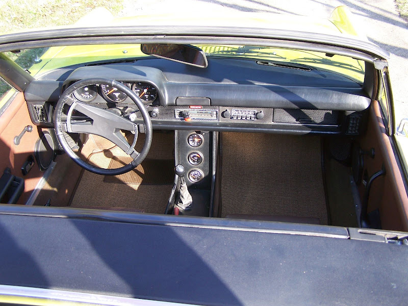

The antenna is not powered. Here's the best photo I could find to show both the radio and the antenna.
(IMG:http://www.914world.com/bbs2/uploads_offsite/lh6.googleusercontent.com-10752-1330445158.1.JPG)
Car's in the shop right now, so I can't go grab better photos...
The faceplate on this one appears to be the correct dash piece for 914, although I'm sure you can find it (or make it) cheaper! (No affiliation to that site)

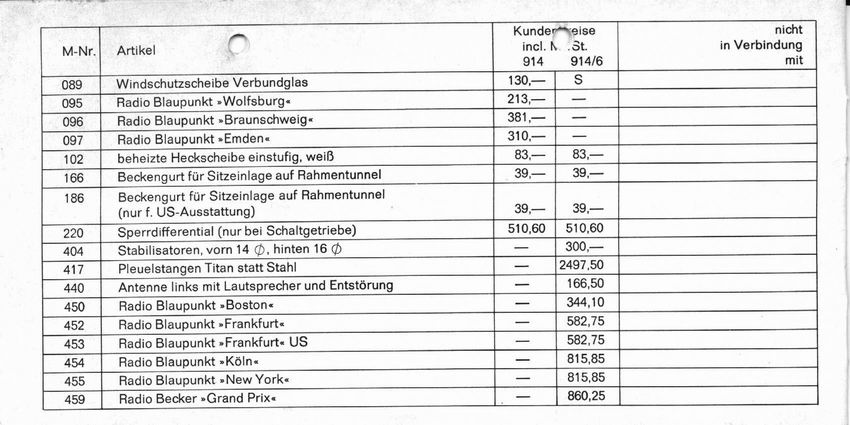

Good info. on options & accessories here:
http://bowlsby.net/914/Classic/OpEq.htm
http://bowlsby.net/914/Classic/Accessories.htm
General 914 at 914 info button at the top of page here & at the Originality & History Forum area, as well as:
http://www.bowlsby.net/914/CanAm/
p914.com
PS - the radios & decks sold for the 914s would include knobs to match the lights & other dash switches & a hard plastic cover plate with the 1/2-circle cut-out for the glovebox lock & molded to match the basketweave (70-74 MYs) or brickweave (75-76 MYs) of the vinyl leatherette dash face material's pattern on the rest of the dash. If you get a vintage radio not for the 914, then you'll have to source the proper knobs & faceplate/surround from another old radio or NOS (if that's important to you). They also sold the radio install kits at dealers with the antenna, 2 oval stereo speakers which fit into the plastic speaker housings at the far L & R footwells, & all needed wiring & coax. or other antenna cable.

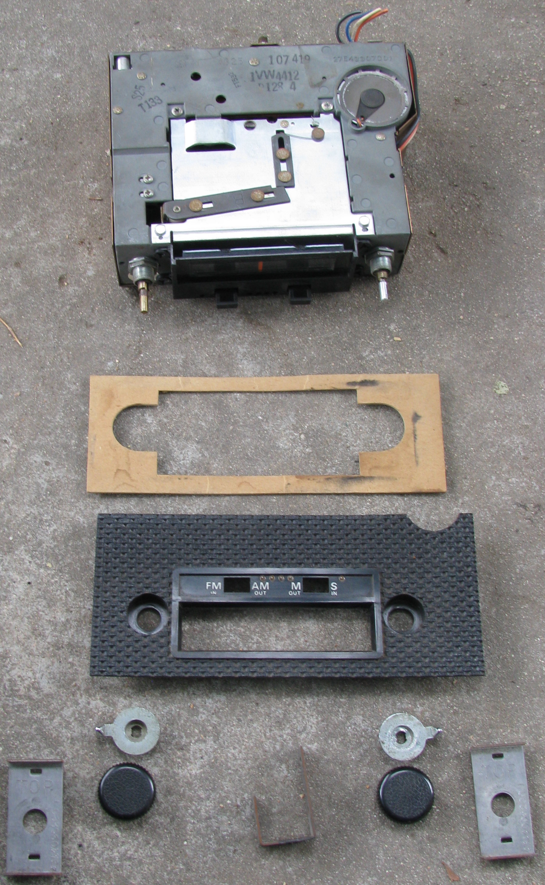

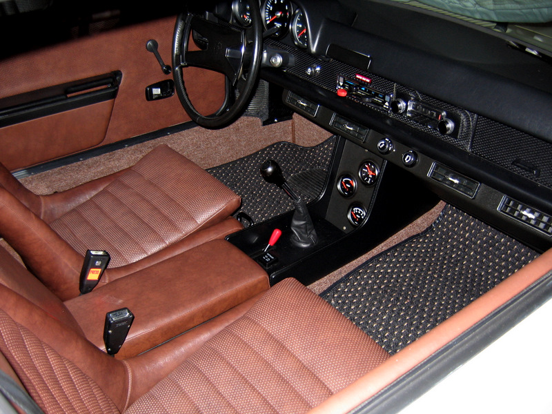

Also - here's an original radio set-up pic (dealer installed IIRC) of a late 73 MY 914-2.0 which is close to your 74 MY's era. There are more pix of it are in the O&H Forum under nailed threads "The few, the rare...", & you can PM the owner steve/smg914 there for more info/questions on his if needed. However, the faceplate/surround is not the plastic one shown on flip's pic above, but a backer wrapped in the actual vinyl dashface fabric (note the circular bulging).
BTW - that faceplate/surround shown as 914/914-6 at the Oldautoradio link above is NOT the correct one, but perhaps one made up by a PO or shop who installed it, cuz it's not basketweave/brickweave texture.
This pic shows the proper radio surround/faceplate & knobs from my Motorola built VPC AM/FM/8-Track from my early-73 2.0 FYI.
