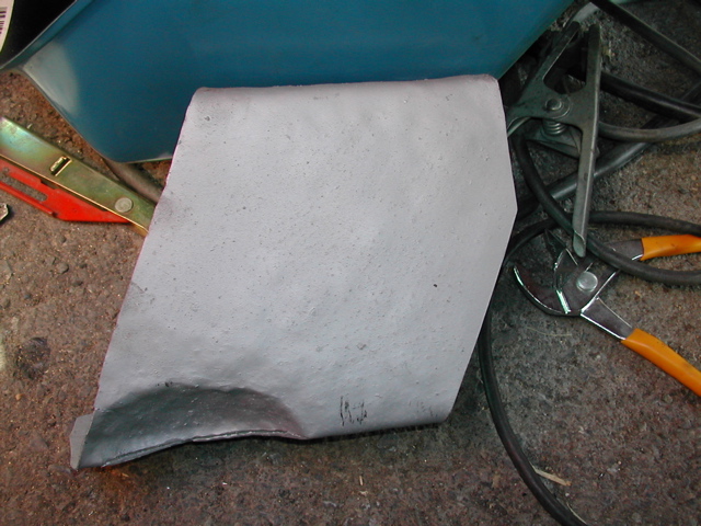

Here's a picture of one of the sheet metal pieces I had to fabricate from scratch. It's the piece that goes behind the motor mount. There is three layers of metal there. I had to stretch the metal to get the bulge, then cut the bulge in half and shrink half of it back flat and then bend the lower piece into place. Leaves that nice cutout for the motor mount.

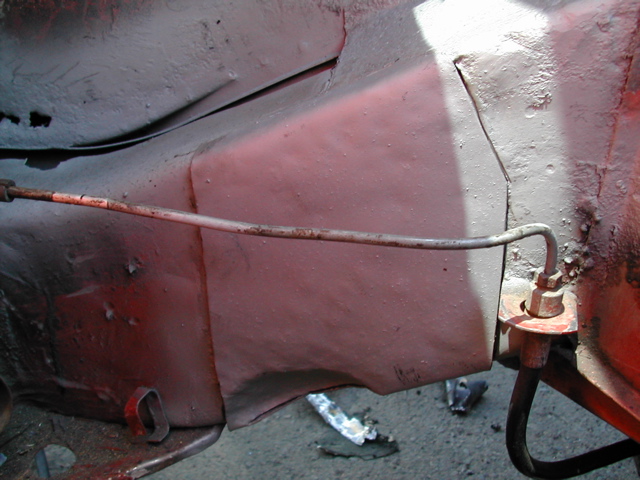

Here it is in place. It's a little rough but it's completely hidden from view by the motor mount/engine shelf/battery tray so I wasn't going to make him pay for me to make it pretty. (IMG:style_emoticons/default/biggrin.gif)
