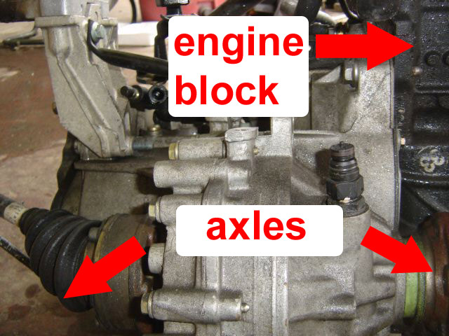

QUOTE Not sure what you mean. with "most" FWD cars, Hondas, GTI, Jettas with VR6 (and 4 bangers), the axles are parallel with the crankshaft of the engine Audi is really the main company to have FWD cars with the engine crankshaft perpendicular to the drive axles Do you know if the VR6 bolts up the Audi transmissions?? Attached image(s)

hey mike,,
I went to the link read the whole thing and they mention that you have to use a 5000 front wheel drive tranny, ( the same as the 944) there is no mention of using the quattro tranny and blocking the end,, so no 6 speed 914, unless there is some trick that have not been mention anywhere, but according to my audi knowledge, the center diff work at 50% and can go to 100% if the sensor in the wheel detect slippage, |

It's not uncommon to make up axles by just taking the four axles from the donor and target, cutting, and welding the ends together to make two complete axles and four extra pieces. Seen it done on several swaps. It's not difficult to alter length this way, either, to accomodate transaxles that put their output flanges in a different place.
Most fwd cars use transverse mounted engines, with the crank perpendicular to the centerline of the car. Thus, they also have to have transaxles where all of the shafts run parallel to each other. Audi and Subaru primarily use longitudinal layouts, with the crank and main gearbox shafts running parallel to the car's centerline, and thus have to turn the power 90d at the diff. There are also some VWs done this way, thanks to parts sharing w/ Audi. Many of the Brazilian-made VWs use the longitudinal layout, too, like the Fox. I wonder: - how hard would it be to adapt a T4 or a Six to an Audi gearbox? - how much heavier is the Audi gearbox? - how much are the replacement parts? An Audi transaxle swap might be more cost-effective than rebuilding a 901, esp. if the internals are cheaper, to boot. Depends on how much the gearboxes cost used, and how much it would cost to fabricate axles. Since a full rebuild of a 901 is over $4K and even a quality refurbishment is going to run close to a grand, the Audi bits would have to be awfully expensive to not make this a more viable way to go. |

I have no reference for this but i would think that the VR6 engine would bolt directly to the Audi tranny,, they have the same blood!!!!, the new 3.2 V6 in the golf and in the TT are the same but the golf has the engine mounted tranversally and the TT has it longitudinally,,

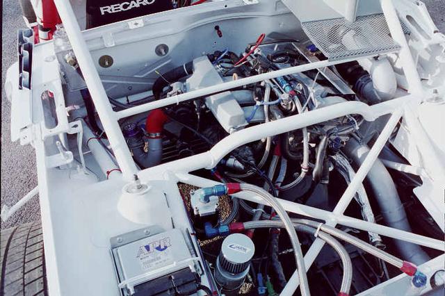

SKS on Audiworld.com did this conversion a couple of years ago. He did a full on
race car though. Had 335 width tires on the back!!!! He had custon axles done up so for sure it can and has been done. You can probably get a hold of him on that forum if you want to. |

QUOTE SKS on Audiworld.com did this conversion a couple of years ago. He did a full on race car though. Had 335 width tires on the back!!!! He had custon axles done up so for sure it can and has been done. You can probably get a hold of him on that forum if you want to. I don't consider the car that SKS built as being a "conversion", if I'm not mistaken, it's a full on custom tube frame car that just "looks" like a 914...not that there is anything wrong with that, hahahaha 914_1.8t knows that new axles can be made, he just does not want to shell out the big $$$$ for them (IMG:style_emoticons/default/smile.gif) I'm sticking with the 914 transmission, I have at least 3 good side shifters plus a few tailshifters if I need parts....the adapter plate and flywheel is about a week away from being delivered |

You are probably right about the SKS car. I have emailed him a couple of times about questions on how he handled
certain technical problems. Although the car is very heavily modified the mounting points for the motor and A6 tranny he used were the stock mounting points. I believe he used a Tilton pedal cluster for the brakes and hydraulics that the Audi tranny required. I had a 98 Passat with the 1.8t and the APR stage III kit on it. The car was very strong and probably weighed 1,000lbs. more than the 914 soooo...... Have fun with your conversion (IMG:style_emoticons/default/biggrin.gif) |

Looks like it started from a 914... Counts as a 914 to me!!!
(heck if I had it my way, thats how mine would look......) Lots of 914 metal still present. |
