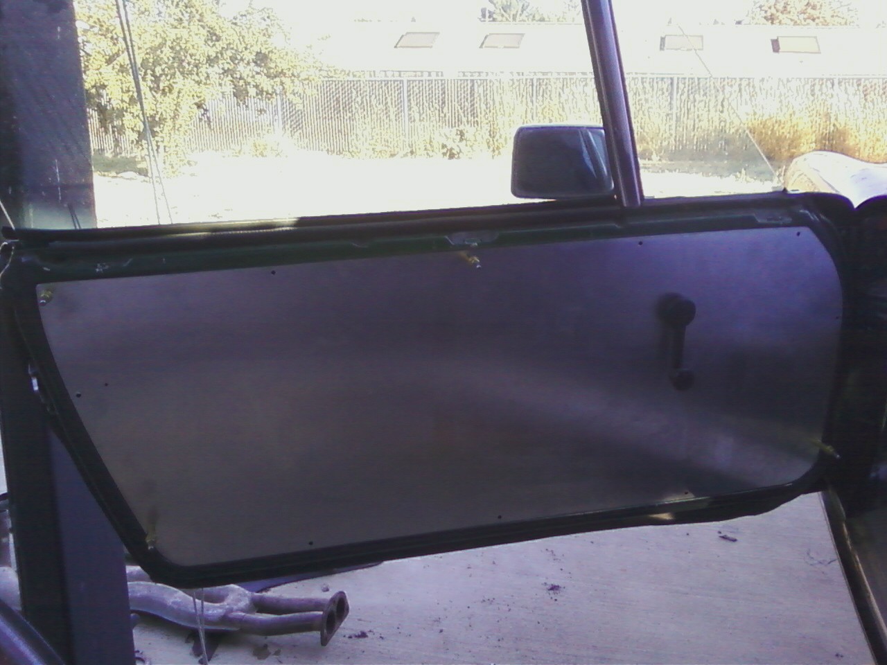

forgot a picture of the aluminum door panels I made.
I'll top them off with the rails from some early door panels after I get them powder coated crinkle black.

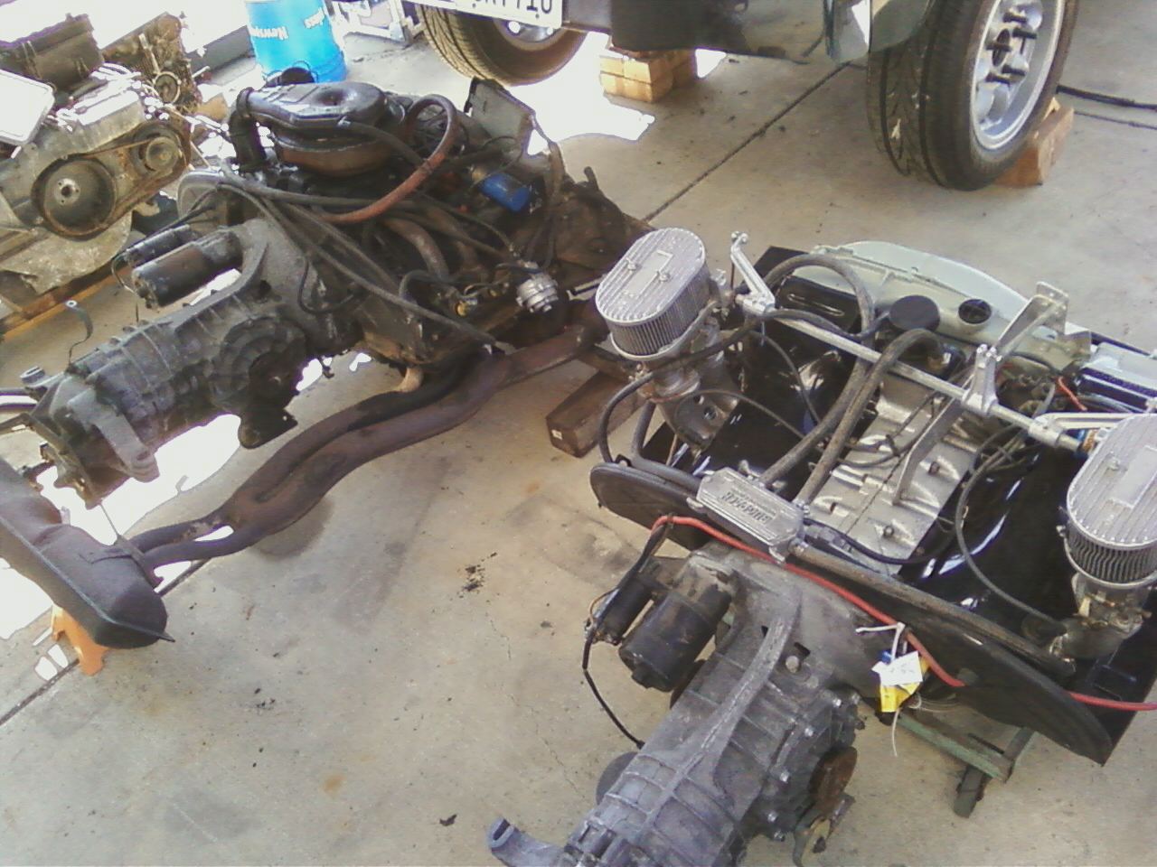

time to do a heart-lung transplant.
here is the old and the new.

If you are tracking the car I'd suggest plugging/blocking the head vents, enlarging the case vent, and using a better breather (I never liked the CB one when I ran it in my drag bug).
My car "ran out of oil" when it was "full of oil". I pumped everything I had in to the heads and starved the bearings. Doesn't happen often, but it does happen...
-Aaron
