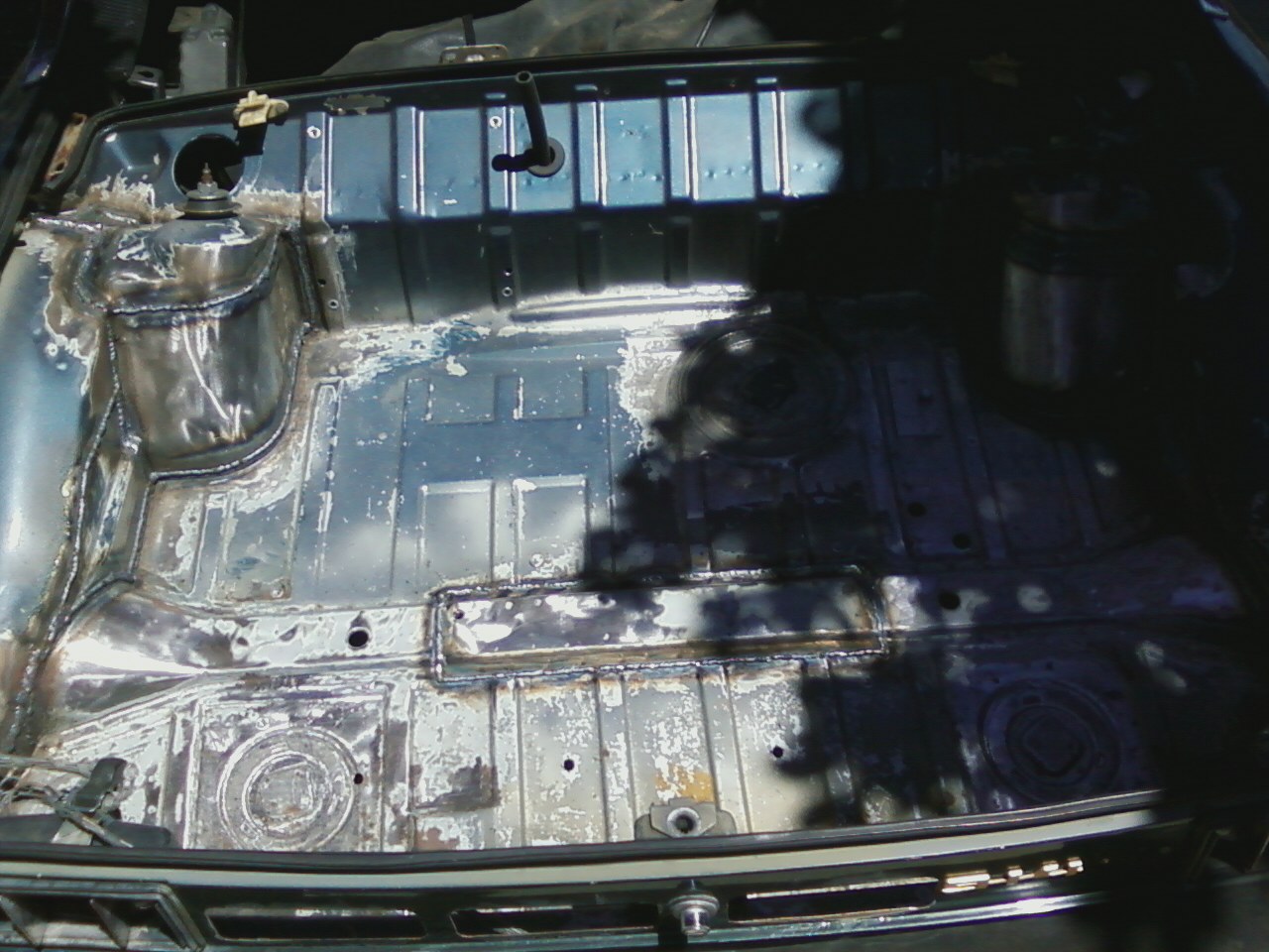

well I was able to get the shock tower seams welded up.
now I can install the oil system and finish up the relocated battery work.

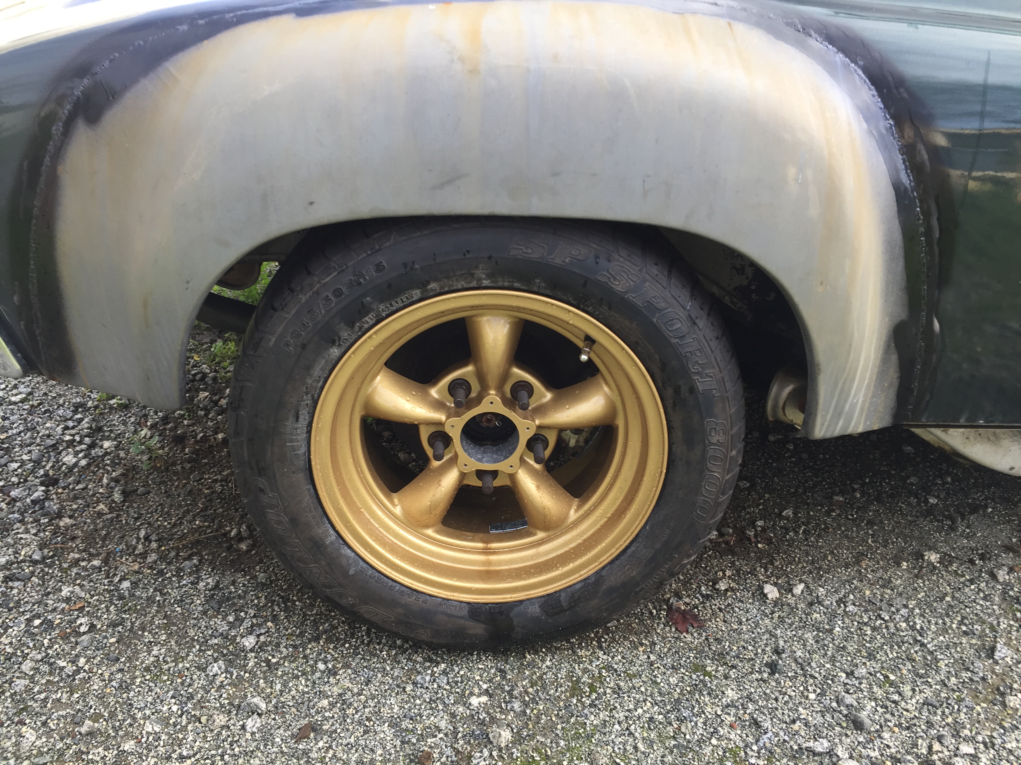

I just took the car to the body shop to have steel GT flares added.
going to strip the body and repaint it also.
I need to buy F/G lids for it now.....

the first guy i tried to use for the flare install turned out to be a huge jerk-off. finally got them installed by an R-Gruppe friend, thanks Bob.

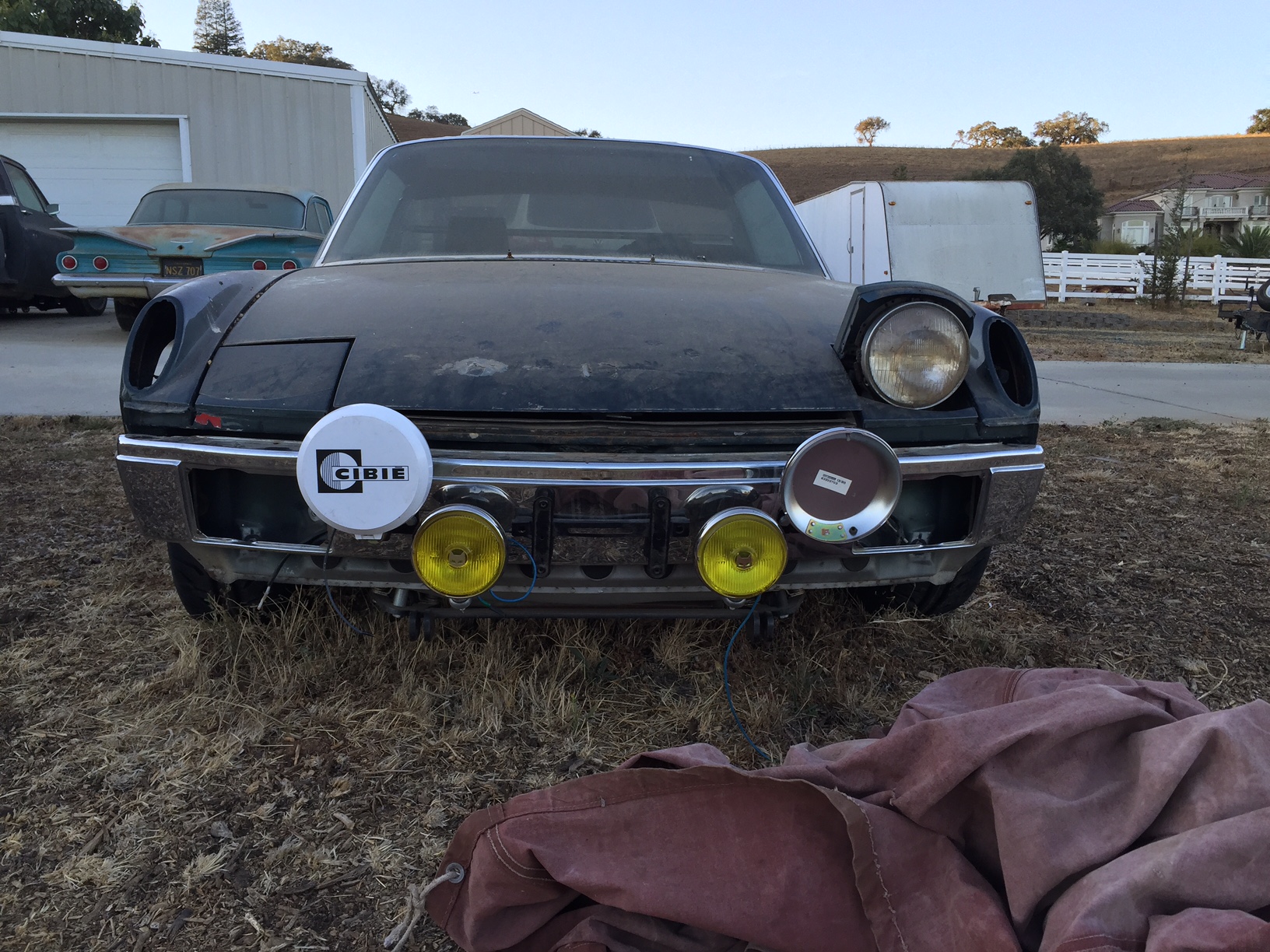

and mounted a few lights. the Cibie is just a place holder. i have a set of Marchal driving lights like the one on the right, i was just waiting for the second clear bulb to arrive.
waiting for some headlight adjuster parts to come and then fresh headlights will go on.
the plan is to restore all the little stuff on the car before i tear it down for paint. so she will be ugly for some time to come.

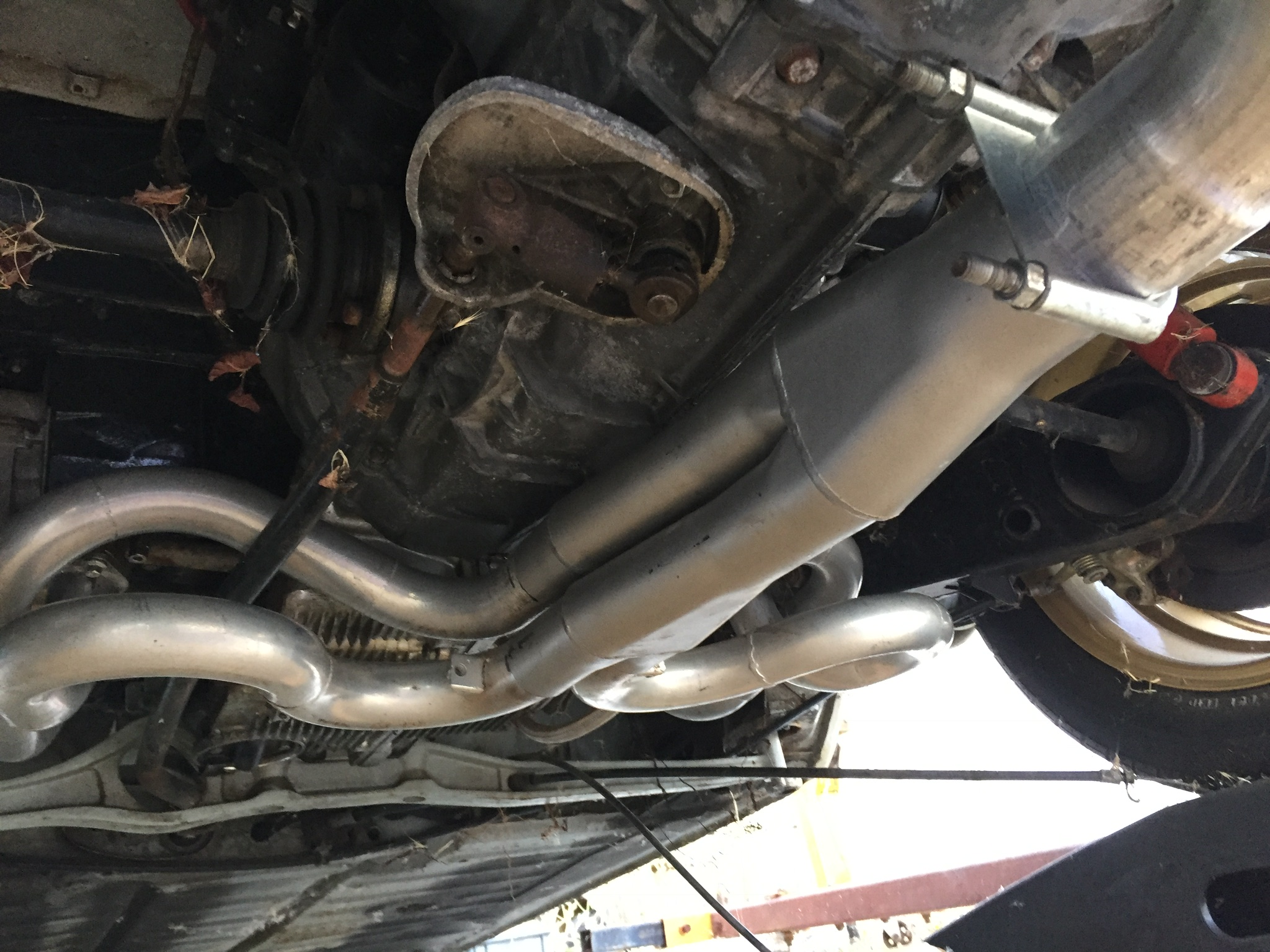

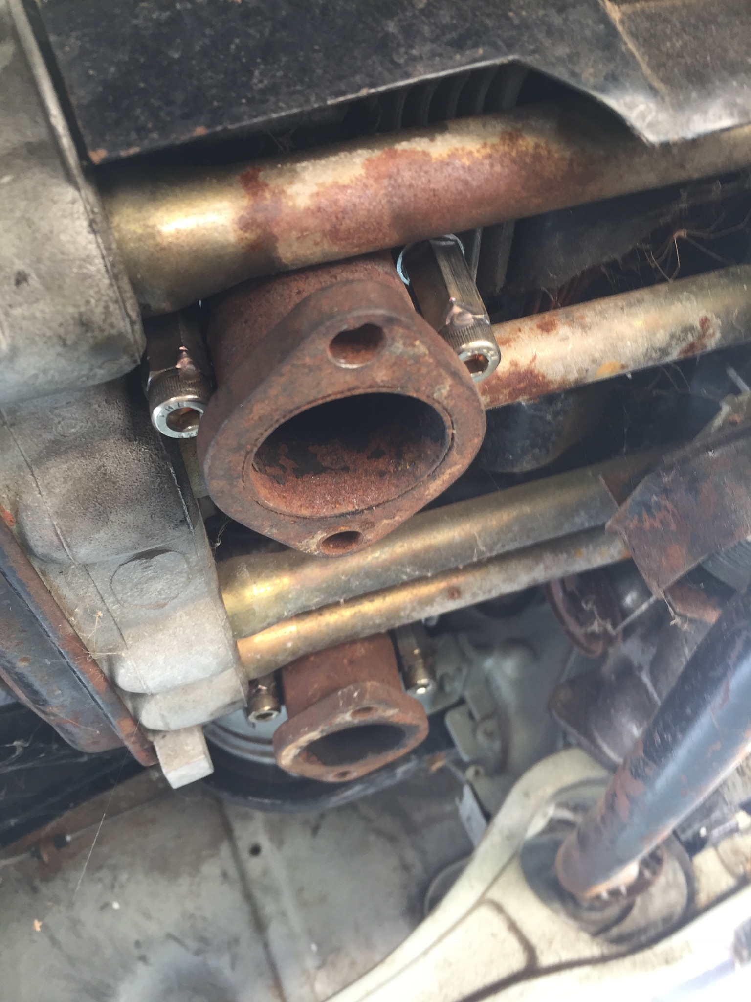

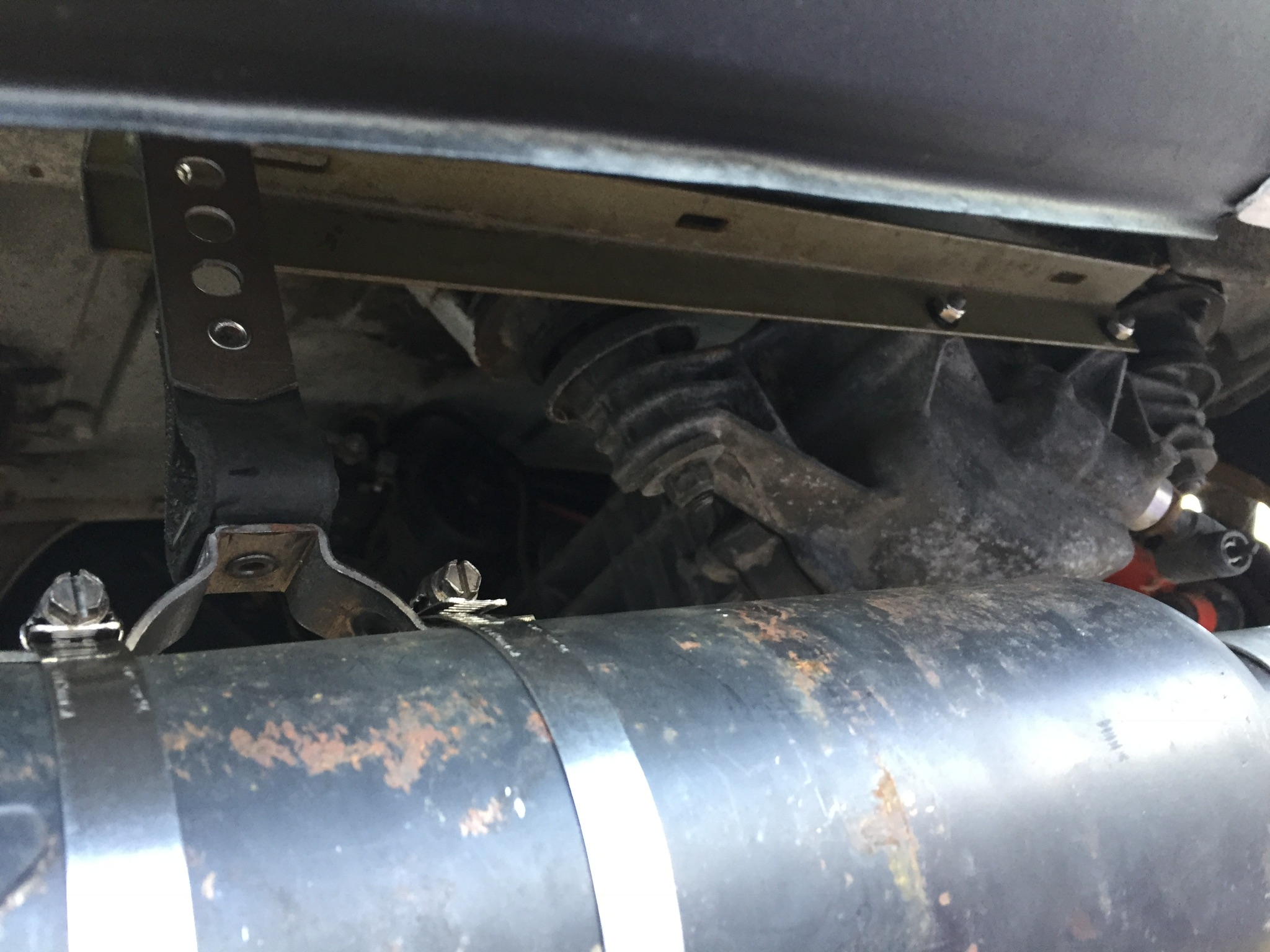

Moving right along I have the exhaust installed (roughly).
barefoot
post Feb 1 2020, 01:01 PM
Post #30
Posts: 1,548
Joined: 19-March 13
From: Charleston SC
Member No.: 15,673
QUOTE(B2524 @ Feb 1 2020, 01:00 PM) *
Not sure how you're supporting the exhaust back aft, but you'll need to accomidate thermal expansion as the system will grow more than the tranny housing

Thermal expansion?
Say what?
I used a muffler hanger.
B2524
post Feb 1 2020, 06:53 PM
Post #34
It's a sickness.
Posts: 72
Joined: 12-November 11
From: Outside Paso Robles CA
Member No.: 13,776
The angle iron is from an old bed frame. The hanger was left over from a C10 project.

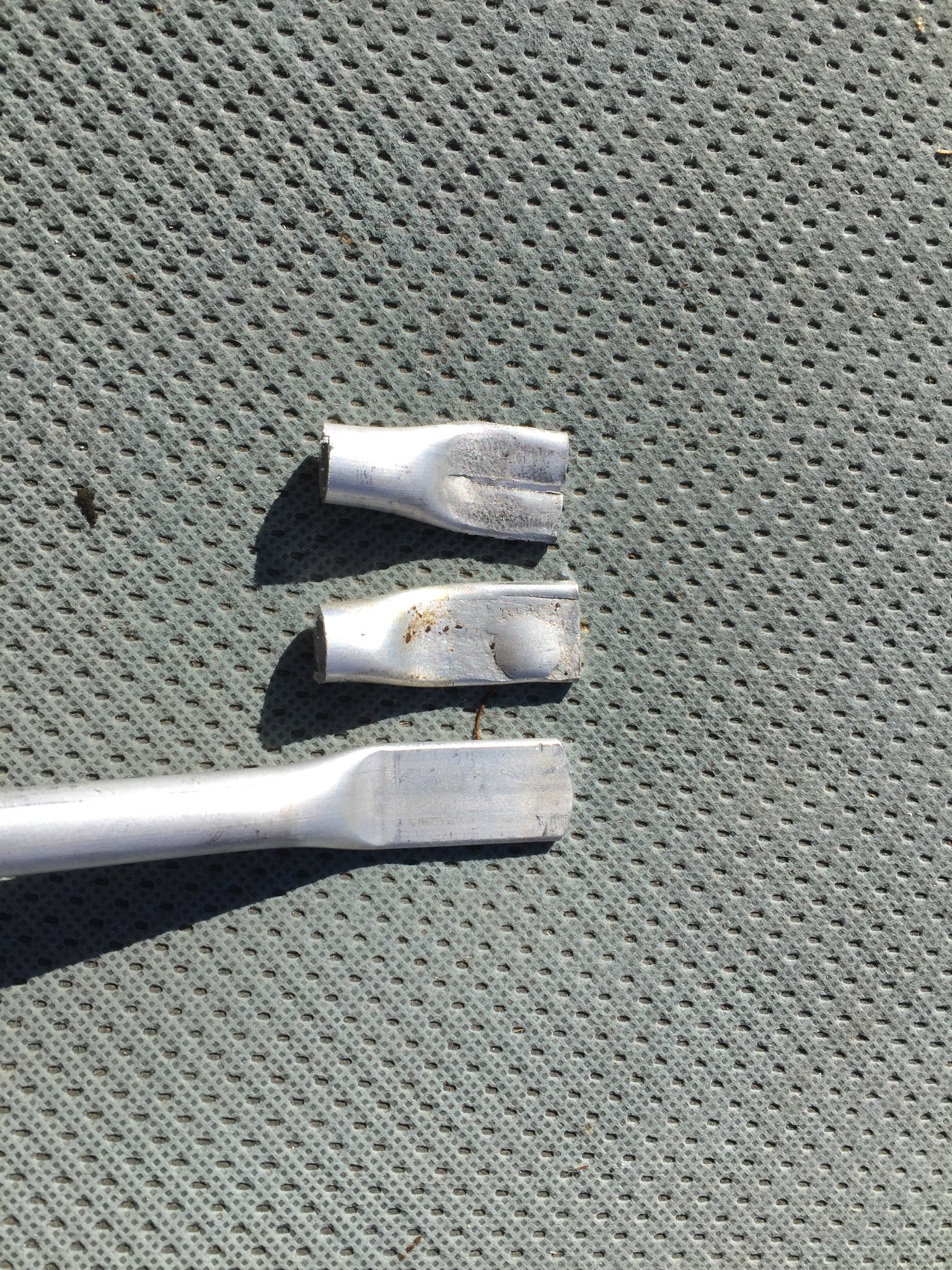

Guess I missed two others
Here is a learning experience. I wanted to make aluminum struts.
So I bought some tubing from Home Depot.
The top piece is where I just crushed it in a vise. As you can see it cracked.
So I used a butane torch to heat it up on the second attempt shown in the middle. The bump is from a hole in the face I used to crush it.
The problem now is to make a smooth transition from the round tube to the flat end. So I took a piece of aluminum and put a radius on the edge. I used it as a jaw when I crushed the bottom piece.

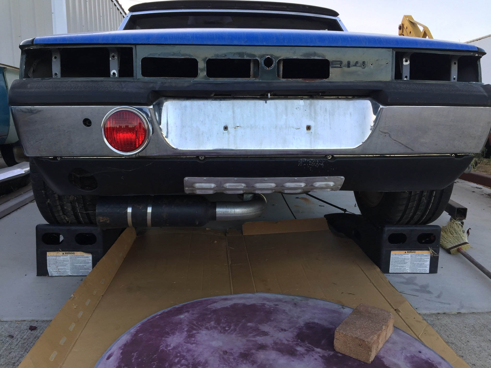

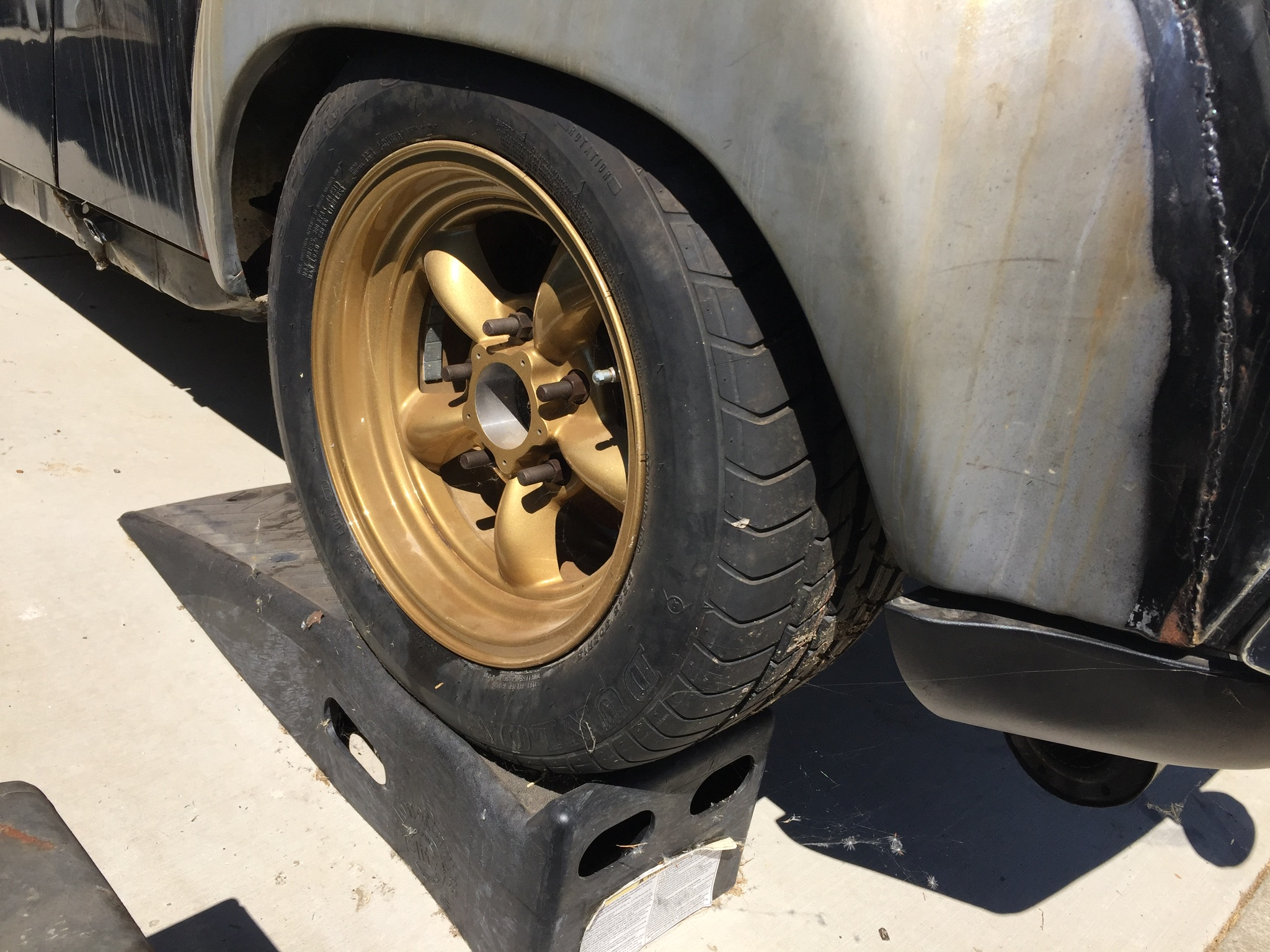

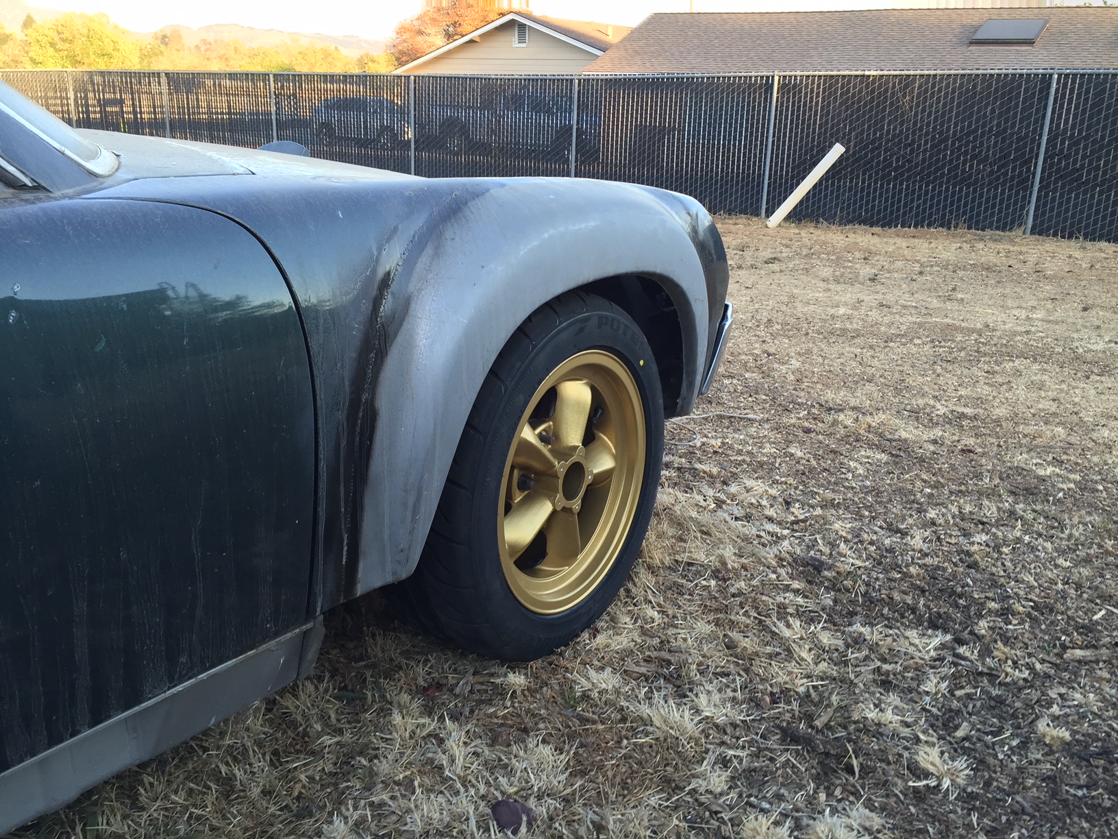

I was at a swap meet and found that rear valance. Which the trained eye will notice is from a 914-6. It came off an old GT that was raced back in the day. The cool thing about it is they flared it in metal.
I need to spend some time fitting it to the car but this gives you an idea. It was not show car quality but it works for me. I had it powder coated in a semi flat black. BTW the Americans are late wheels I had made up. The inner is cast but the outer is spun. They are very lightweight and you can get them in various widths and offsets. The rears are 9’s with 5.75 or 6 inch backspace. I can’t remember but I they were 6..
B2524
post Feb 1 2020, 07:36 PM
Post #39
It's a sickness.
Posts: 72
Member No.: 13,776
Oh yeah I forgot to mention. They ran a sport muffler on the 914-6GT race car and cut two mouse holes in it for the tips. They did not do a great job on cutting the holes so instead of filling them I had a piece of aluminum louvered and covered them. What can I say I’m lazy.

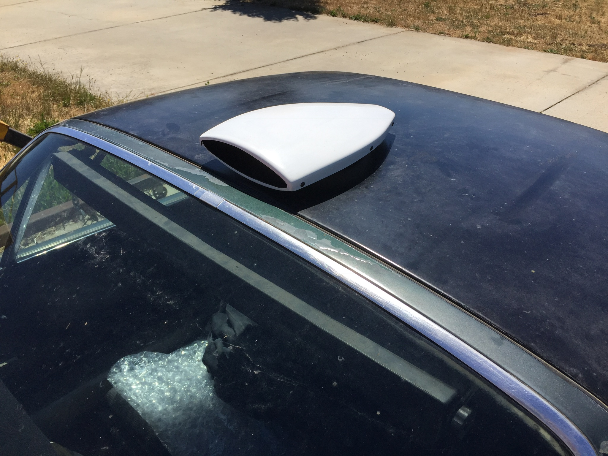

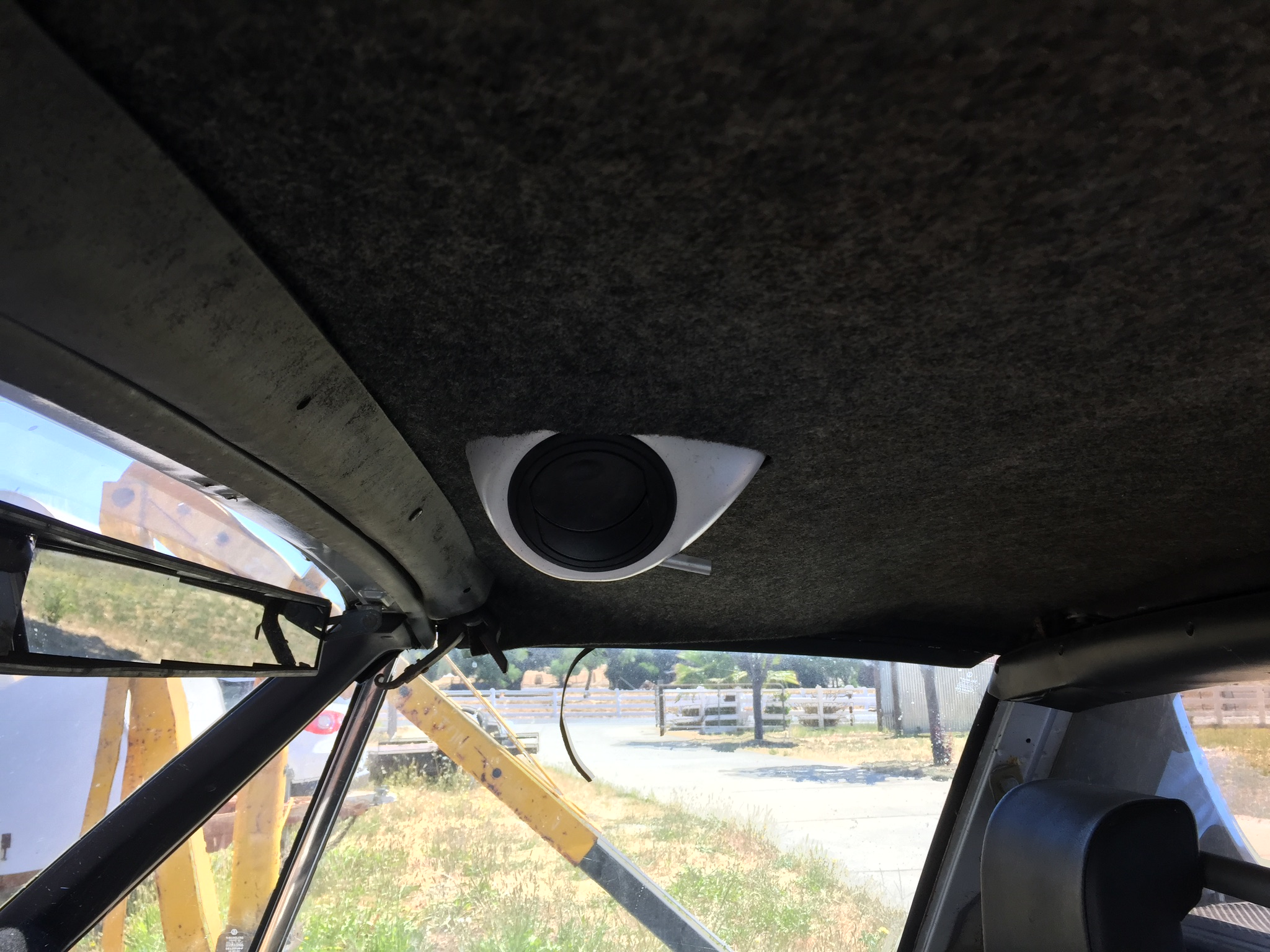

One more thing I added to the build. I have a spare roof so I thought I would play with this one and try to add some ventilation.
