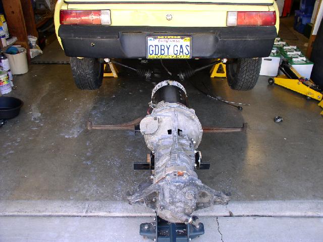

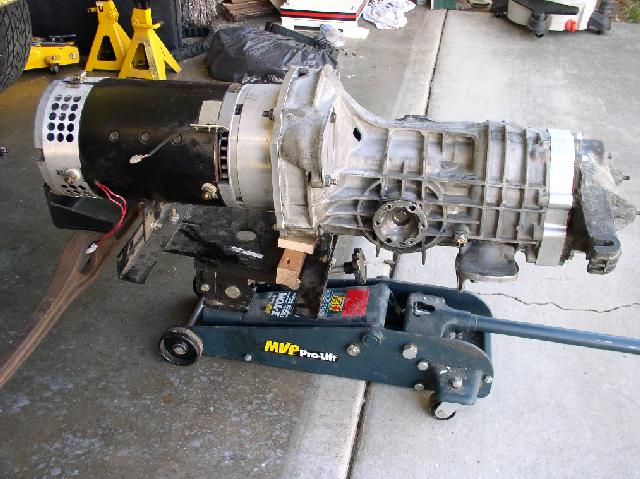

After a lot of advice from this board and others I've decided that the endplay on the output flanges can be ignored for now. So..... Let's get this baby back on the road!!!!!! (IMG:style_emoticons/default/aktion035.gif)
Here is the B.F.N. tranny mated to the motor. Yep, that's it. Hook two big fat wires to this thing and it goes! No F'n' ignition, valves, carbs, oil, cams, exhaust, etc.....

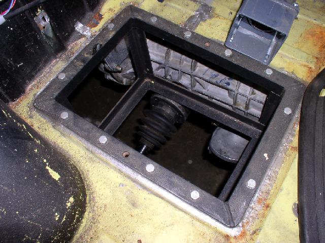

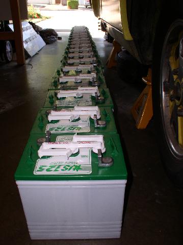

How many batteries will fit in this thing?

Are you going to use solid bus bars to connect the batteries together? Any figures on how much it costs/mile to charge them? How many miles do you figure you get before having to replace all those batteries? Curious about the numbers.

Bob - I'm not going to use solid bus bars to connect the batteries. Basically for vibration reasons you want the connections as flexible as possible. I have connectors made out of sheet copper. They can take the amps (500amps or so) but are fairly flexible.
As for cost it's about $2-$3 for a full tank. And a full tank gets me from anywhere between 50-100 miles. It don't pay for any of it though since I charge at work. (IMG:style_emoticons/default/aktion035.gif)
YMMV but I expect to get between 15-20,000 miles out of this pack.

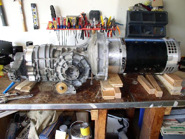

First, one step forward... motor and tranny ready to go in

'nother view. That electric motor sticking out there makes this process a bit phalic (IMG:style_emoticons/default/huh.gif)

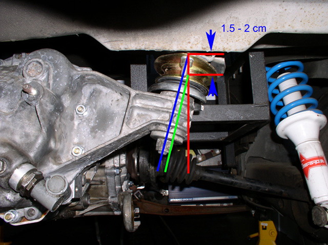

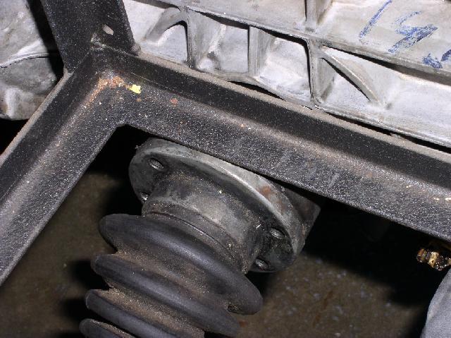

... and 10 steps back...
The only thing different this time is the 911 sport mounts. I measured them before the switch and they were only a few thousandths smaller. Where I had about a cm of clearance before now I have none.
Wiskey Tango Foxtrot ... Over?
So it looks like I'll have to move my battery boxes up. (IMG:style_emoticons/default/mad.gif)

Hmmm that's about 24 bolts (2 boxes), a bunch of sealant, and I gotta fab a bunch of spacers... (IMG:style_emoticons/default/mad.gif)
Not the least of which, I will lose my ability to put the top in the trunk. I know this is a family website but FUCK FUCK FUCK FUCKING FUCK!!!!!!! (IMG:style_emoticons/default/ar15.gif)

Can't you just space the tranny mount lower to get the clearance? Worth a try before you raise the battery box.

That's a great idea for the long term. Thanks for the suggestion.
Short term I have about $1000 in batteries sitting on my garage floor that have to get in there and on charge before they die.
I'll have to fab a nice block of aluminum like you have in your pic. I've got to drop the tranny about 1.5 to 2 cm. Perhaps for just today I can add about that much in washers to the 8mm bolts on the tranny mounts. (IMG:style_emoticons/default/idea.gif)

Ok, so I've been laying under the car staring at the situation. I can't just add a bunch of washers to lower the tranny mounts. The darn things are angled so if I lowered them the bolts won't line up. But it's small enough that the new hole would overlap the hole to mount the spacer to the car. Is any of this making sense?
Anyone remember their high school geometry? Anyone have a suggestion?

Any thoughts on hybridising? Could you put a honda generator in and reduce the volume of batteries? Trying to keep the range the same, reduce the weight, and have an on board charge source. Could you use the smaller battery supply for around town driving, and turn the generator on only when you needed the extended range? Most trips are not 100 miles. I realize the generator could not keep up with the draw rate. But, there should be a mid-point, battery volume vs. battery volume & generator, that would show an advantage. Are those glass mat batteries?

why cannot you lower the front of the motor/transmission assembly???
