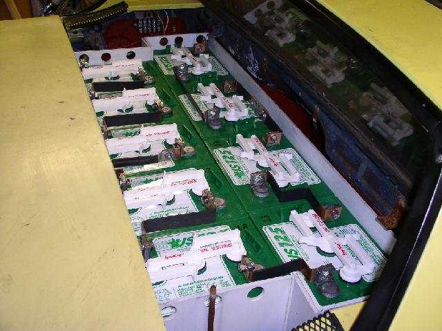

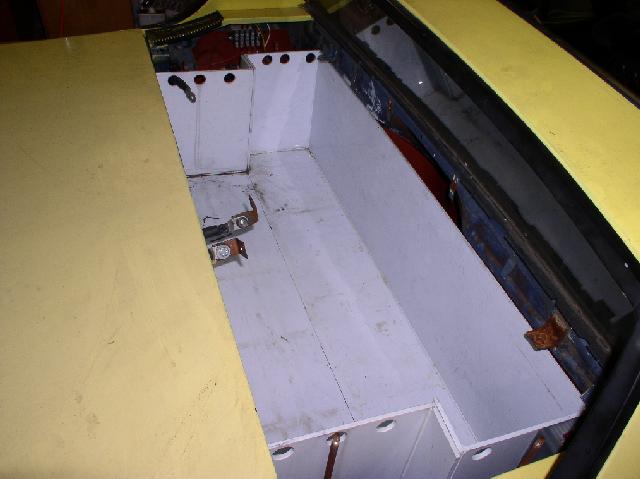

Before:
sgomes

After:
sgomes

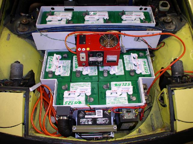

Member No.: 2,029
Front:

First the pics, then Ill answer all those questions above.

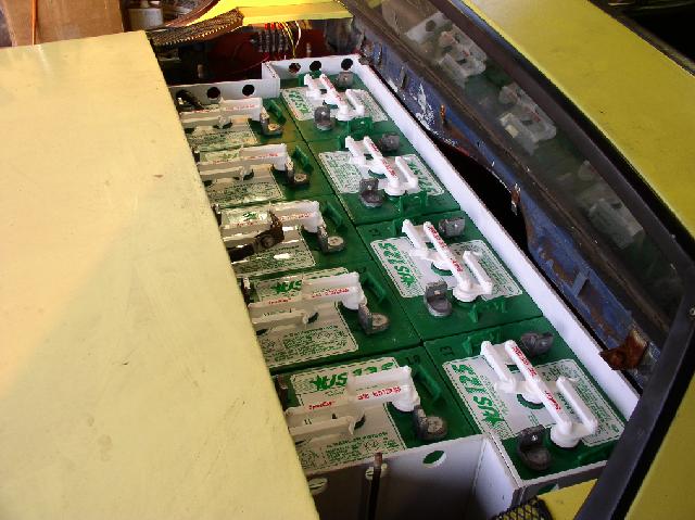

First up, same shot again but this time with the interconnects.

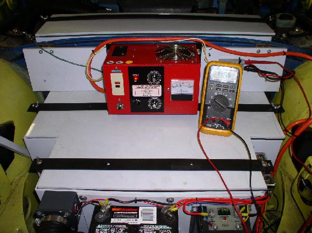

Member No.: 2,029
Amps going back in after a short spin around the block. Number on the DVM is charging volts (140.9) at the moment. Only 8 amps since it was only a short spin.

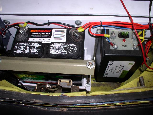

Member No.: 2,029
This is a shot of the alternate alternator. Basically, it converts the 120V battery pack to 12V to charge the little system battery. It's actually somewhere around 13.8V just like an alternator.

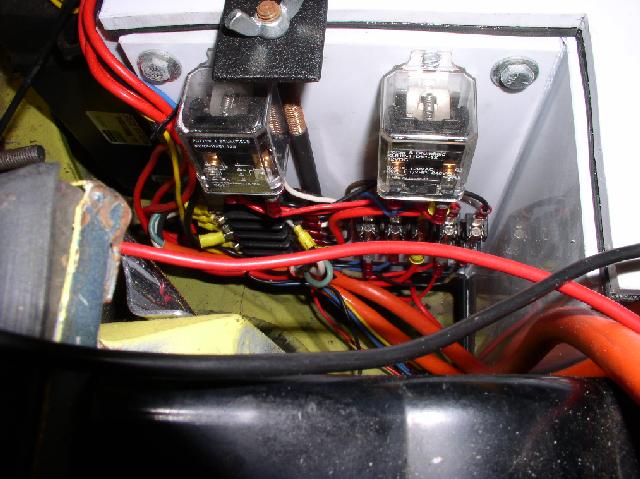

Member No.: 2,029
These are a couple of relays to keep the car from operating while it's on charge.

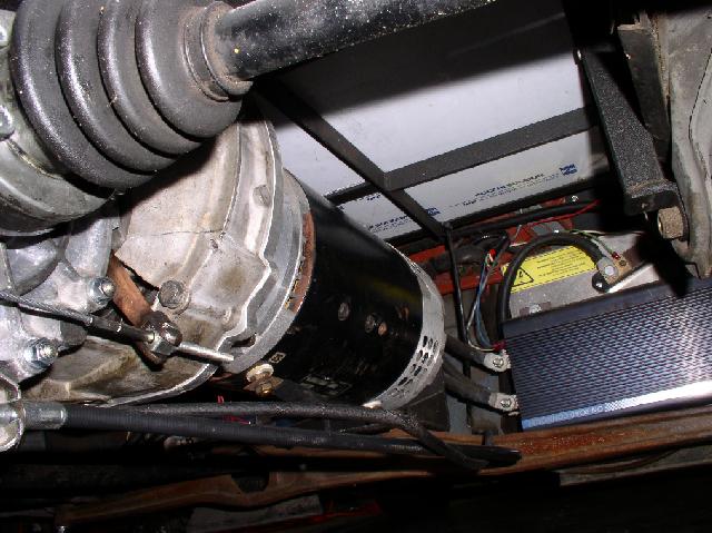

Member No.: 2,029

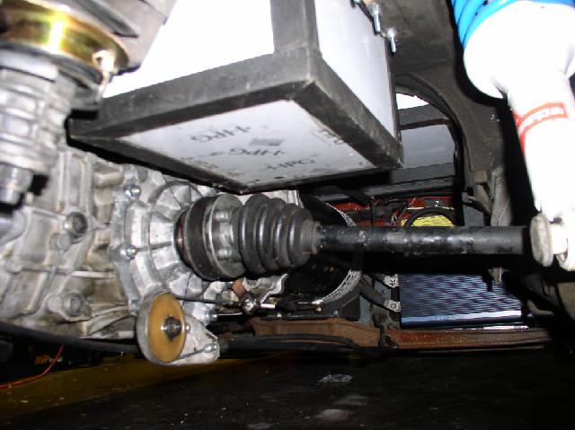

Motor and controller. The box to the right is the controller. Essentially it's what regulates the current to the motor based on the throttle input.

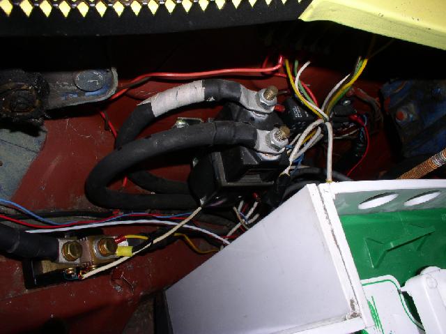

Member No.: 2,029
In the center of the picture is the contactor. It's a big fat relay that closes when you step on the pedal. You can hear it slap from pretty far away. Also shown is the second shunt that allows one of my guages to measure the current leaving the batteries and also returning to the batteries when on charge.

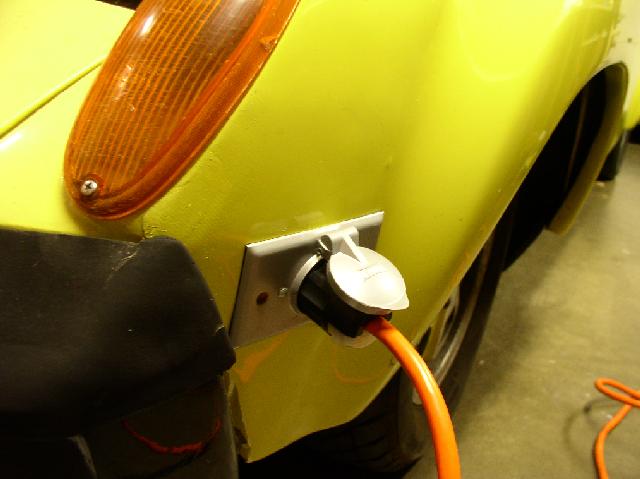

This is the one item on the outside of the car that always catches the eye of someone who knows 914s. (IMG:style_emoticons/default/laugh.gif)
