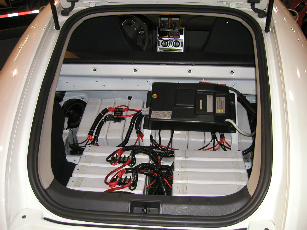

Shannon,
Here's a car you may want when you win the Lotto... (IMG:style_emoticons/default/biggrin.gif) Chrysler Crossfire electric: 6 speed allowing speeds over 90MPH, 100 mile range, 168 volt - 25 kw. It was shown at the SEMA in LV. Their website is www.whistlerinvestments.com. I wonder what they did with the Benz engine... Felix Attached thumbnail(s) ![]() |

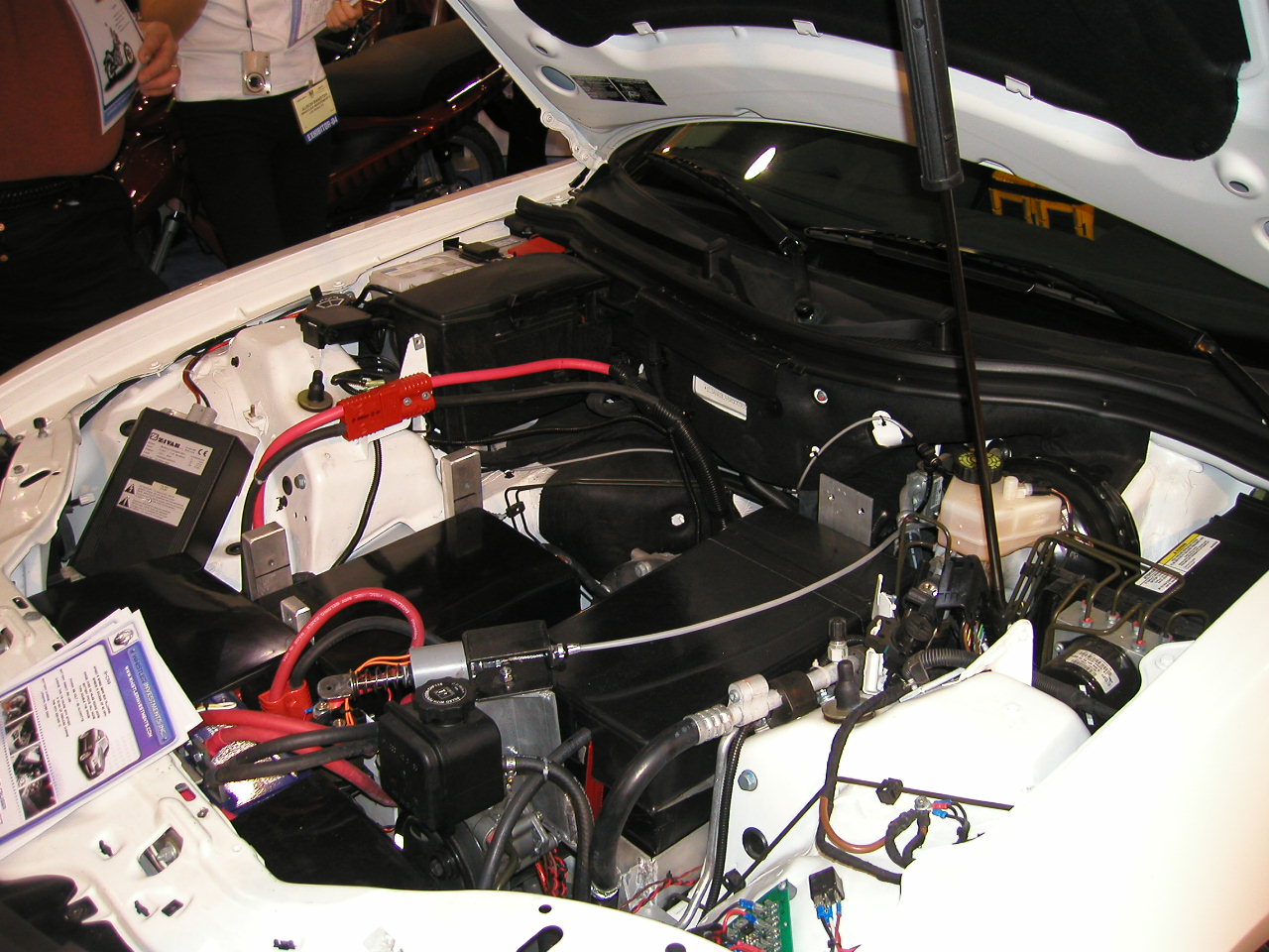

neo life ![]() ![]() ![]() ![]() ![]() Group: Members Posts: 5,086 Joined: 16-January 03 From: Willow Glen (San Jose) Member No.: 159 ![]() |
batteries...

You gotta love their dash gauges!!!!!!
(IMG:style_emoticons/default/laugh.gif) (IMG:style_emoticons/default/lol2.gif) (IMG:style_emoticons/default/chairfall.gif) (IMG:style_emoticons/default/unsure.gif) (IMG:style_emoticons/default/blink.gif) Looks like a super nice conversion otherwise. I'll have to read up on the details. Their website seems to be down at the moment. |
