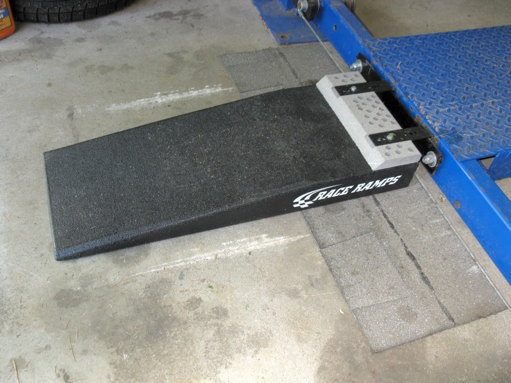

Okay, for anyone with drive-on lift. The ramps that came with mine
are 1/4" bent steel 18" wide and 47 pounds each. And if you leave
them attached while raised, they get in the way of my face (no 12'
ceiling for me).
So, I bought 'race ramps' which are 4 pound foam bits. But, they are
only 3" high when ramp is 4" high, and they need to hook onto the lift.
Added a piece of composite decking machined for the hooks, put a
bolt thru and done. (IMG:style_emoticons/default/aktion035.gif)
Now I can pick these up and throw them anywhere. You can make out
the size of the old parts by the marks on the concrete.

What kind of foam?
I have the big steel ramps also...and they are heavy and hard to store...
Formation sells all sorts of foam...wonder if I could just get a slab of foam....

QUOTE(r_towle @ May 19 2012, 09:13 PM) *
What kind of foam?
Well, the outside is some kind of formed plastic (with rough texture).
When I drilled the hole, it really seemed to come out like tiny (~2mm)
styrofoam beads. Without the outer structure and maybe ribs inside,
you'd be in big trouble with more than 500 pounds on it.

(IMG:style_emoticons/default/agree.gif) The ramps that came with my Danmar weigh a ton (not really a ton), but yes, they are fairly heavy boogers.
The ramps don't REALLY need to 'hook' onto the lift, do they?

QUOTE(euro911 @ May 19 2012, 10:42 PM) *
Nice idea.
Without hooking them to the lift, you stand a good chance of shooting a ramp out as you try to get on the lift...

Nice. I bought the aluminum ramps for my BendPak lift; they weigh 18 pounds each. That's a far cry from the 53 pound stock steel ramps. I can easily hand them on the wall next to the lift above my walking space. I have just shy of a 12' ceiling over my lift.

QUOTE(r_towle @ May 19 2012, 07:51 PM) *
Nice idea.
Never had it happen, but good point (IMG:style_emoticons/default/idea.gif)
Wonder what the scrap value is on those bad boys (IMG:style_emoticons/default/laugh.gif)
