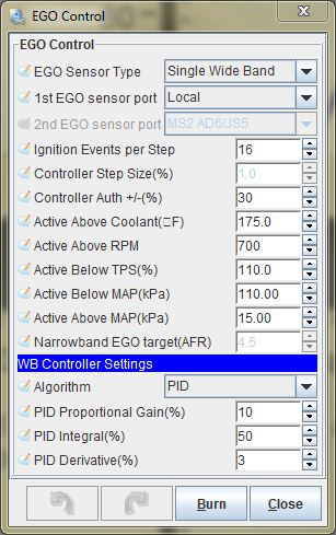

I spent about a week going back and forth to work and think that my VE table is about as good as I can get it. But now I need help with the EGO Control Settings.
I can't find anywhere where it has a recommended starting point for the
"WB Controller Settings" see pic.
I followed the recommended settings for tuning but now I'm trying to setup up for running and I can only find instructions for the upper part of this dialogue.
I'm using TunerStudio and MS2 Extra
