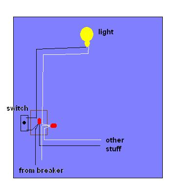

White = neutral, black = power (120V), green = ground. Switches, including dimmers are only connected to the black wire. Switches open and close the circuit, dimmers will vary the resistance to give you more or less voltage.
Don't connect black to white or green = blown breaker (bad).
Quick and dirty skletch.

Wow, I suck at this but I appreciate the help!!
Progress report:
I can peer up into the fixture box and identify the four wire bundles where they enter the box:
  1. The Always Hot (main) and the corresponding Neutral, which must go to the main panel - These look like newer wires
  2. I've labeled this bundle "A" - when I connect the Black to the Always Hot, the White of the same bundle turns Hot as well - These look like newer wires Edit: Windforfun, I realize now that this circuit has a load somewhere in the kitchen and has nothing to do with the chandelier.
  3. An older bundle, Black and White - I've labeled this "B"
  4. An identical older bundle, Black and White - I've labeled these "C"
I loosened the dimmer switch from the wall and the wires behind it (one black, one white) appear to be the older type of wires. So now I just need to figure out, of B and C, which one goes to the dimmer - right?
flipb
post May 26 2012, 07:59 PM
Posts: 1,816
Joined: 2-September 09
From: Fairfax, VA
Member No.: 10,752
QUOTE(flipb @ May 26 2012, 09:51 PM) *
Progress report:
And the winner is... bundle C goes to the dimmer switch!! Yay.
