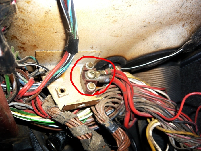

Quite a while back I bought an Engman fuse panel. It's lovely and I'm happy that I bought it. I finally installed it today and, after a little smoke, made an unpleasant discovery.
It turns out that the metal bracket on the back of the fuse panel touches right up to a positive wire connector that has live voltage.
Hence the smoke.
My question is why is this battery connector sitting right here so close to the panel? With the new fuse panel bolted up it makes direct contact between the rear metal bracket and the live connector making a really solid short circuit. Has anyone else noticed this? I have no idea if my connector is even in the stock location. There doesn't seem to be another convenient spot to relocate it to.
Thanks,
Marcus

You have an early car. You could remove the connection from the bracket. Bolt and shrink tube the electrical connection. Then tie it to the harness.

Entirely true. Mostly. The car is a 1971. The engine and rear half of all the wiring is from 1973. If it just needs to connect, then I'll find a fancy connector and move it out of the way.

Later cars ~'72ish had two wires from the battery directly to the fuse panel and ignition switch. Yours has one big wire split under the dash. I assume Porsche changed it due to arcing under the dash.

On my 74, that is where the ground wires bolt to.

In my case, the bolt touched that the block where the main red wire from the battery is attached. My red wire and other wires were melted. I had to pull the harness from the tunel, inspect, tape and replace as necessary.
you may want to do the same.
I added a fuse on the engine bay on that red wire for prevention.

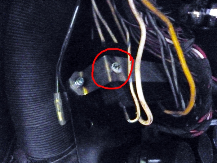

I just had the same problem as OP - but manageable (IMG:style_emoticons/default/sad.gif)

This thread was brought to my atttention suggesting that I should be concerned about this.
However, the issues above did not occur with a JWest fuse panel. Our fuse panal does not use a metal strap above for this very reason.
We use a nylon spacer to mount the fuse box so even if the screw near the power block touches solid, it is isolated and will not cause a short.
