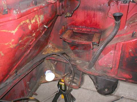

Since I had to search extensively for the installation of a battery stand and tray, I decided to write up the process that I used to weld in my new one.
This 'upgrade'/'enhancement' to the 914 is probably the easiest welding project that I've done yet. I replaced mine because I was replacing the suspension ear and engine shelf and the battery tray was starting to show signs of rust. It also allowed me to check the frame rail underneath.
Here's the before shot. It doesn't look as bad as others, but I wanted to do it 'right' since I was in there.

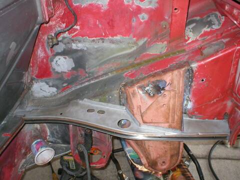

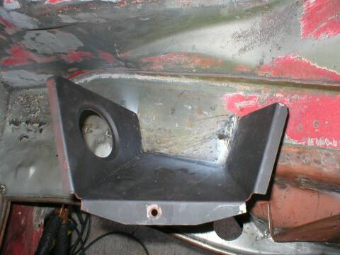

I'm not going to show the removal process as it will depend on the state of the stand/tray. I would recommend drilling out the spot-welds, if you can find them. If not, then you can use a cutting wheel to removed the stand and tray, then grind out the left over metal.
Anyway, here's what mine looked like when I was finished removing it.

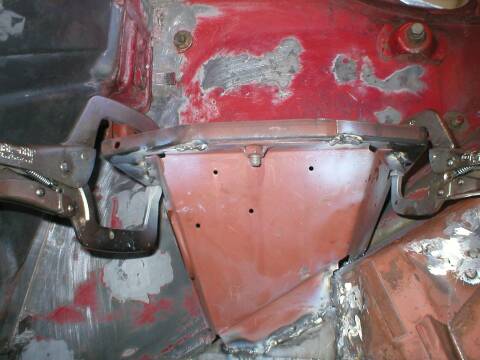

The first thing you'll need to do is bolt the stand and tray together, using a 13mm bolt. This will allow you to place the stand in position to determine where you'll need to adjust it. Remember, these new pieces are just a starting point, you will need to fit, bend, grind, then repeat until it fits.
Here's mine fitted in place.

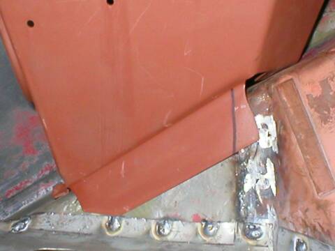

Here's a section that I'll remove to make mine fit next to the suspension ear.

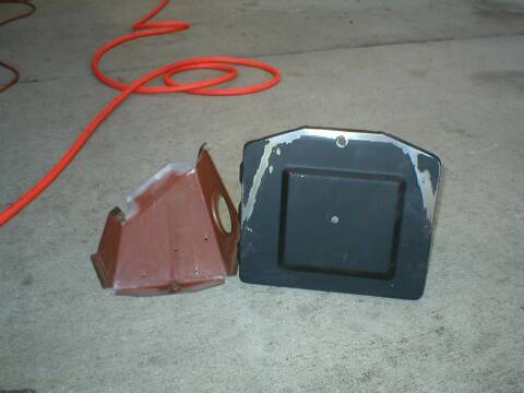

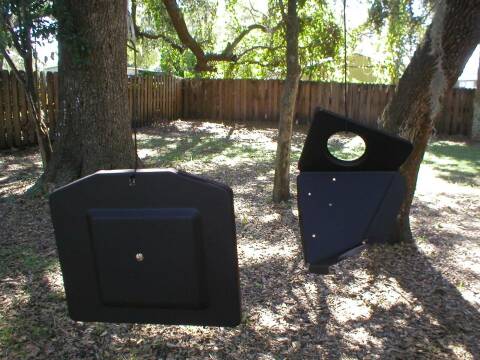

Next, I removed the stand and tray and painted the inside of the stand and the bottom of the tray with flat black. I felt that this would be a good color in case I ever decided to repaint the engine compartment.

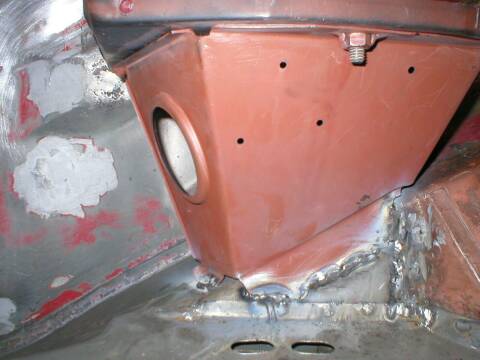

Now I ready to begin welding. I bolted the two pieces back together and placed them into position. I tack-welded them into position, then completely welded the two tabs that are connected to the frame rail. I decided not to drill holes and spot-weld, which some people do. I felt that I could get a better weld this way.

Next, I removed the bolt and the tray to be able to weld the inside tab to the frame rail.

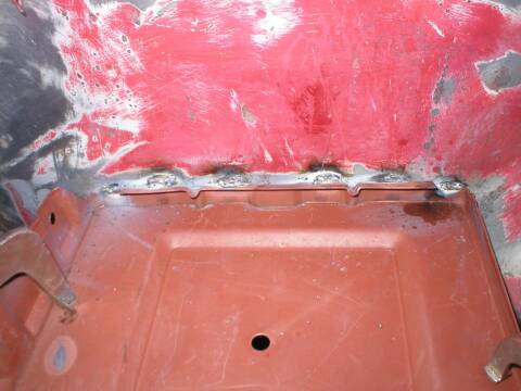

The final welding was done on the top. I welded the tray to the side of the fender well.

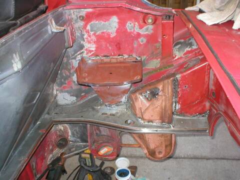

Here's my completed engine compartment improvement. It includes the new suspension ear, engine shelf and battery tray.

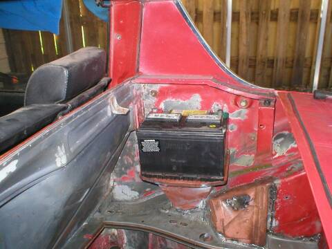

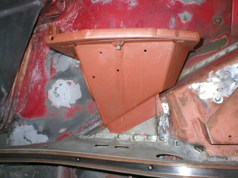

Finally, here's a shot of an old battery that I put in place to verify the position and the strength of the welds.
This is a very straight forward welding project that anyone can do, just remember, take your time. I probably spent 10x the amount of time fitting and/or grinding as I did welding.
I hope your project turns out as well as mine. Good luck.
