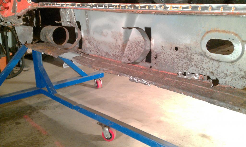

cary   I'm tearing into the drivers long. It's go...   Jul 23 2012, 09:51 PM
cary   Yes, I cut it open with a disc and a sawsall. I wa...   Jul 23 2012, 09:55 PM

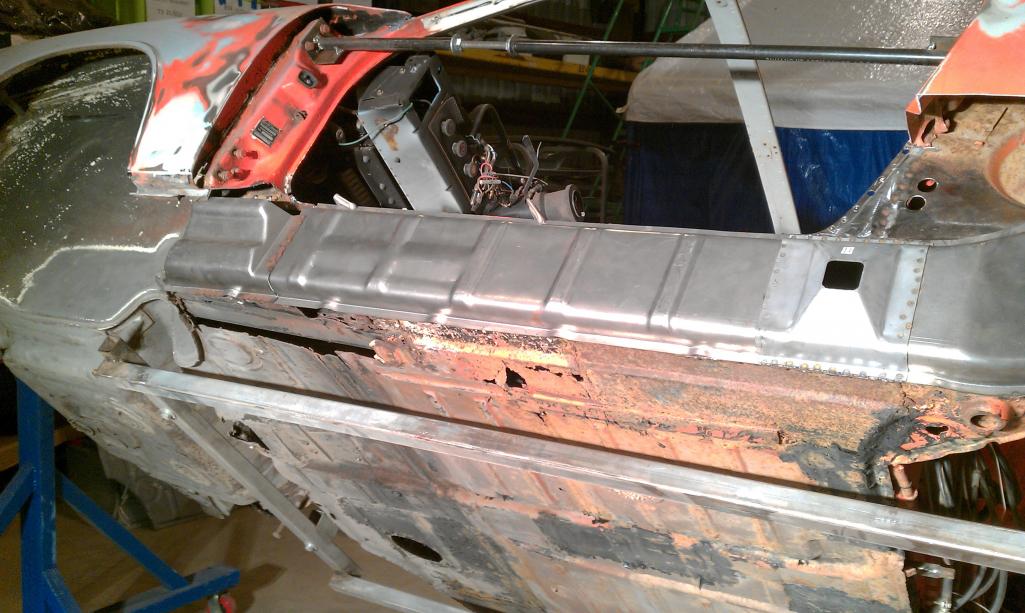

cary   Here's the long all gutted. Didn't have to...   Oct 18 2012, 11:21 AM
cary   Or just mix up some JB weld and we're good to ...   Oct 18 2012, 11:24 AM

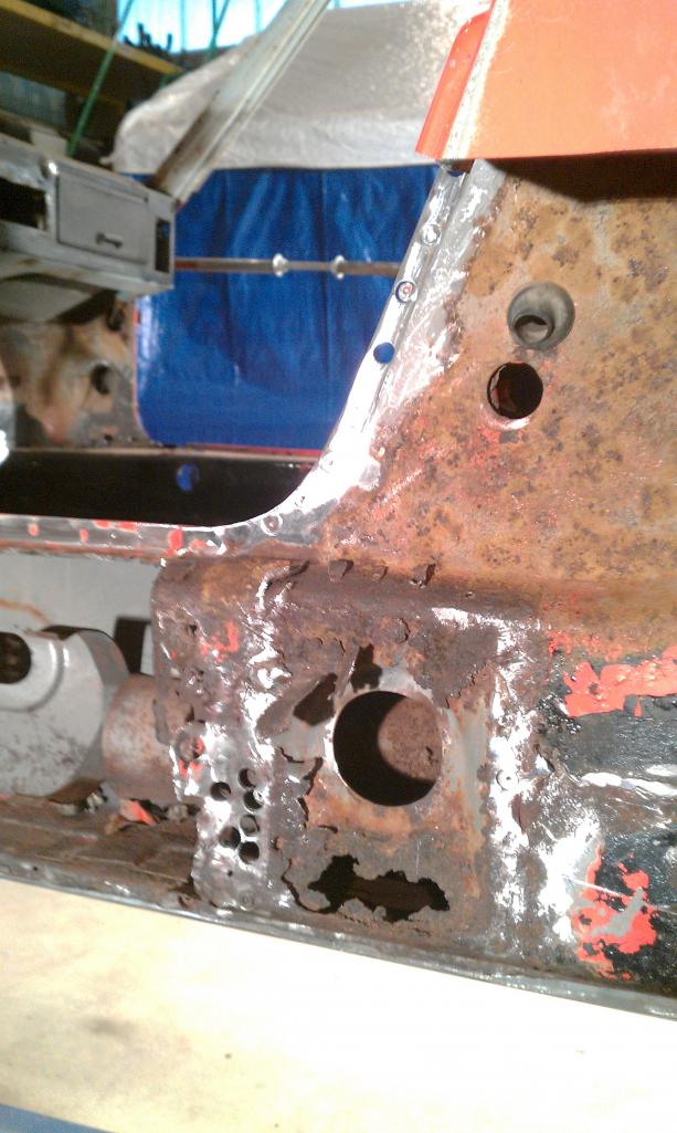

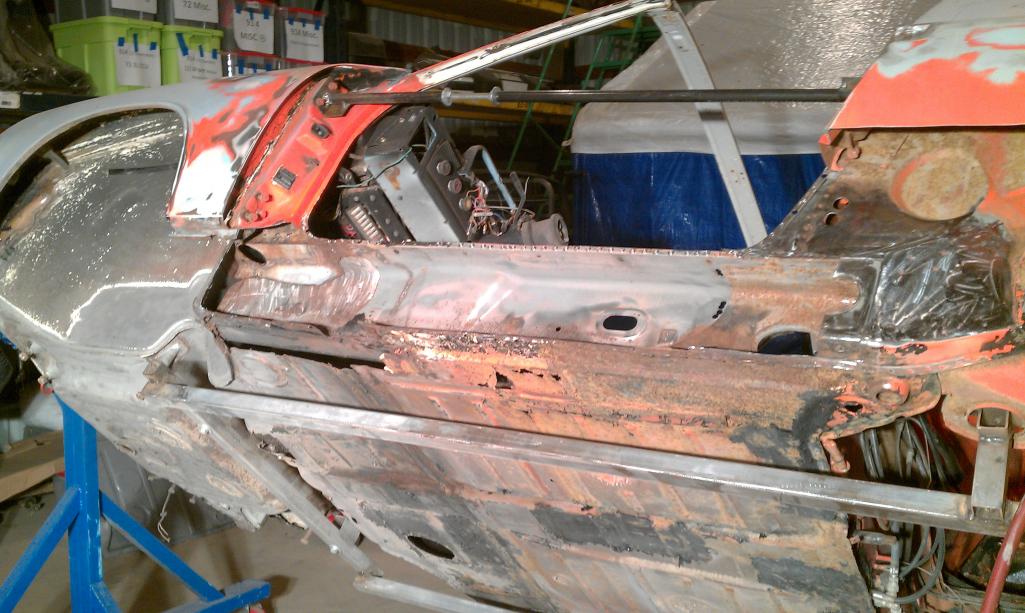

cary   Started by surveying the rust at both ends of the ...   Oct 24 2012, 08:24 PM
cary   Front end ............... Look what I found und...   Oct 24 2012, 08:27 PM
cary   Then I start the carnage ................   Oct 24 2012, 08:32 PM

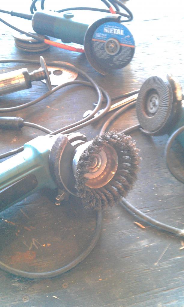

cary   Getting my moneys worth from my cutting wheels.......   Oct 24 2012, 08:38 PM
cary   First I cut off the bottom .............. Still...   Oct 24 2012, 08:55 PM
cary   Then you see where the day ended ................ ...   Oct 24 2012, 09:07 PM
cary   You can see in this picture our cheater bar. B...   Oct 24 2012, 09:24 PM
cary   As you can see the car isn't liking hanging up...   Oct 24 2012, 09:27 PM
cary   Here's a shot looking into the wheelhouse. Wha...   Oct 24 2012, 09:29 PM

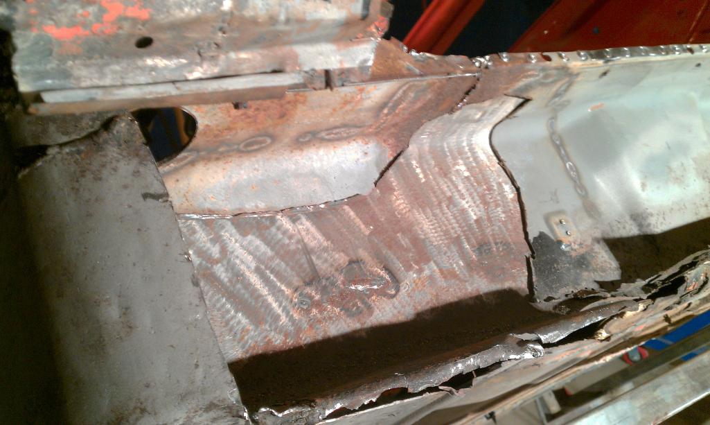

cary   The more I look at that drivers long. The more I...   Nov 11 2012, 11:04 PM
cary   Here's a picture of the panel spotter being ti...   Nov 14 2012, 08:12 AM
cary   I decided an amputation is in order. Heading to th...   Nov 18 2012, 09:43 AM

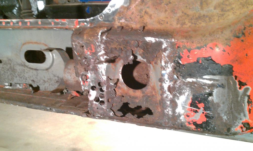

cary   Now for the bad news. I didn't look at the pas...   Nov 18 2012, 08:52 PM

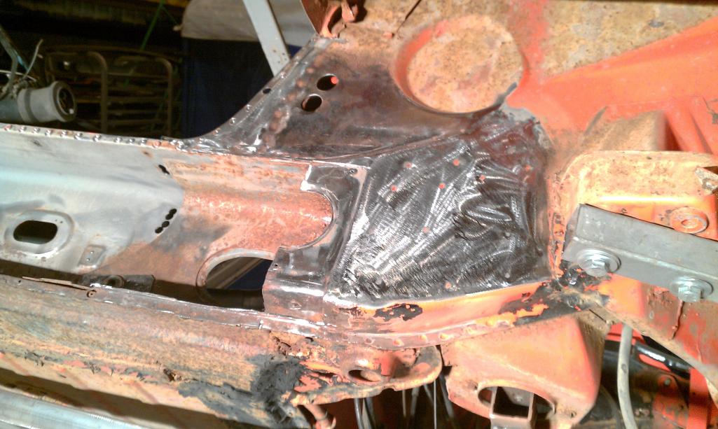

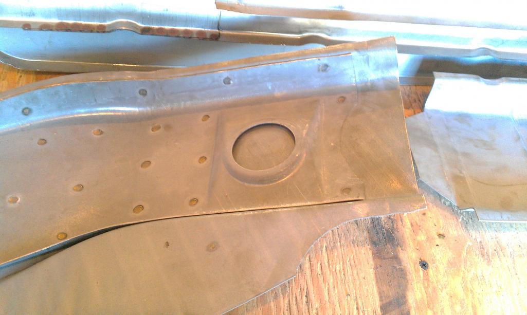

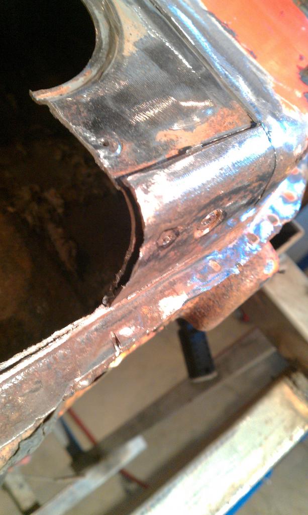

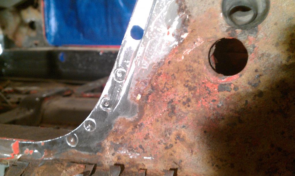

cary   So I moved on the recreating the bottom corner of ...   Nov 19 2012, 09:32 PM
cary   Here's where we start. This is going to tak...   Nov 19 2012, 09:37 PM
cary   Using some of Mark's work as a pattern. I...   Nov 19 2012, 09:41 PM
cary   First attempt with the shrinker we made the apex o...   Nov 19 2012, 09:46 PM

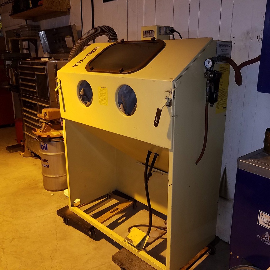

cary   The parts washer lives. Have a small leak at the p...   Nov 26 2012, 11:06 PM
cary   I guess its going to be a Popsicle. White with blu...   Nov 26 2012, 11:23 PM
cary   Well the heater elements work great. The turntable...   Nov 27 2012, 09:16 PM
cary   Steam coming out the vent pipe.   Nov 28 2012, 10:05 PM
