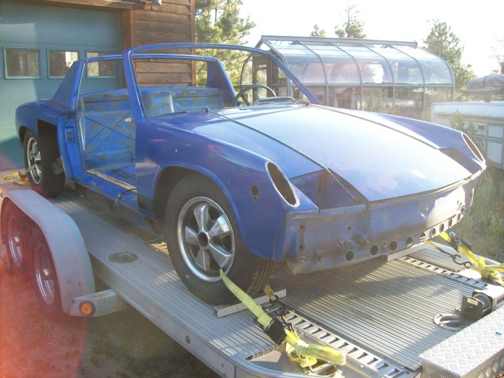

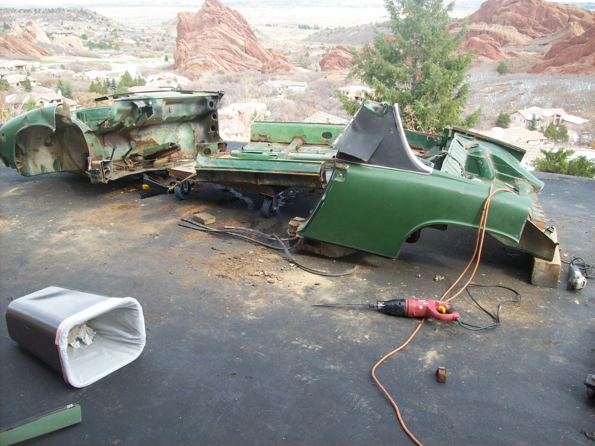

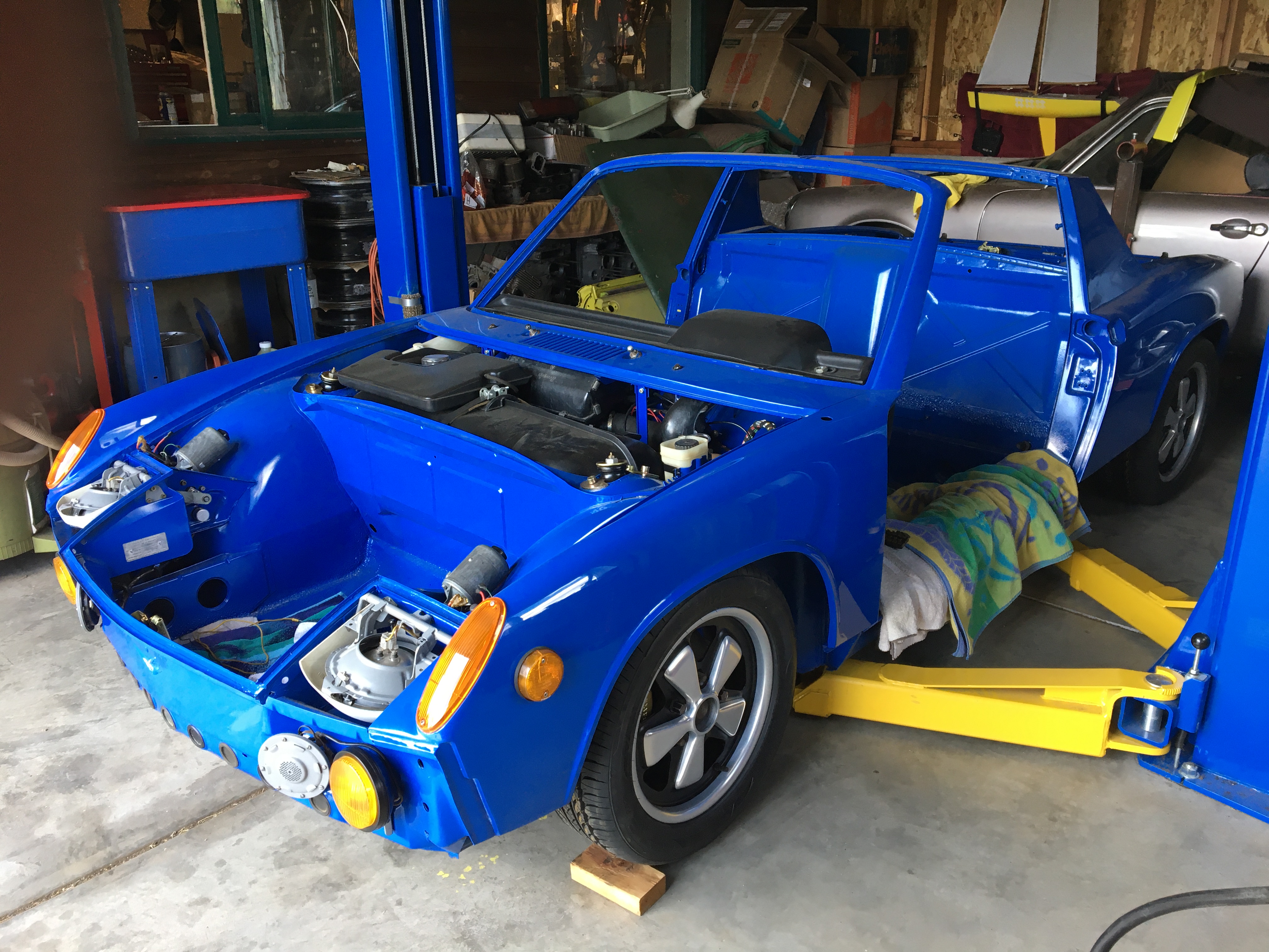

New to the board. Most of my work and experience is over on Pelican with 911 longhoods. I stalked a local PCA guy who was going to eventually sell his 914-6. No pressure, just every few months I let him know I hadn't forgotten. Finally got a chance to see the car in person three weeks ago. Passenger rocker issues as well as surface bubbling in a number of places. Car had been extensively autocrossed at PCA parades for years...very successfully. Owner had pulled the original 2.0 and replaced with a 2.7 RS spec engine with carbs. He bought another mid-engined car (boxster) and ignored the 6. I bought the car (w/ 2.7) and original engine. Got the 2.7 running well enough to drive the car...and decided to dive into the resto. I am familiar with rust, and plan to do it correctly. I have a rotisserie with 911 mounts, but shouldn't be a big deal to make mounts for the 6. Made a couple calls to Resto Design to check on parts...and away I go. I have a 71 911 softie that has been at paint too long...so while I wait for it to come home, thought I would see what my sandblasters schedule was. Turns out he can do the car in two weeks. So, I have a deadline. So...I guess this is my resto thread on my new Adriatic Blue 6...

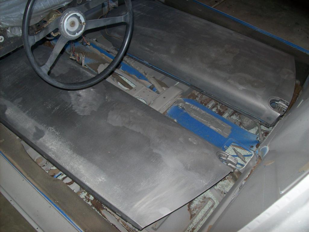

I took a few hours Friday afternoon,a couple yesterday, and a few more today. Almost ready for the blaster
yuck...passenger side. Drivers side looks ok. Before you question...yes I do have some hell-hole issues.
More later...
Speedo

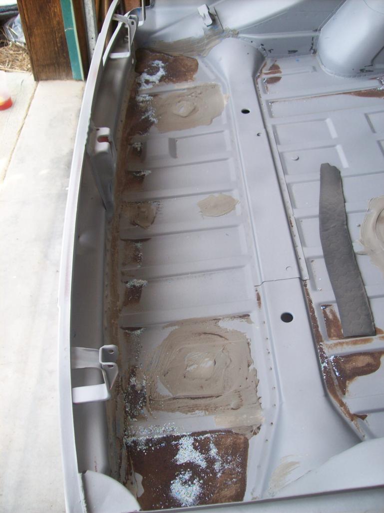

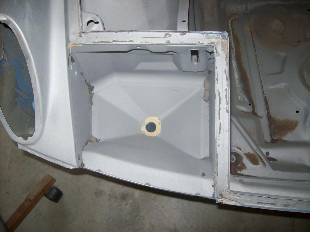

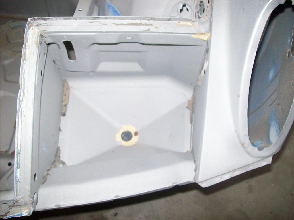

wachospeedo   Couple more...the hell hole. Hopefully after blast...   Jun 12 2012, 07:30 PM

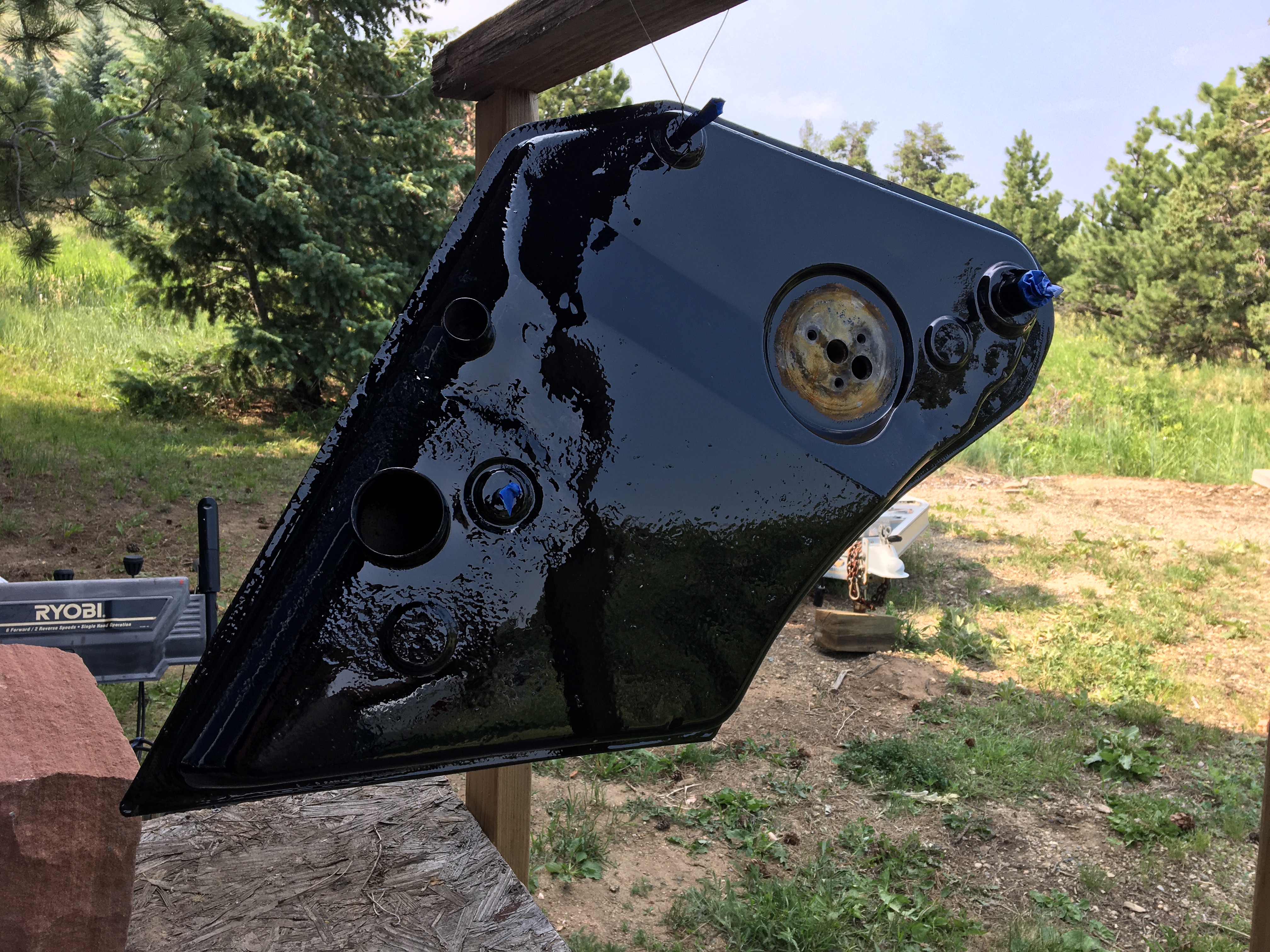

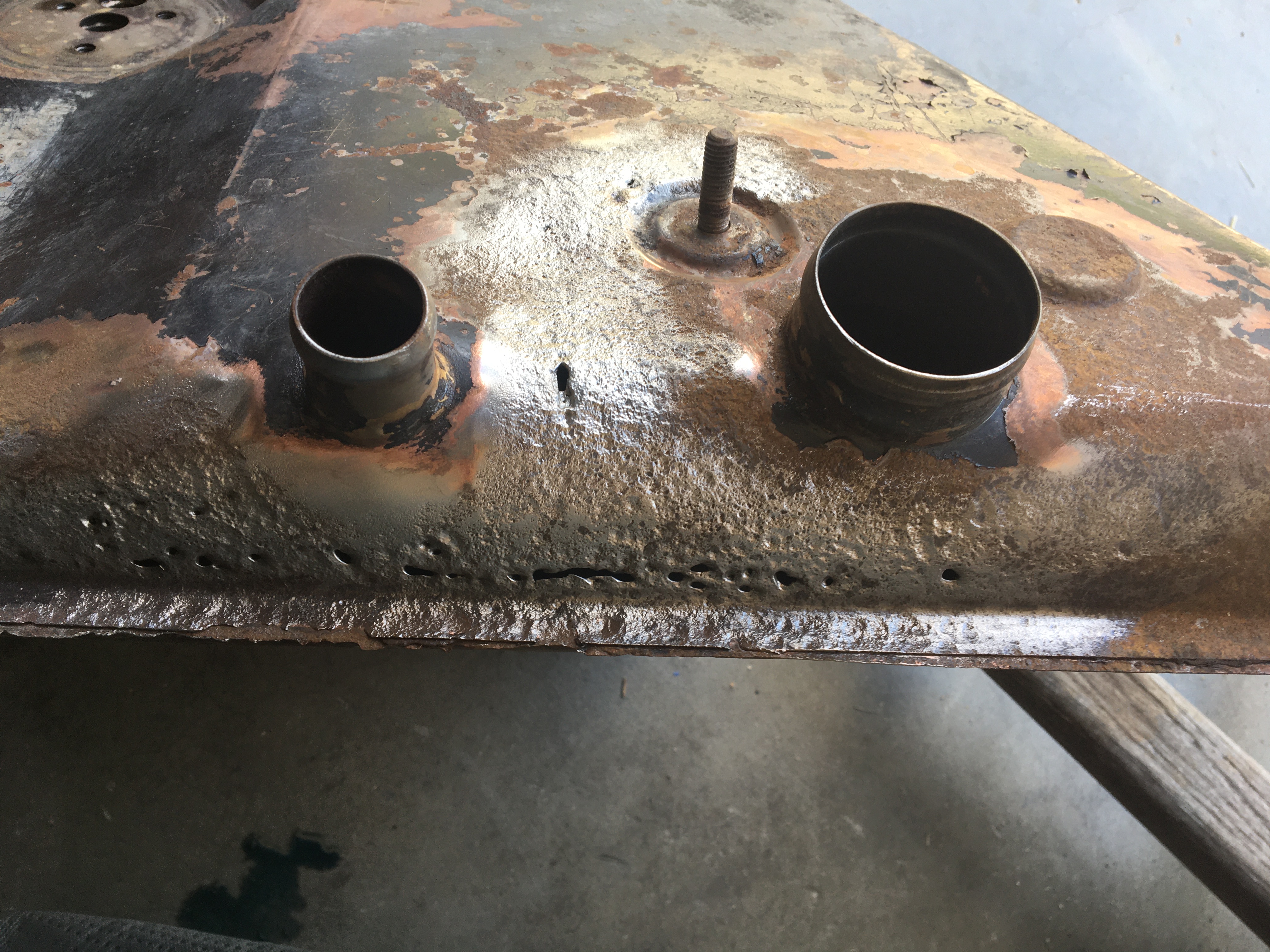

brant   pull that oil tank before it goes to the blaster.....   Jun 12 2012, 11:01 PM

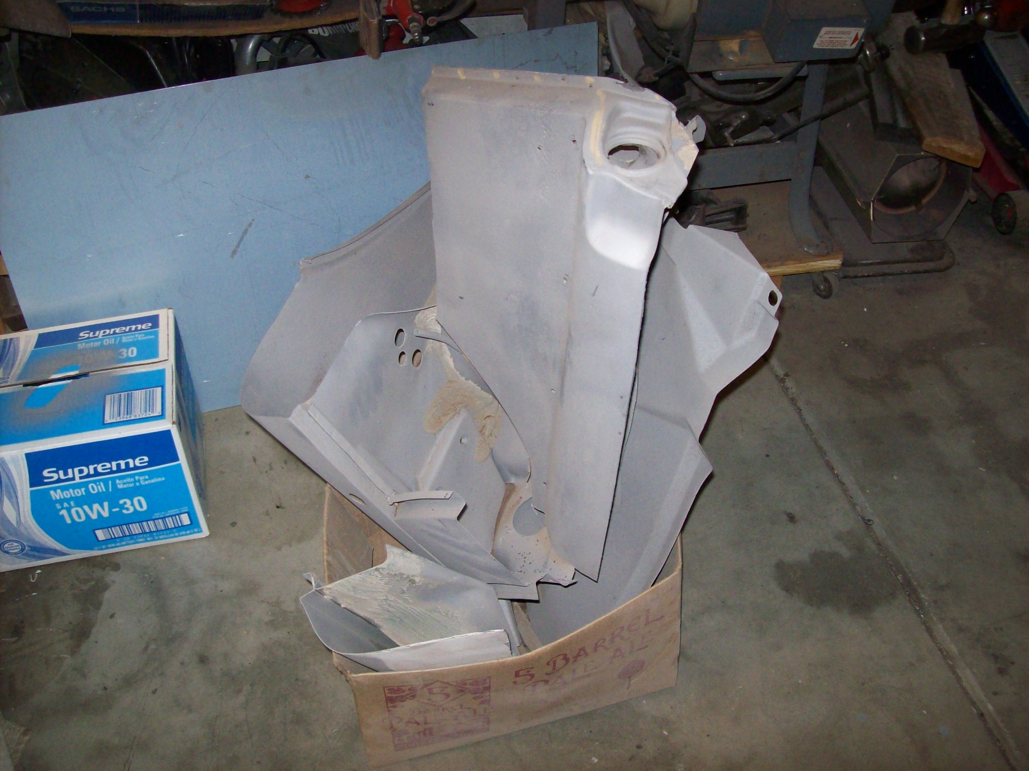

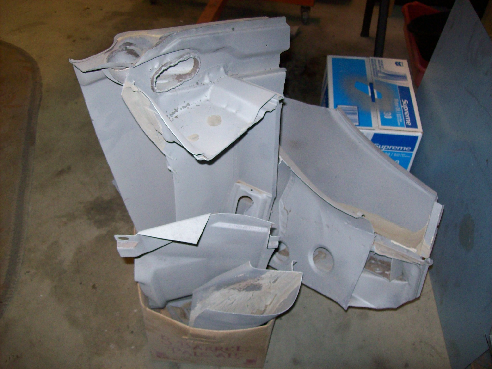

wachospeedo   More prepping for sandblaster. Removing the oil ta...   Jun 18 2012, 06:52 PM
wachospeedo   Moving on...This all obviously is bye bye I atta...   Jun 18 2012, 07:11 PM

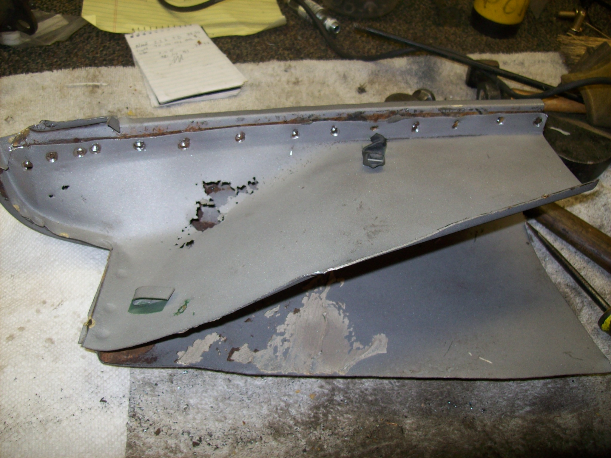

brant   Nice job.... time to cut that front fender off... ...   Jun 19 2012, 04:53 PM
914Sixer   Looking good !!!!   Jun 19 2012, 07:37 PM

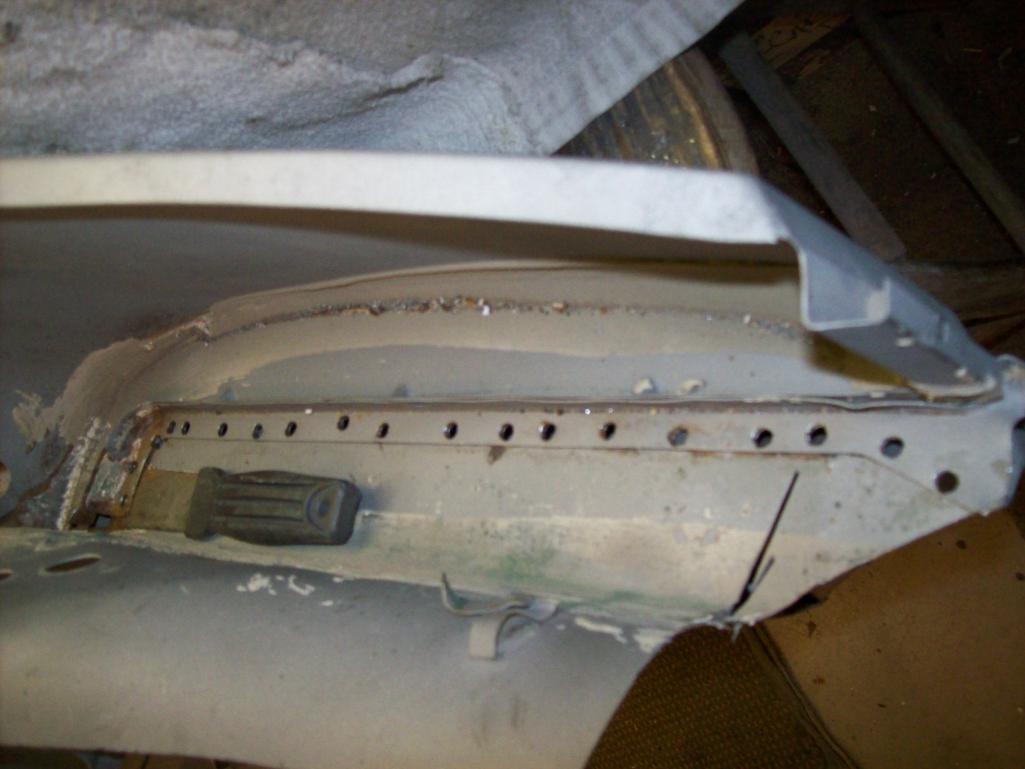

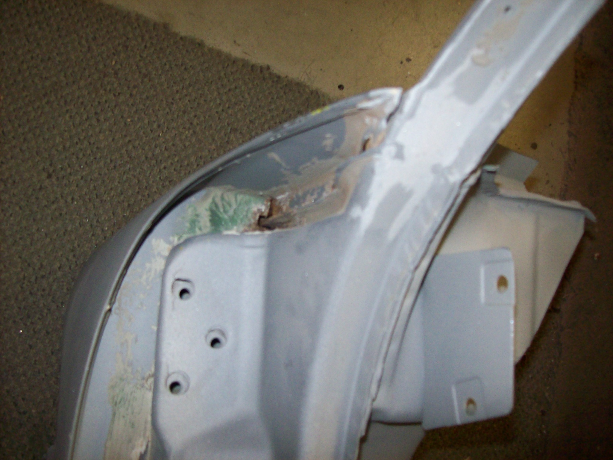

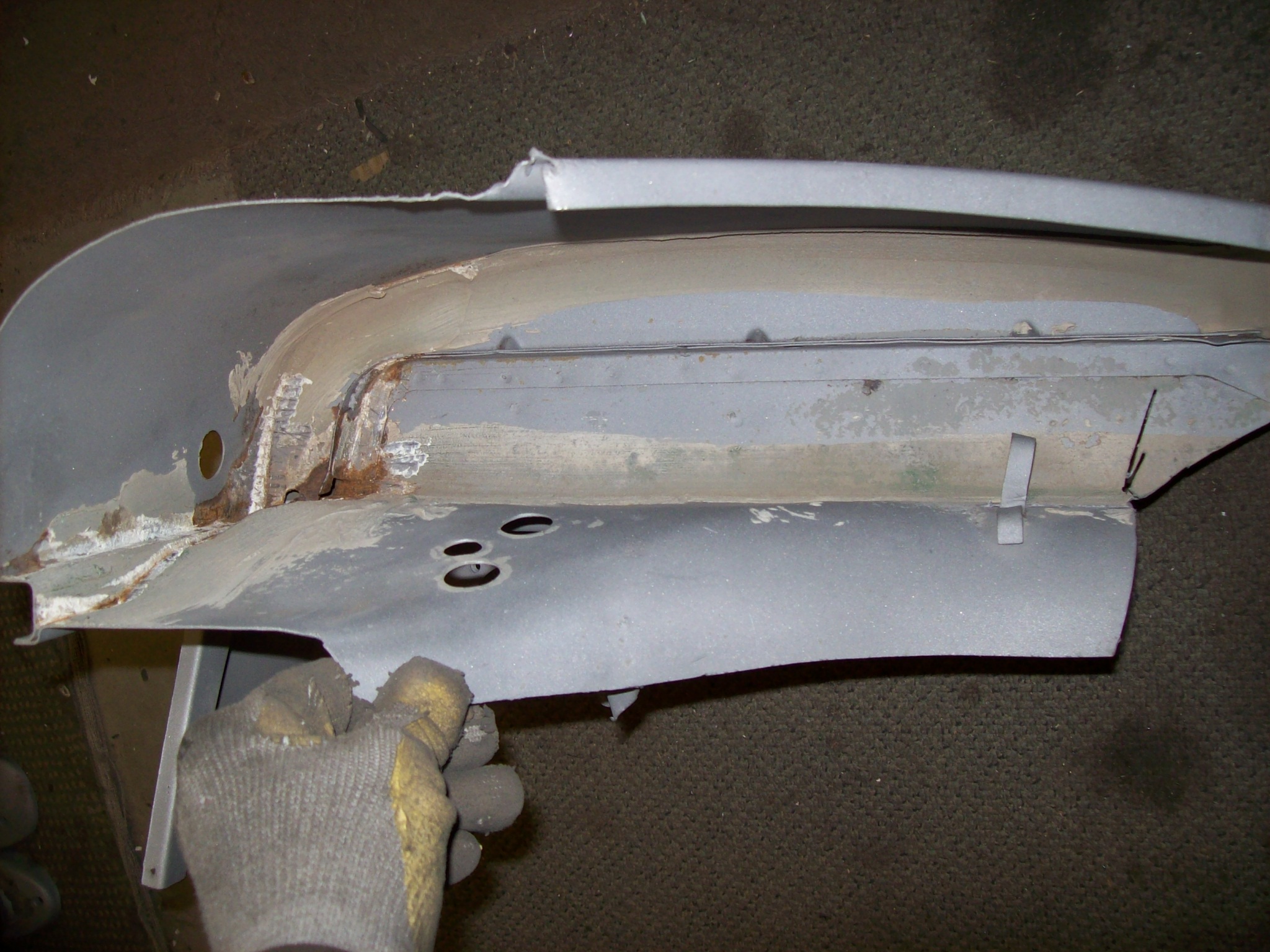

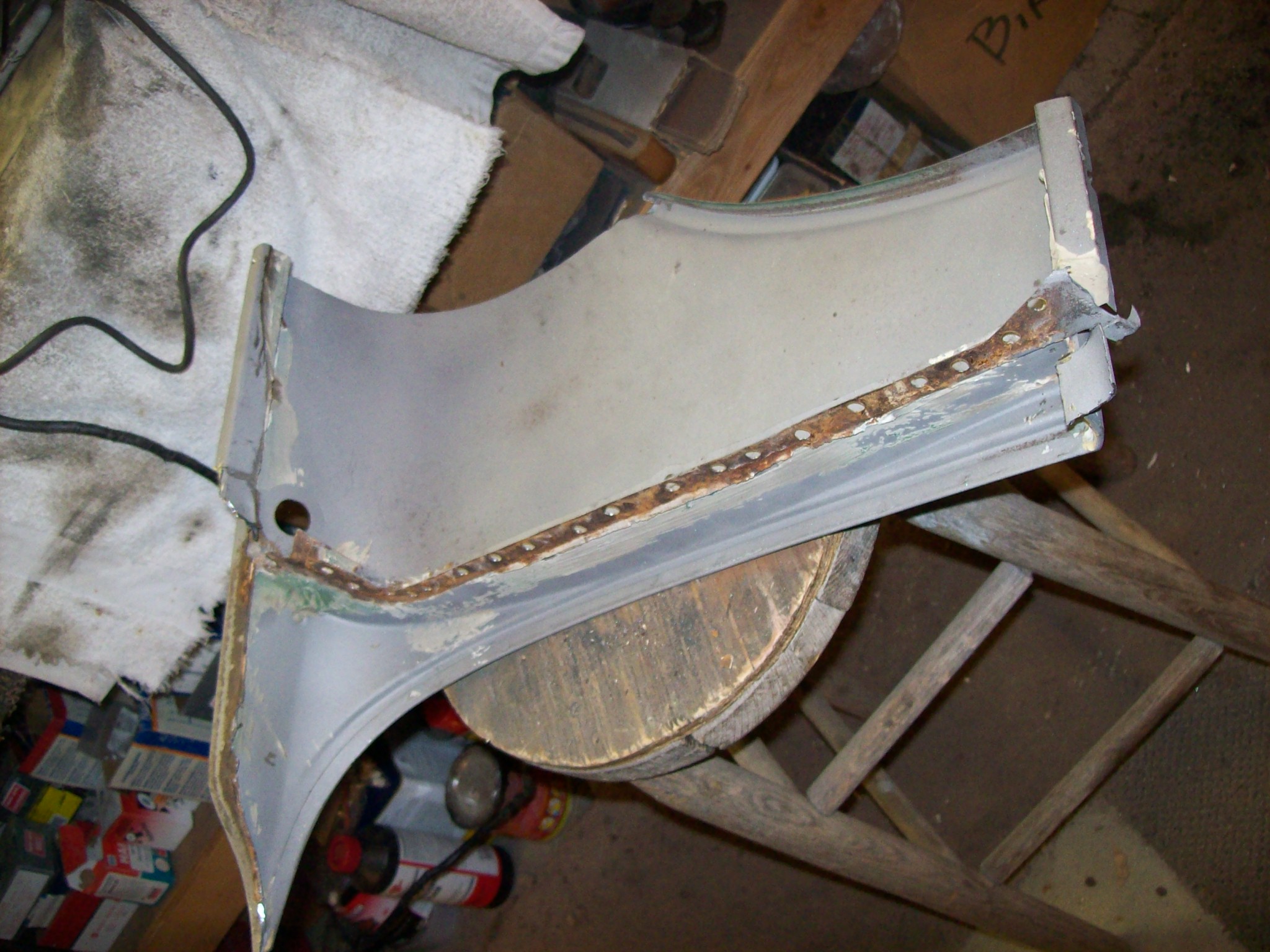

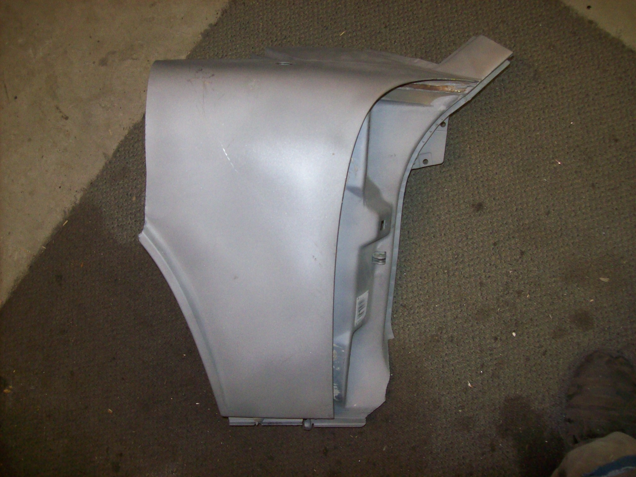

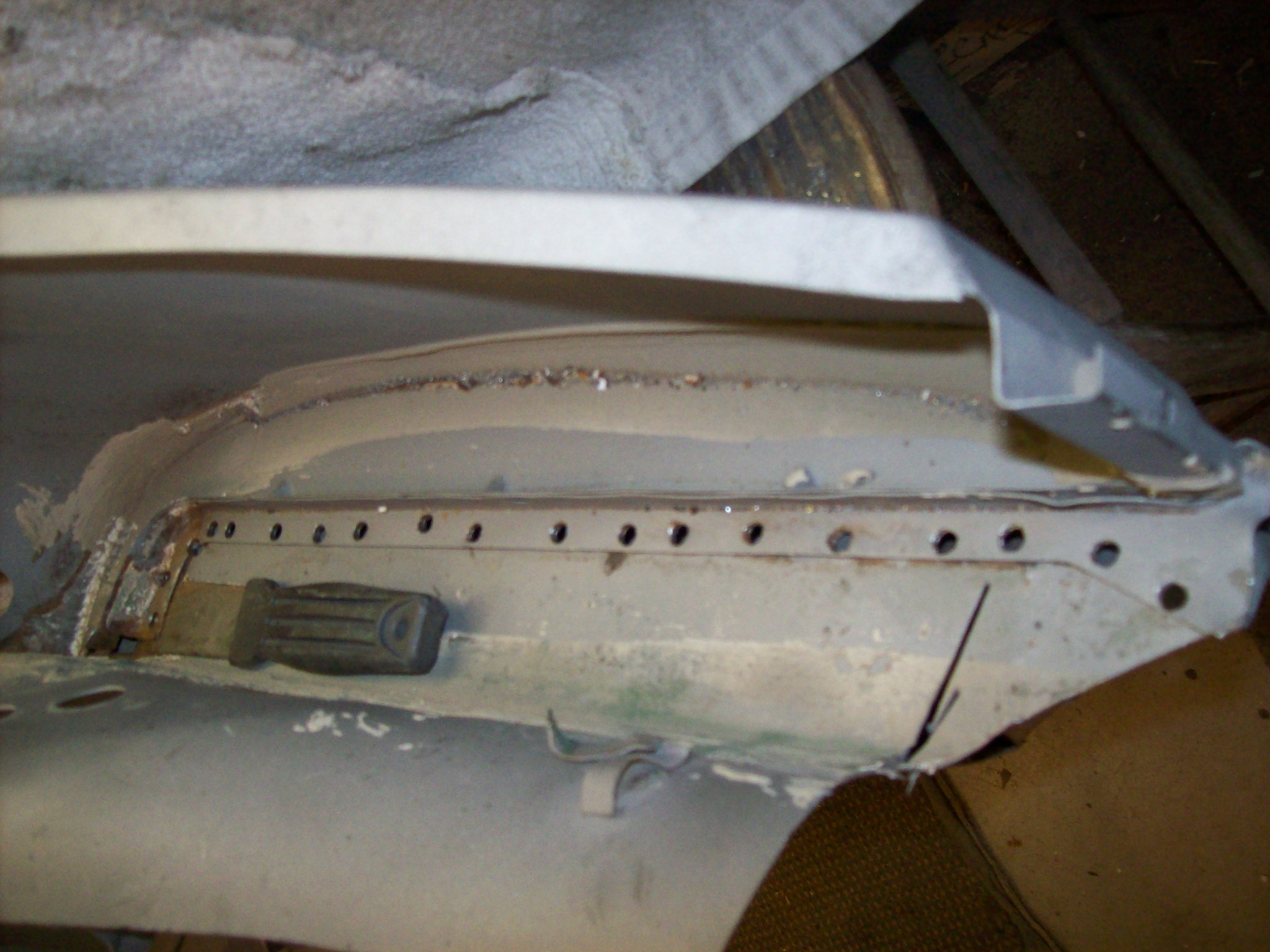

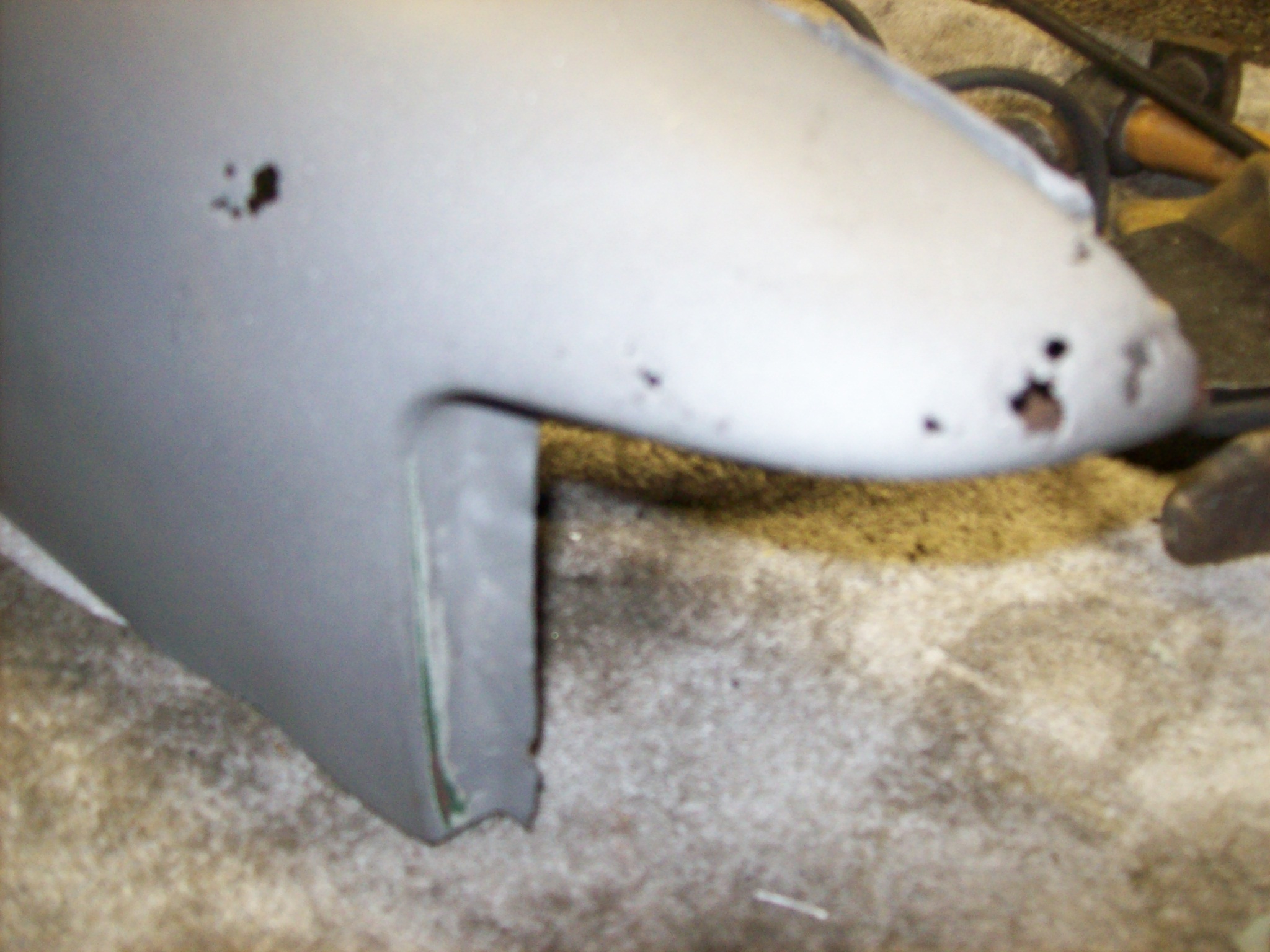

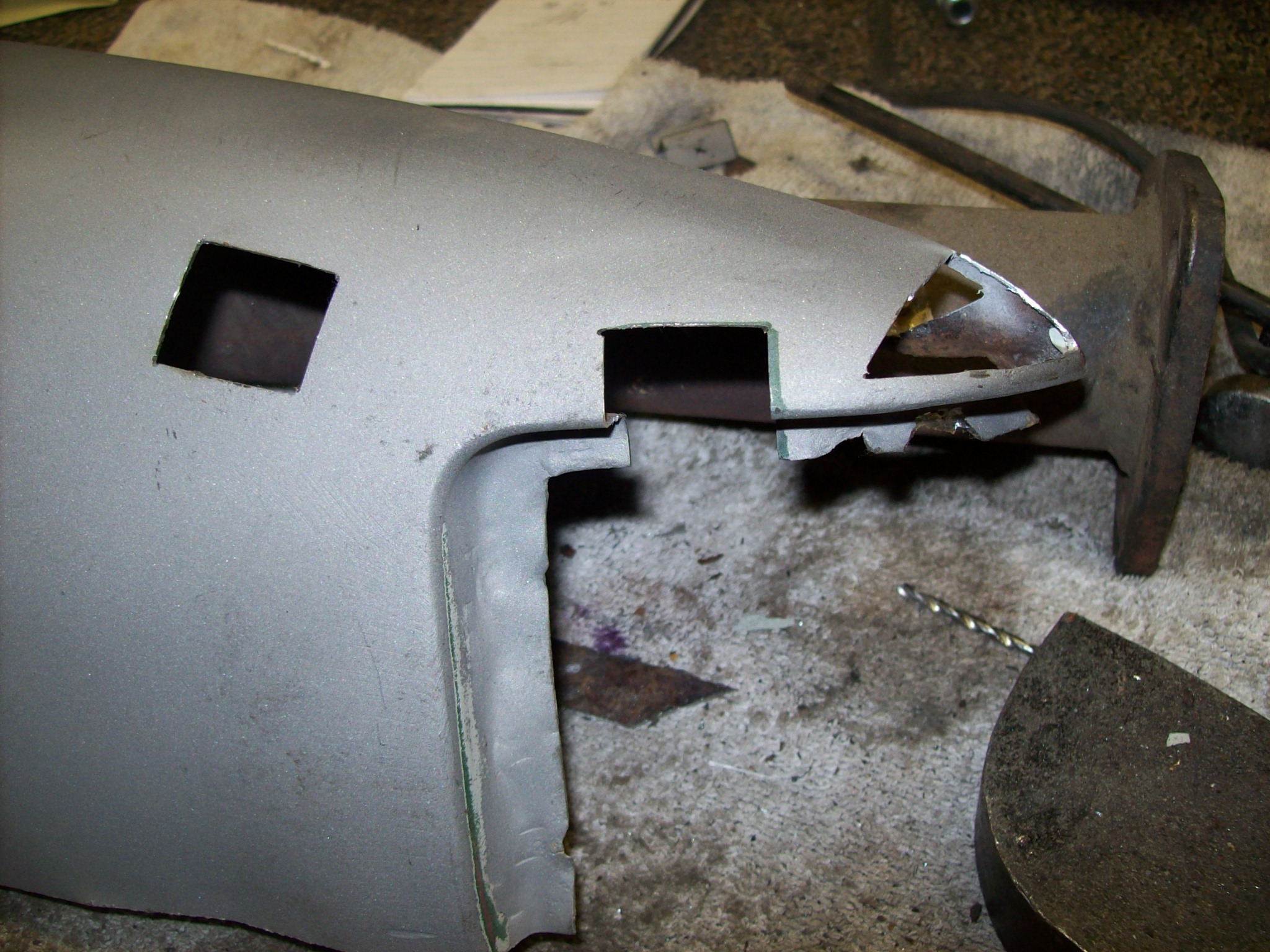

wachospeedo   Ok Brant... Marching orders...cut the bad out befo...   Jun 20 2012, 08:25 PM

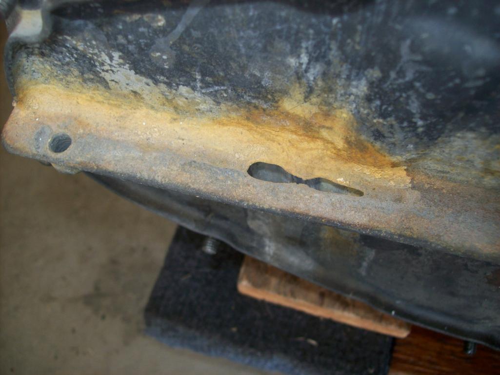

wachospeedo   One more view of the perforations in the lip next ...   Jun 20 2012, 08:38 PM
brant   you're moving much too fast to be a real 914 g...   Jun 20 2012, 08:57 PM

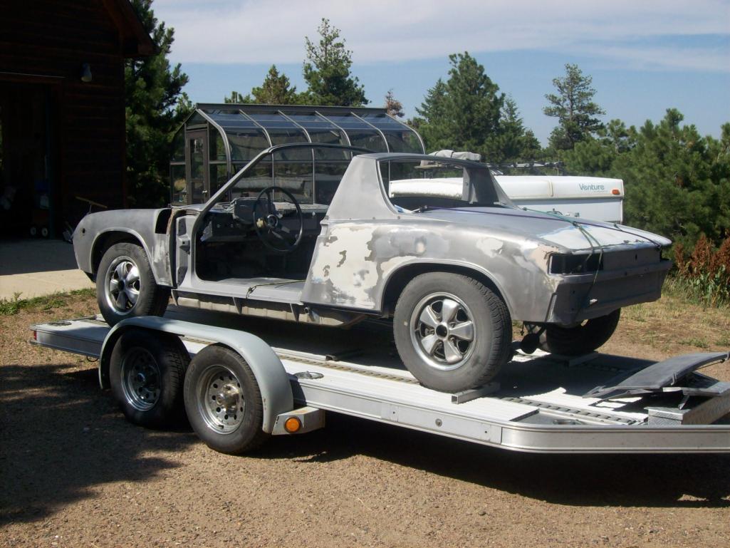

wachospeedo   Packed up and ready to go. Trunk is full of small ...   Jun 22 2012, 03:46 PM

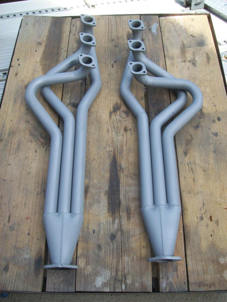

wachospeedo   Spent a couple hours going through by baggies of p...   Jun 24 2012, 06:22 PM

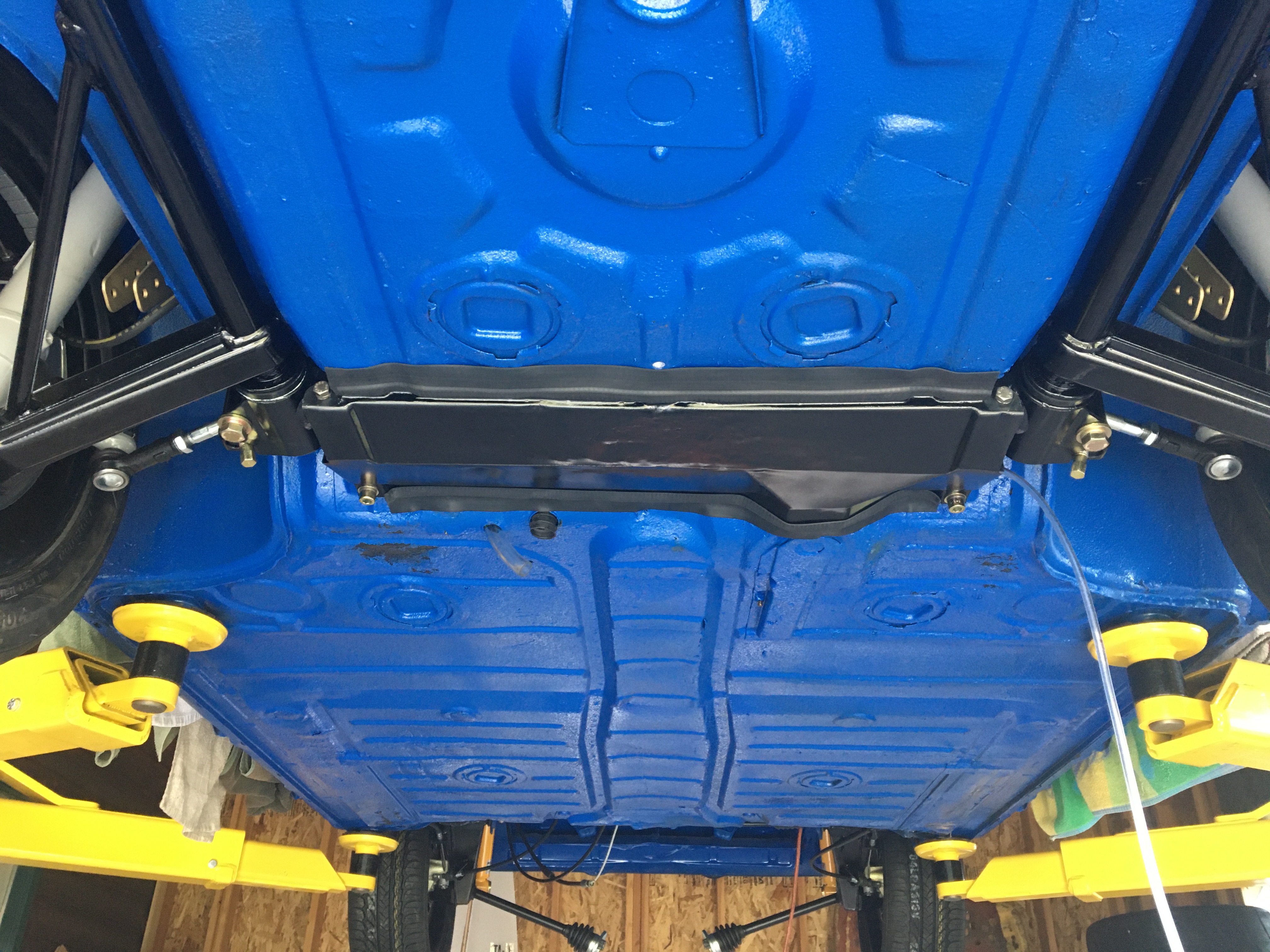

wachospeedo   Clean continued.... Now for something complet...   Aug 12 2012, 07:21 AM
Cairo94507   Very nice chassis. I hope mine looks reasonably c...   Aug 12 2012, 07:53 AM
brant   Nice progress car is good when do you need help l...   Aug 12 2012, 08:10 AM
wachospeedo   The "unwashed"...the worst first I ...   Aug 12 2012, 09:43 AM
wachospeedo   Instead of "the corner workers", these a...   Aug 12 2012, 09:50 AM
wachospeedo   I ordered a big batch of repro steel from RD with ...   Aug 12 2012, 10:05 AM
wachospeedo   Braces going together...trial fit I had to use a ...   Aug 12 2012, 10:16 AM

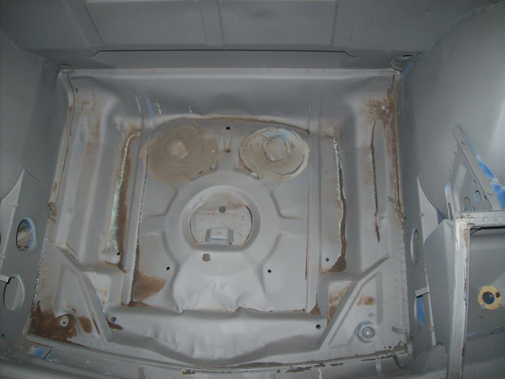

wachospeedo   I needed to massage a few front trunk areas while ...   Aug 12 2012, 10:31 AM

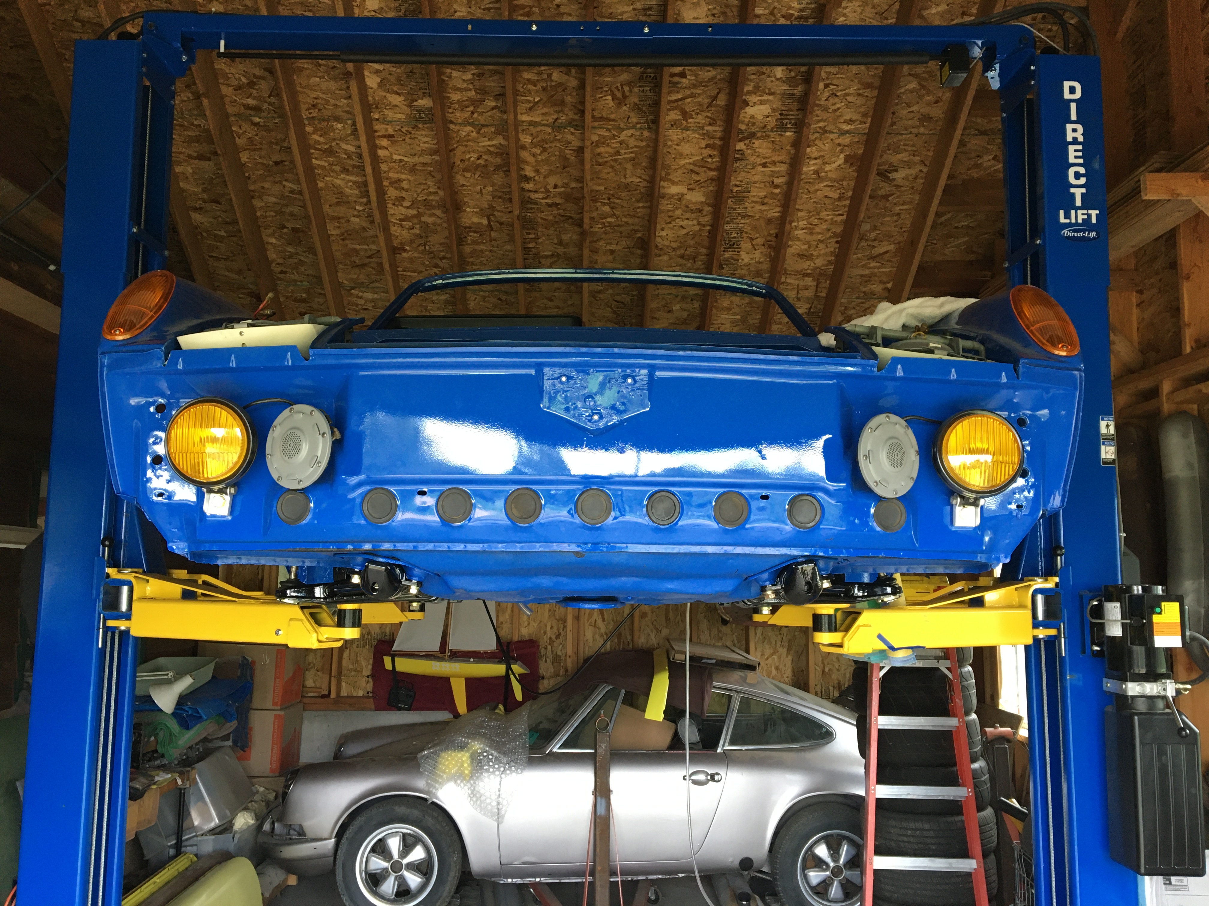

wachospeedo   Crap! I rolled my car! So not claiming t...   Aug 12 2012, 10:54 AM

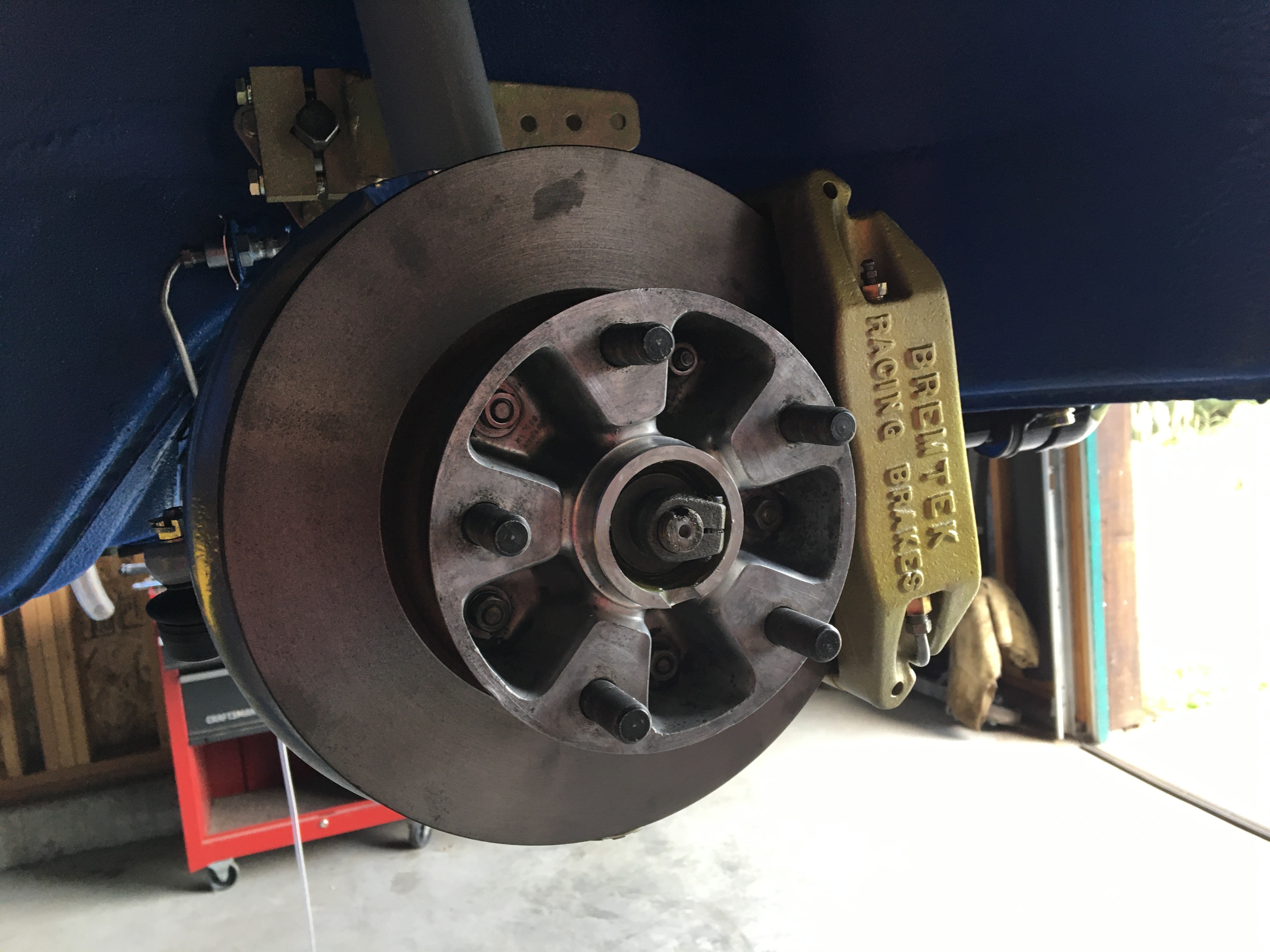

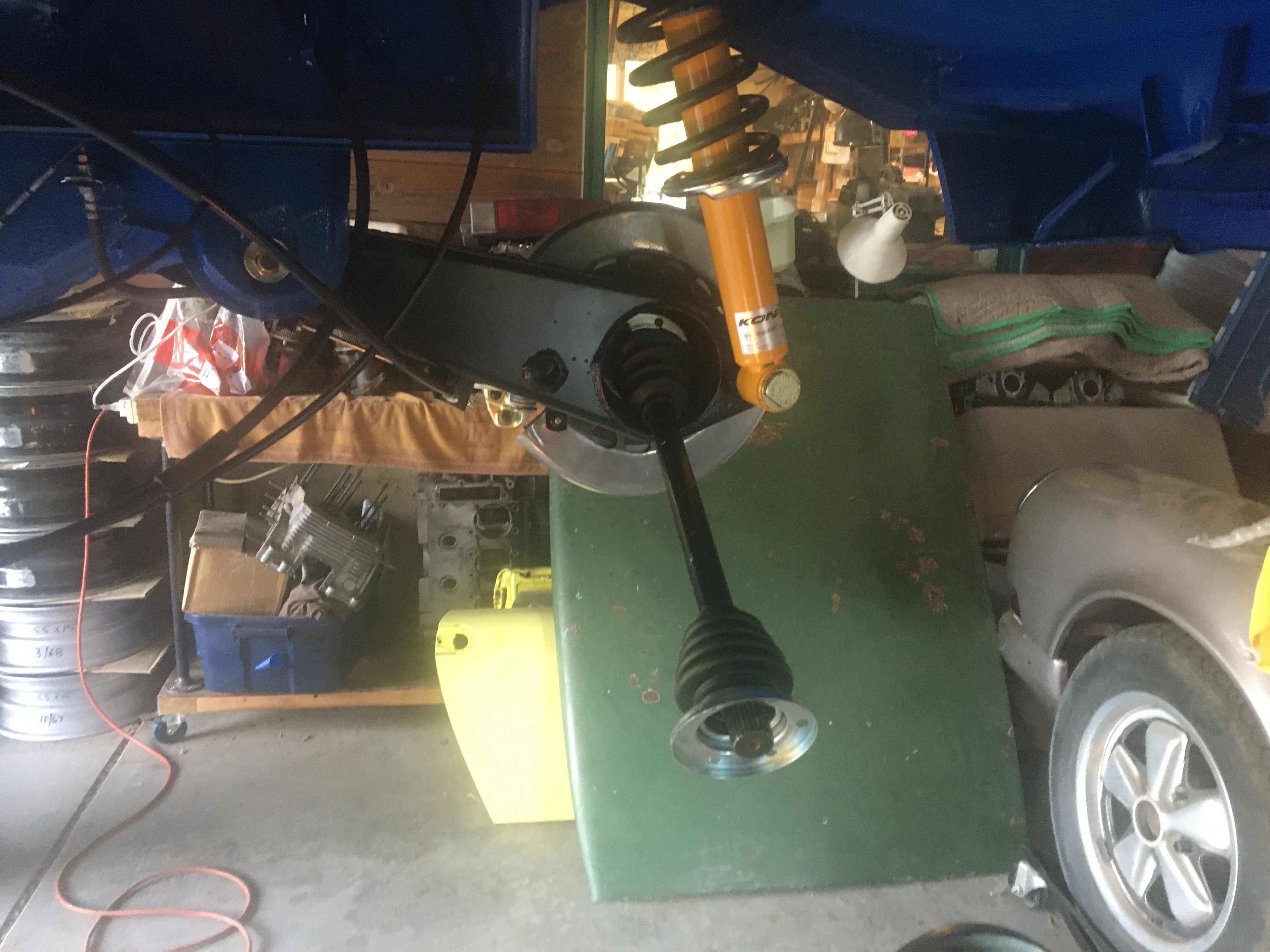

wachospeedo   Front suspension first. Nice to have easy access t...   Aug 12 2012, 11:06 AM
wachospeedo   My next concern was whether or not the remaining b...   Aug 12 2012, 11:20 AM
sixnotfour   Boge are Grey on sixes,   Aug 12 2012, 11:31 AM
wachospeedo   Long days work...but it feels good to get the car ...   Aug 12 2012, 11:37 AM

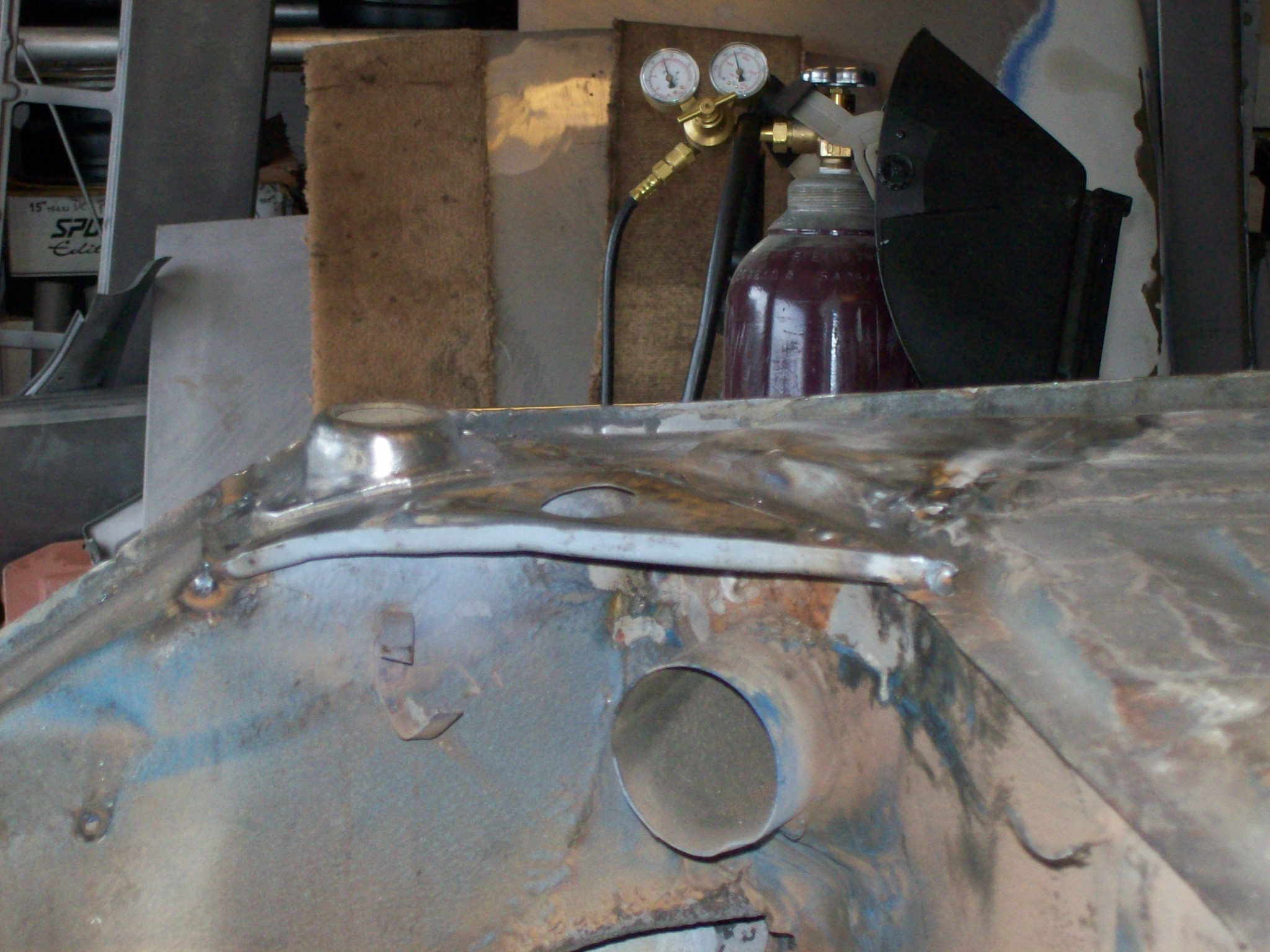

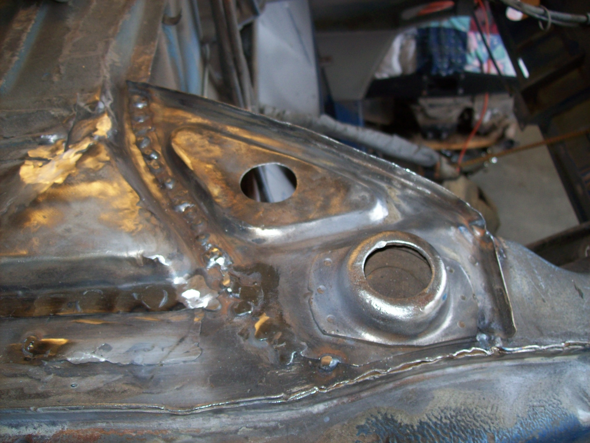

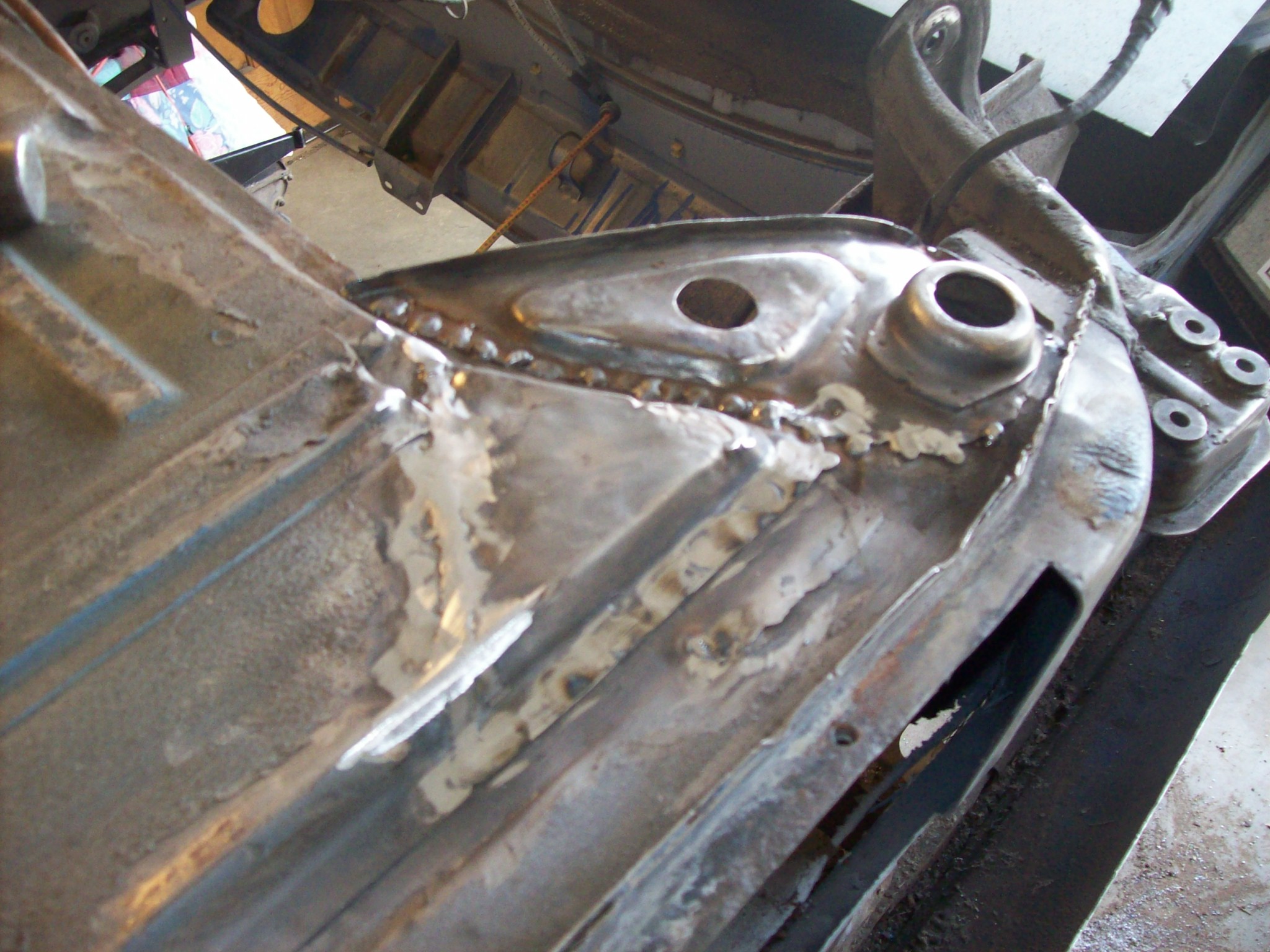

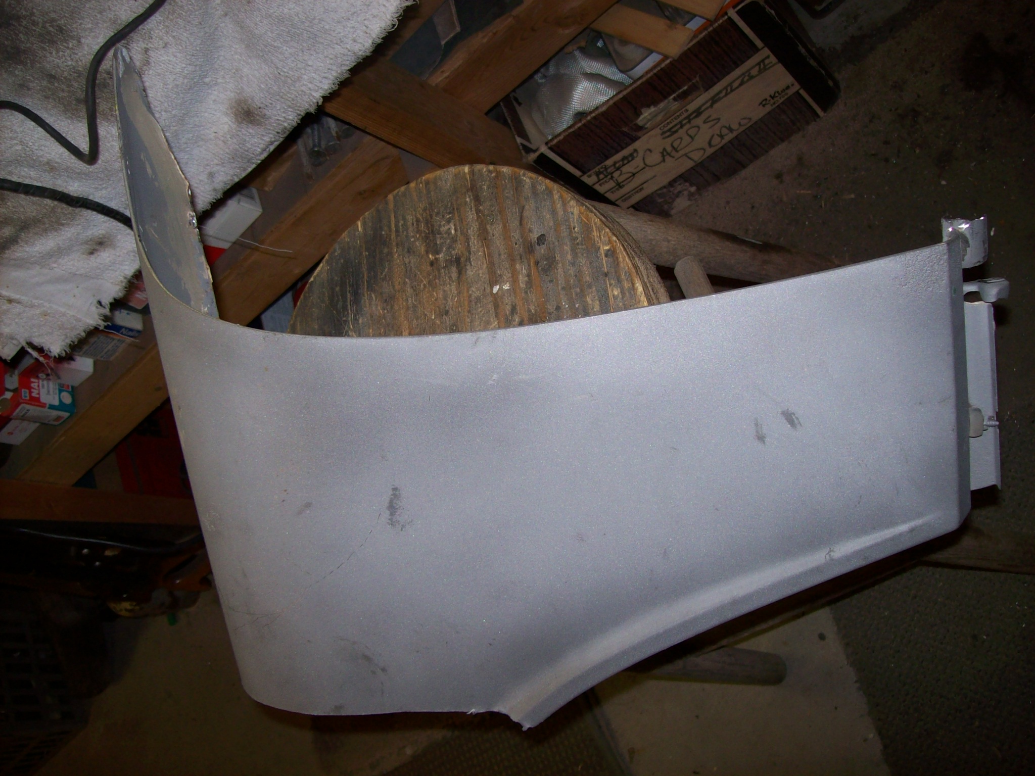

Speedo   I was going to start hammering on the front end to...   Aug 19 2012, 07:10 PM
Speedo   I like the fab work...so we start. Peter's par...   Aug 19 2012, 07:18 PM
Ferg   Nice Lars :welder:   Aug 20 2012, 02:43 PM

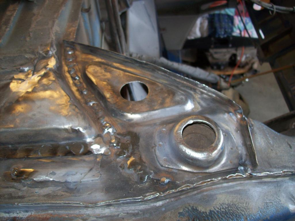

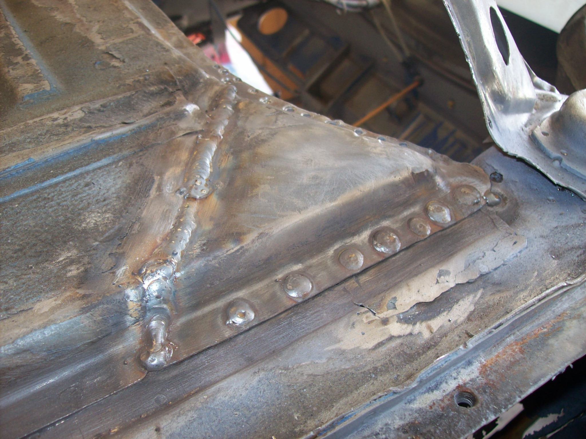

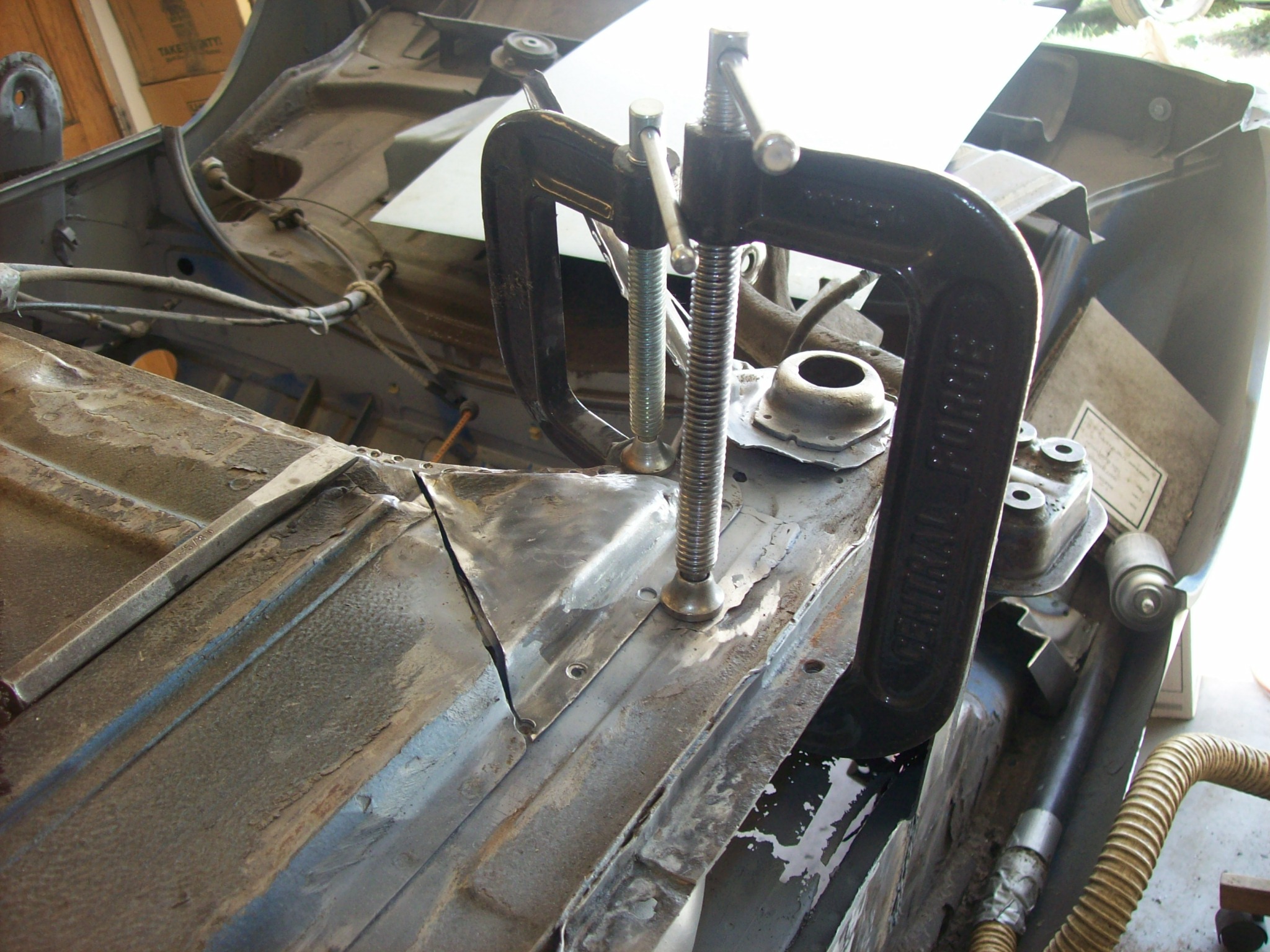

Speedo   Pretty straightforward....cut and fit and repeat. ...   Aug 20 2012, 08:11 PM
Speedo   My front A-arms didn't want to give up the t-b...   Aug 20 2012, 08:46 PM

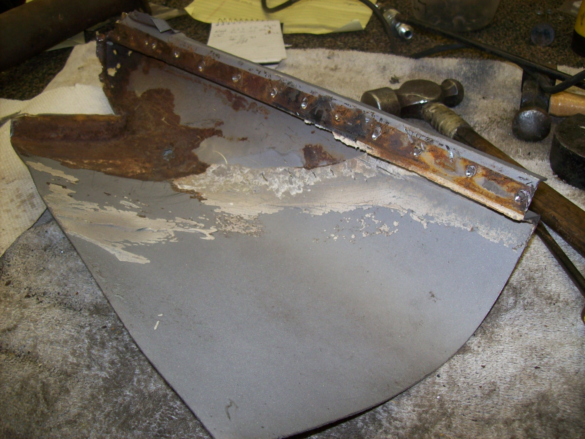

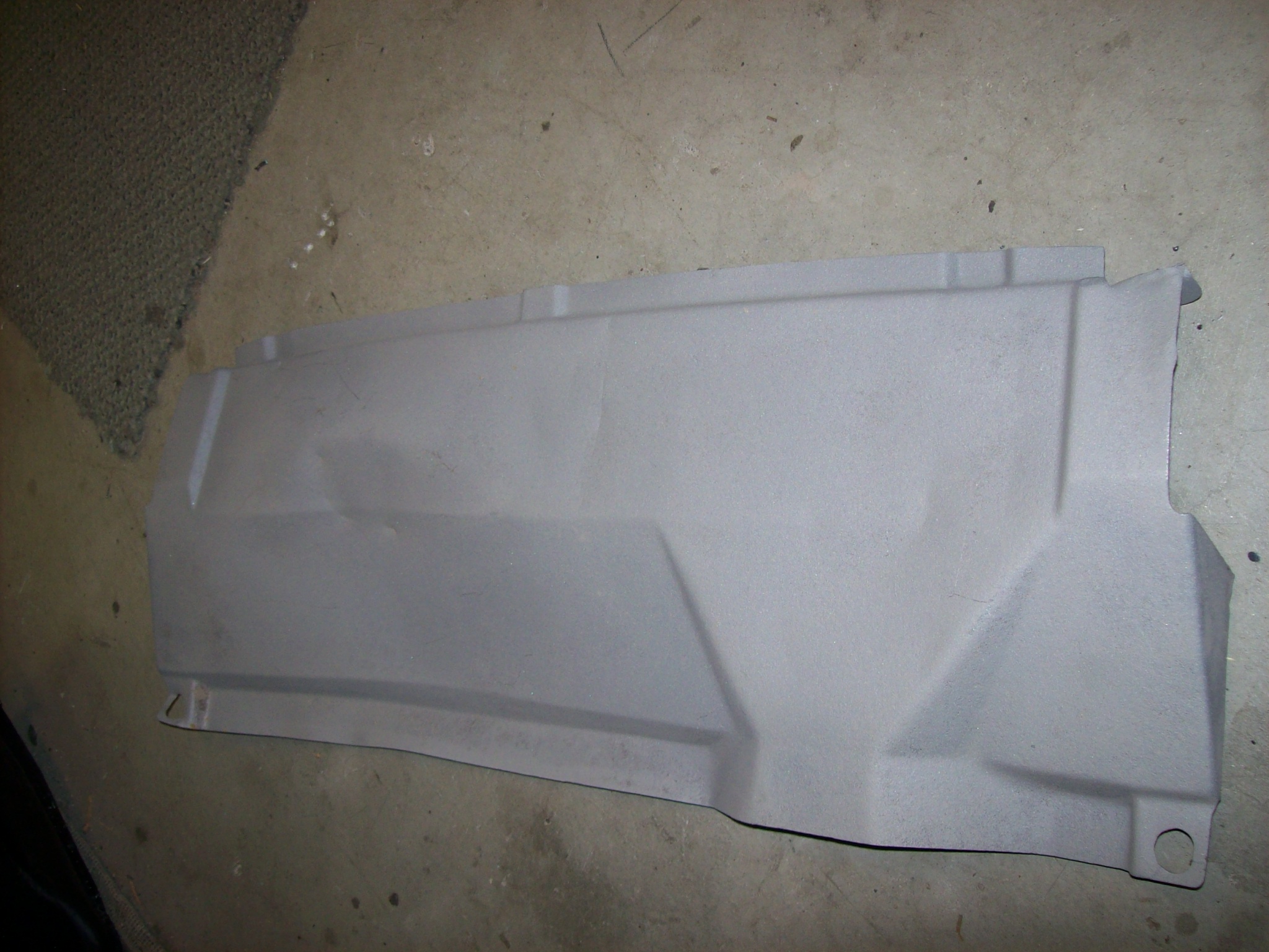

wachospeedo   I needed to beat on something this weekend. As it ...   Aug 27 2012, 05:24 PM
wachospeedo   This is going to take some time...lots of big dama...   Aug 27 2012, 05:35 PM
Scott S   Wow Lars - looks fantastic. You guys should se...   Aug 27 2012, 05:40 PM
wachospeedo   And the finished product... Beats replacing the e...   Aug 27 2012, 06:09 PM
