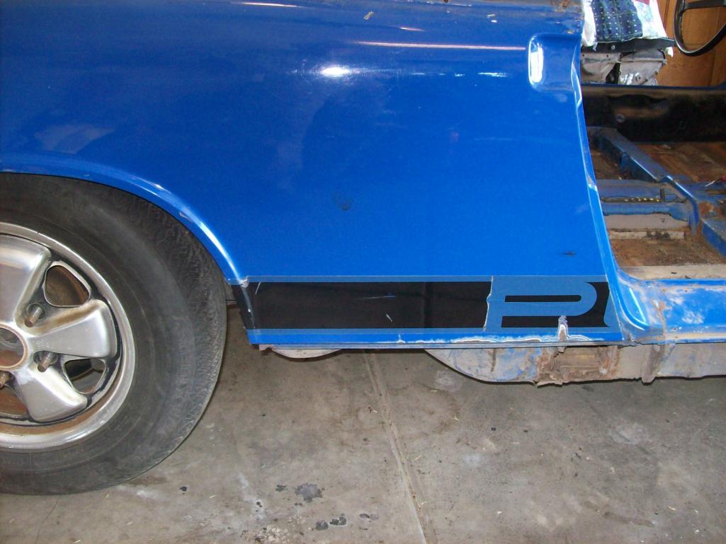

I am going to pickle the correct 2.0 and store it...sorry for the PMs about parting with the original engine. I will do a leakdown and a top-end probably on the 2.7. The engine was having a hard time transitioning from idles to main jets. I blew the jets and added clean gas, but it still wanted to stay under 2500-3000 rpm. I will likely keep the carbs on the 2.7 and rebuild them (as I am a carb guy), but I also have a 2.4 S MFI setup as an option.
Yeah that POS aftermarket mirror was on the car when I bought it...actually it was one of the first things I took off the car. Why to people yank nice OEM mirrors and put $7.99 Pep Boys mirrors on their cars? Brant and ferg came up to look at the car after I brought it home and noticed a bunch of things about the car that were not correct (read funky). Here are some better pics of what I have to work with. Damn...sorry about the sideways pics. I tried to rotate them before posting, but they didn't stay that way. Still getting used to the posting format.

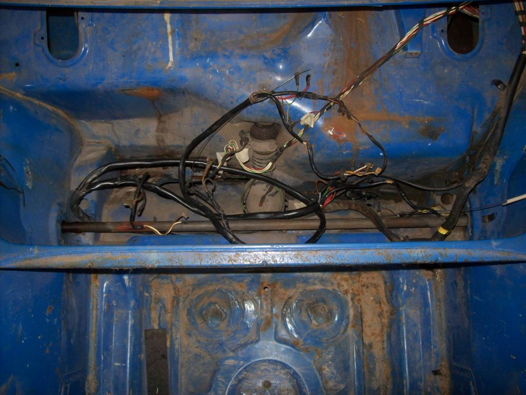

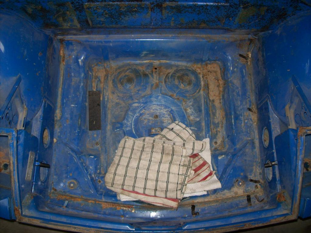

More prepping for sandblaster. Removing the oil tank...how come nobody warned me about this? What a mother! All the inside fittings were a piece of cake. The bottom oil line is close to impossible to get off while the oil tank is under the fender. I was going to dremel the line off, as it was the only thing prohibiting the tank from being removed...but I'd hate to find out after the fact that it was one of "those" lines that are beaucoup expensive. Impossible to get a wrench up in there to get the fitting off. I managed to get the thing out...
This was the culprit
Gutted the rest of the engine compartment and found more not so great hell hole news...no big deal, I sort of expected it.
Ground out the old battery mount. It was actually factory steel, but a hack job of installation
Oh well...resto-des has all my parts

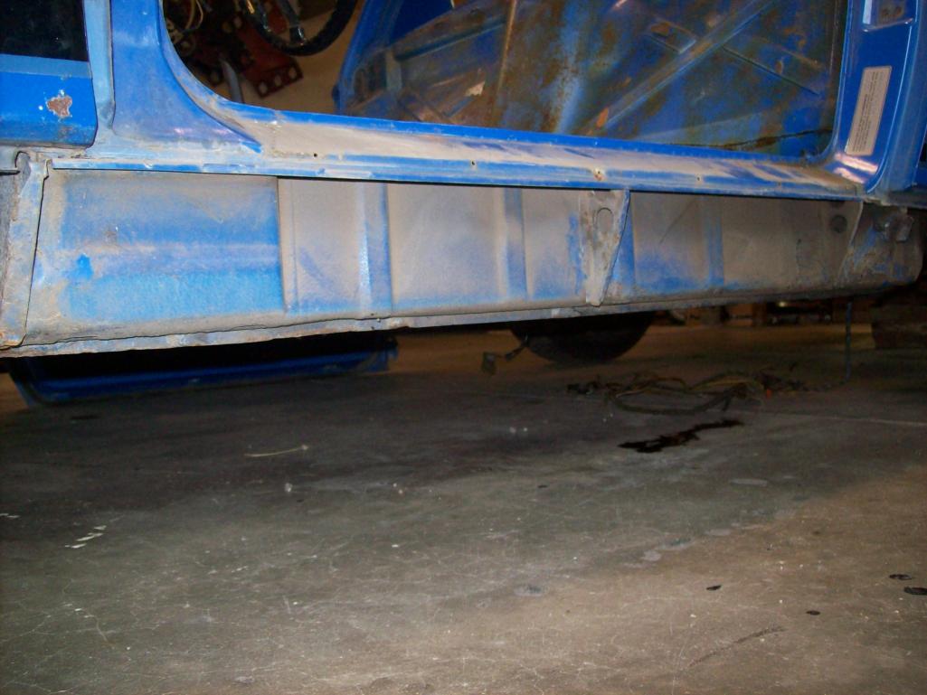

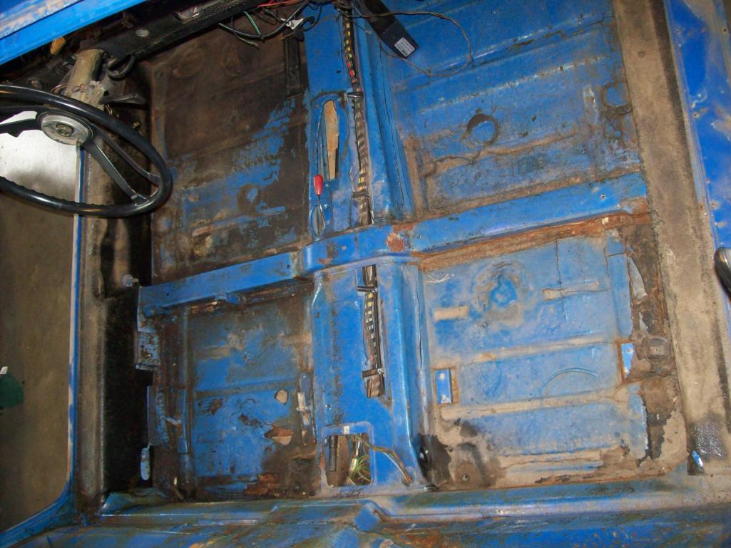

Moving on...This all obviously is bye bye
I attacked the floor sound insulation as I figured the sandblaster wasn't going to be able to blast through it. There is a technique. The floors are oxcidized, but I think they will blast clean. Must have been 15-20 lbs of this stuff.
This area is all bagged up and ready to go
My Porsche pickup truck...
Speedo

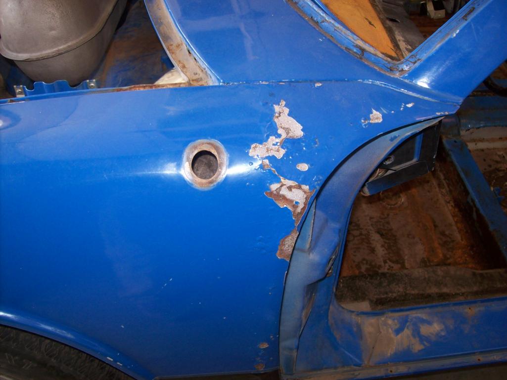

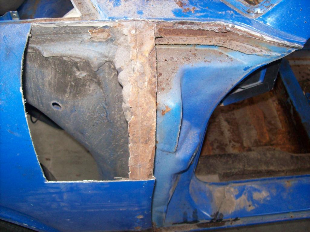

Ok Brant...

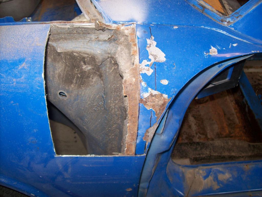

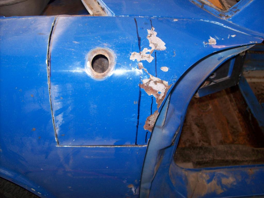

Marching orders...cut the bad out before the sandblaster. So I have two specific areas that are going to need to be very exposed to the media (not the paparazzi).
I need to cut back on the tail of the fender to clean up what is underneath....mark and cut
The damage is worse than was apparent from the first pic...but not so bad from here. We'll wait to see what things look like back from the blaster
wachospeedo
post Jun 20 2012, 08:38 PM
Post #39
Unregistered
One more view of the perforations in the lip next to the bonnet
Now on to the quarter panel...that by the way is in decent shape. So yes, I am going to hack off a perfectly good quarter panel, just to gain access...and give the sandblaster access to the hell hole. First cut is the deepest...
What have I done???
This will get blasted better and more deeply. We'll get good access to the hell hole and inner fender.
So the car is ready to be loaded up. I disassembled the pedal cluster to add to the small parts box to include to get blasted. Wiring harness is taped off and I didn't bother to protect the original palstic fuel lines as they will be yanked and replaced with steel once the car is back and on the rotisserie. Here we go...
