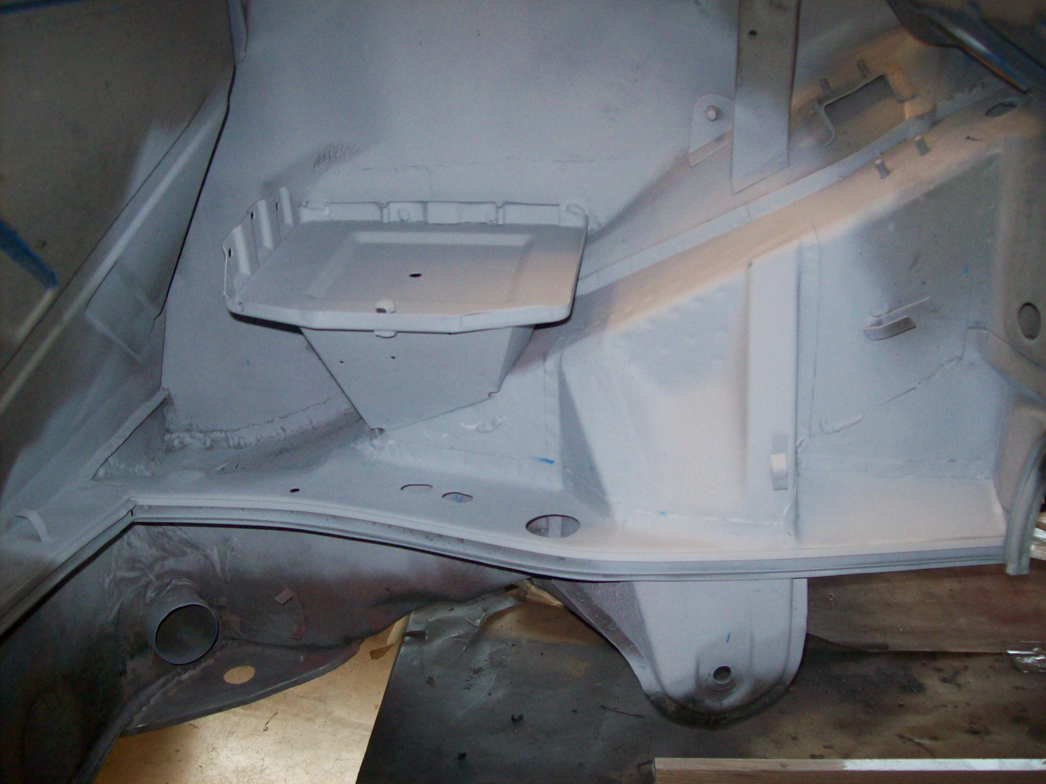

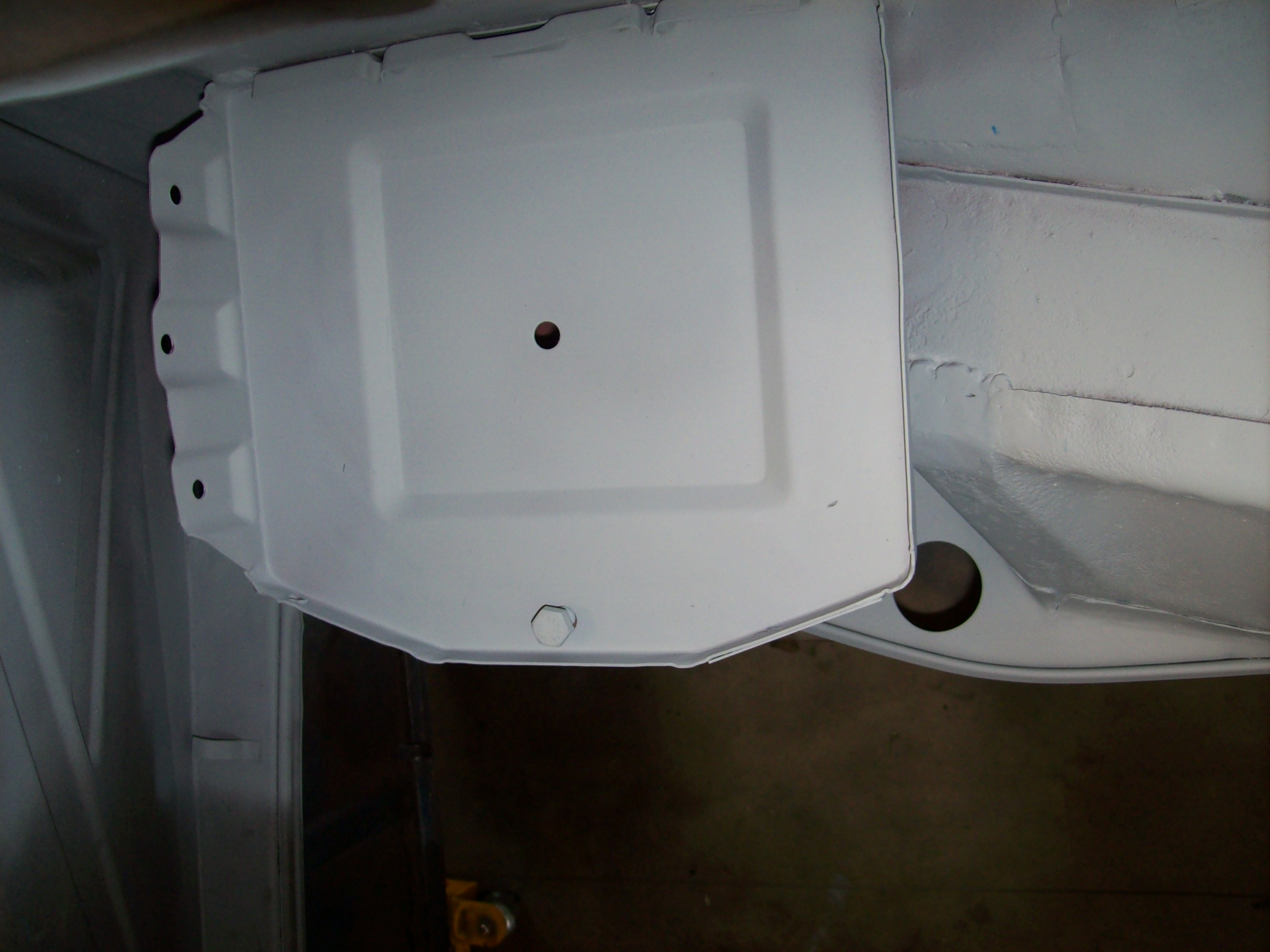

Welding and grinding plug welds...some ongoing progress. Working on shop addition for the next few weeks (weather depending). Need the space and a place for a lift.

The finished (mostly) shelf area...

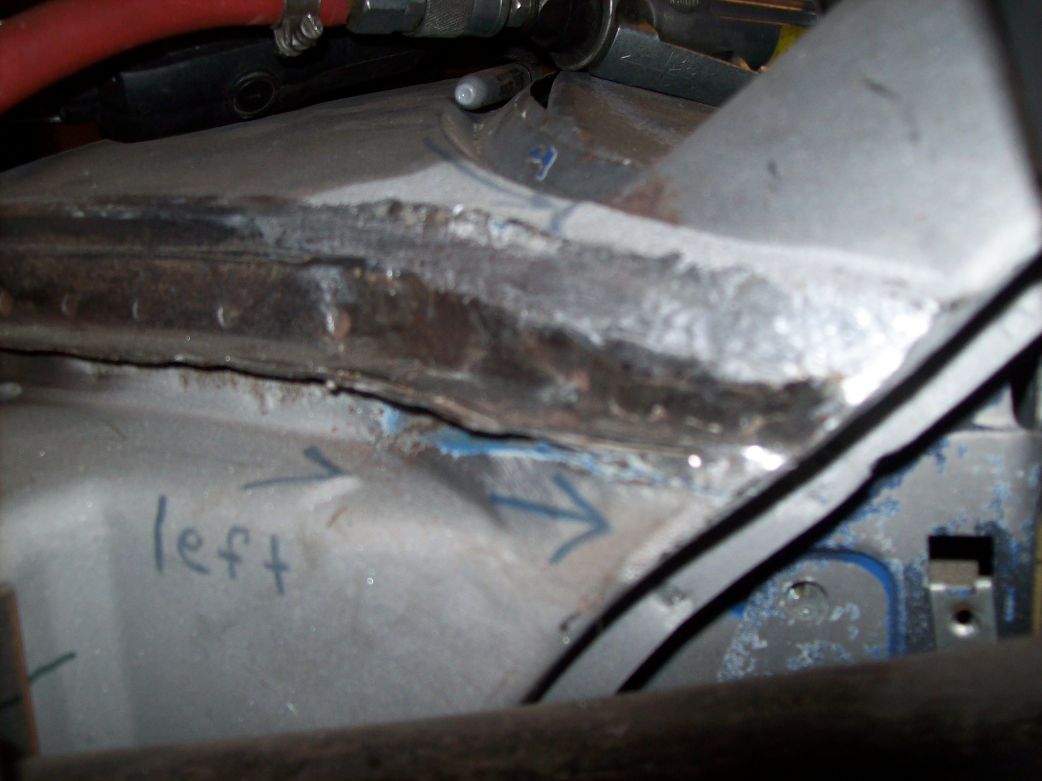

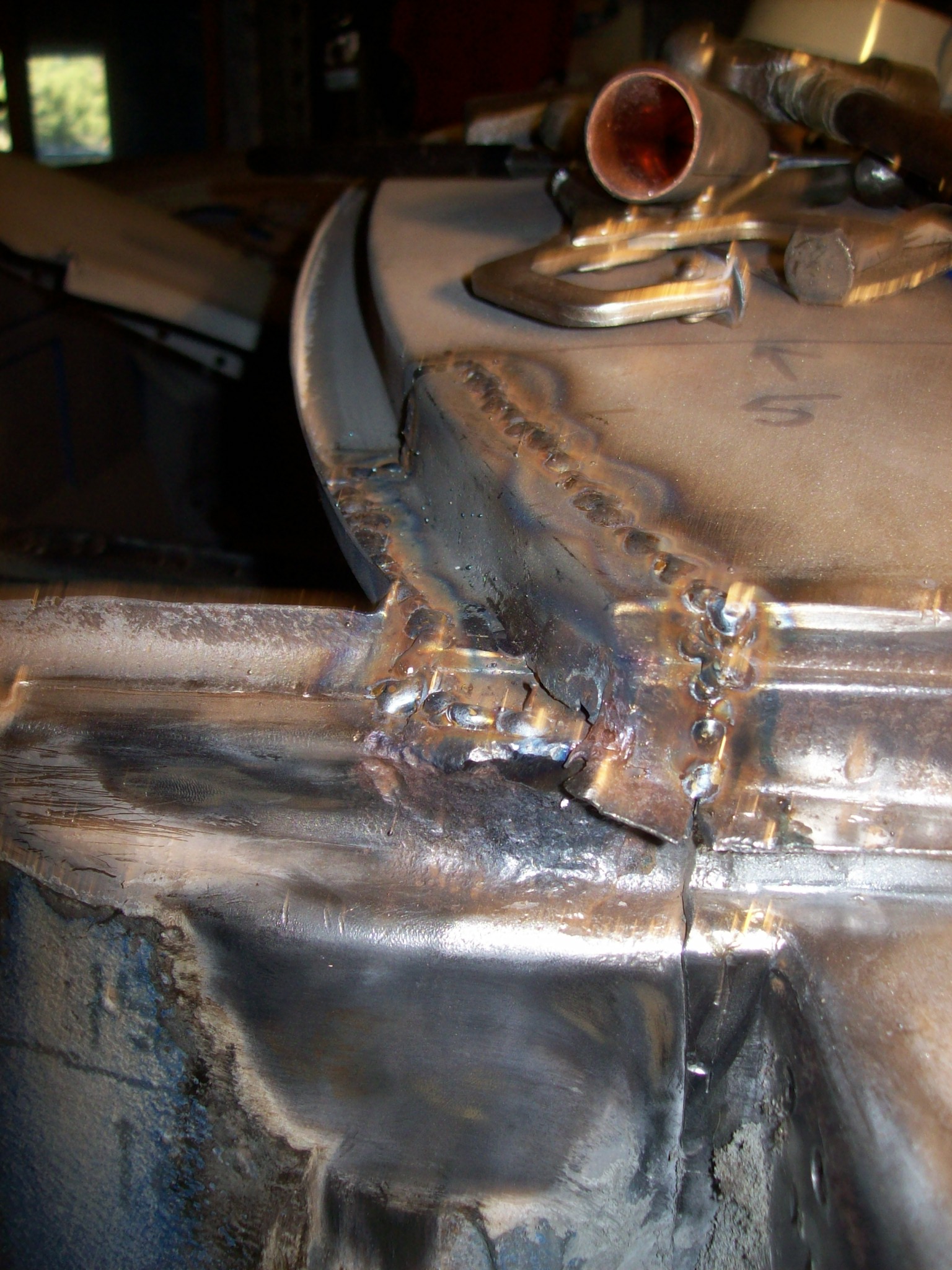

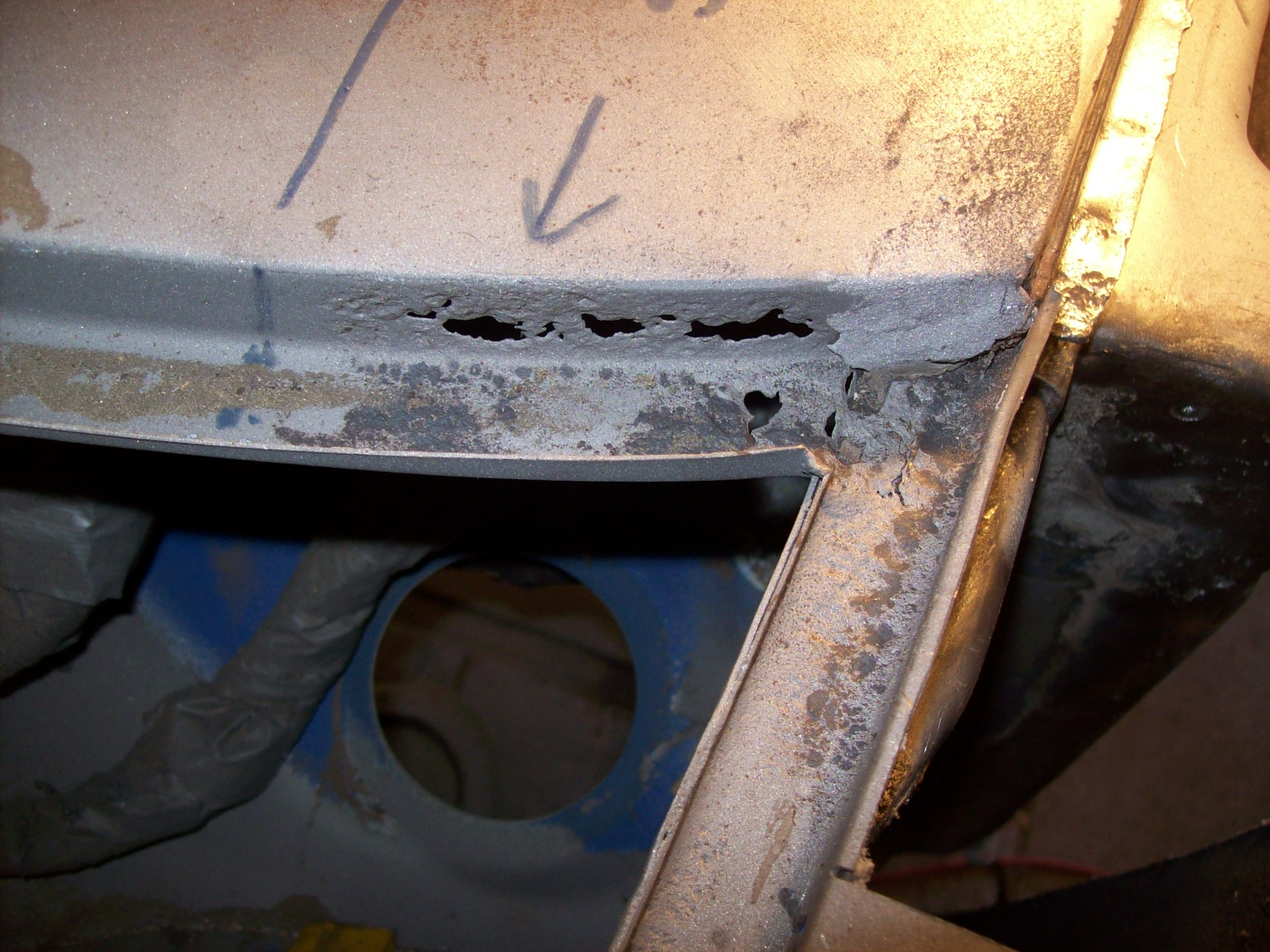

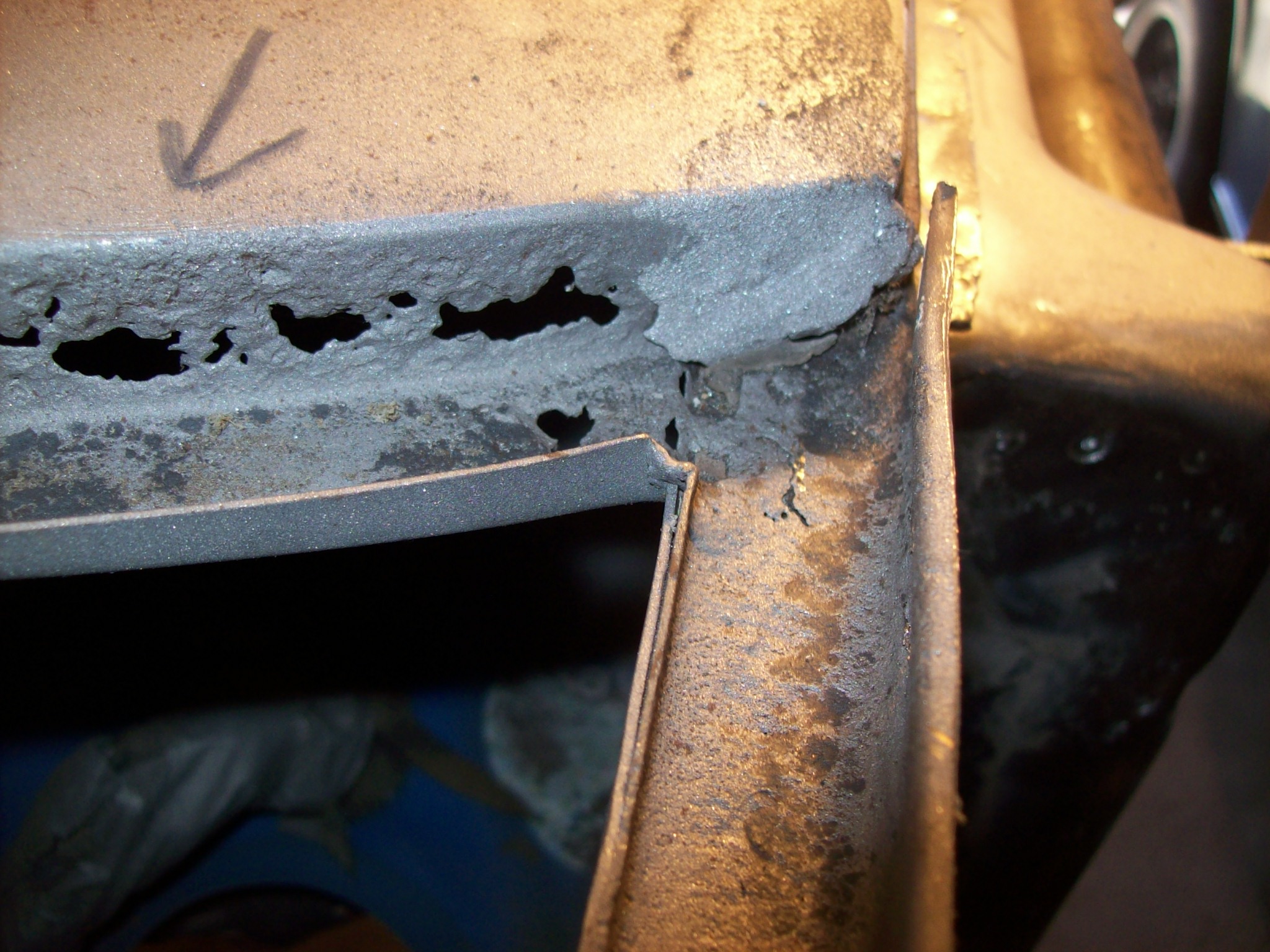

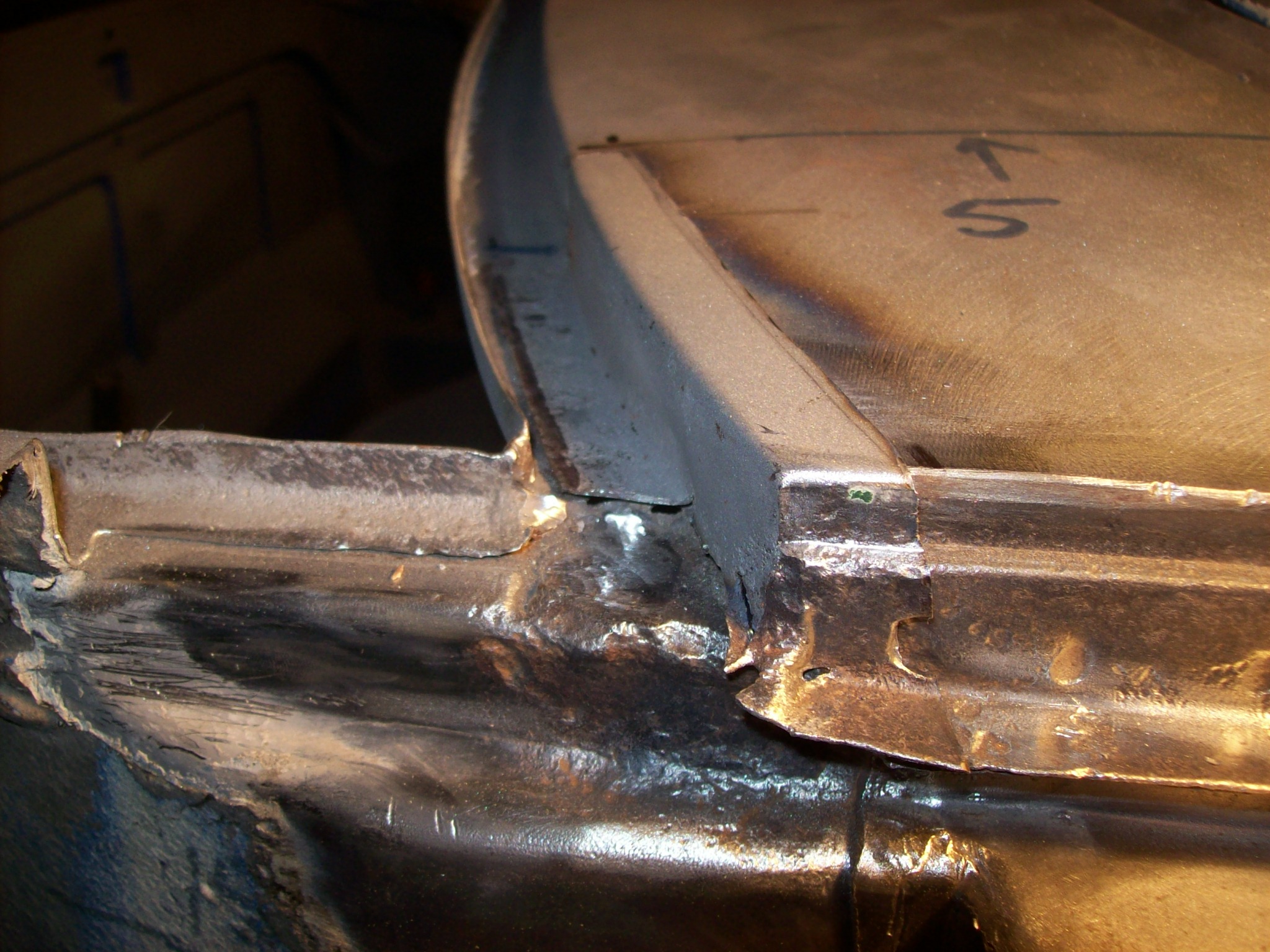

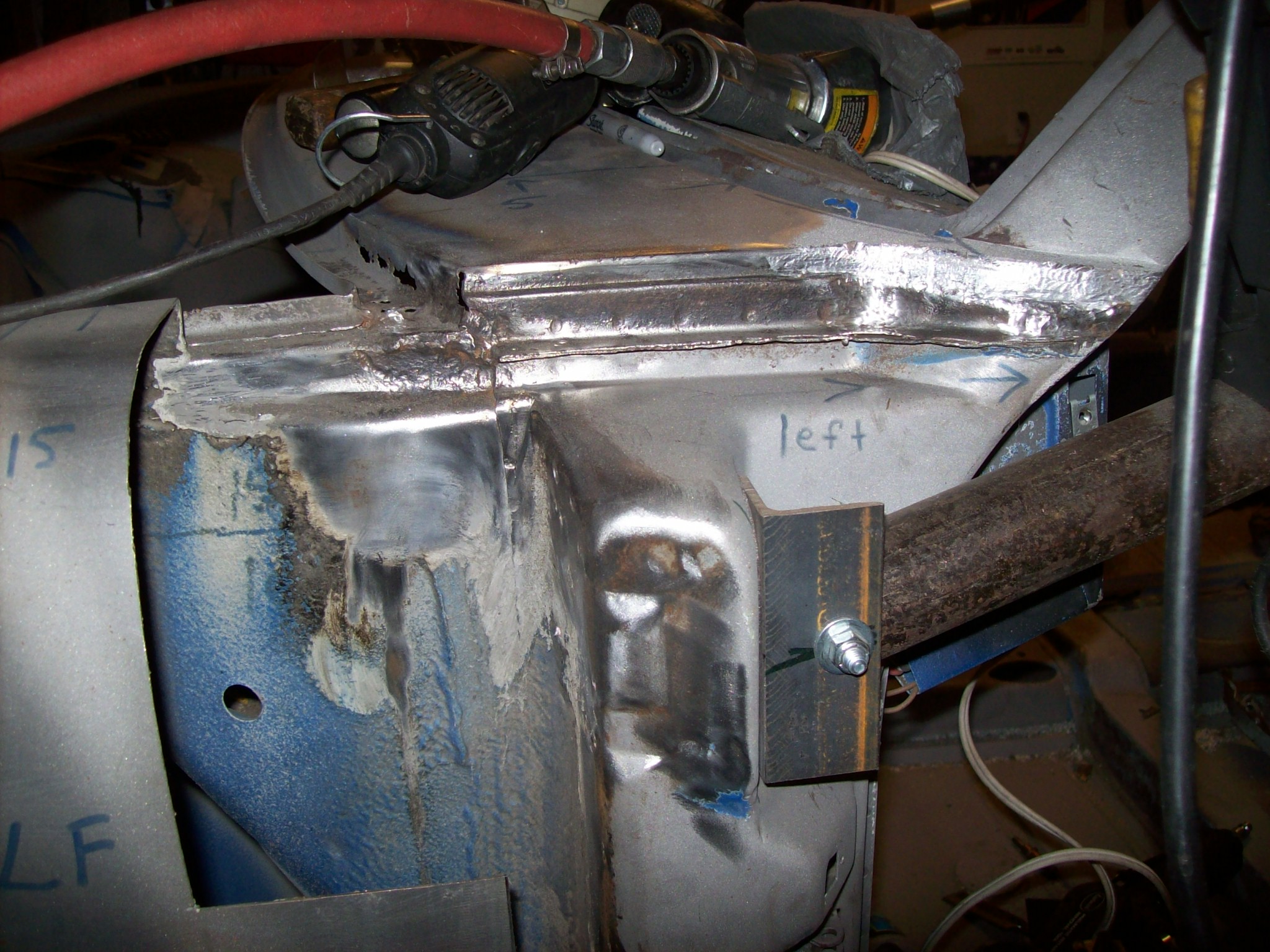

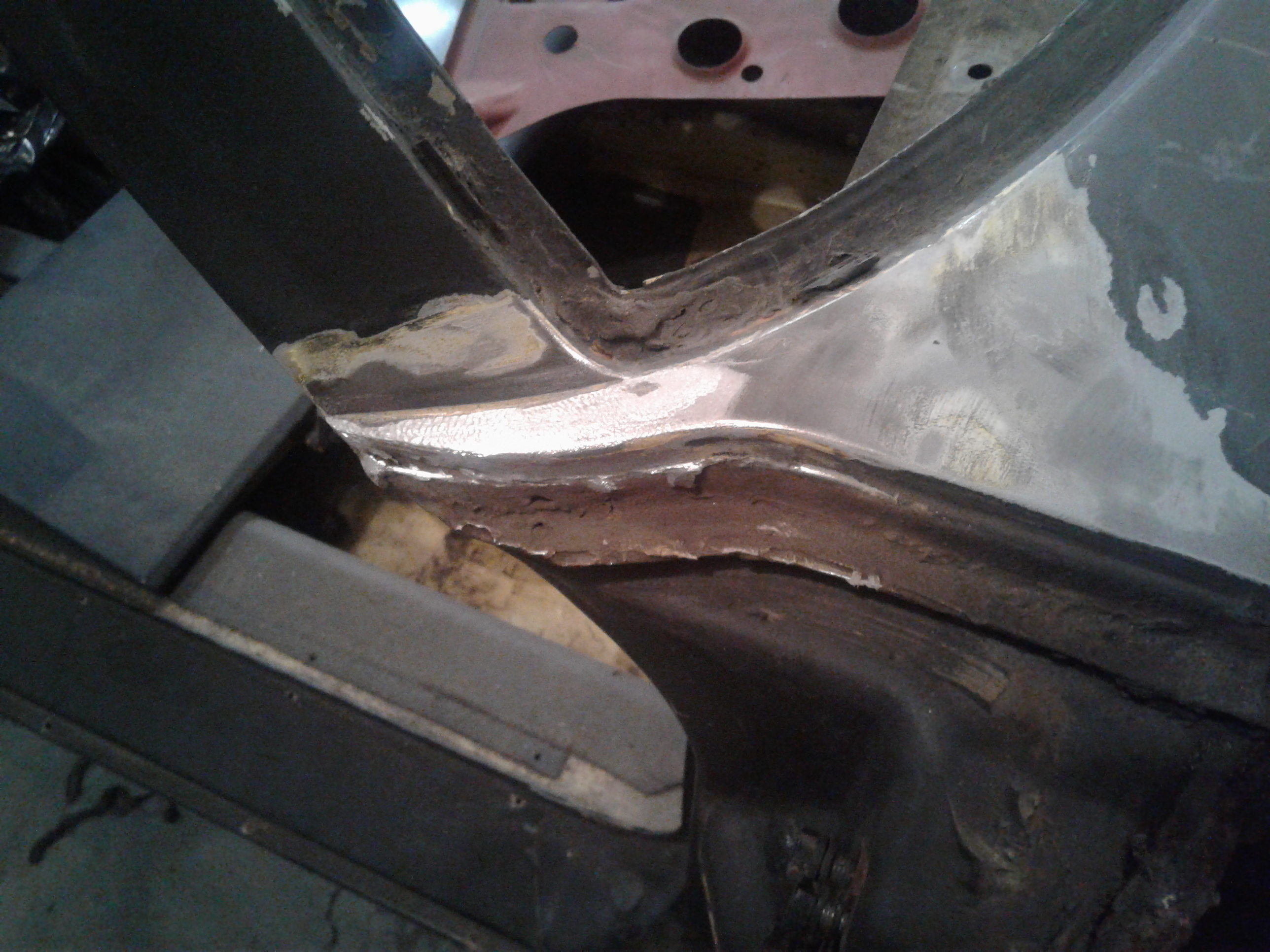

Been quiet, but working. Almost all the way around the car. Now on the aft end of the drivers front fender...peeling the onion back. So where the fender is welded to the "bonnet" (lower horizontal below the windscreen), there is lead. Like on the 911 fenders, the 914 fender tends to rust by the fender joining panel and mine was no different. With that corner removed...it would make sense to splice the corner in and then re-lead. Obviously I cannot re-lead and then weld that corner back in. (IMG:style_emoticons/default/blink.gif)
Shiny area is where the lead is below the A pillar.
Speedo
post Oct 16 2017, 06:57 PM
Post #267
Posts: 591
Joined: 7-November 06
From: Boulder
Member No.: 7,170

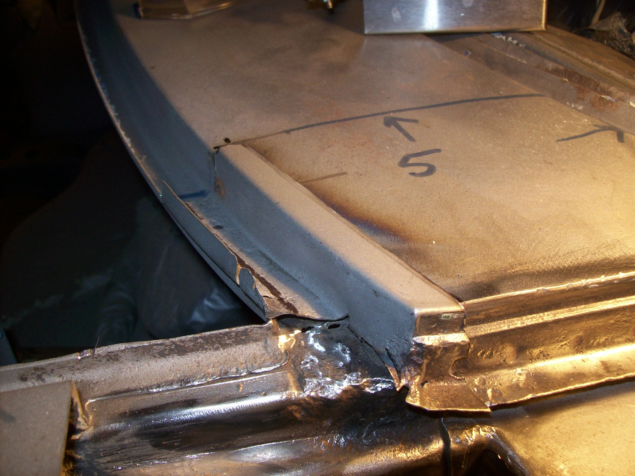

My question is...on 911s the fender is bolted up to the inner fender in this area and a thin plastic separator is inserted as the fender bolts are tightened. Any lead work in this area on the 911 is done prior to painting. On the 914, given that the fender is welded up...is the required lead work in this area done after the fender is welded up? and how do you keep the slot between the top rear of the fender and bonnet from filling up with lead? Seems like you would need the equivalent of a concrete sidewalk trowel tool to maintain the gap as there is no vinyl to insert. Am I overthinking this?
I still need to repair the perforations in the lip in front of the bonnet before welding the fender splice in place, and there will probably be some leading going on there. But it can be done after the steel is welded in. BTW the Eastwood wire wheel undercoating removal tool is the bats ass in this area. (IMG:style_emoticons/default/evilgrin.gif)

Member No.: 43
I've used lead back in the day. There is a serious learning curve that's for sure. My explanation of the process is to install the fenders then go through the tinning/leading process. The key is the warming and paddling of the filler. You want to get it to a plastic state. It should not run. Lead is usually soft enough to sand, scrape and file. If you need to apply more to fill a low spot after filing it is important to finesse the plastic material and get the rewarming just right to allow the new layer to adhere to the filed layer.
As far as the seam goes, a piece of sheet metal should work as a form or a dam. Just leave enough space to slip a piece of 36 grit sand paper in there to final shape.
The one drawback with using this Archaic process is it burns the primer and any paint off the back side of the panel. If you have no access to retreat these areas you are opening the car up to rust forming from the inside out.

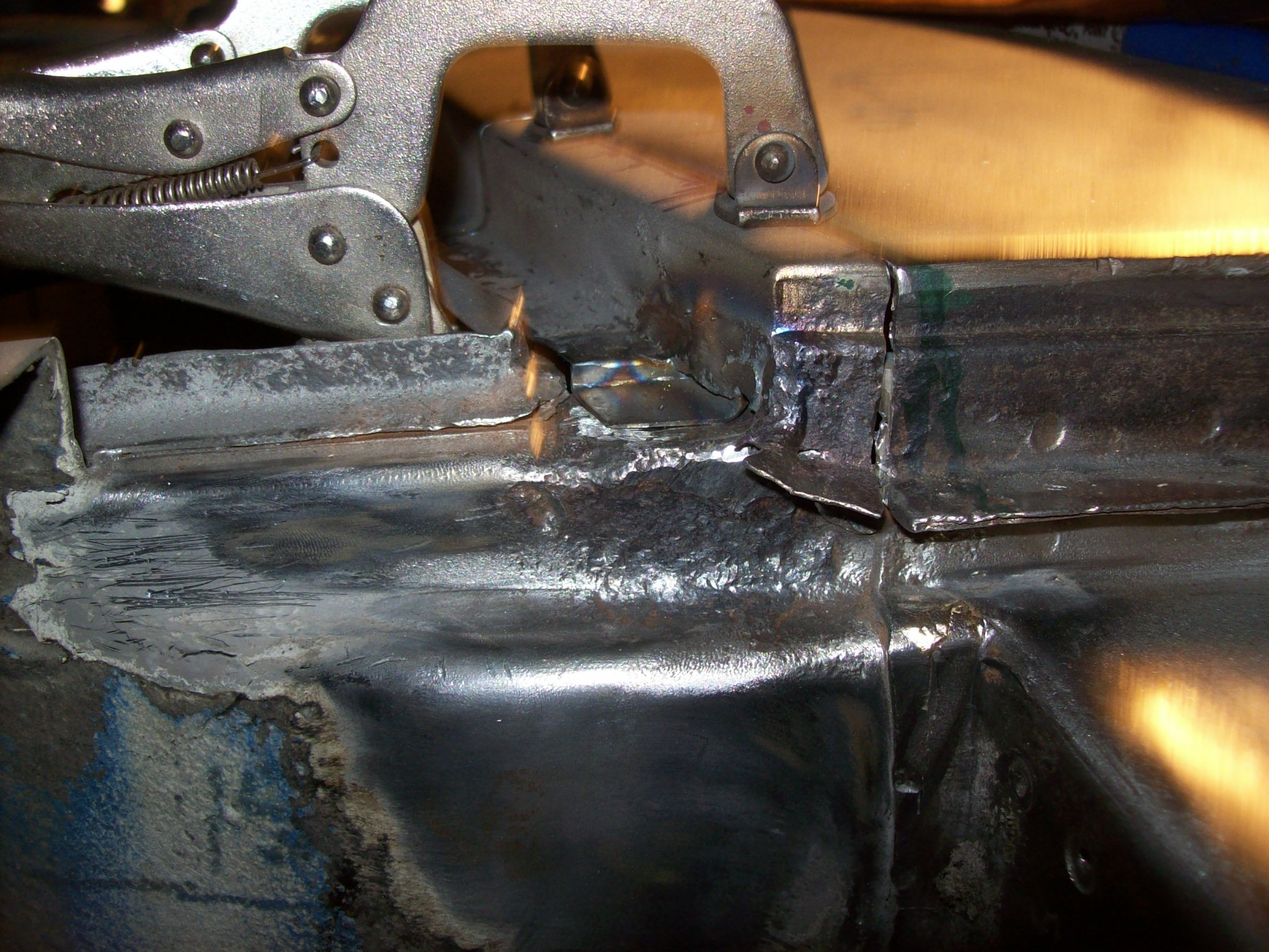

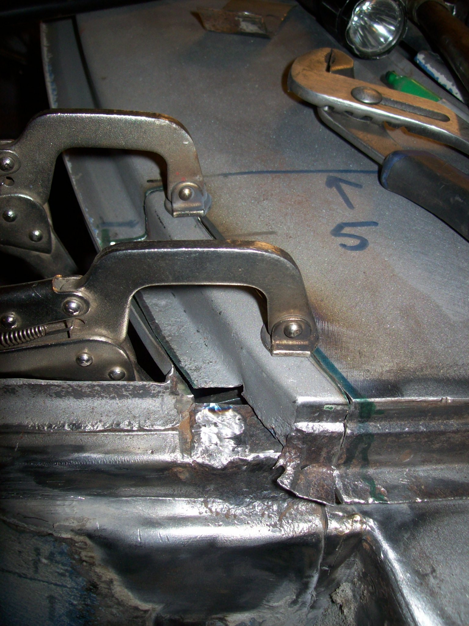

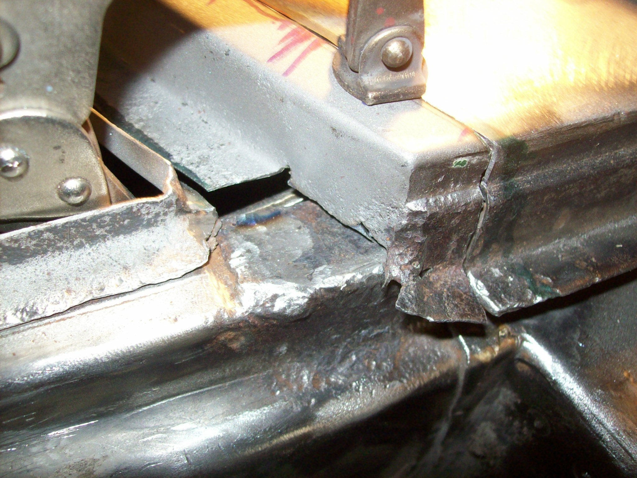

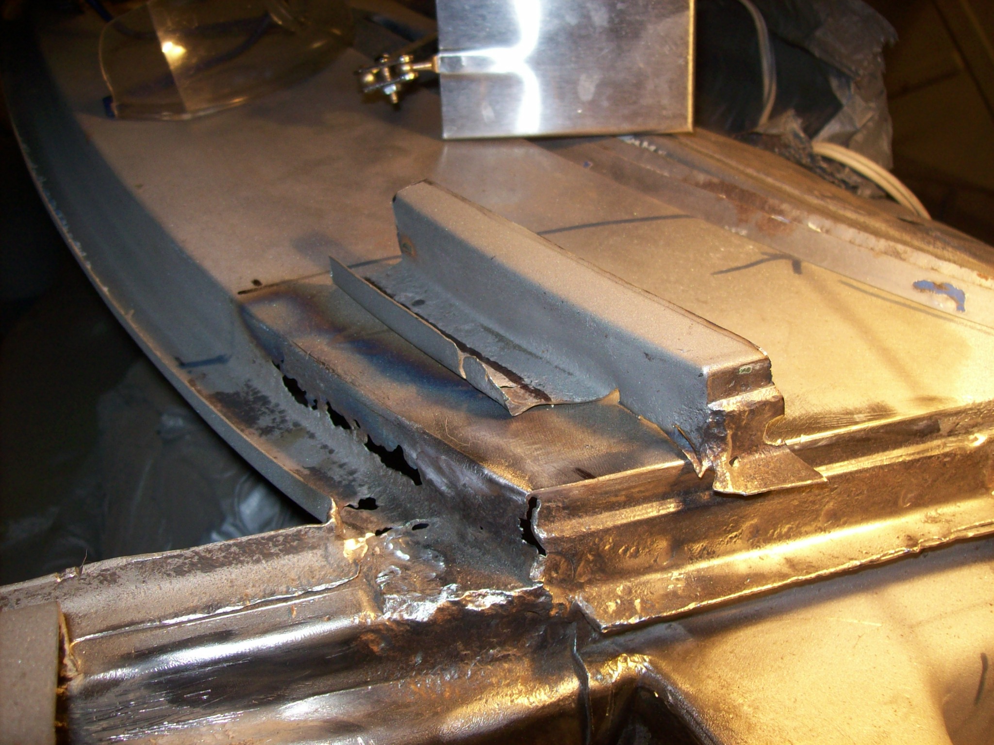

Speedo

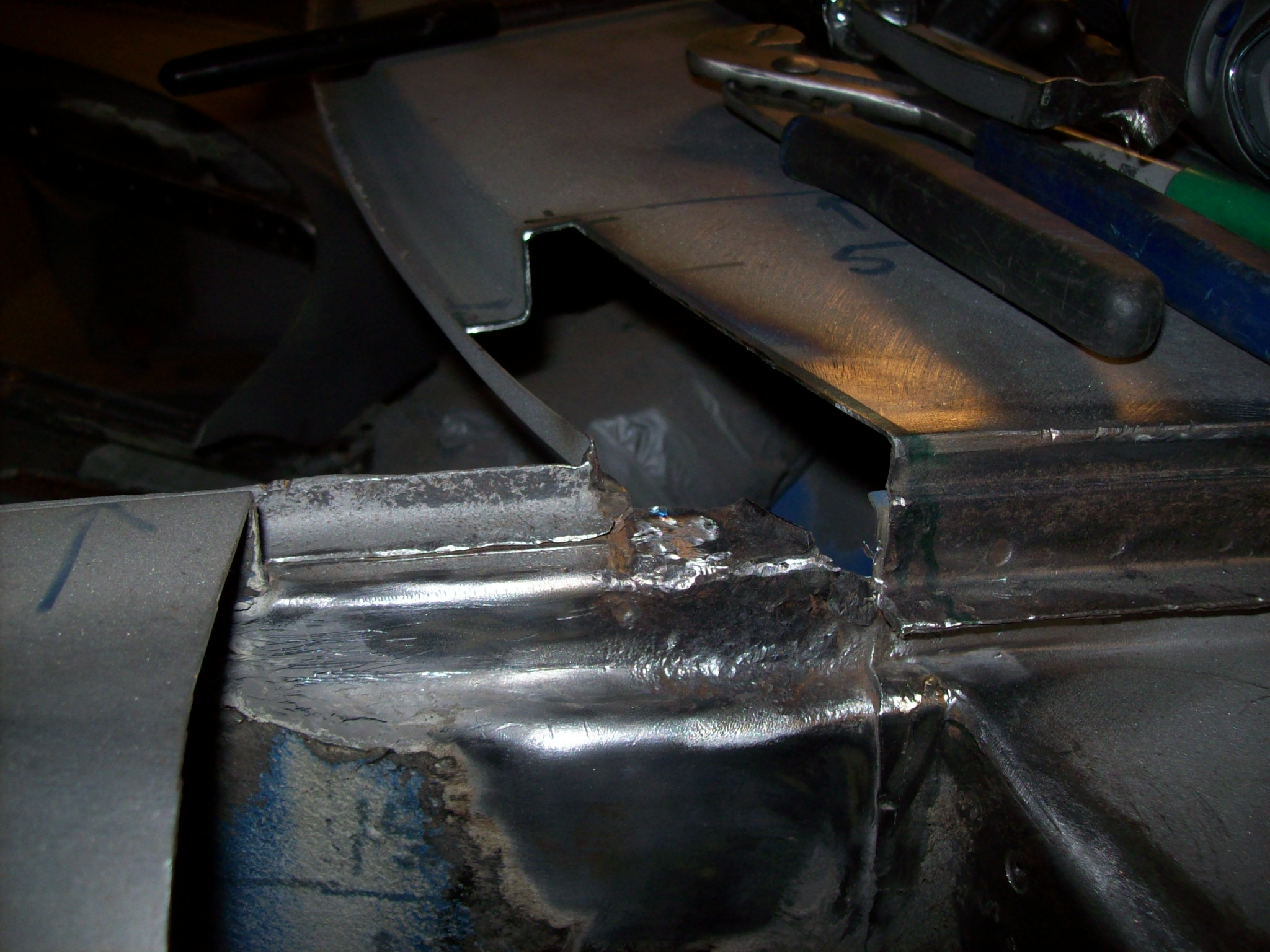

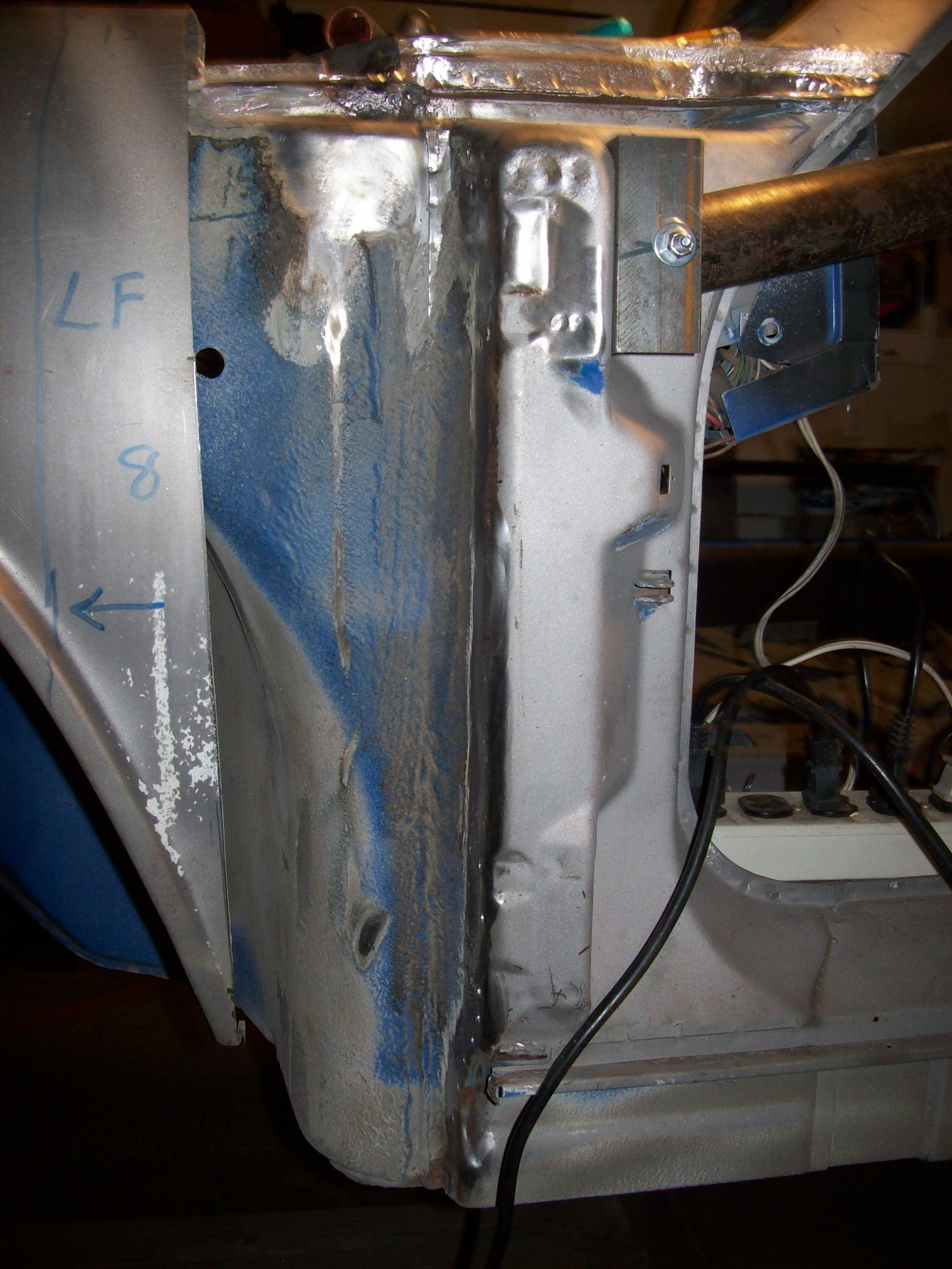

post Jan 1 2018, 06:52 PM
Post #271
Posts: 591
From: Boulder
Member No.: 7,170

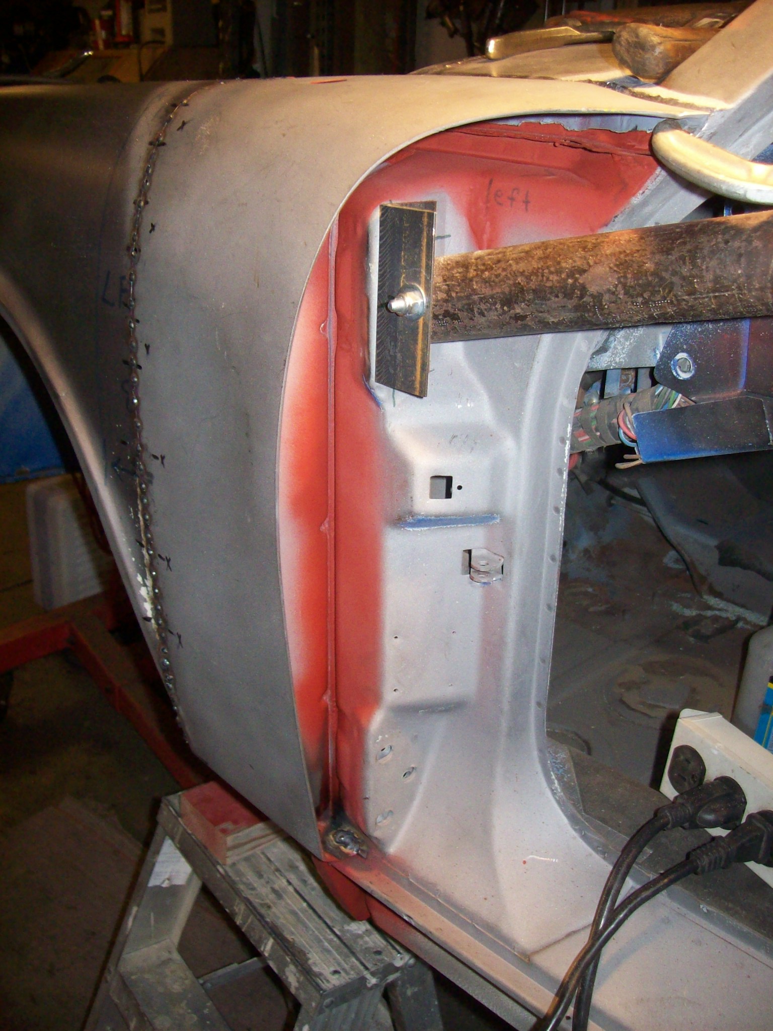

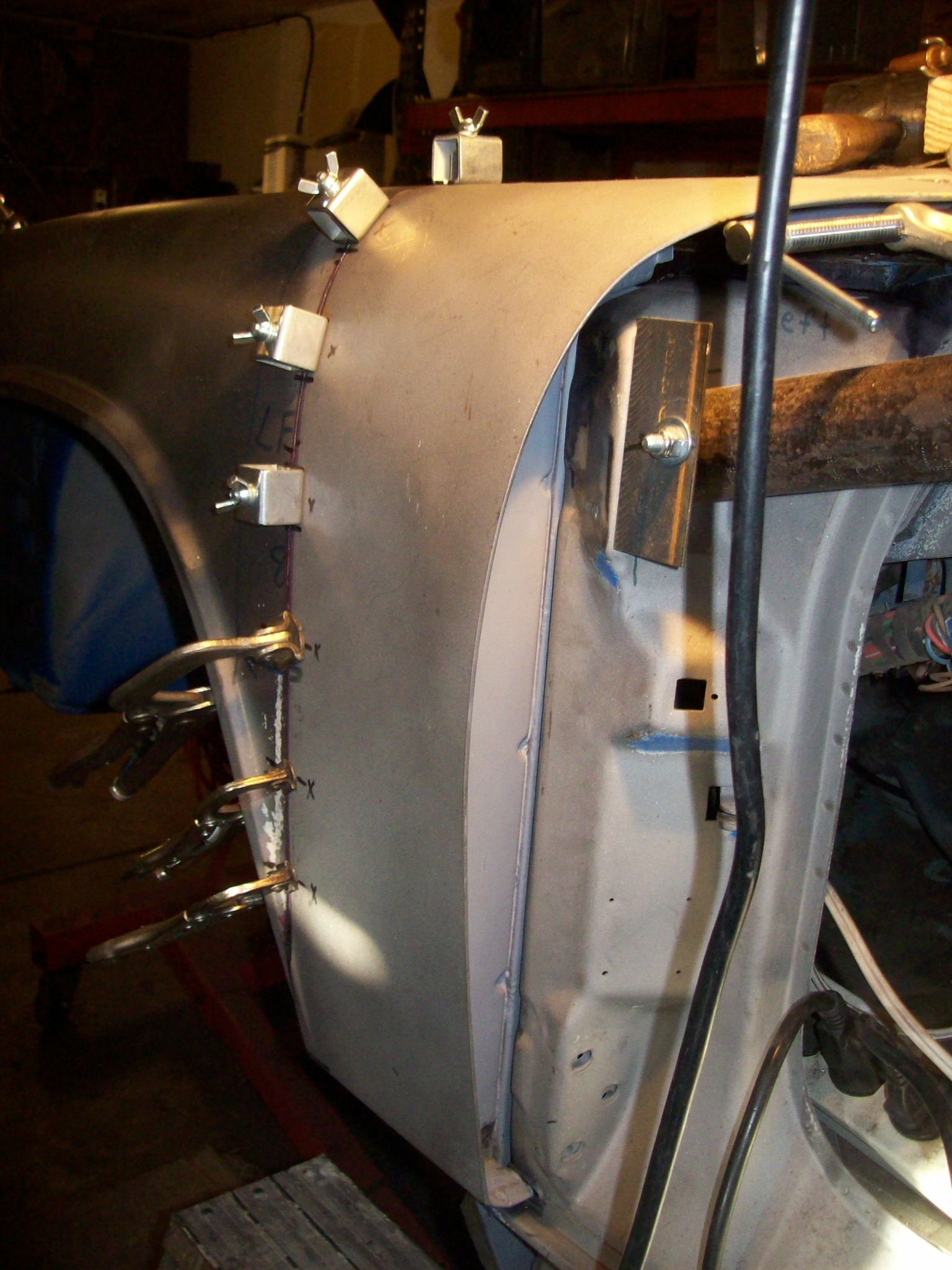

Moving along...
Speedo
post Jan 1 2018, 07:00 PM
Post #272
Posts: 591
From: Boulder
Member No.: 7,170
Cut and fit and...

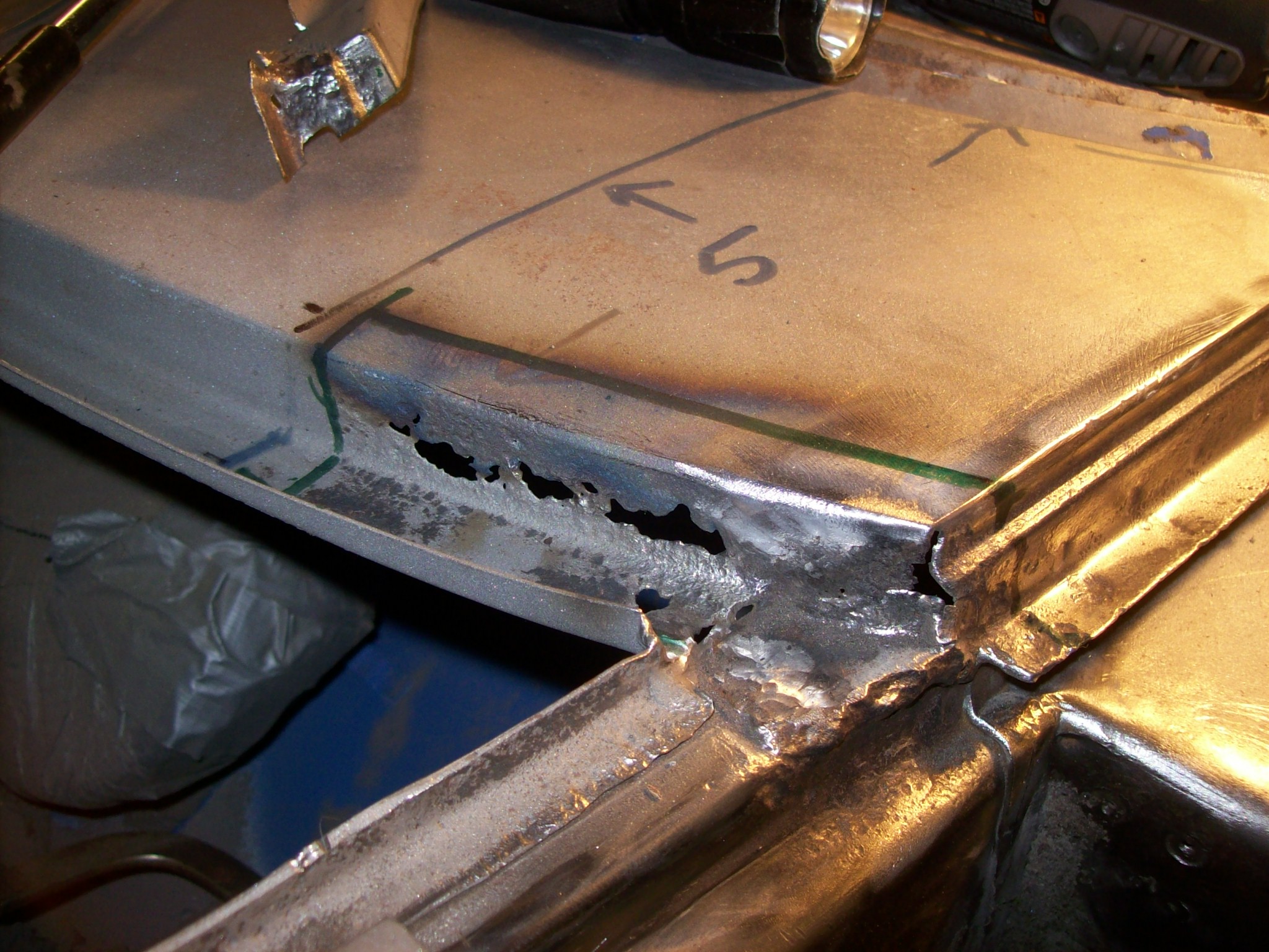

Speedo
post Jan 1 2018, 07:18 PM
Post #273
Posts: 591
From: Boulder
Member No.: 7,170
And more...

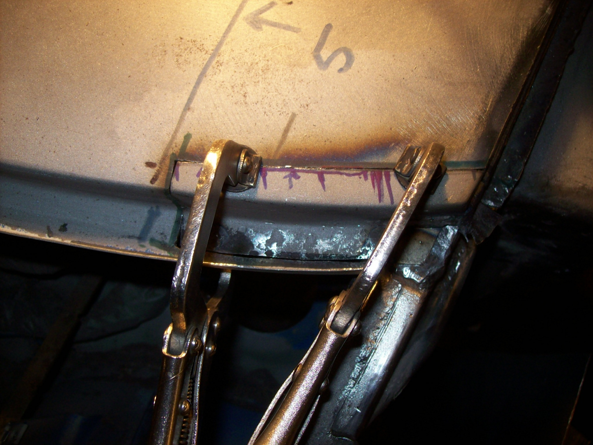

Speedo
post Jan 1 2018, 07:22 PM
Post #274
Posts: 591
From: Boulder
Member No.: 7,170
And finishing this corner of the cowl...

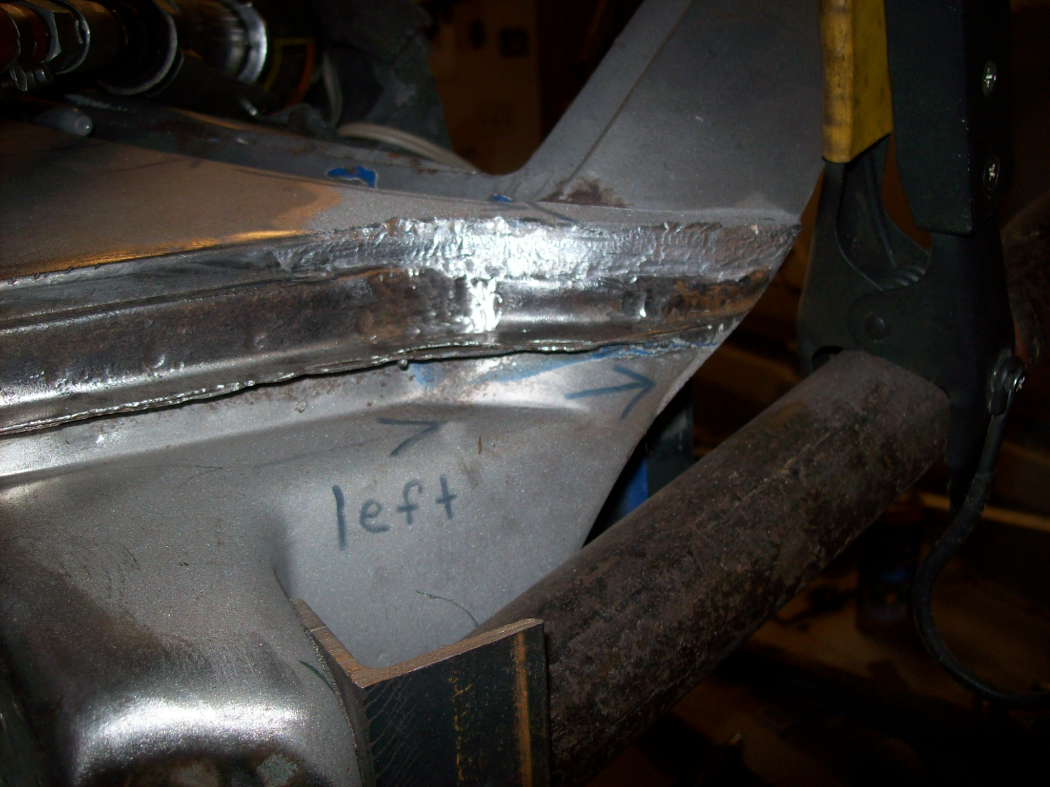

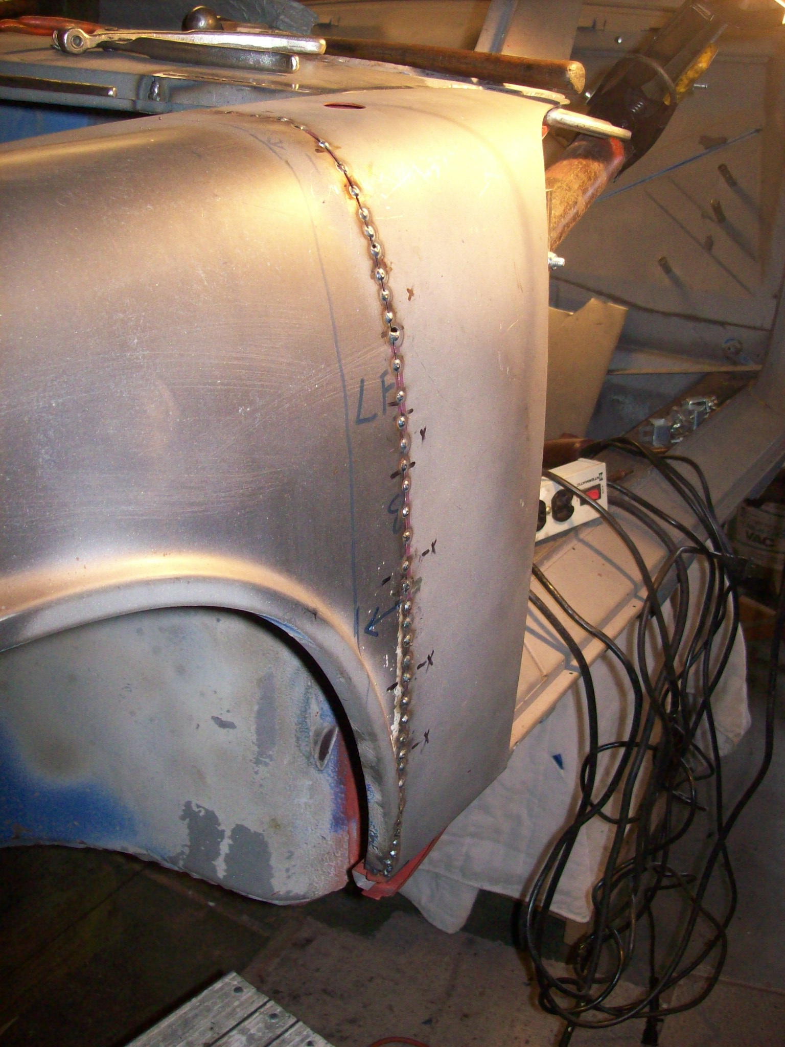

Speedo
post Jan 1 2018, 07:28 PM
Post #275
Posts: 591
From: Boulder
Member No.: 7,170

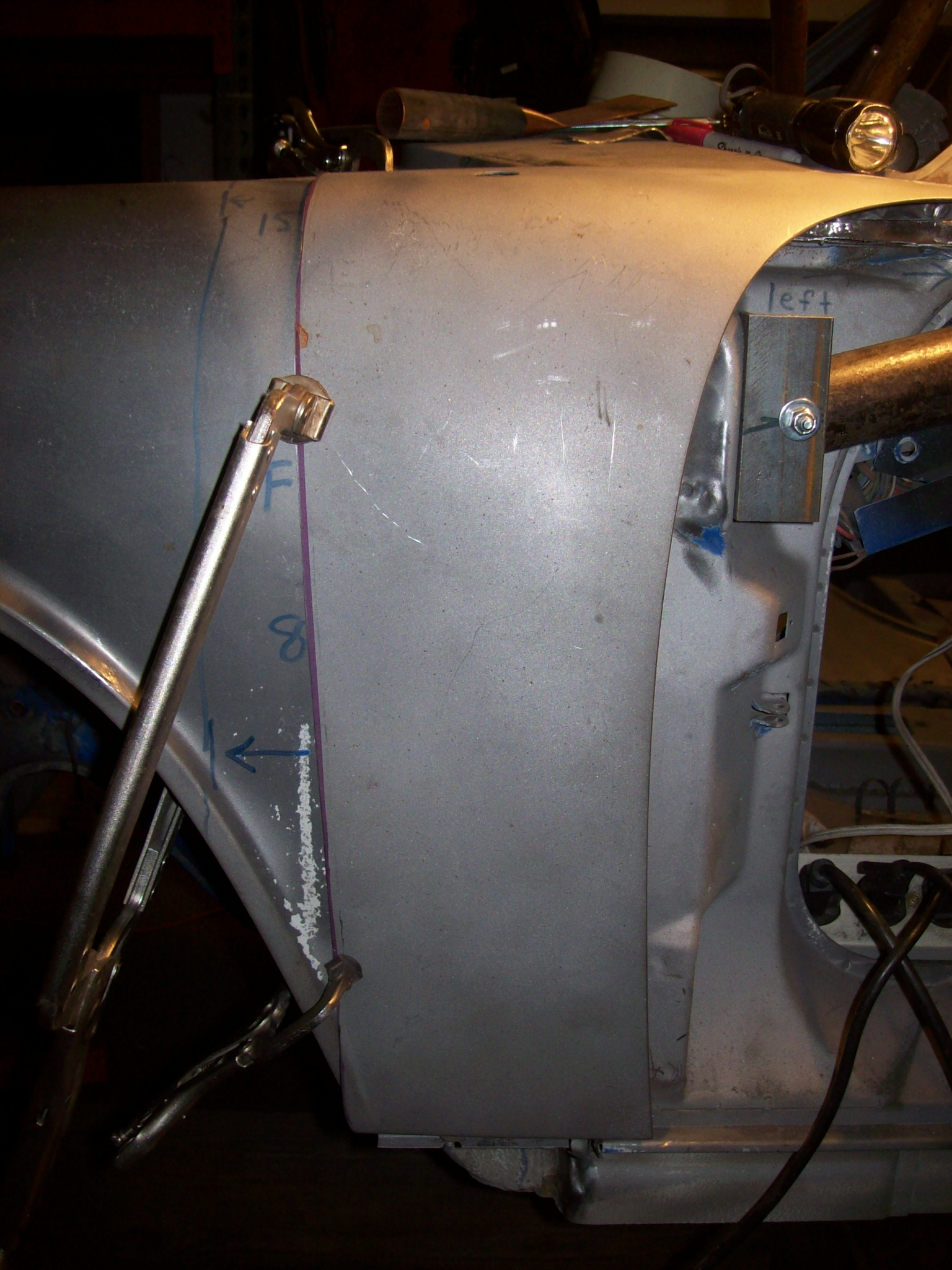

And now the fender...

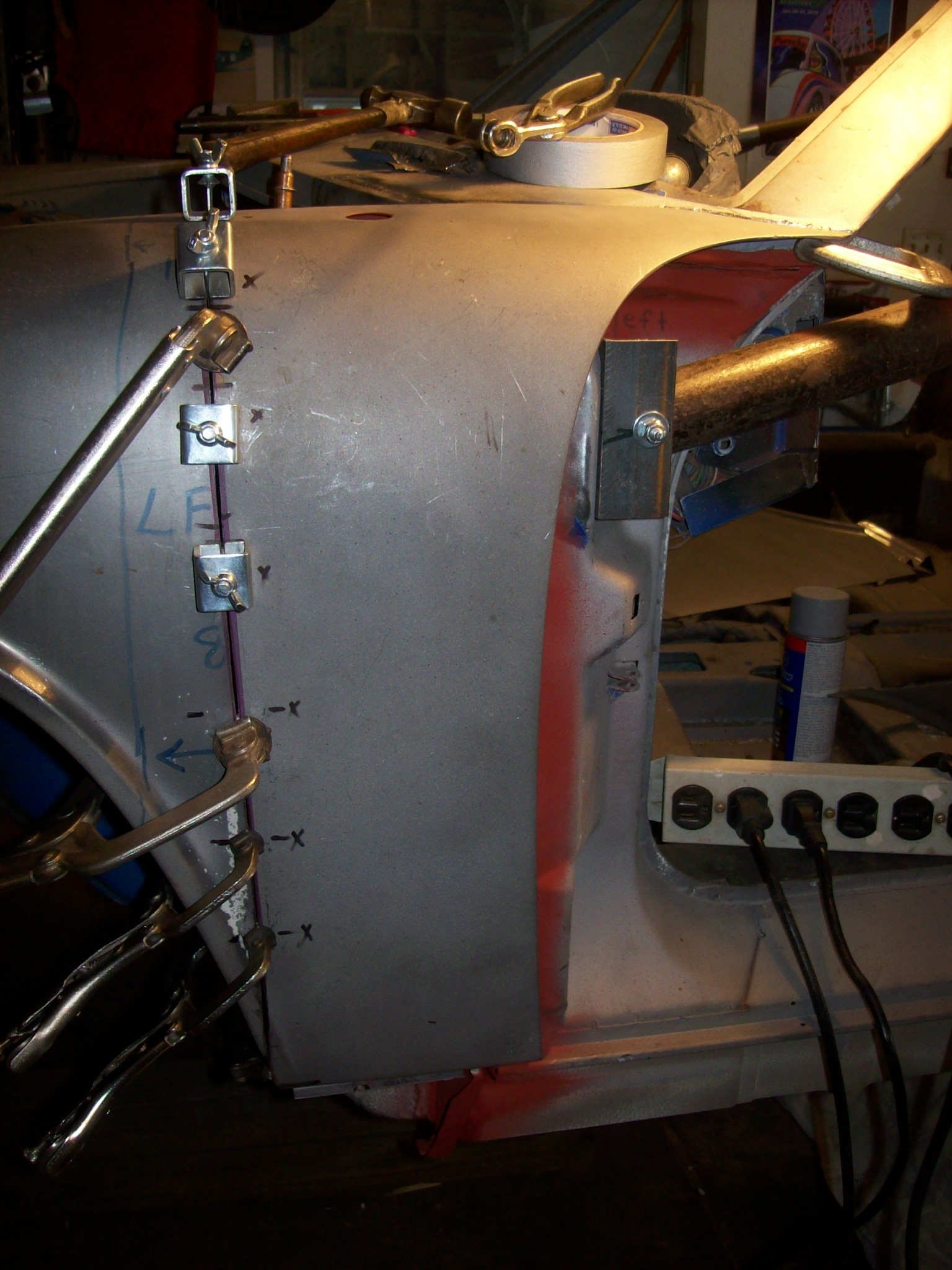

Speedo
post Jan 1 2018, 07:37 PM
Post #276
Posts: 591
From: Boulder
Member No.: 7,170

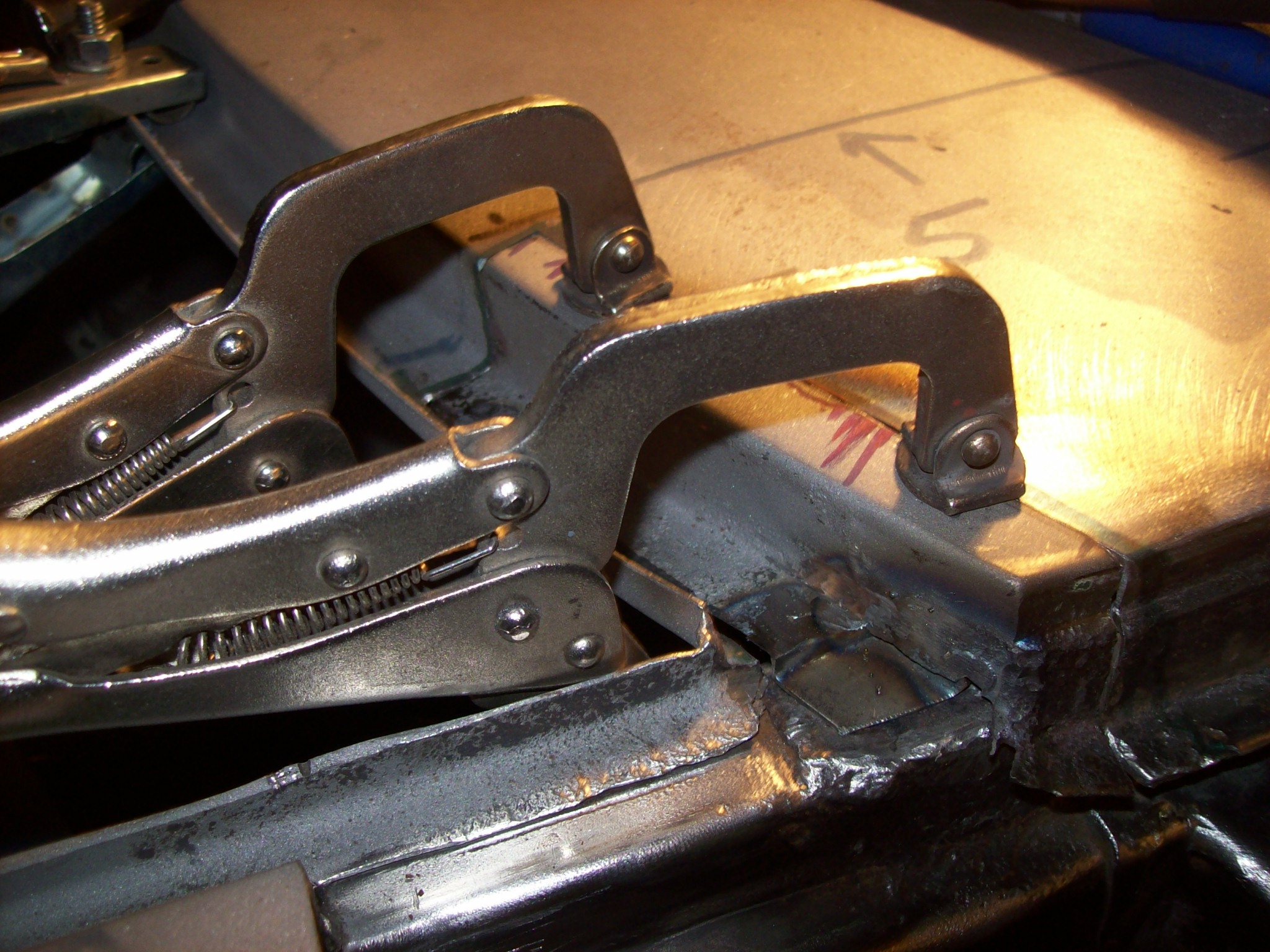

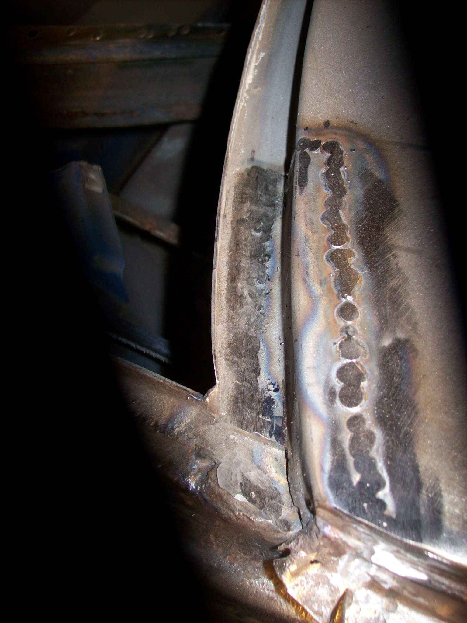

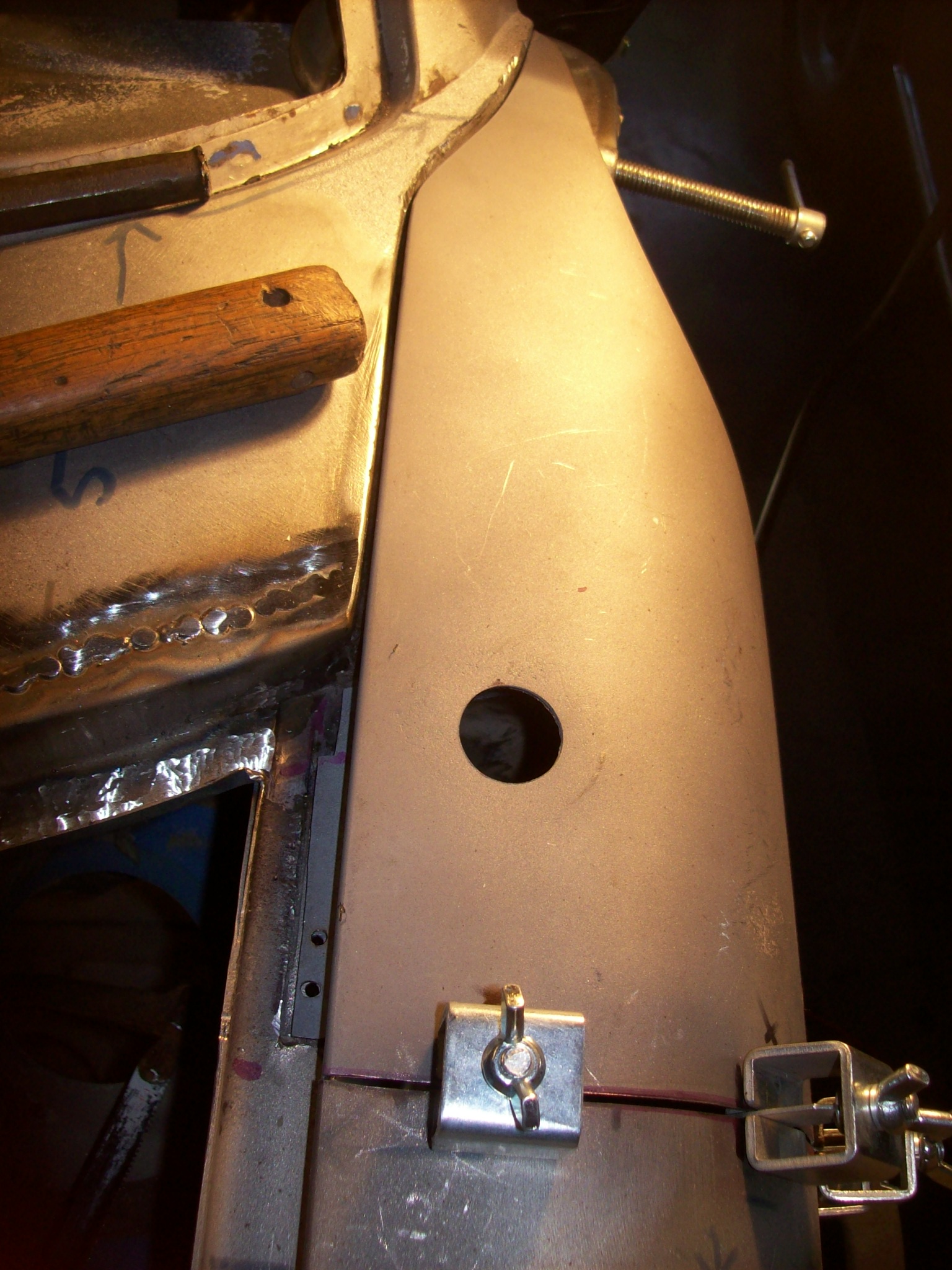

Couple more getting ready to weld... Attached Image Attached Image Attached Image

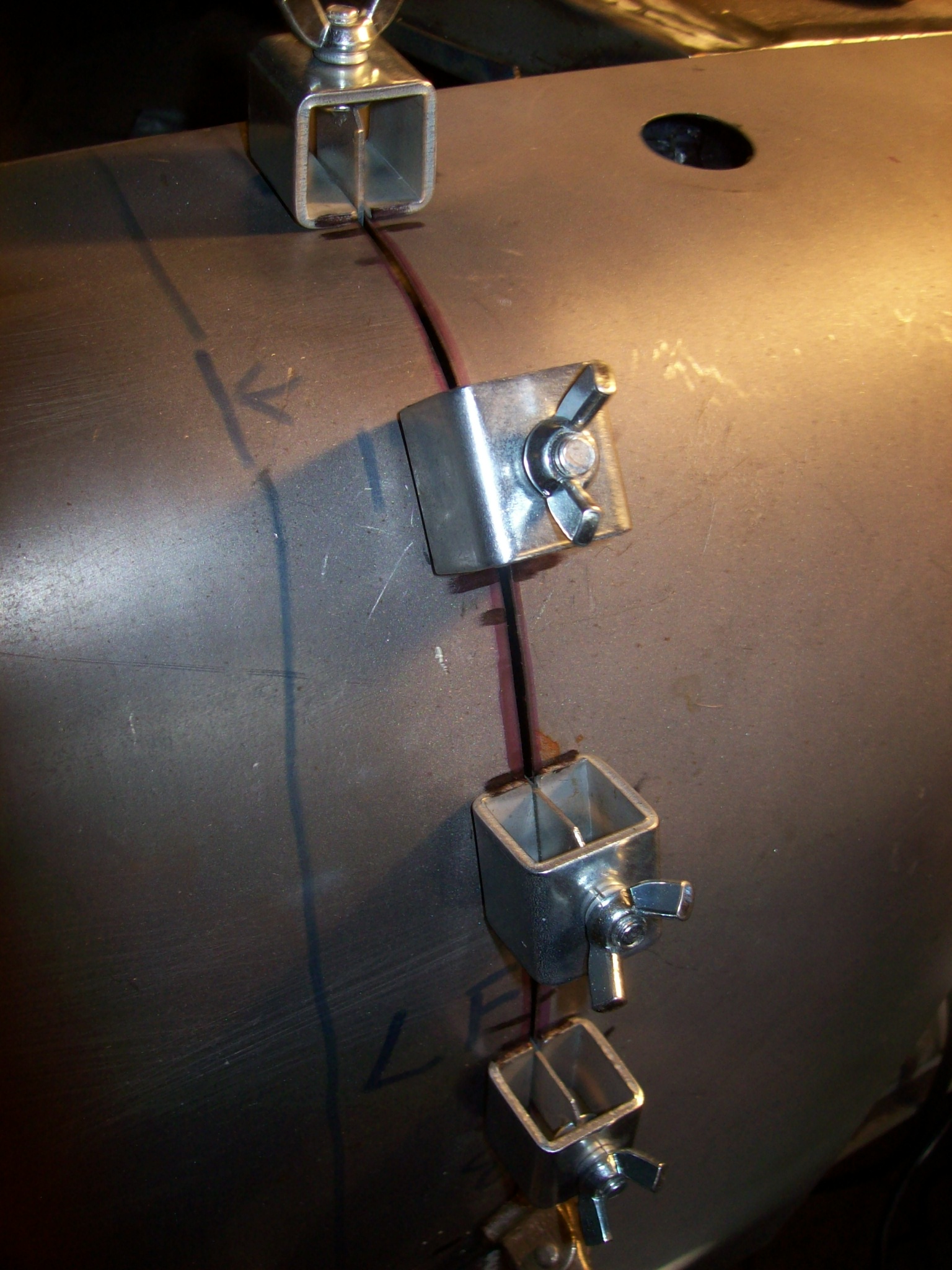

post Jan 15 2018, 08:27 PM
Post #278
Posts: 591

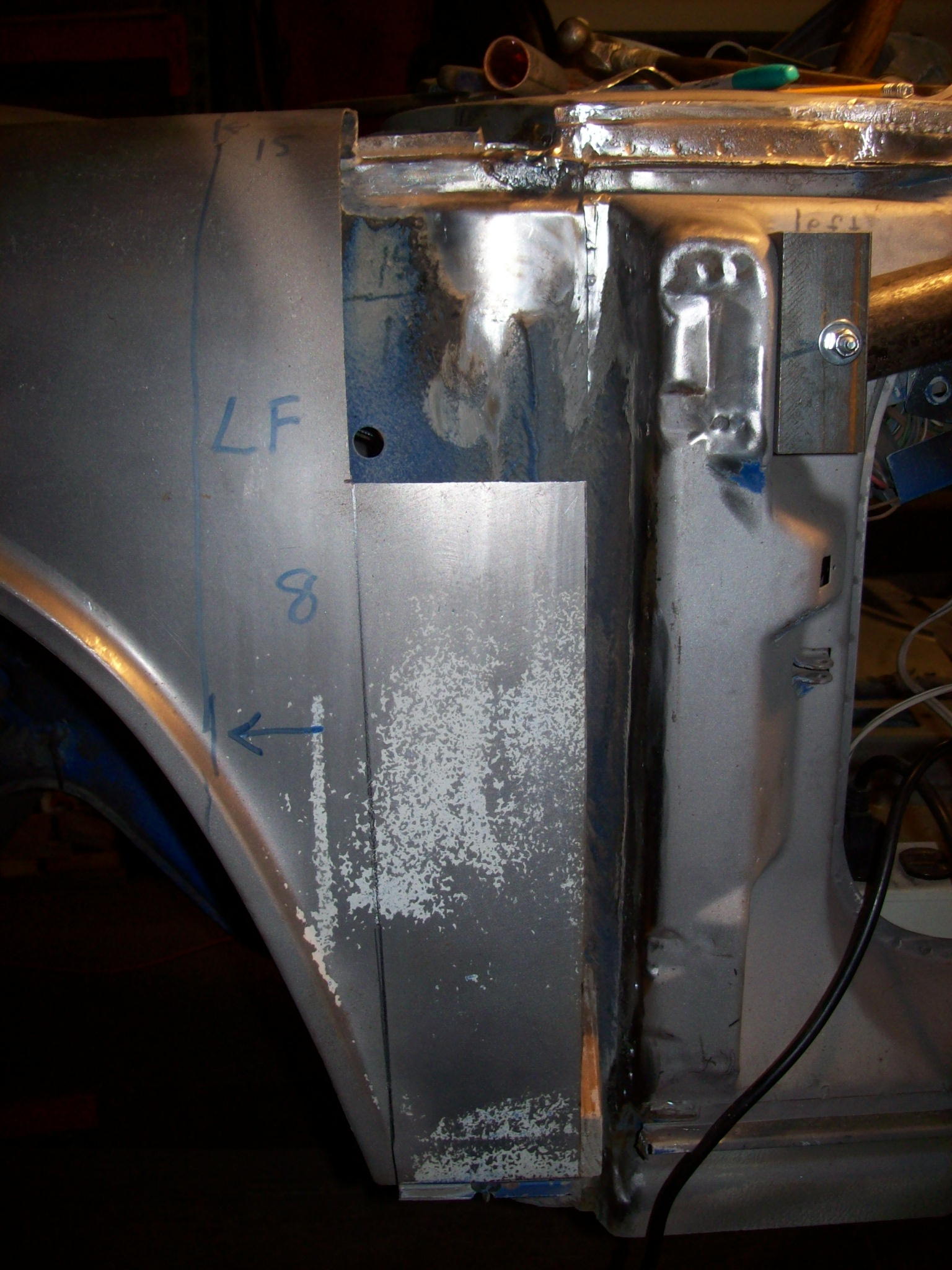

From: Boulder
Member No.: 7,170

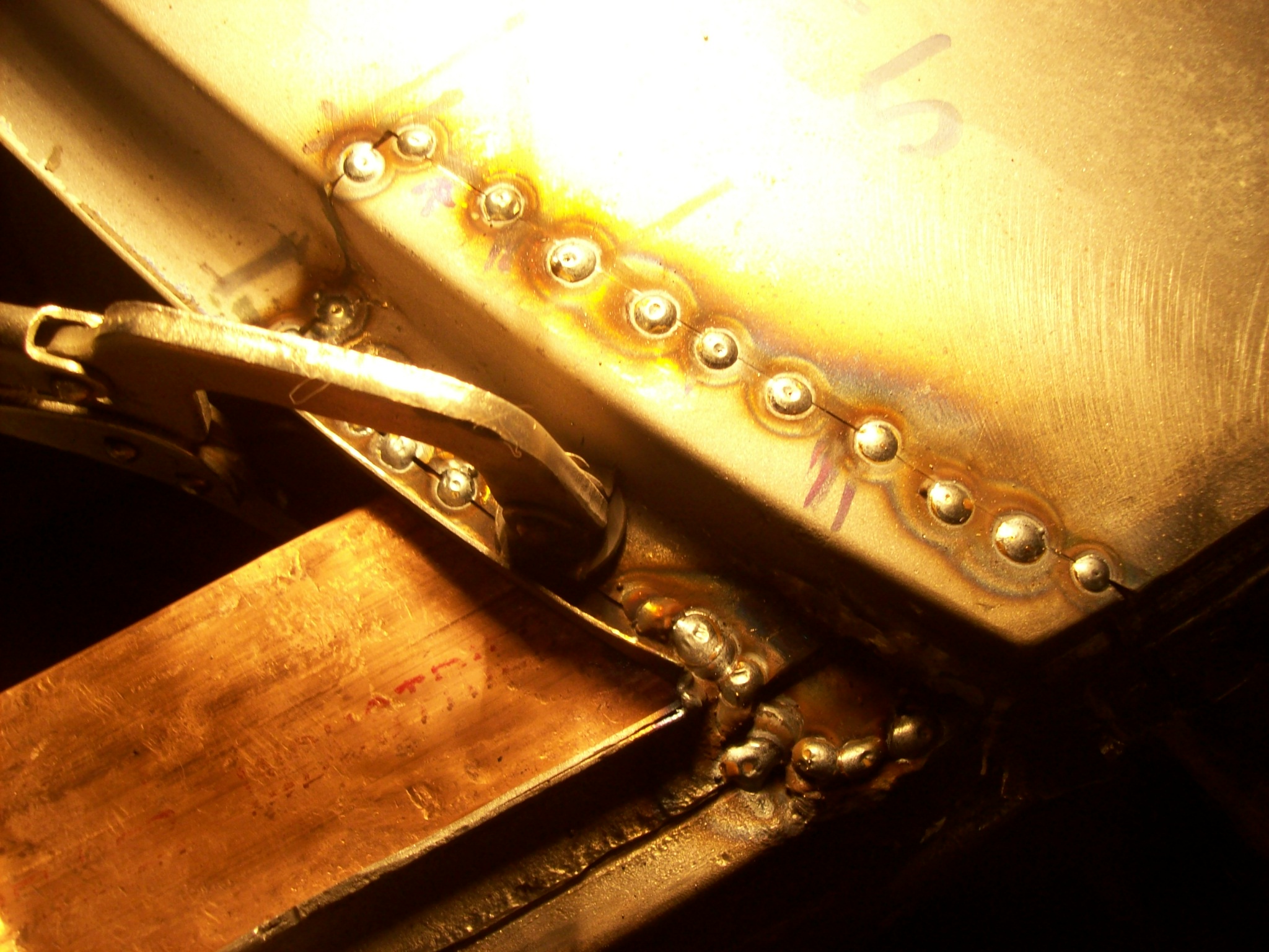

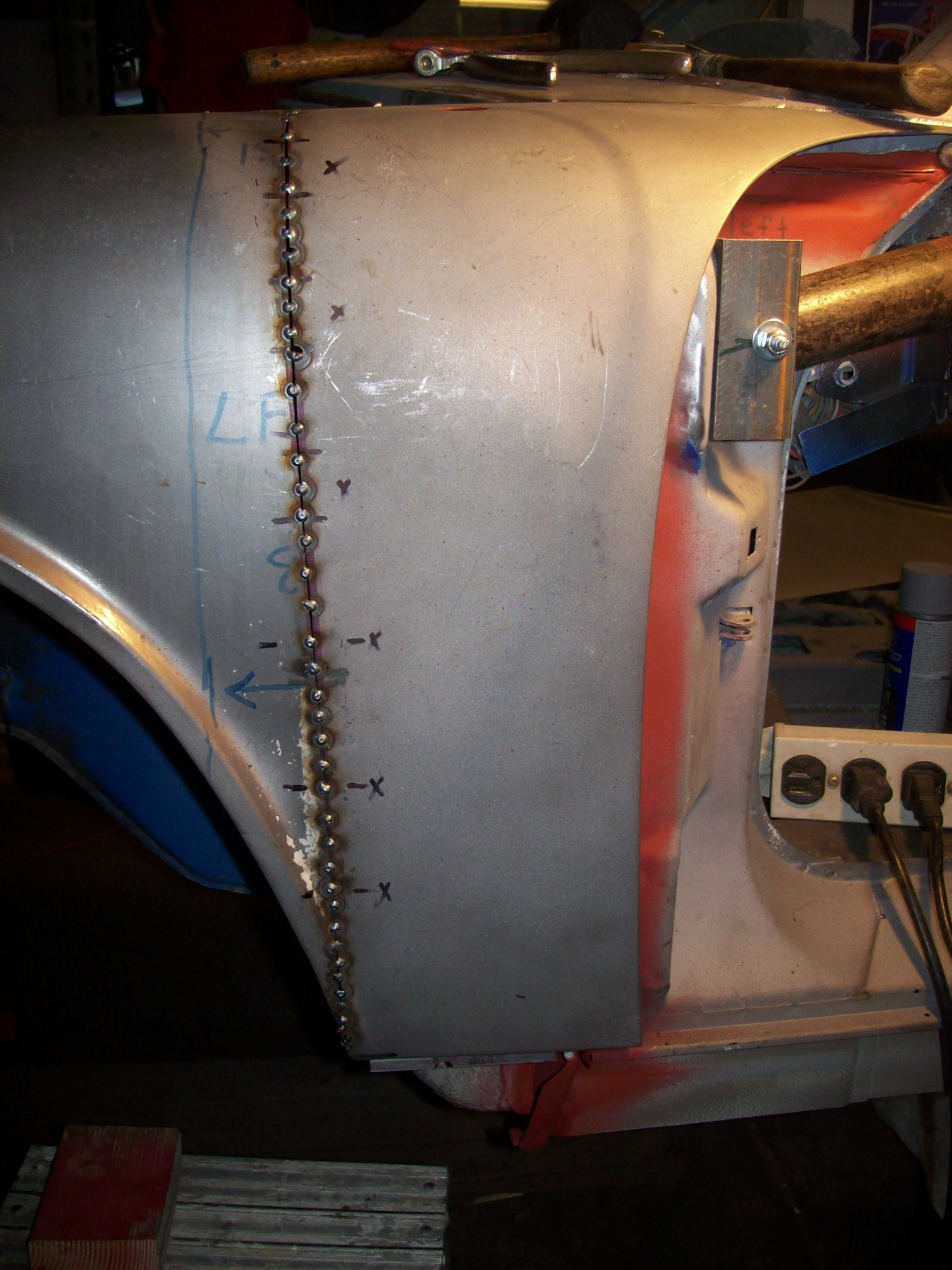

So a couple of the 914 "grand masters" came up today to see if I have totally screwed up the splice of the driver side aft fender. Word was that it looked ok to close it up. I have measured and measured...comparing the driver side opening with the passenger side.
I went ahead and committed the splice.
