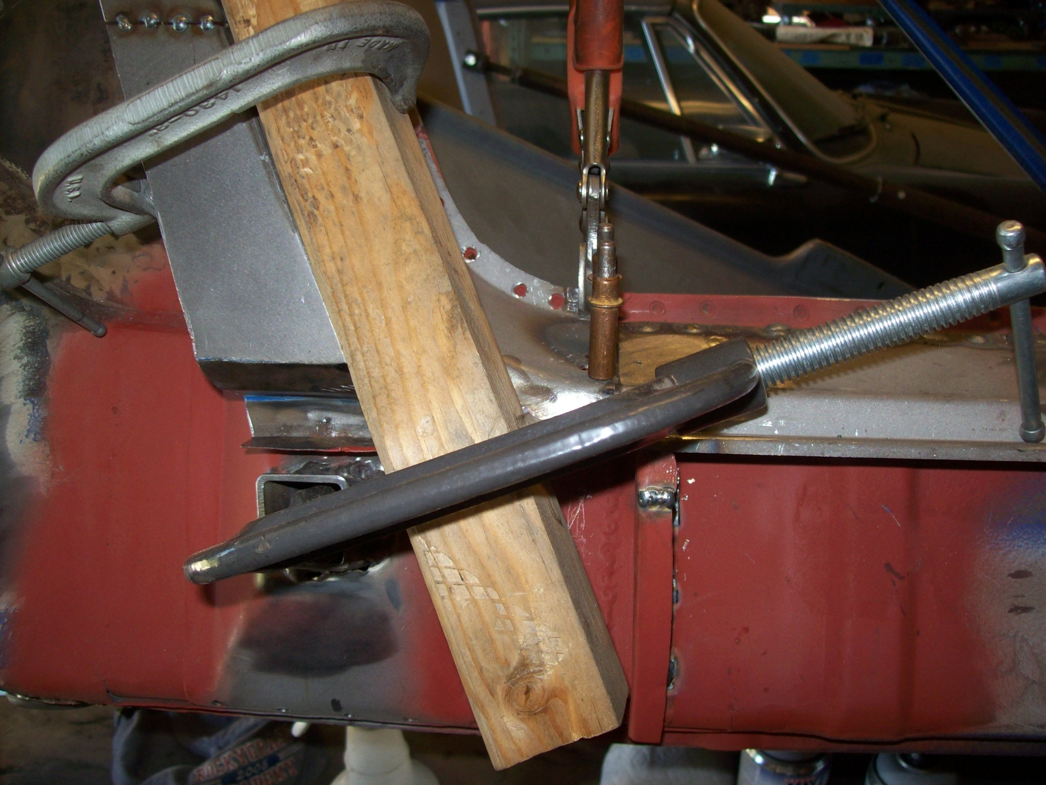

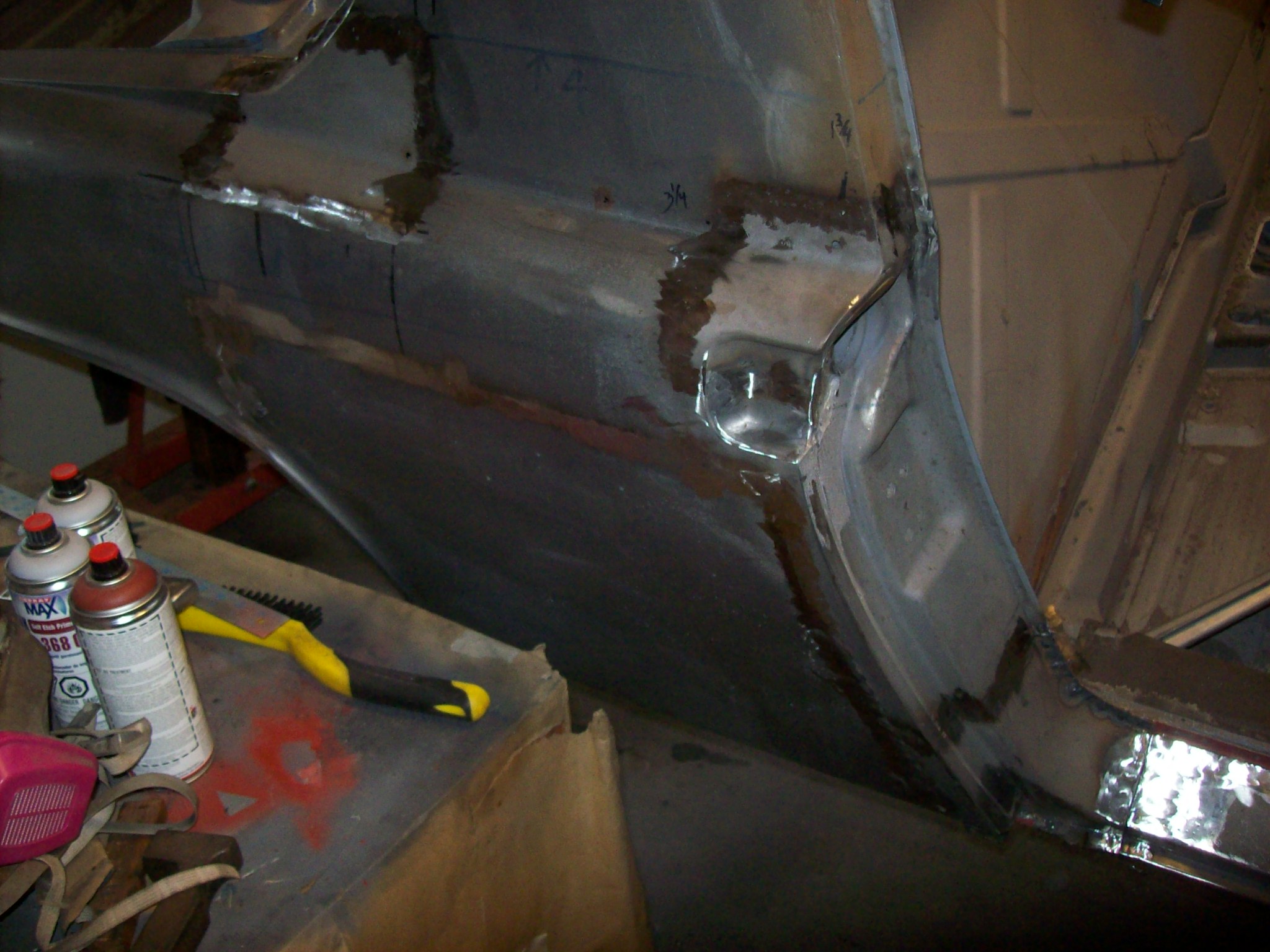

The splice is committed and the inner fender welded up. Starting to rotate the car on the rotisserie to "finish" the welds.
So if I am not going to track the car and the rocker/longs repairs have been done correctly, is the stiffening kit still necessary?

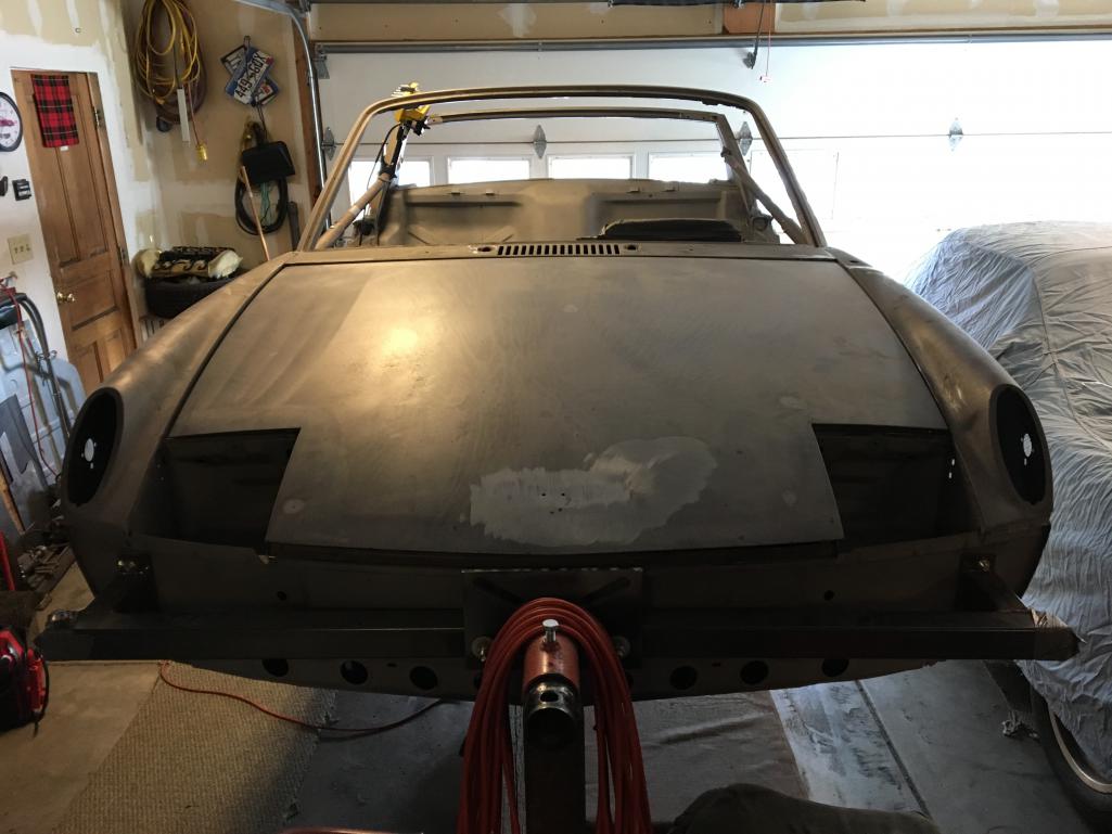

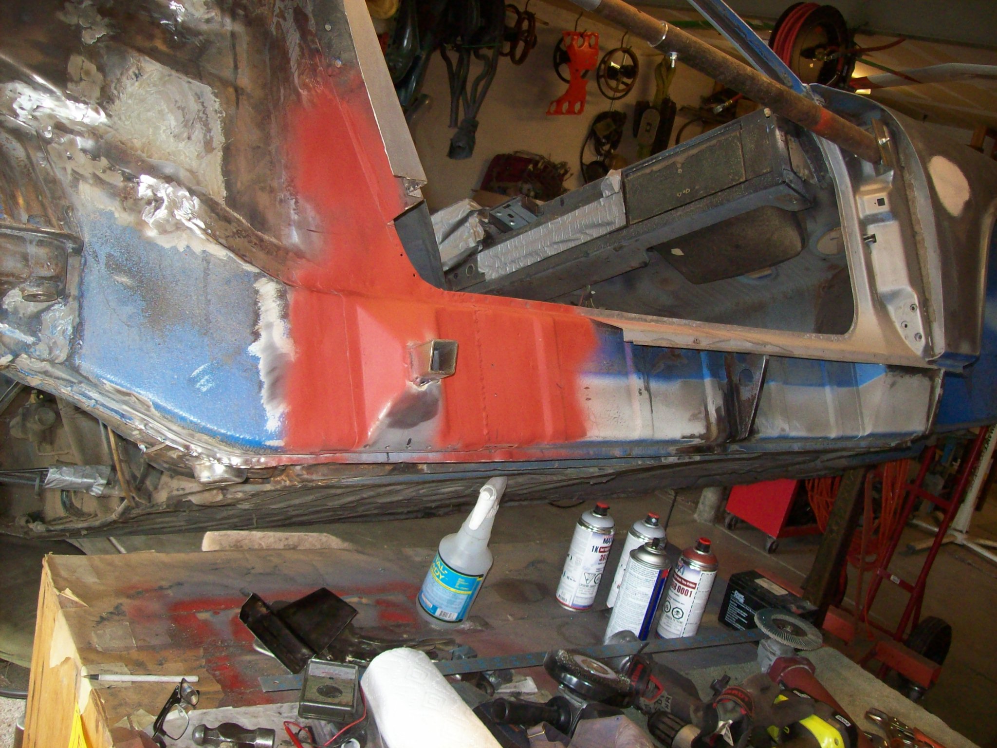

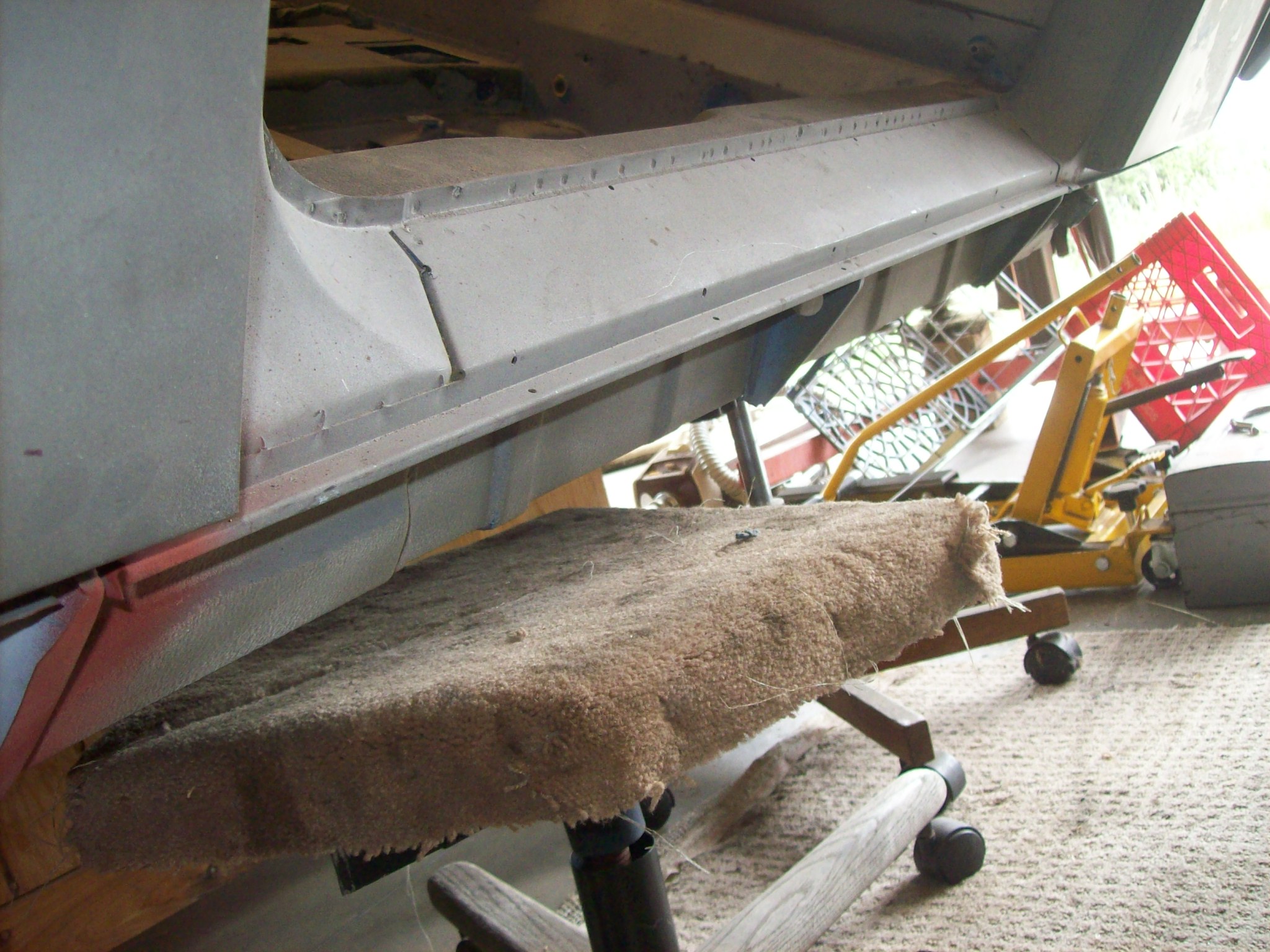

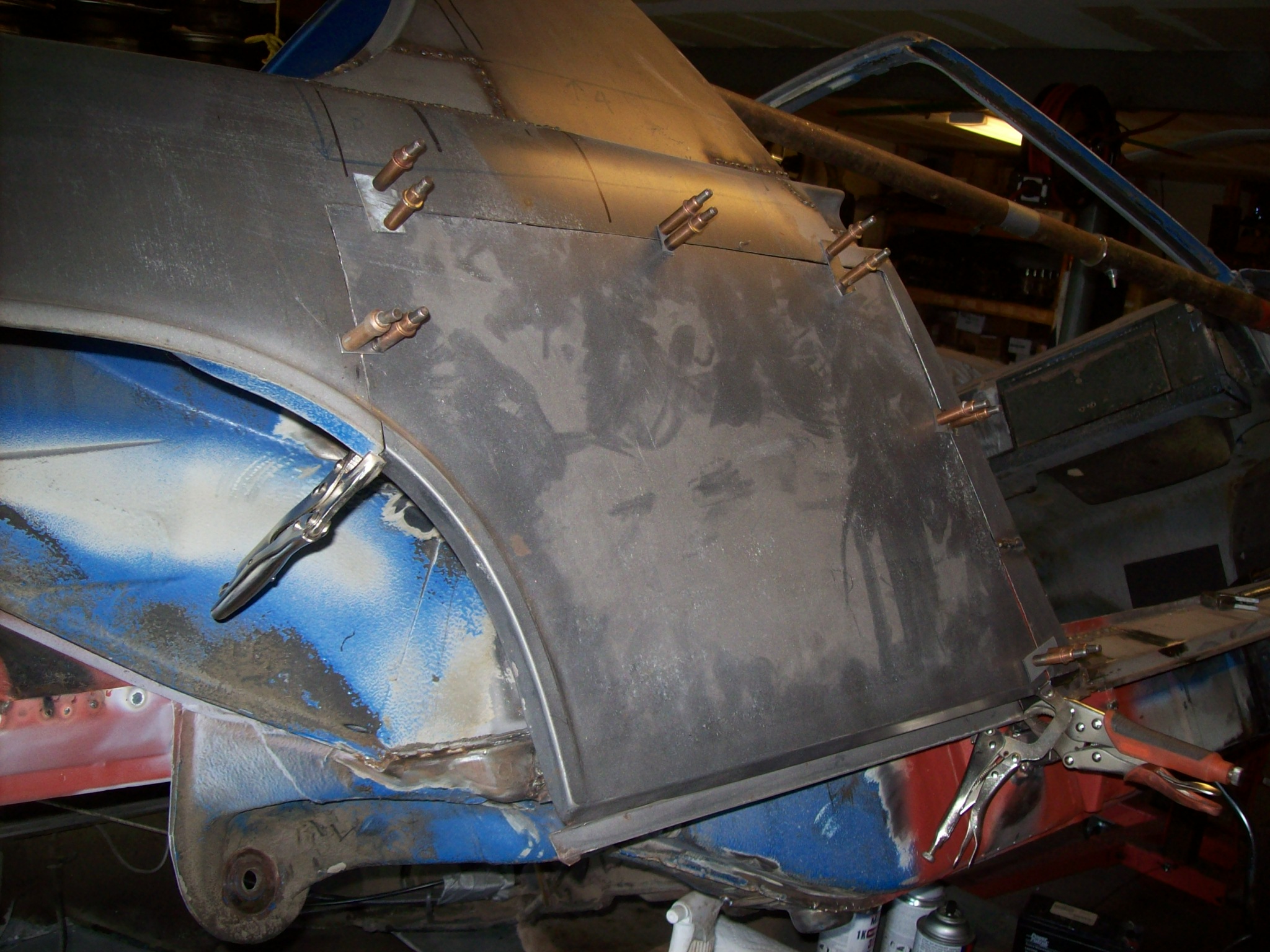

Long time since posting...but a lot of progress made. Decided not to add stiffening kit as chassis was not bad, repairs were correct and it is not a "tracked" six.
You guys have seen all this a thousand times so the dialogue will be minimal. At this point I have gone around the car 360 degrees and I am back where I started.Attached Image

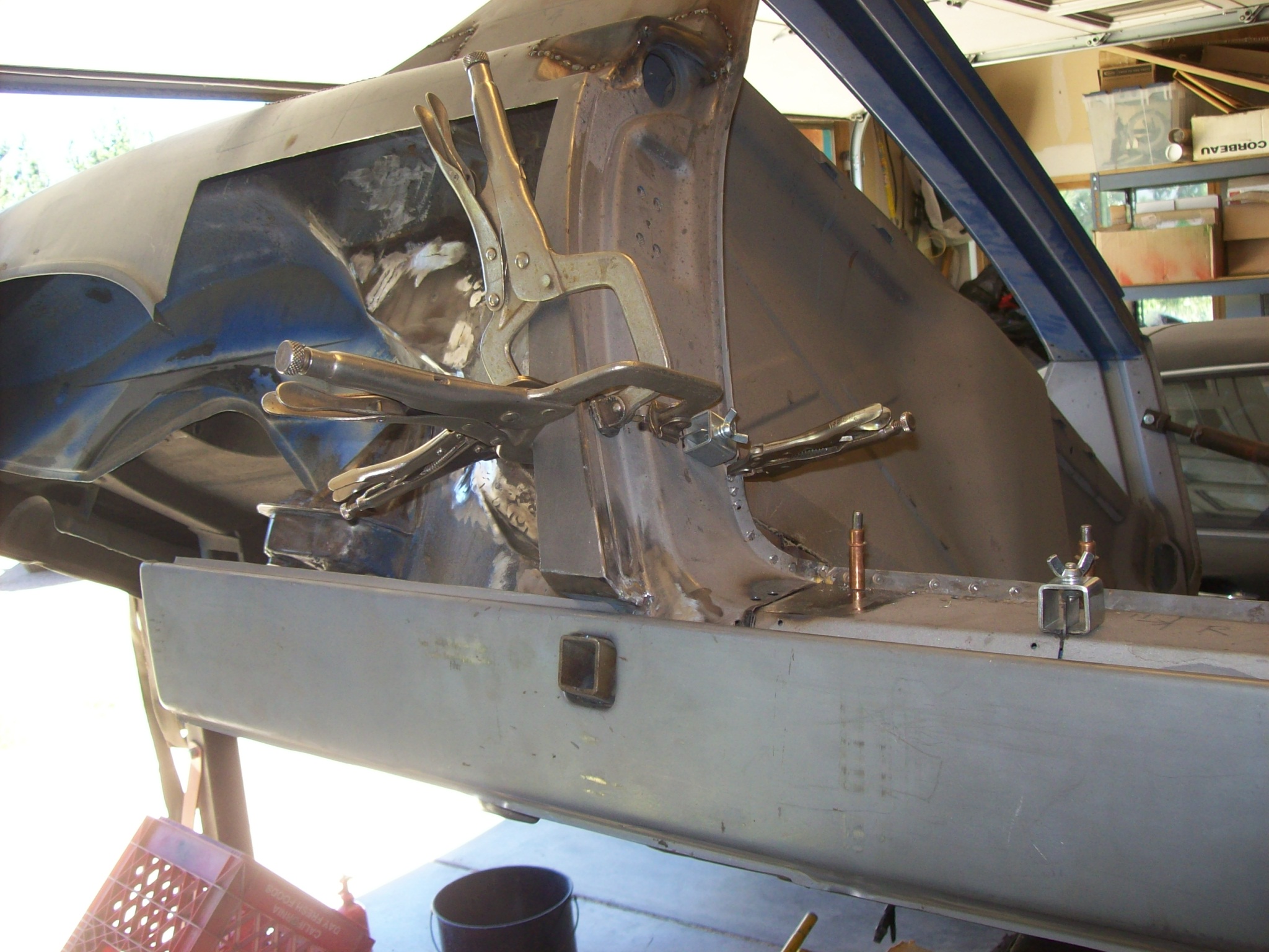

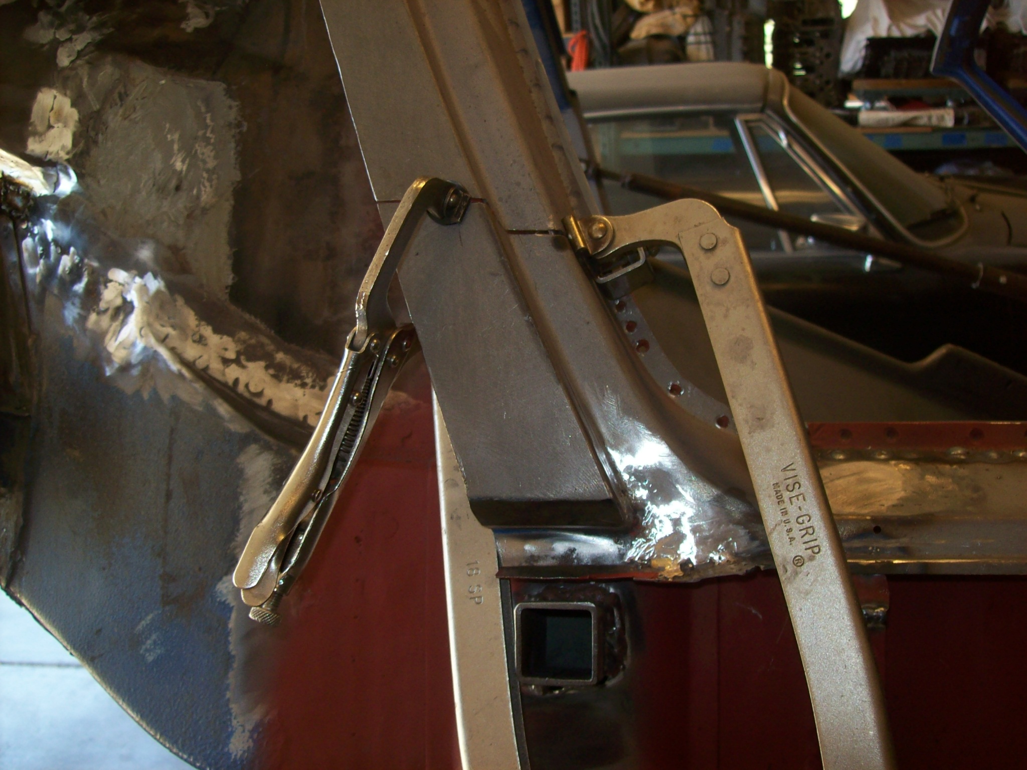

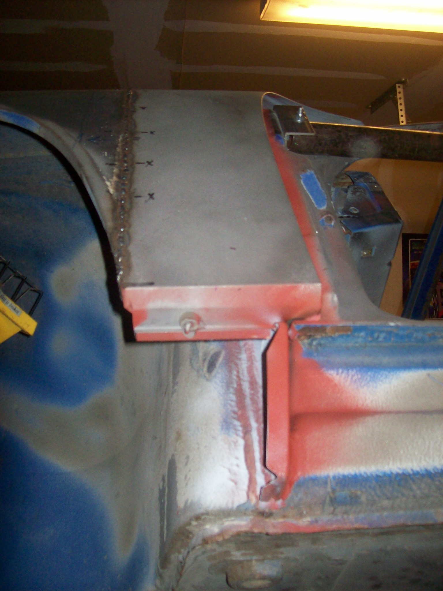

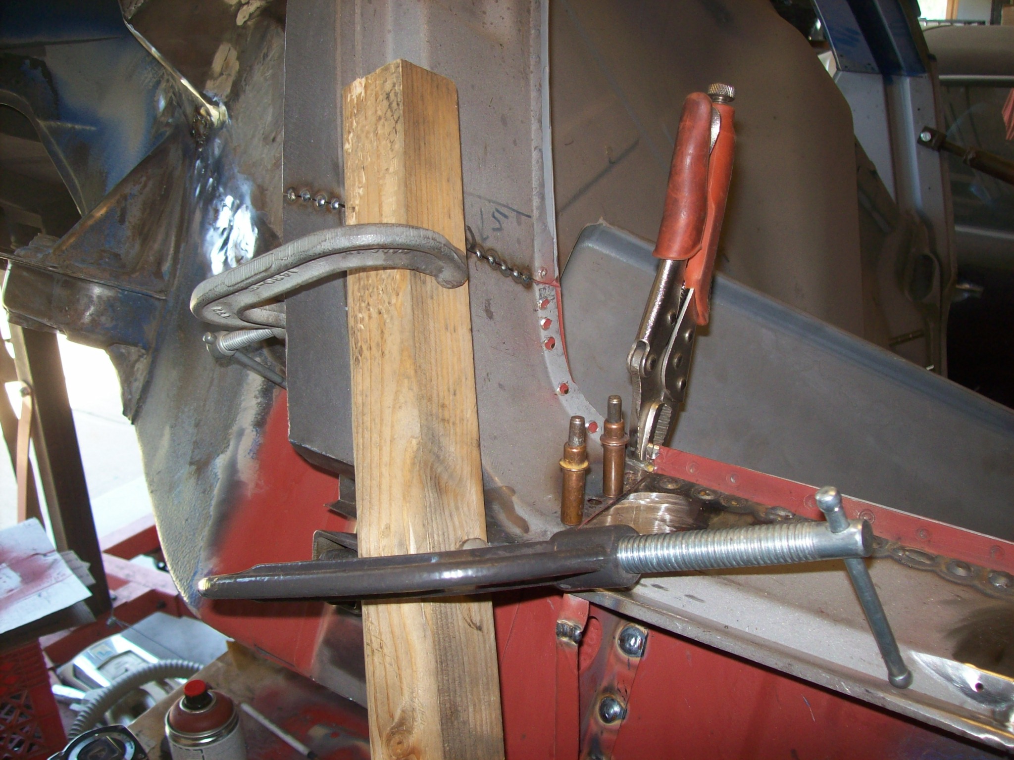

Moving on...welding back in the repaired bottom of the lockpost worried me. Quarter panel was removed which allowed the lockpost to "float". The bottom of the lockpost had welded so the shape might have changed slightly. I measured and triangulated and compared the dimensions with the drivers side 1000 times. I had to "muscle the steel in place to weld using clamps and voodoo.

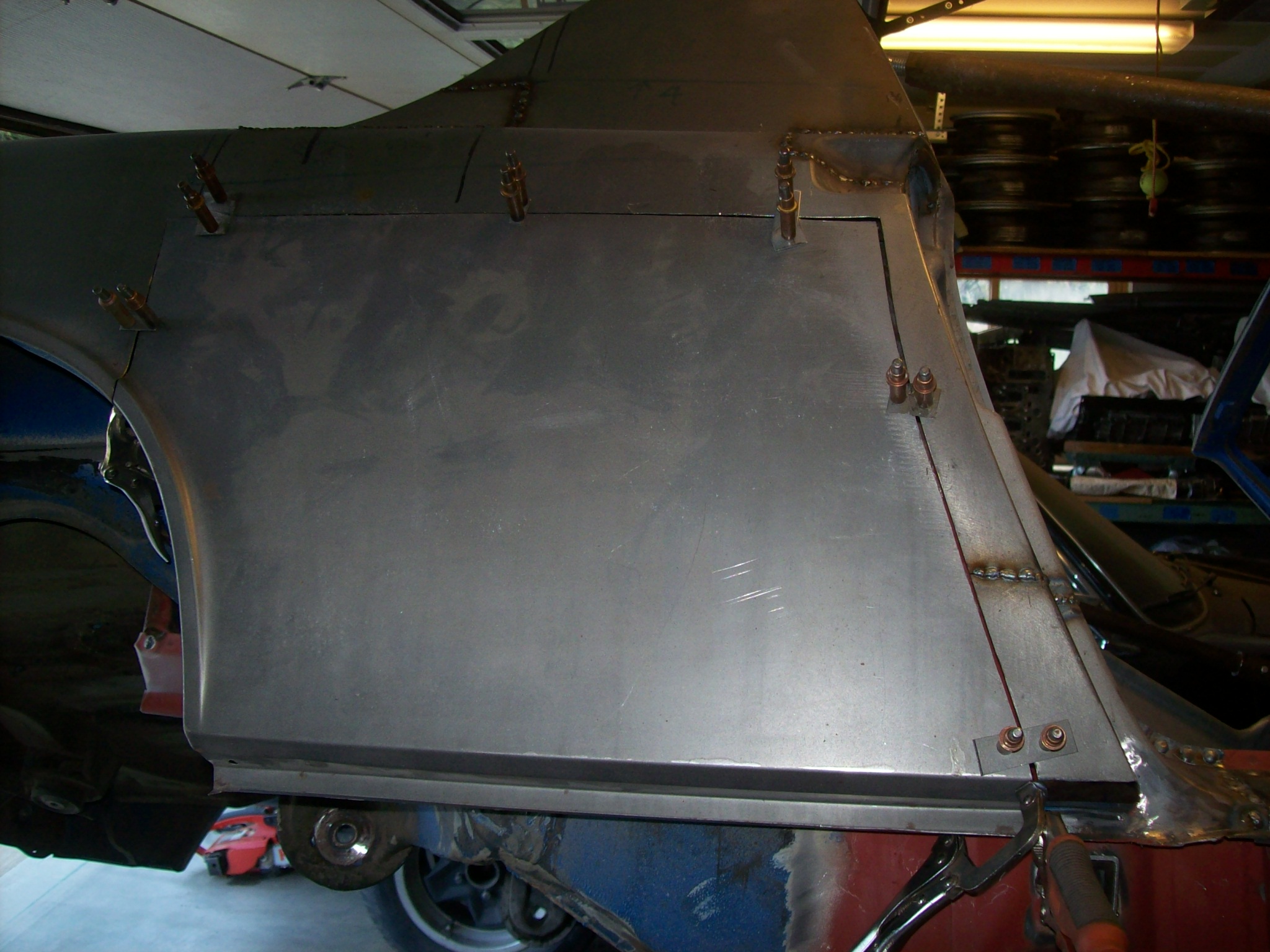

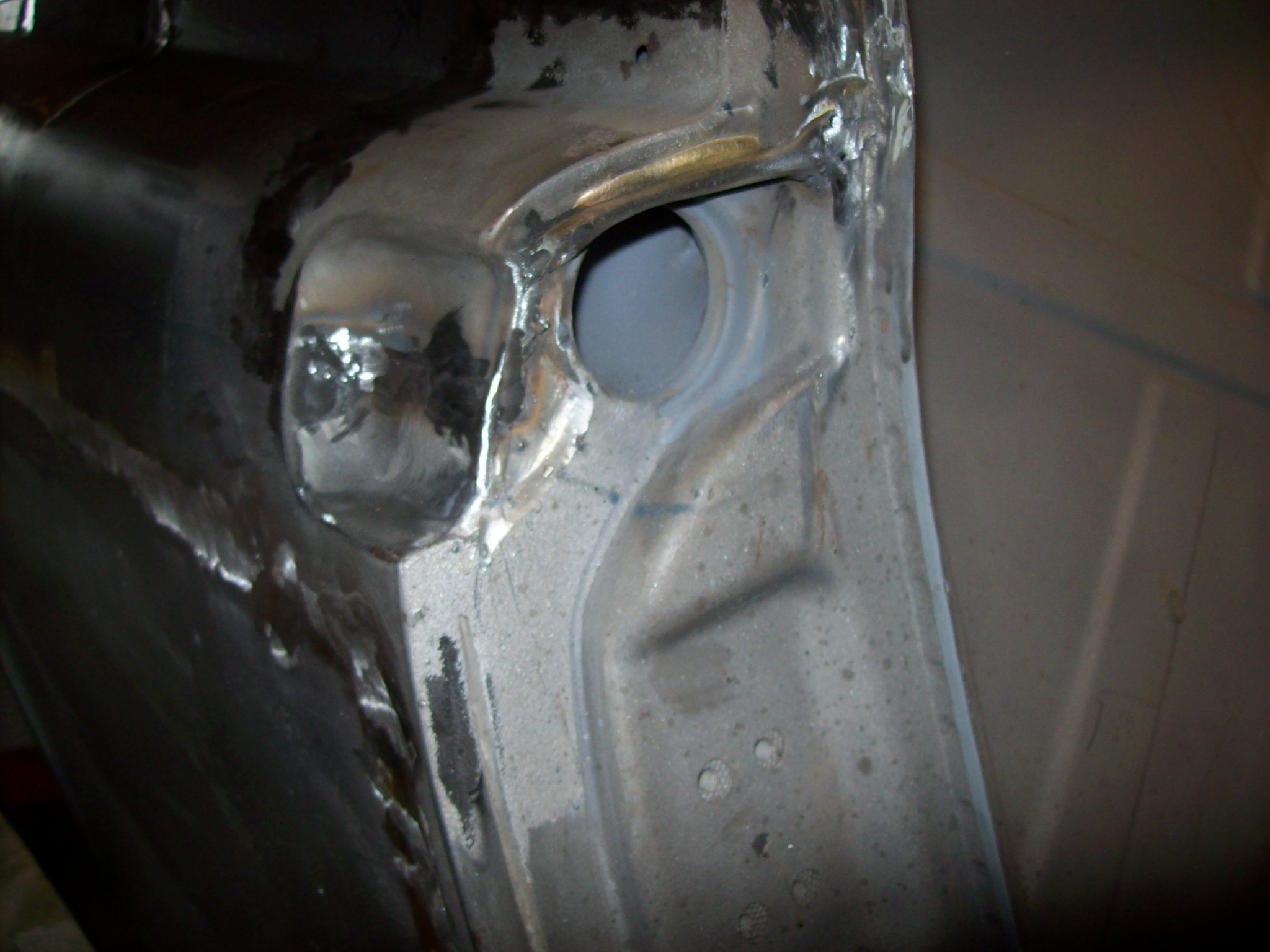

Closer...
With the chassis on the rotisserie, and the bracing in place...no way for me to mount the door to check for fitment. All I can do is measure and measure...and then measure a last time. Quarter panel seems to fit back in ok. A real bummer would be that it was either too large (needing something to be re-assessed), or too small leaving large gaps. Would really like someone to come look over my shoulder before I commit this back to the car. Better to have someone look at it and say..."no wait!!!" now than after it is all welded back up. I have beer... (IMG:style_emoticons/default/drunk.gif)

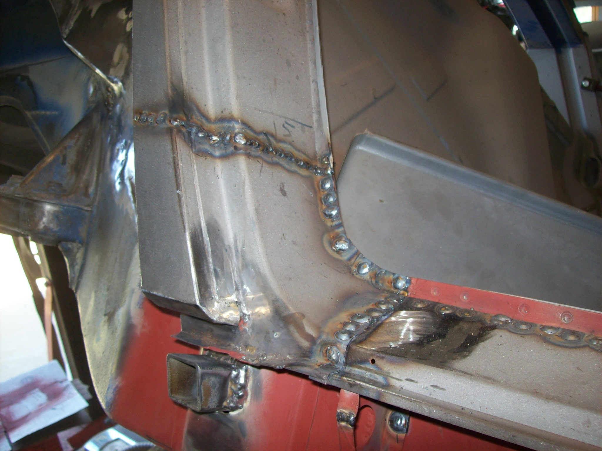

I am done welding. Didn't want to bore folks with welding pictures. I have dressed my welds and ready to prep for paint, but I have some remaining questions...

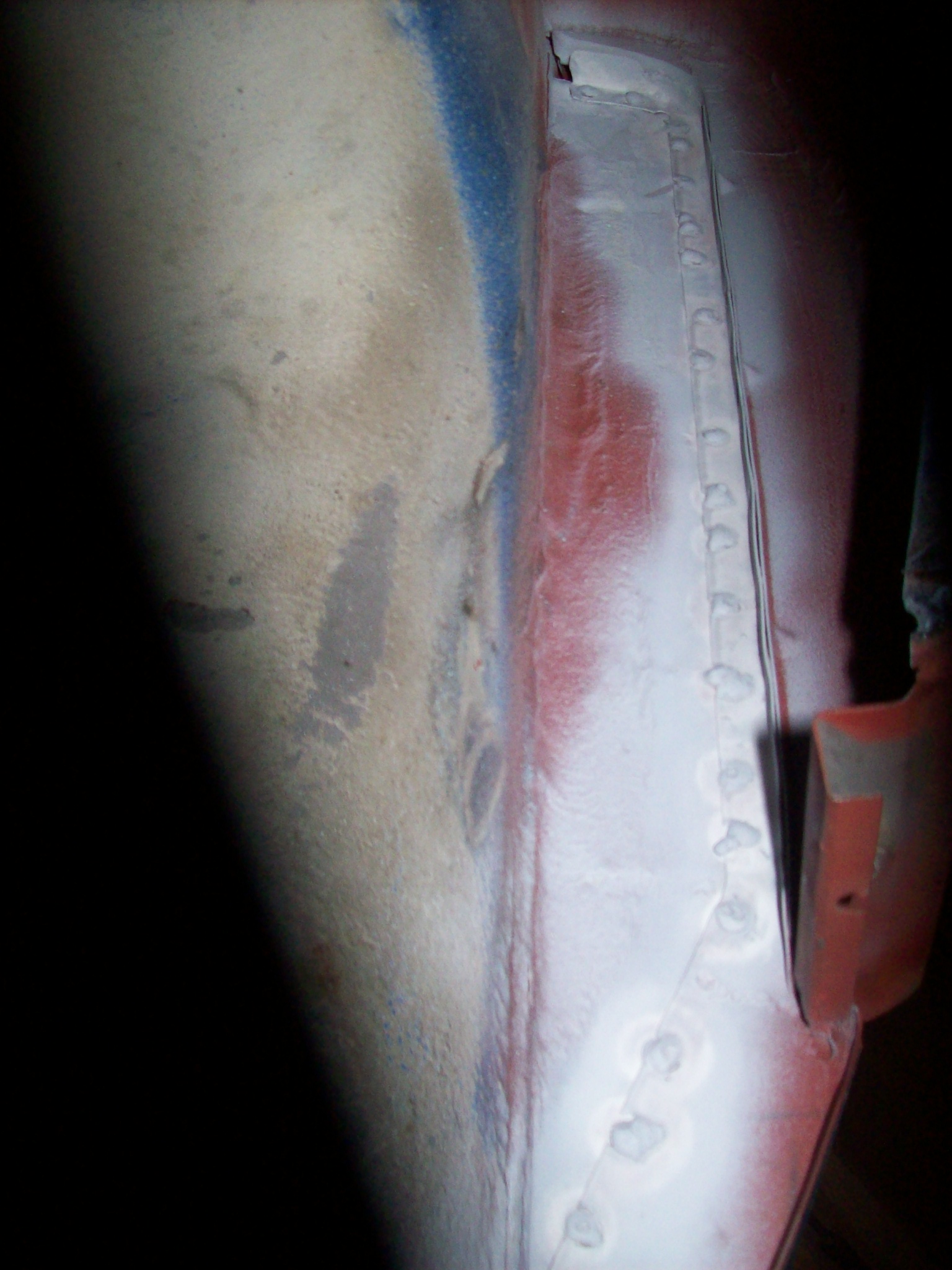

Lot of welding done here to mitigate rust. B pillar area at lockpost/vent area when I have leading "contour" concerns. Having a painter (no Ferg, not him again (IMG:style_emoticons/default/headbang.gif) ) come take a look tomorrow to see how much prep he wants me to do. Gonna put some paint on this puppy...eventually!

Needed to clear out some room in the shop today which required moving the hood and rear lid. Painter had suggested that I check fitment soon...as there has been a lot of metal added and metal heated after all the metal repair. Both fit well, and I was reminded that the rear lid needs some massaging above the latch where I discovered dents under the bondo. Not a bad or complicated fix. Front fits great, and I have to admit it starts to get the juices flowing.
