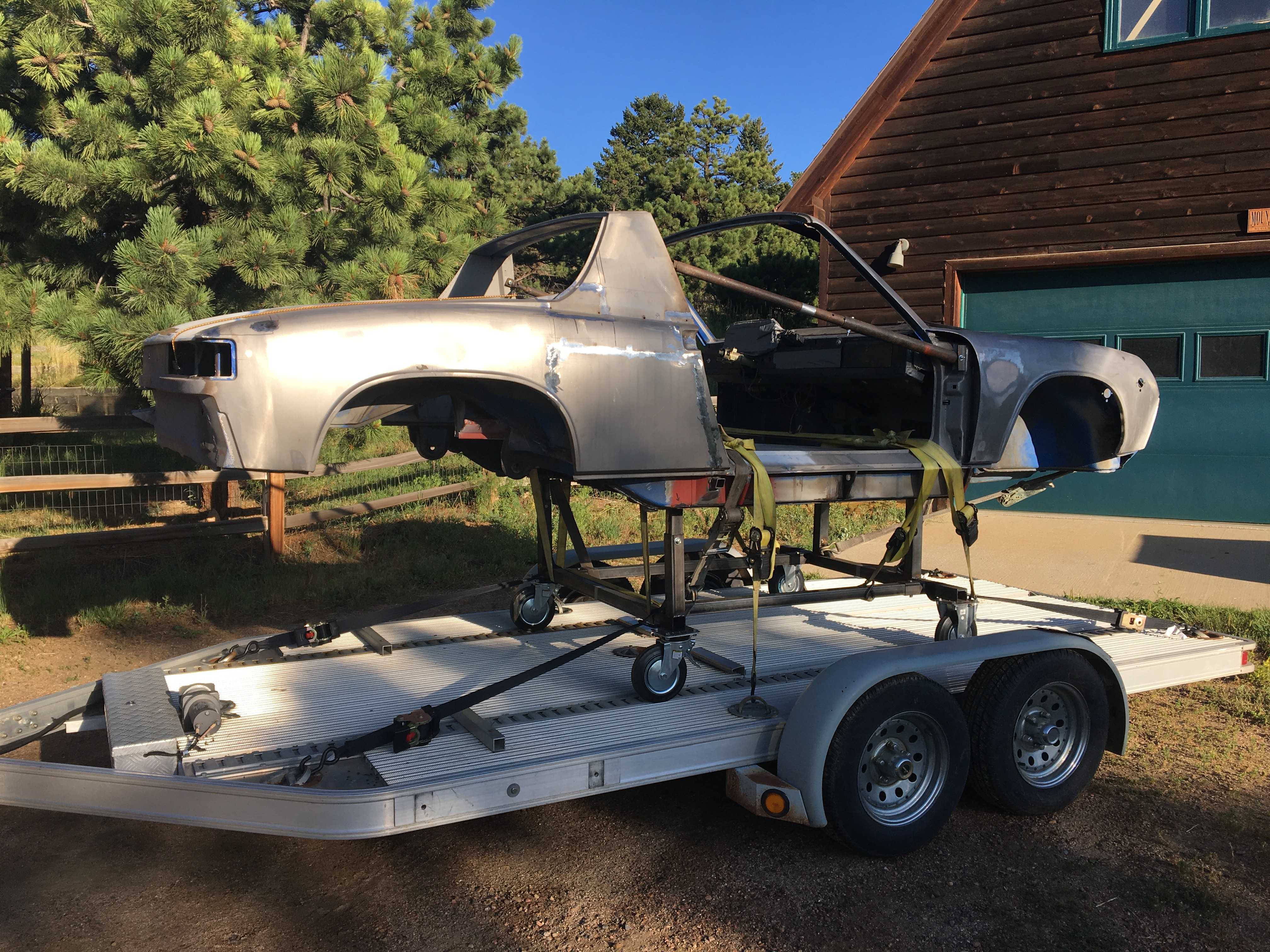

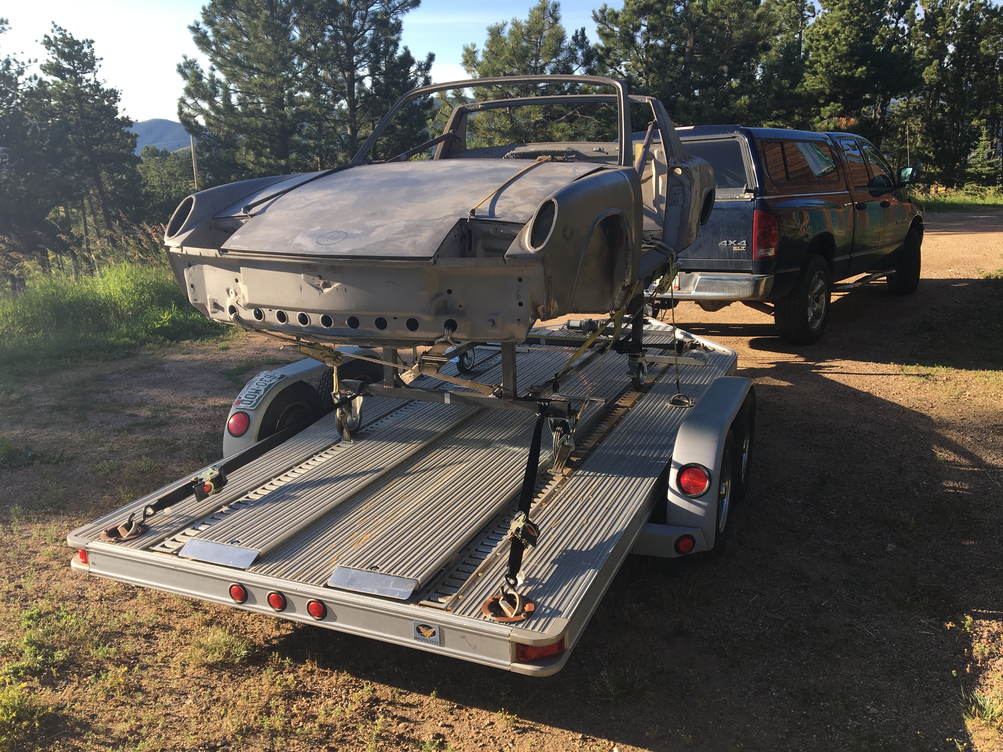

Paint time. (IMG:style_emoticons/default/cheer.gif)
Decision has been made to go with Apex Autobody in Denver.
He (Dave) came and looked at the car a couple months ago and I have been waiting for my turn in queue. I will trailer it down tomorrow am, and do the hand-off. A bit nervous as I haven't worked with them before, but during my visit to the shop, they had some $$ Porsche cars in progress and the metal work looked very good. My recent history with painters has not been great...so this time around I am going to get a written contract with a "not to exceed" clause. He assured me that any further sandblasting would be done on site.
I will need some guidance from the board as to how the body should have been correctly finished. To be specific...the steps involved in the application of "product". Such as ...
primer-seamsealer-undercoating-color and where on the chassis this all goes. I am of the impression that chassis was primed, then seamsealed then undercoated, then color over the entire chassis. Hopefully this is easier than figuring out specific year 911 paint.
He will get the car for as long as he wants...and that will allow me to decide what I will do for the engine. Original engine is pickled. I can rebuild it, or leave it on the shelf and build something different. I have a 2.7 RS spec engine ready to go back together, as well as a twin plug 3.0 MFI waiting to be rebuilt. The EASIEST thing to do would be to build the original engine, and save the hot-rod engines for another day/project.
I'll throw some pics up shortly.
