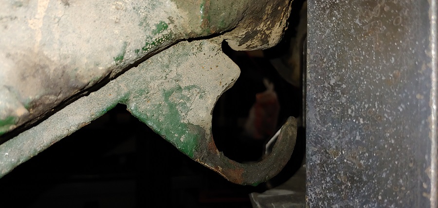

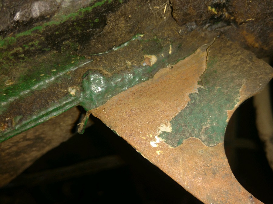

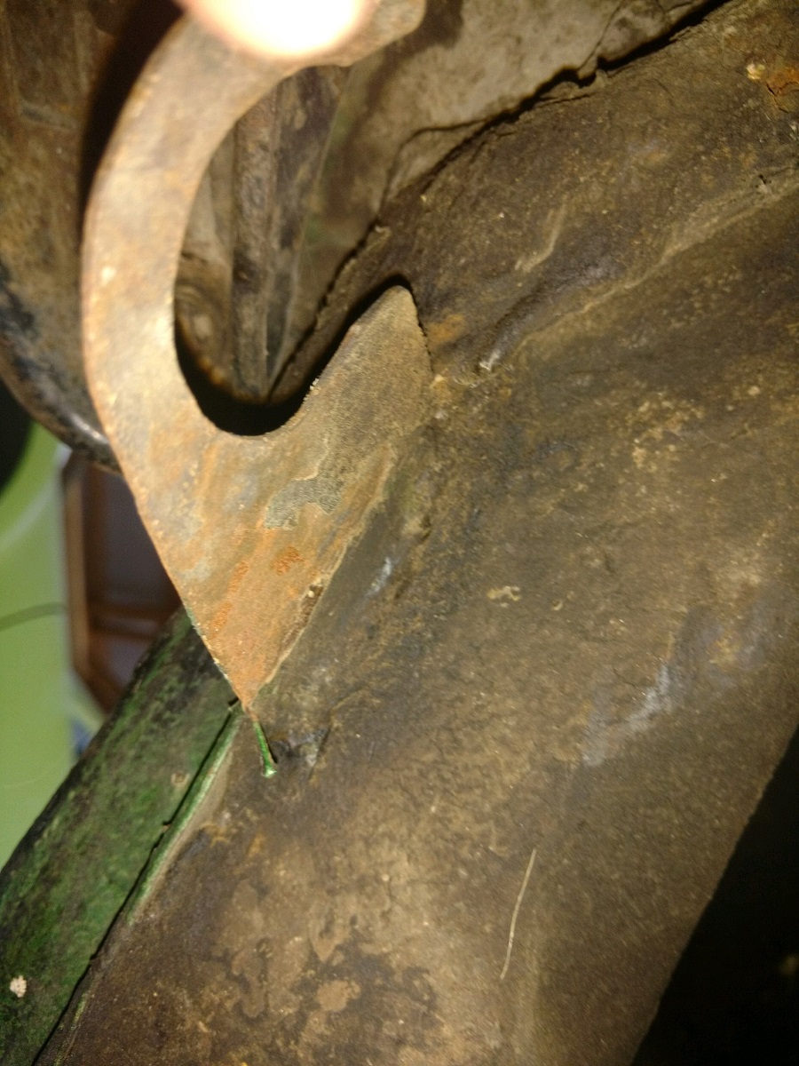

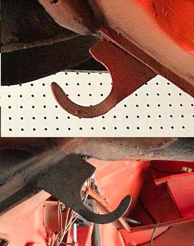

Hi Lars,
The 6 looks good and coming along nicely.
The hook gets welded by the left rear suspension reinforcement plate. On my 914-6 there's a 5 mm gap between the plate and the hook. Posted a few pics for you.
Which trunk plug do you need? Is it the one on the trunk floor that turns and locks?
I may have a spare if so. The hook is being made and sold by RD.

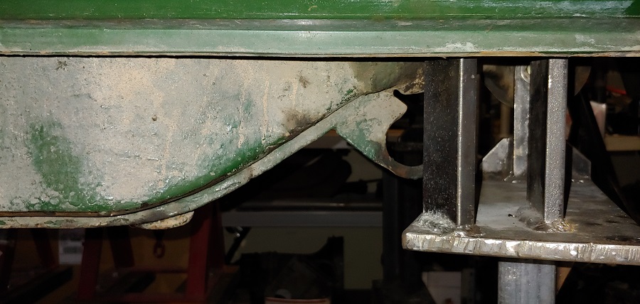

Another set of pictures
.Attached Image

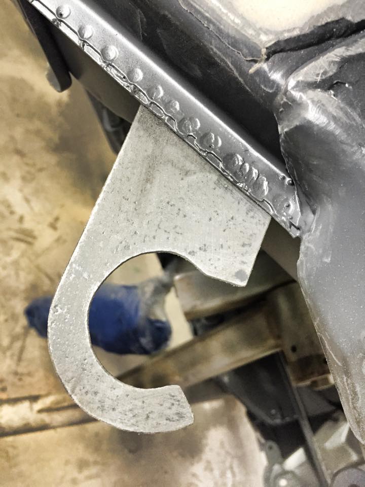

So "restore2seater" graciously sent multiple pics and dimensions of his oil line hook

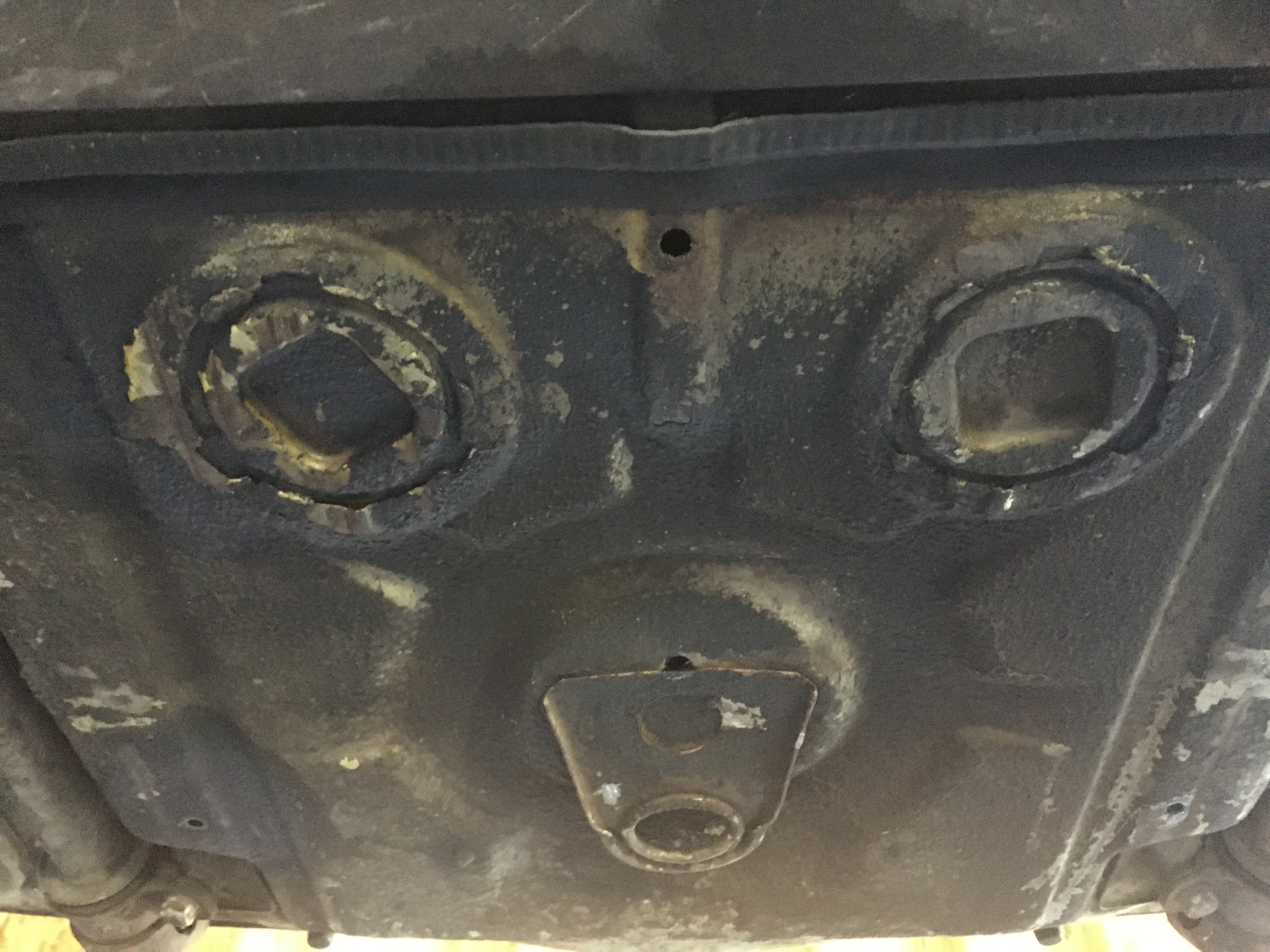

and I was able to fabricate the "hook". My new short term dilemma is sourcing the two drain plugs/plates for the front trunk. Per Porsche these are NLA so my only option is to harvest these from another chassis. My understanding is that once the old seam sealer is wire-brushed off...they can be tapped out easily. I will post in the classified section a WTB, but in the interim if anyone has these, please send me a PM. The picture is of my son's 72 1.7, and I'm pretty sure he doesn't want me to steal these from his car. (IMG:style_emoticons/default/dry.gif) Attached Image
post Jul 1 2020, 09:11 AM
Post #370
914-6 GT in waiting
Posts: 20,625
Joined: 19-September 09
Member No.: 10,825
Yes, the seam sealer (other than rust) is the only thing that secures them.

Oil line hook attachment question. In the first two pics of the green chassis, it looks like the hook is "butt" welded to the edge of the flange. In the second set of pics it looks like the hook lays over the flange and is welded at the base to the outside of the flange. Which is correct? I fire up the Lincoln in an hour (IMG:style_emoticons/default/biggrin.gif)
sixnotfour
post Jul 1 2020, 11:00 AM
Post #372
Posts: 11,199
Joined: 12-September 04
Member No.: 2,744
lays over, factory is spot welded to existing flange..pancake #41

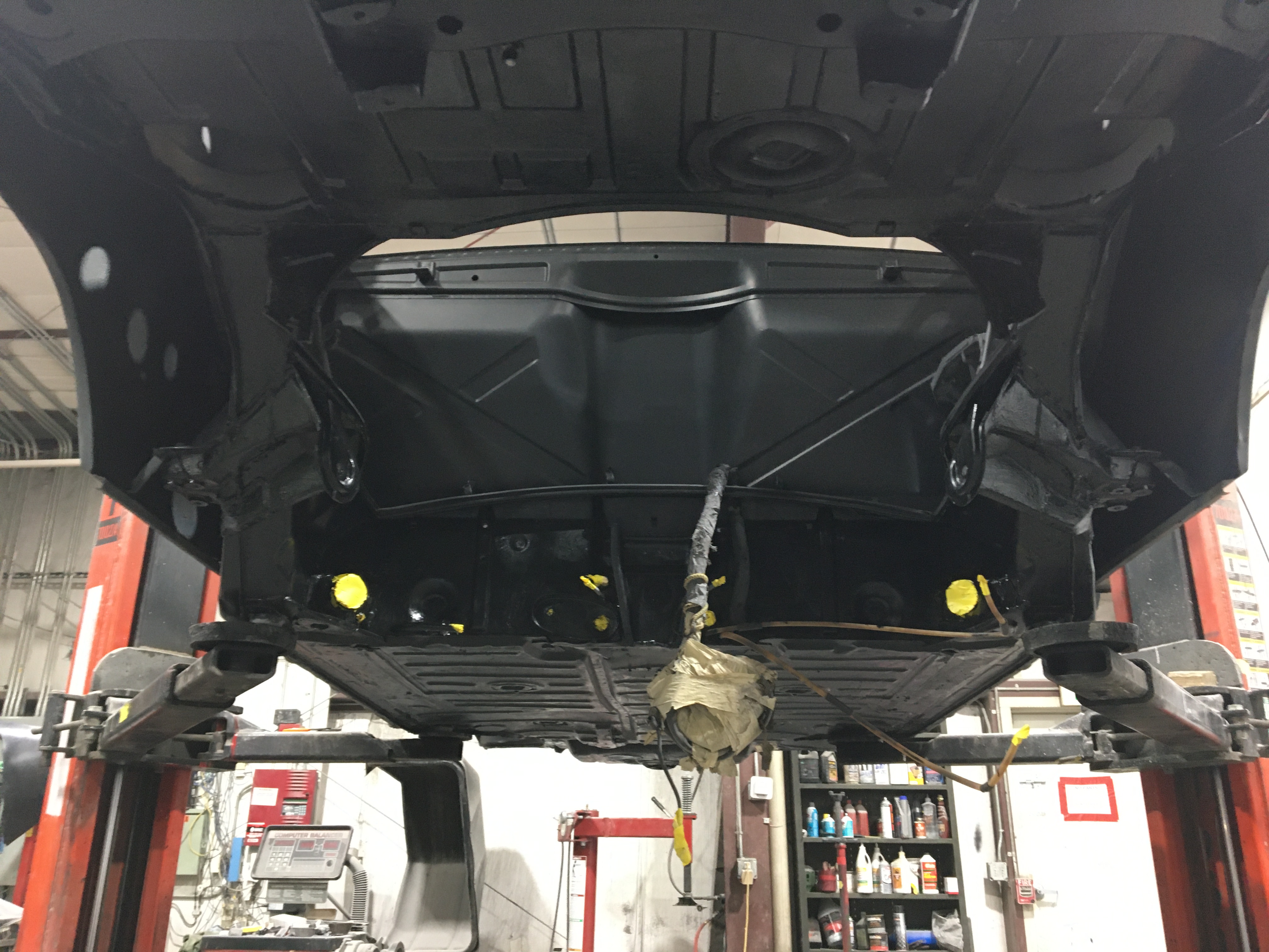

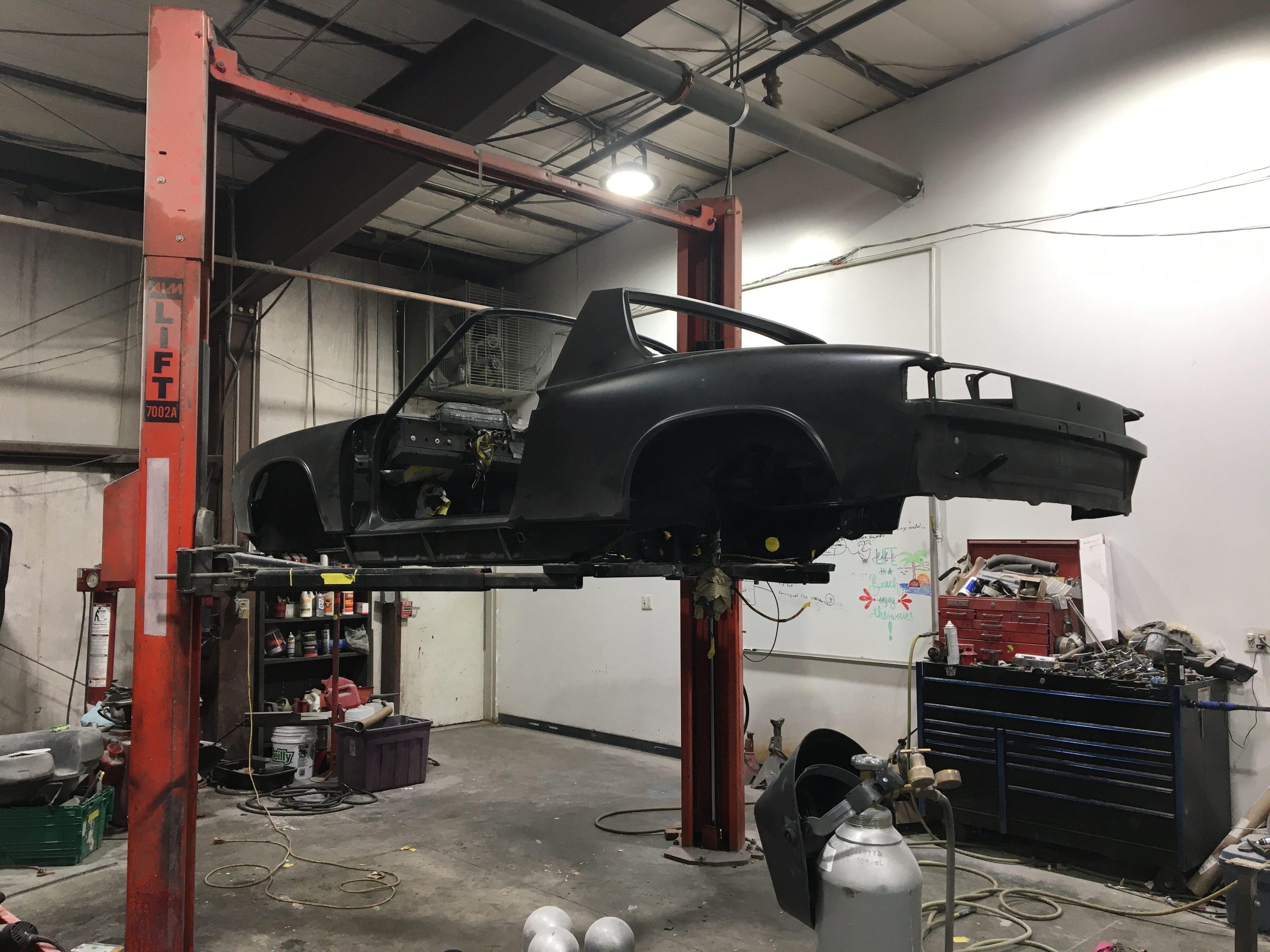

Mig welded the hangar. Spent the afternoon with chassis black. Friday is undercoating. Then color. I'm getting burnt on the underside of this car.

post Jul 1 2020, 06:51 PM
Post #376
Michael
Posts: 10,611
Joined: 1-November 08
From: Auburn, CA
Member No.: 9,712
Going to be well worth it when it starts to go back together. (IMG:style_emoticons/default/beerchug.gif)

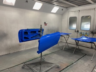

Moving along now...

post Jul 3 2020, 04:26 PM
Post #378
Ridge Runner
Posts: 1,085
Joined: 27-March 10
From: Live Free or Die
Member No.: 11,513
Oooo, nice color!

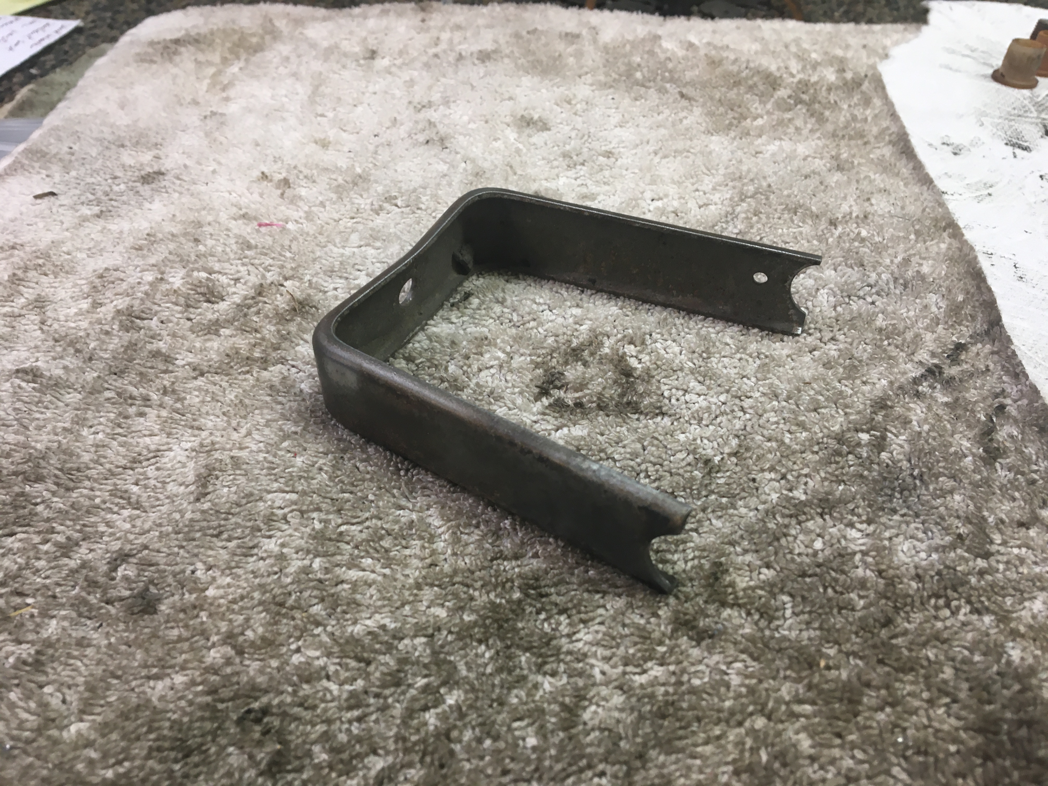

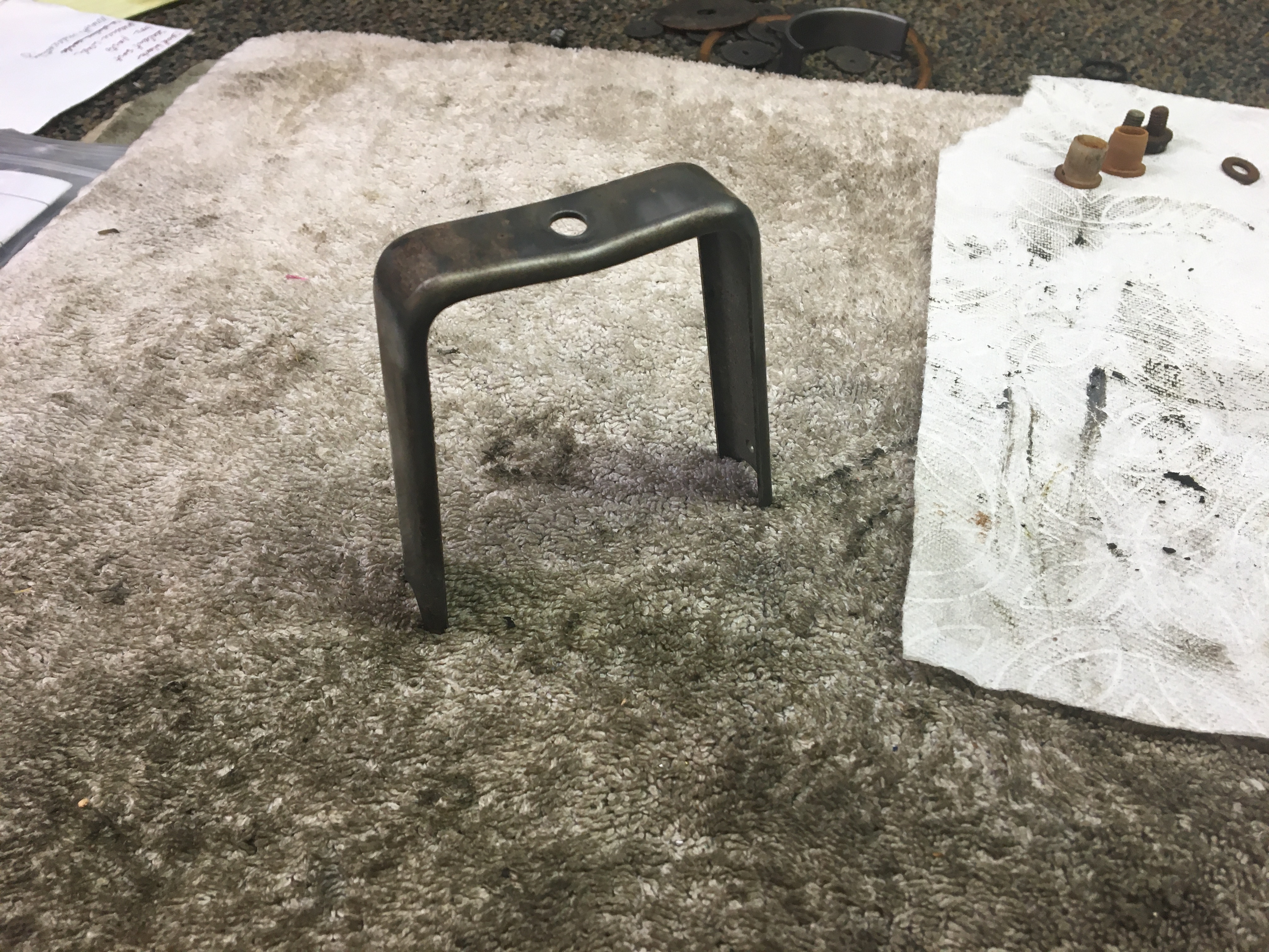

Making sure my painter has all my "bits" and starting a pile of parts for refinishing. Curious about clear vs yellow zinc...my internal door latches are obviously yellow, but it looks as though my lid and trunk latches are clear? Which is correct? Sure would be easier if all the hardware was either clear or yellow. And in one of my boxes I ran across this parts which I cannot identify (looks like it was refinished yellow). On a 911 it reminds me of a bracket that supports the fresh air vent. Can someone id this for me please?Attached Image
