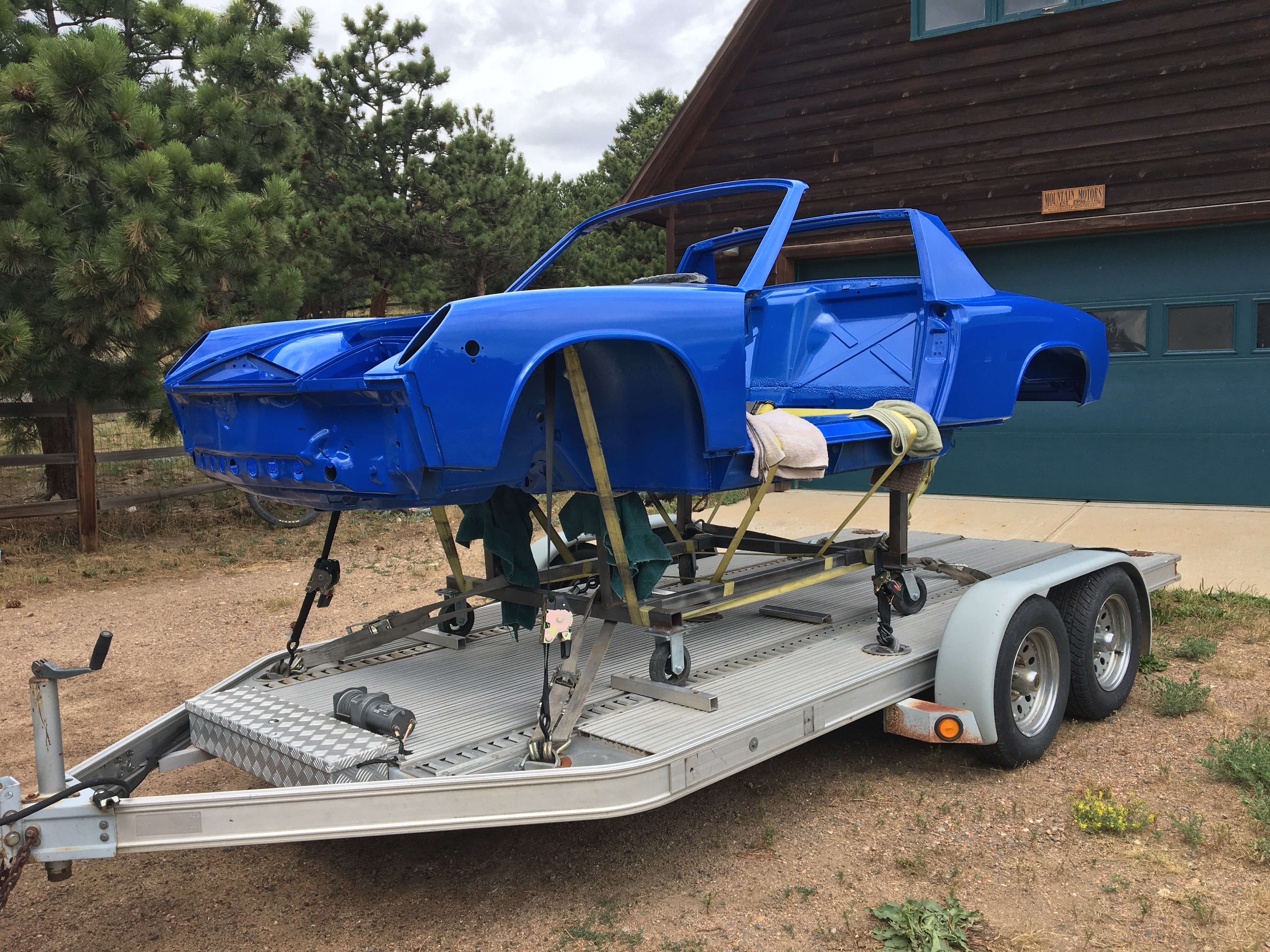

"Not everybody is a car guy"....
Brought the blue beast home this morning. At a stoplight with the windows rolled down, a guy next to me in a Mazda sedan says..."is that a Corvair"? I replied, "no it is a Porsche 914-6". His response was "Porsche huh, wow they sure have changed". I could think of nothing to say so I just smiled and nodded.

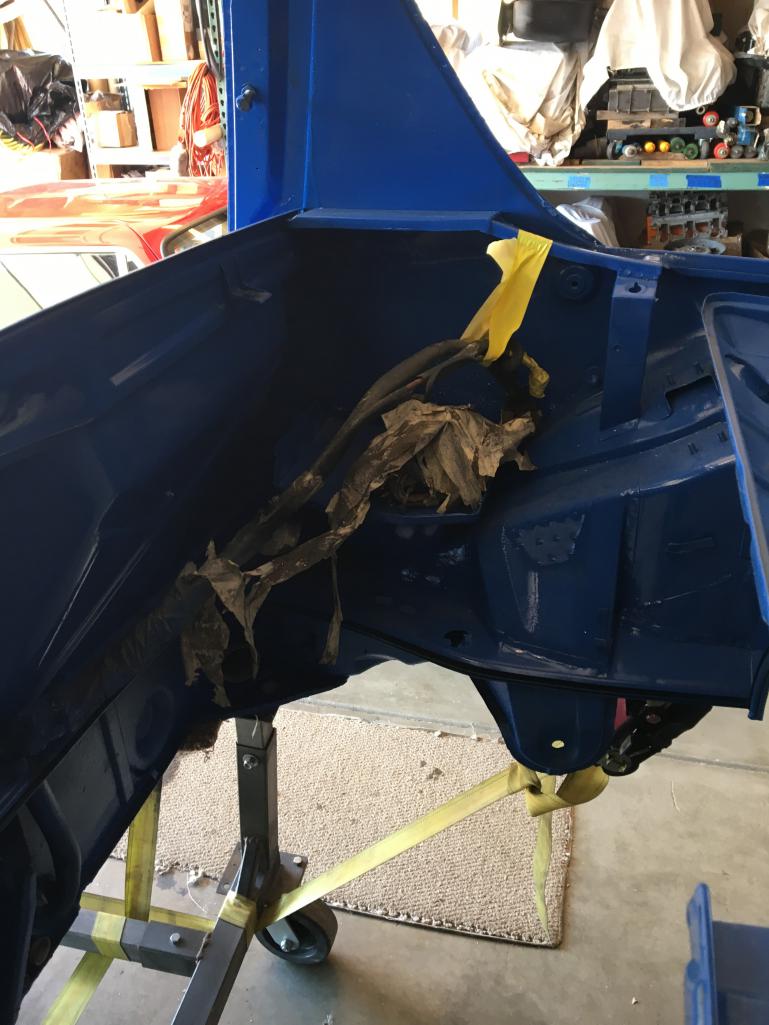

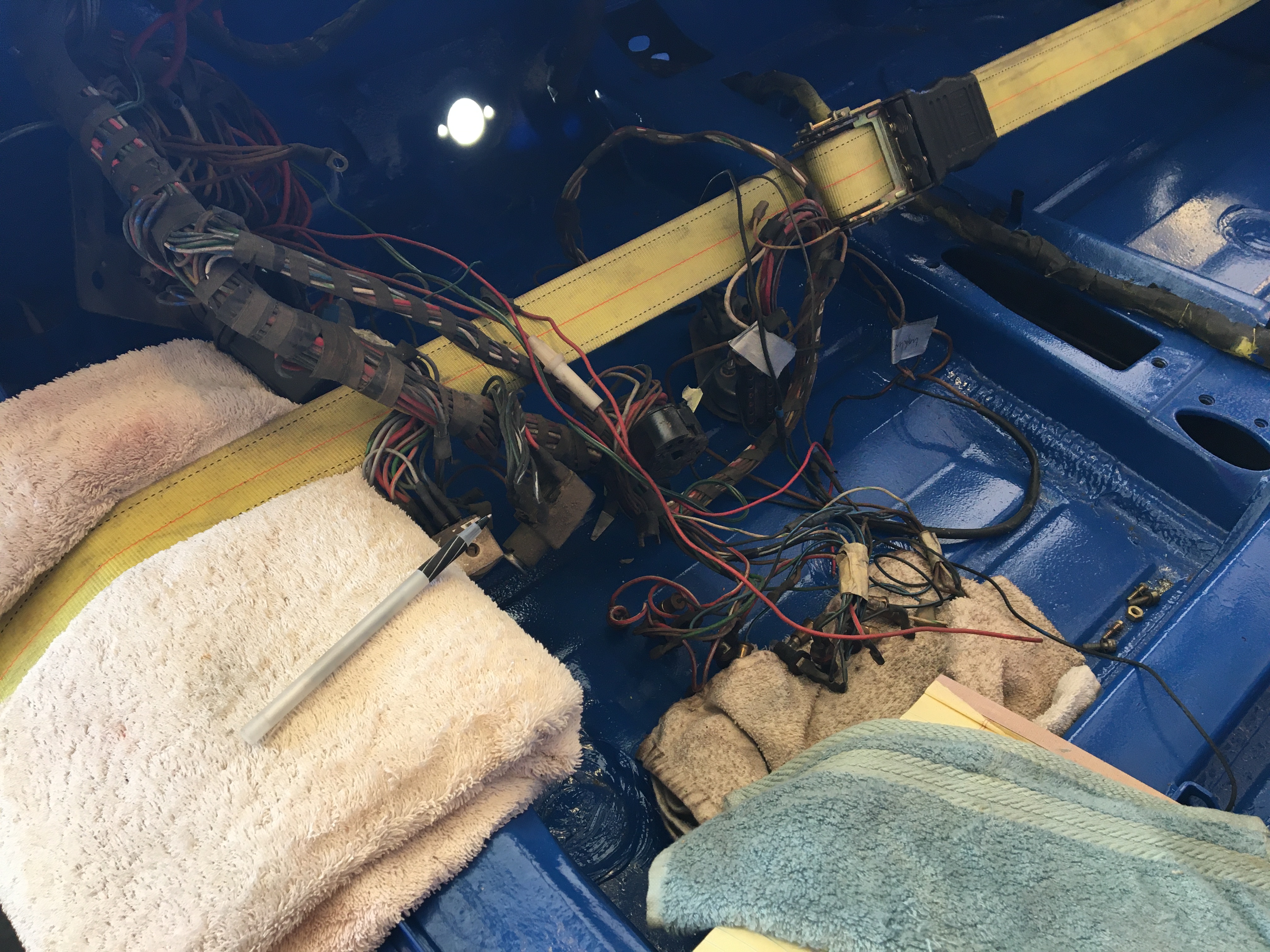

Hornets nest and spaghetti...is what I am starting with.

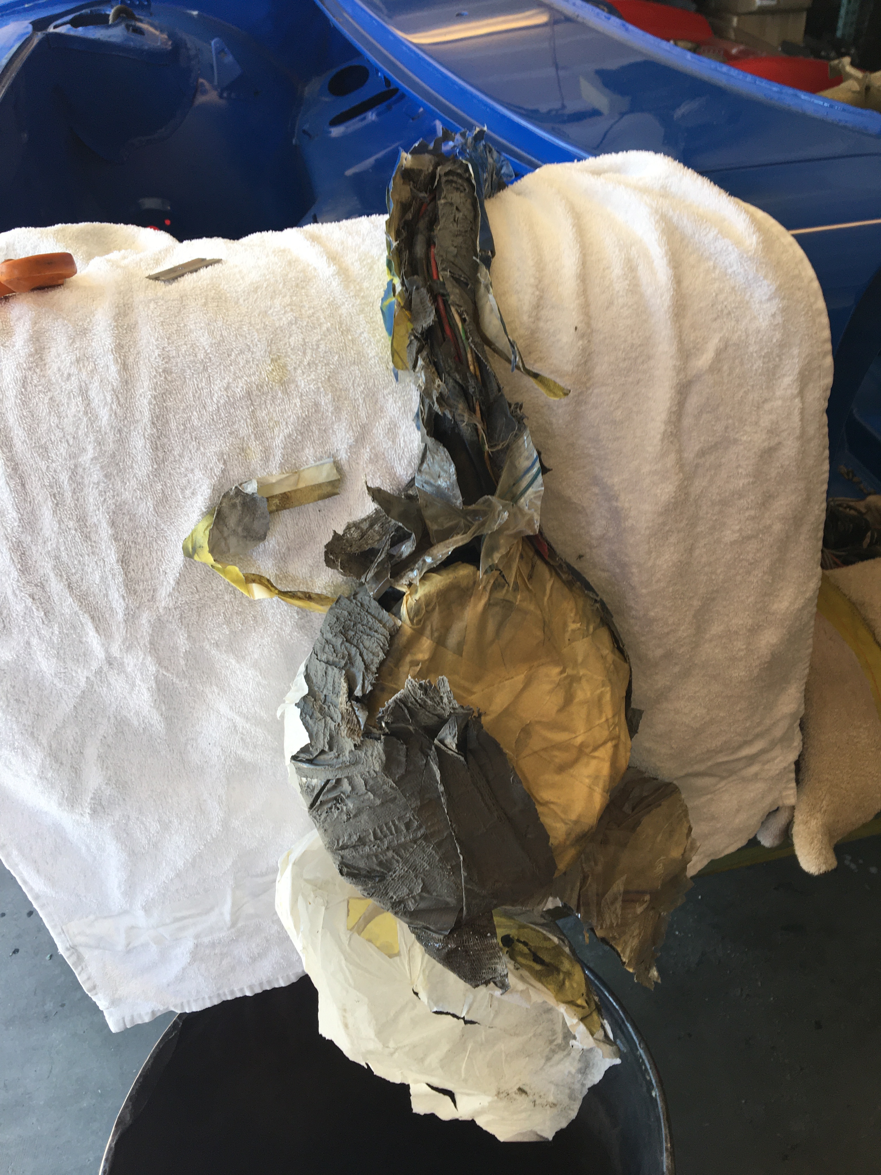

Attractive...

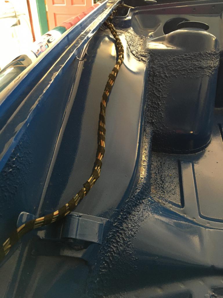

I'm using my son's 72 1.7 to figure out my wiring harness. Front and rear trunks are accessible. Behind the dash and under the gas tank not so much. Can someone post a pic or two of how the harness is routed across the back of the dash and down through the bulkhead/firewall into the front trunk please? I need to order some grommets (914 Rubber) and some black cloth wiring harness tape (vendor?) before I secure the harness to the chassis. Is black shrink wrap the best way to re-cover the wire "hold-downs"?
Suggestions are appreciated.

914 Rubber has the cloth tape.

Hi Lars,
The 6 looks good in paint. 914Rubber has all that you need, tape, grommets, and the wire hold down inserts. I got all of my parts from them so I'll be ready when my time comes.
As far as wiring layout check out the links. It'll will give you an idea where the harness goes. Hope it helps.
http://www.914world.com/bbs2/index.php?showtopic=78492

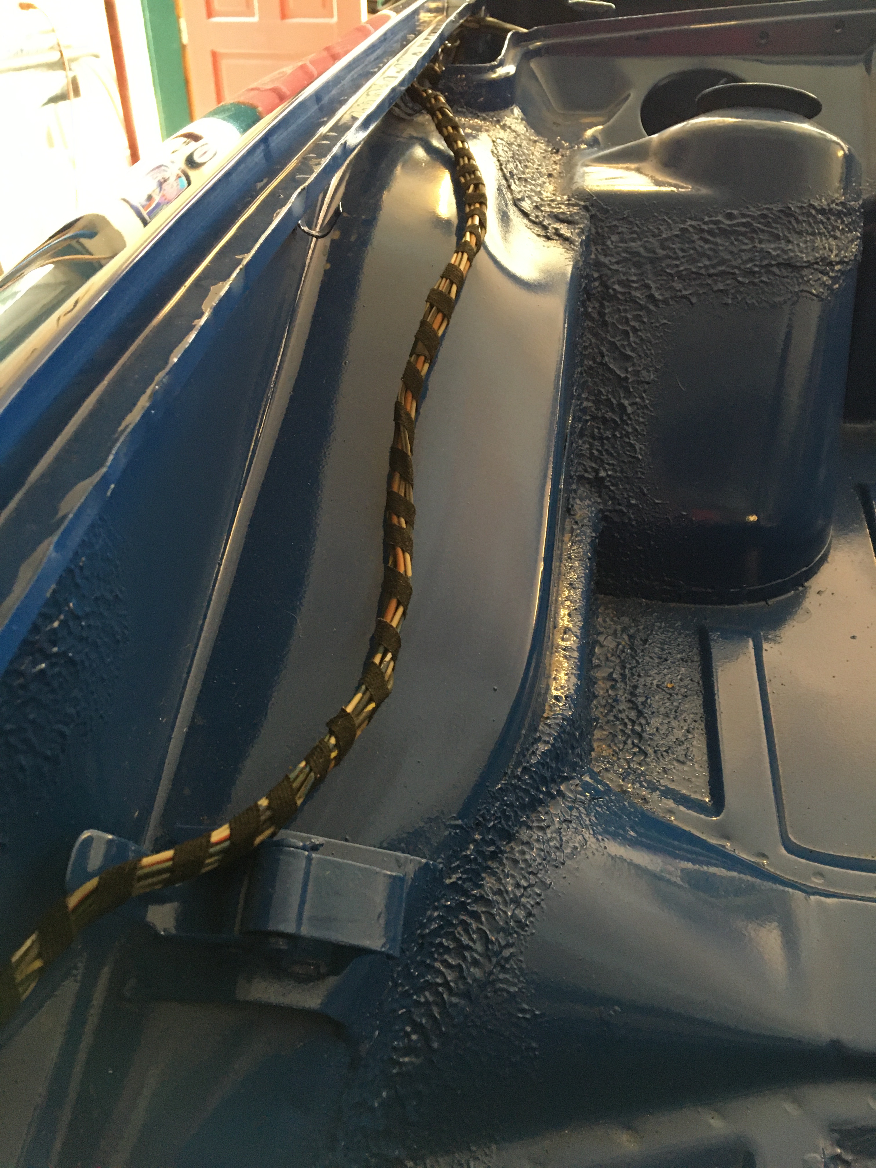

Unwound the hornets nests and started working on cleaning up the wiring. PO had done a hack job on the harness. I had a stereo wired in, and a few extra gauges for oil pressure and voltage as well as a plug for a trailer (PO was big on auto cross and me thinks he had a tire trailer. Got rid of the un-necessary and cleaned up the harnesses. All of the cloth tape was trash, but fortunately my replacement black cloth tape had just arrived. Looks a lot better...
