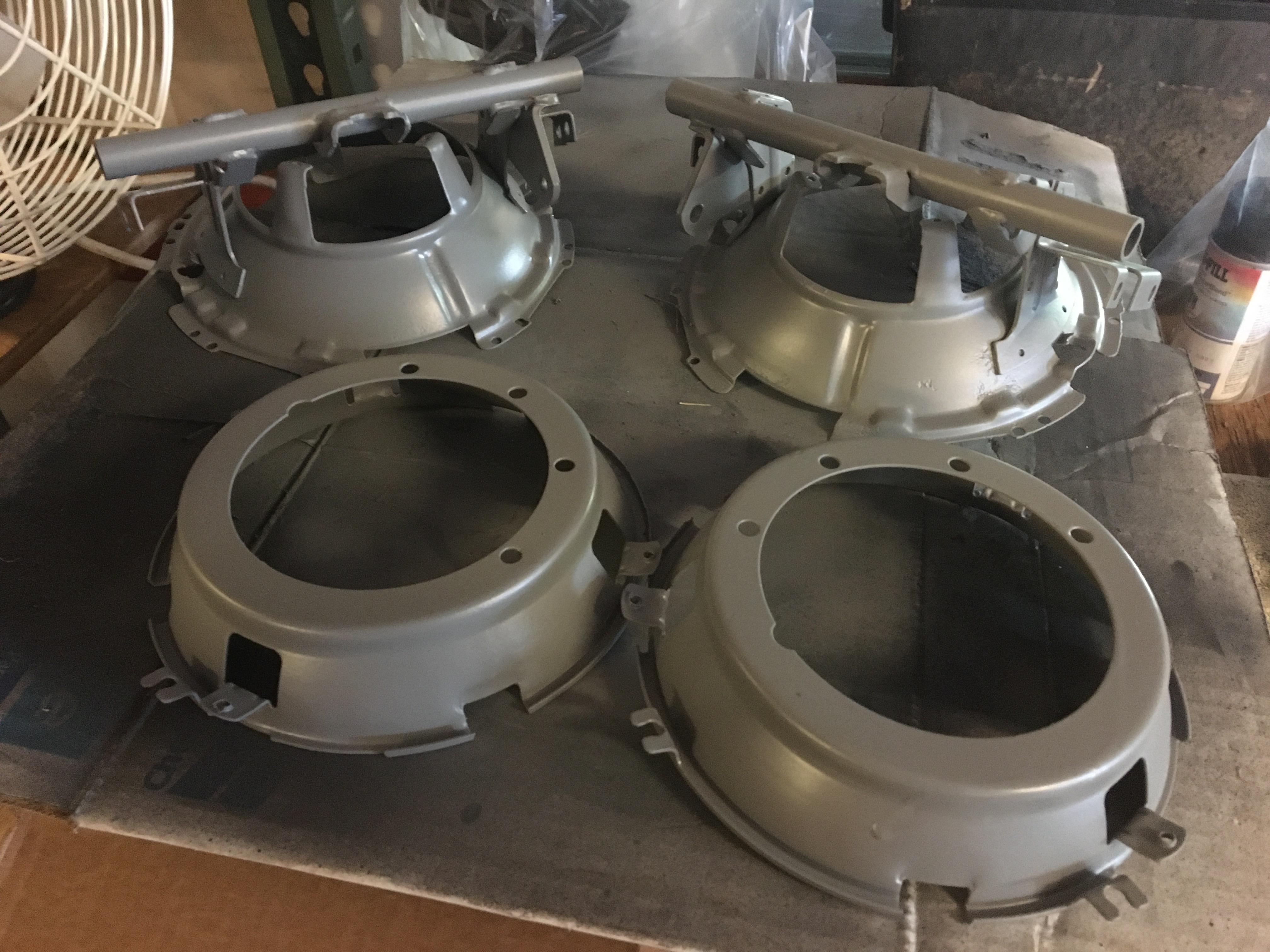

Four big boxes of stuff arrived from 914Rubber. New dash, bumpertops and miles of rubber seals. Going to work from the front to the rear of the car. Lights horns and fogs first. The mechanisms were incorrectly painted black by the painter, They are now the correct grey. Attached Image

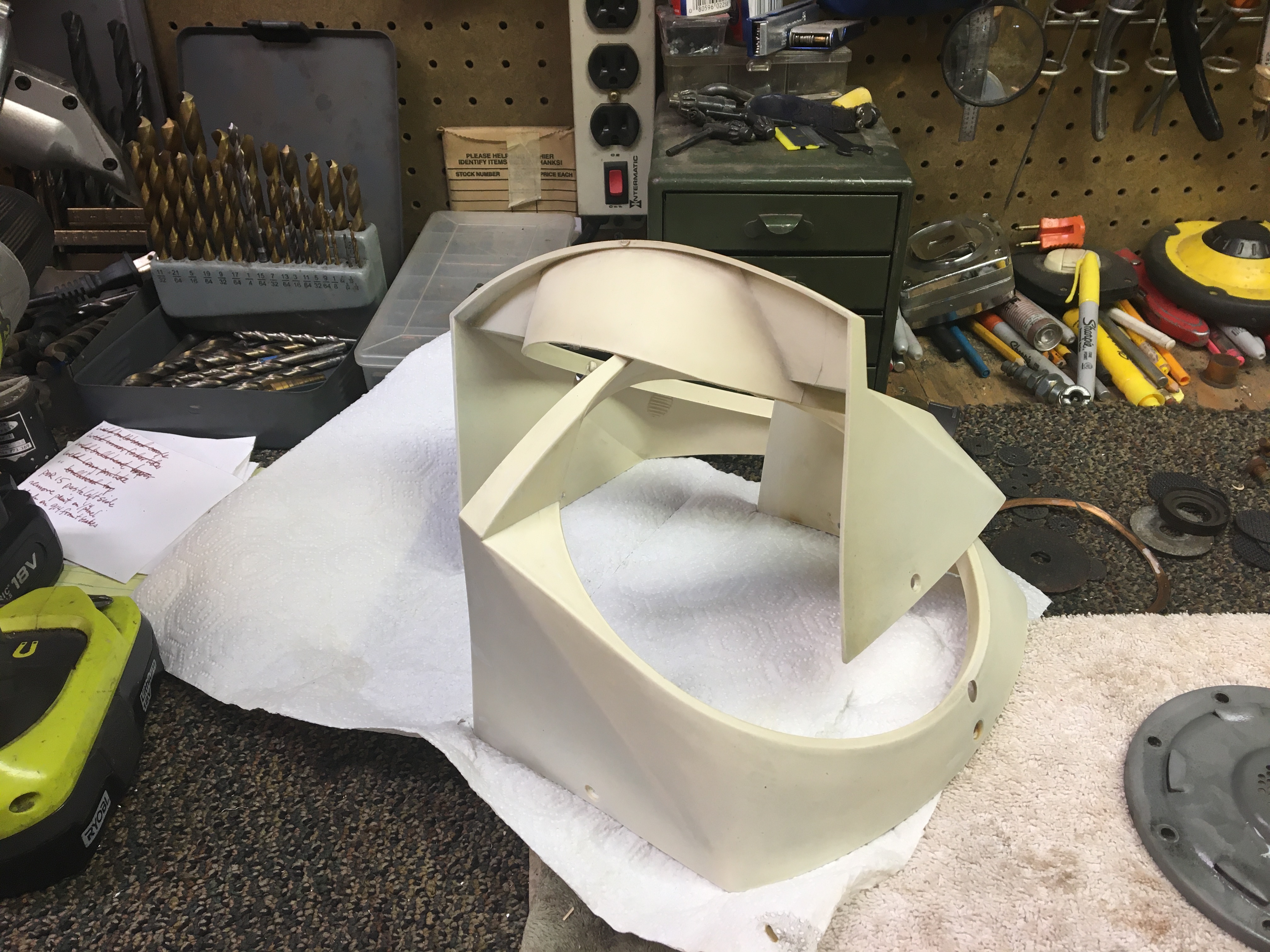

I was going to paint the faded plastic headlight surrounds but was coached to bleach and scotchbrite instead...worked great.Attached Image

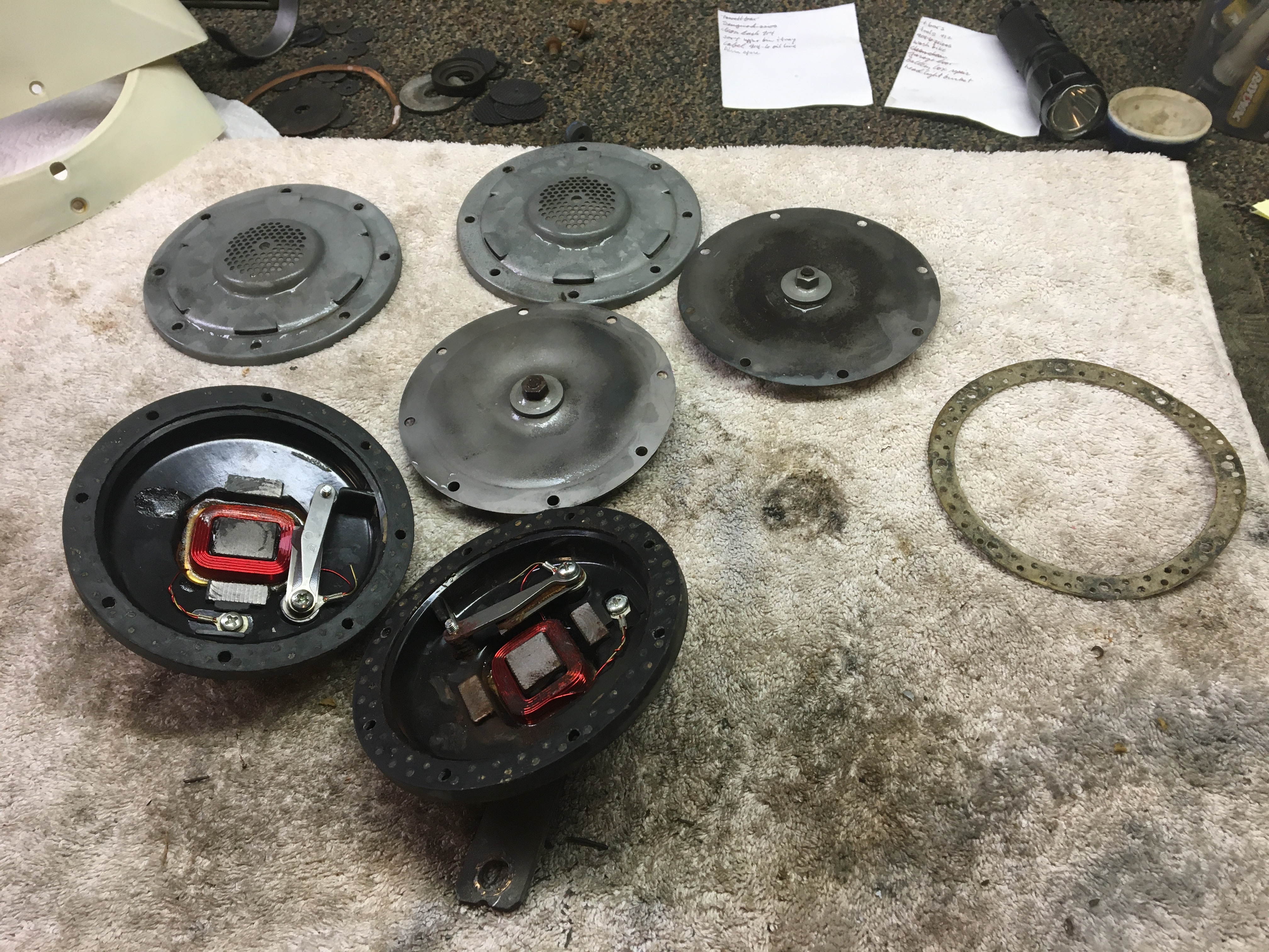

One of my horns worked (barely) and the other not at all. I disassembled the horns, repaired them, sandblasted and now will paint. I am to assume the same grey as used on the headlight mechanism?Attached Image

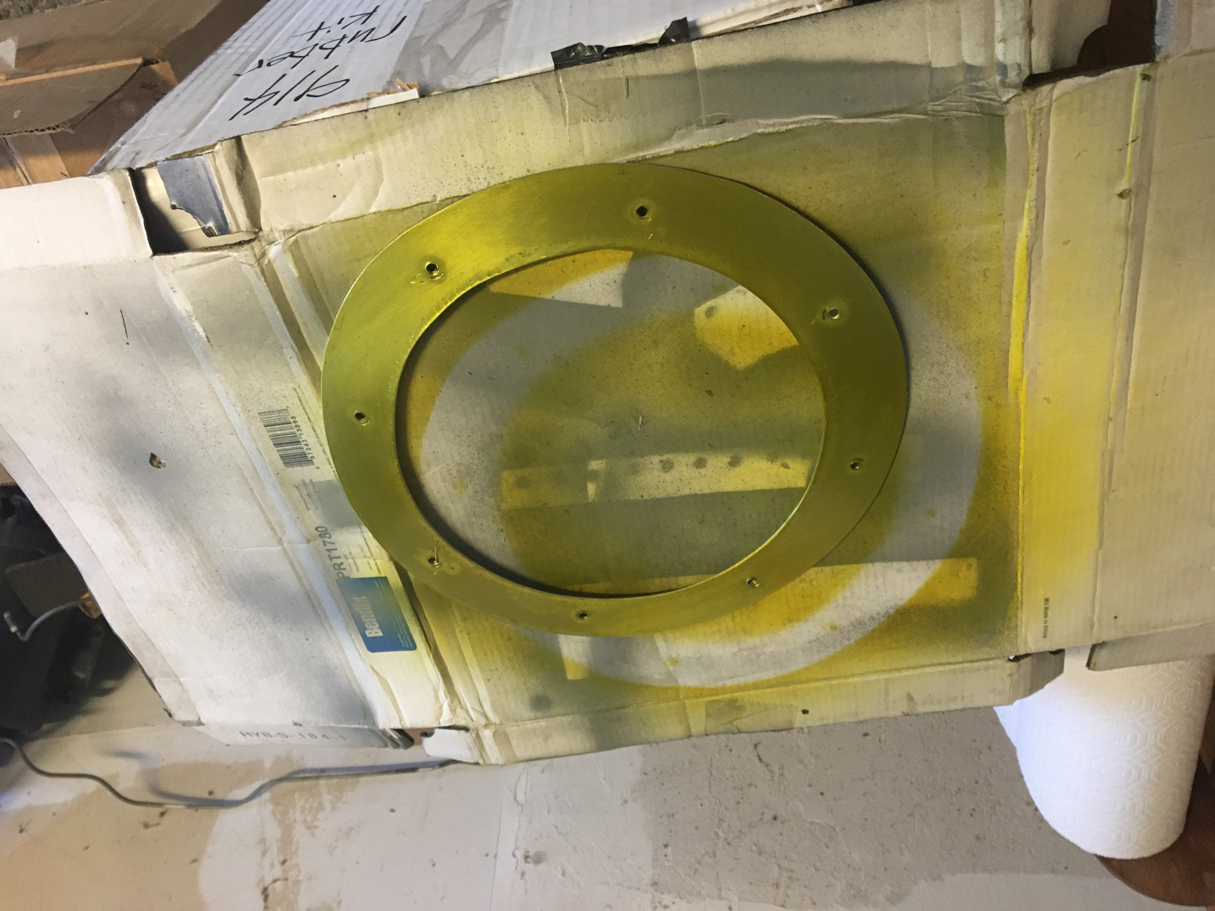

Final challenge for the day. I am trying to emulate the yellow zinc on my rear calipers...for my front alu Bremtek race calipers. Back and forth over what is the best way to do this...without sending them out. Picked up some yellow anodize colored rattle can high temp paint. Tried on some raw alu and color didn't come close. I picked up a rattle can of high heat gold and will spray the gold and then try to "dust" the gold color with the yellow anodize to see how close I can come.Attached Image

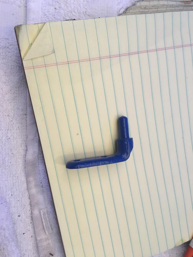

Where do I get these nylon bushings for the headlight mechanism axle shaftsAttached Image?
bigkensteele
post Sep 6 2020, 06:12 PM
Post #434
Major Member
Posts: 2,200
Joined: 30-August 04
From: Cincinnati, OH
Member No.: 2,660
QUOTE(Speedo @ Sep 6 2020, 03:44 PM) *
On you next 914rubber order. (IMG:style_emoticons/default/biggrin.gif)
Speedo

QUOTE(bigkensteele @ Sep 6 2020, 04:12 PM) *
Ok, got that order coming today. (IMG:style_emoticons/default/biggrin.gif)
Were these brackets body color or grey headlight assembly color?
post Sep 13 2020, 07:26 AM
Post #436
914-6 GT in waiting
Posts: 20,625
Joined: 19-September 09
Member No.: 10,825
QUOTE(Speedo @ Sep 13 2020, 09:20 AM) *
grey. They only get painted body color when they get hit with a cheap respray.

Agreed- they never came body color. (IMG:style_emoticons/default/beerchug.gif)

Make that three.

Horns restored and wired in. Rest of headlight parts sandblasted, painted and waiting for plastic bushings. Louver motors cleaned, turn housings degreased and ready for sandblasting and paint. Boots installed on wiring corners.
