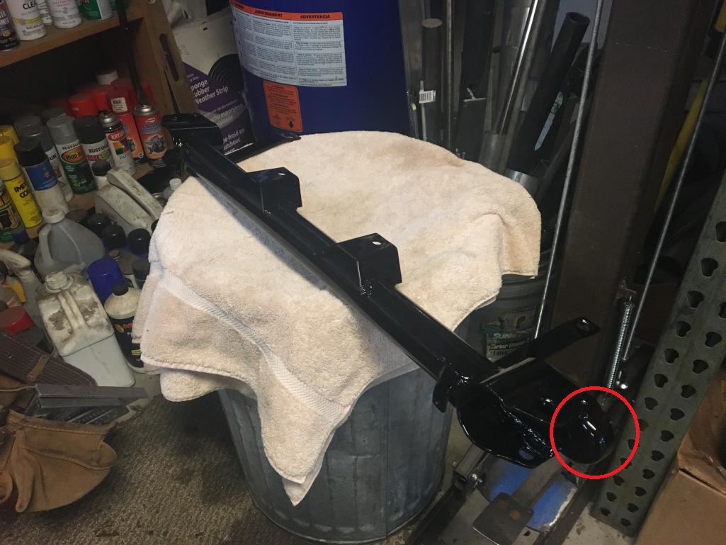

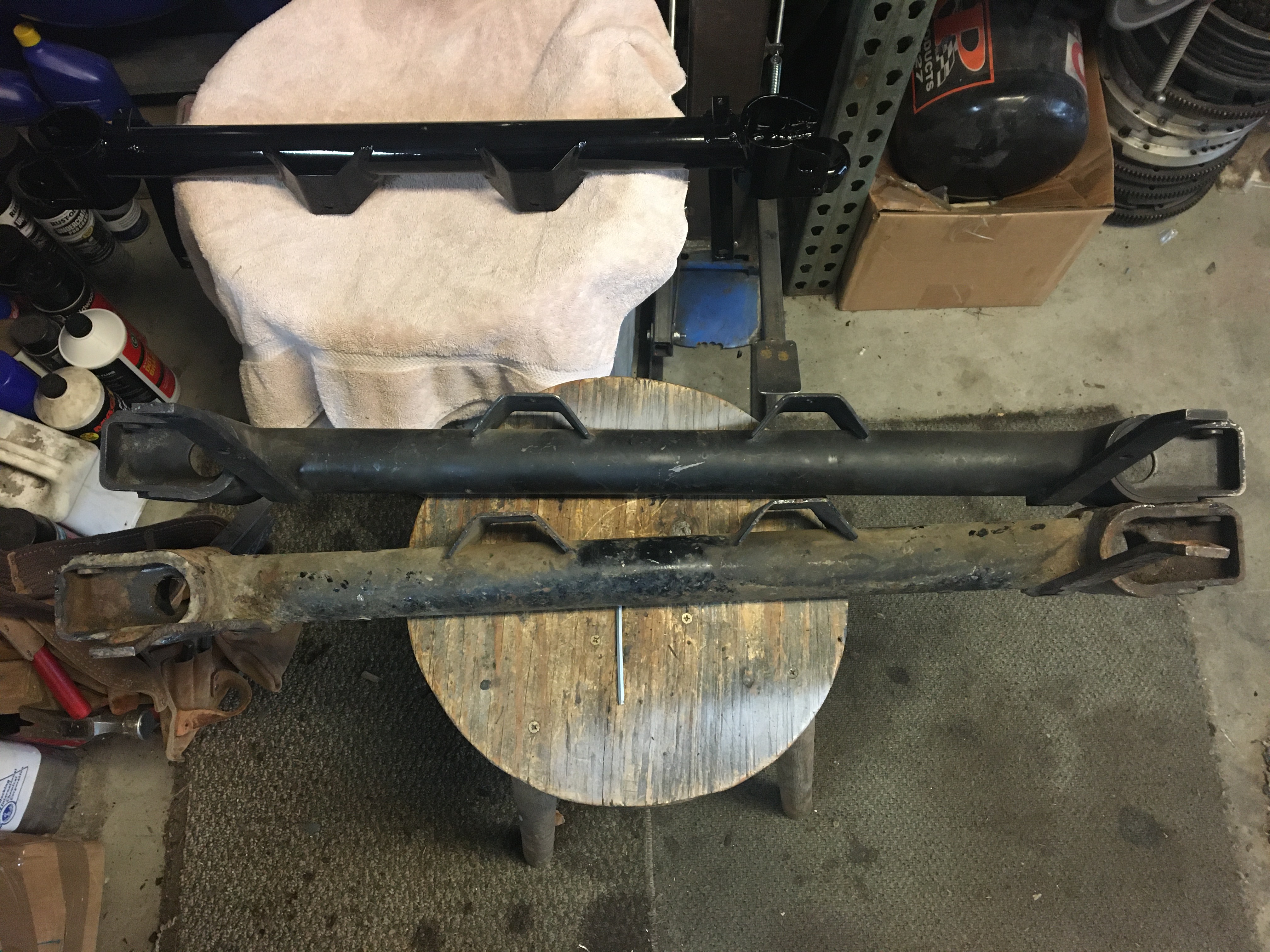

Clay, The cross member is not correct. Look at the ends where I have it circled.
Go look at your 6. I bet it's flat like I have posted above. The one I took off my 6 is flat as well.
Here's a link to one.. Same as early 911/914-6.

You are right.
I went out and took pictures of the crossmember on the six, and one in the parts pile in the garage. In all my years of owning 914s, I never noticed this difference. The /4 has a rounded end, the /6 has a square end.
You learn something new every day.
Clay

There's a long thread on world from a couple years ago about the difference. Some six owners swear their four crossmember was original but it would be odd since Porsche built the six pieces onto the Karmann built bodies at the Porsche factory and would probably not have the 914-4 pieces in the parts bin - but stranger things have happened with these cars.
Lars - I have a powder coated 911 crossmember if you want one. I can't guarantee the finish is the same sheen as your other pieces. Price is half whatever the going rate is (you decide) plus ship.

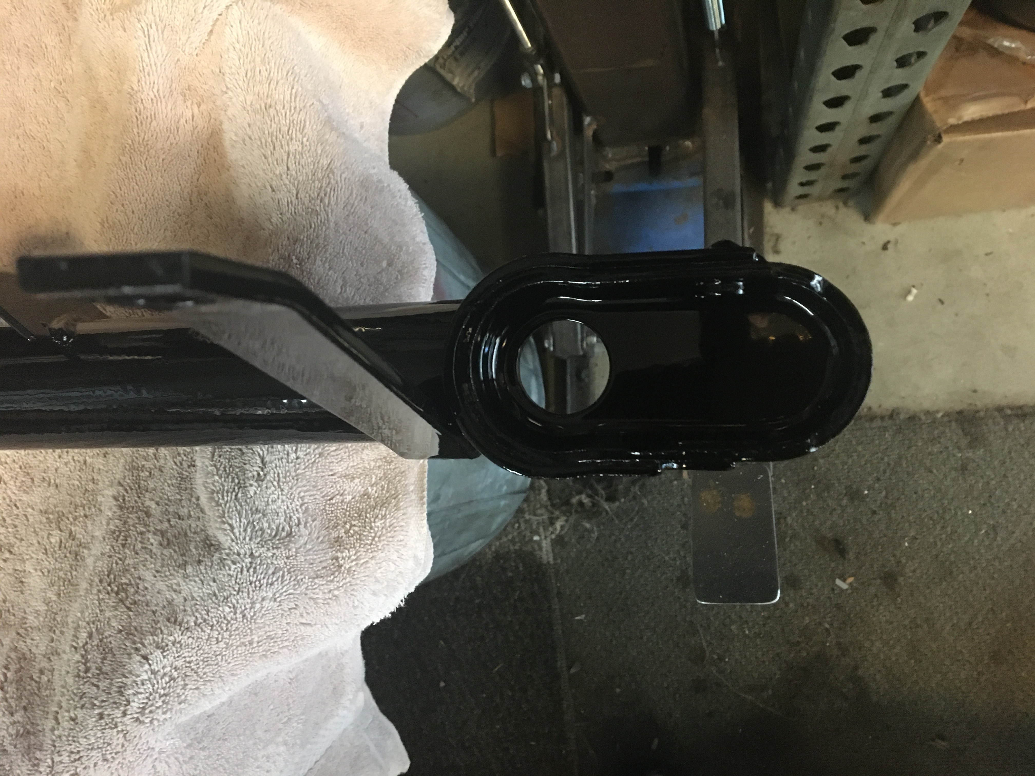

Where do I go from here...
Luke, you were correct. The crossmember ends are round...which makes it a 914 crossmember?
Speedo

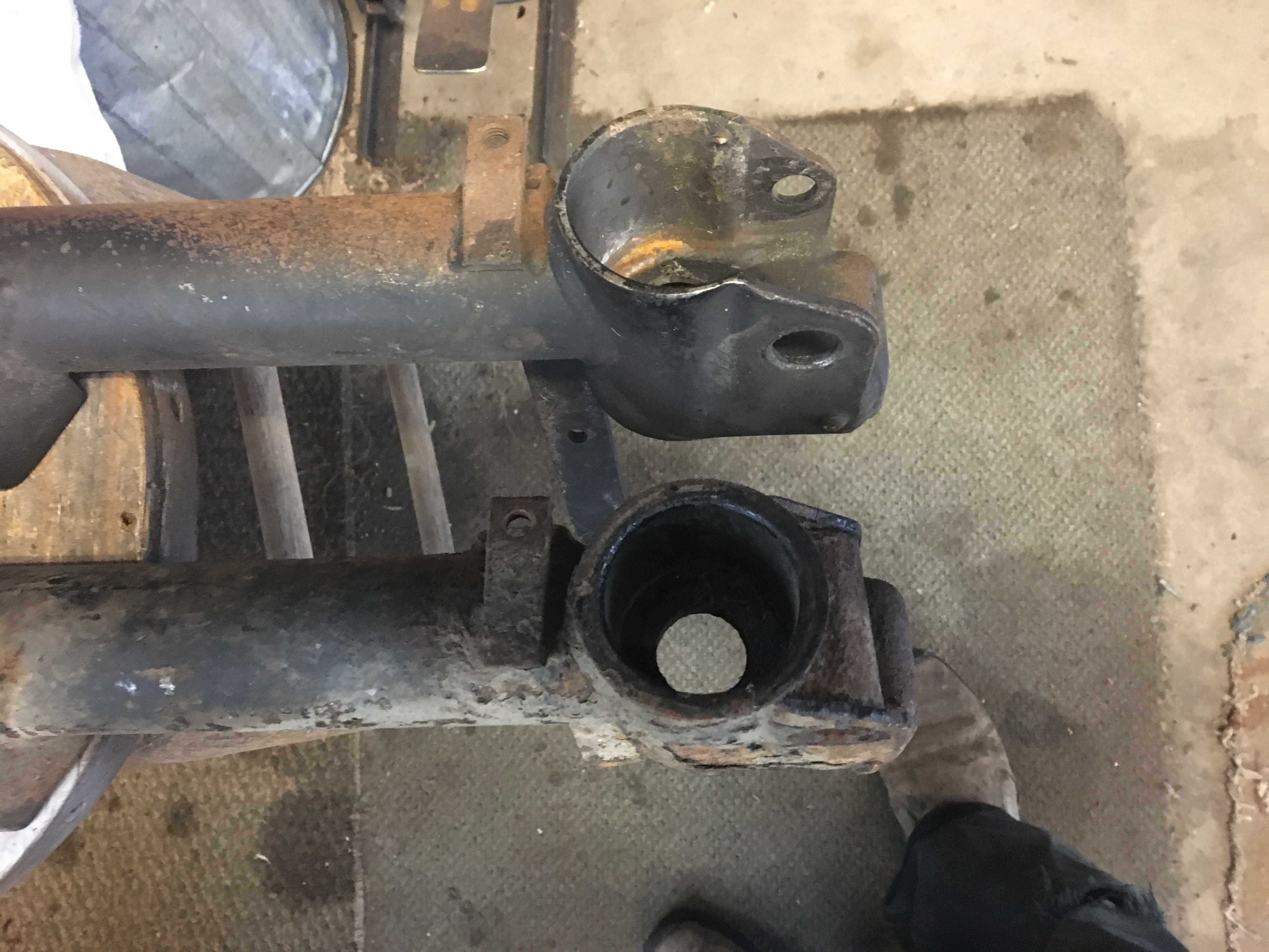

The bigger question is how did this car end up with this crossmember? I looked in my stash and fortunately I have two 911 crossmembers. And while they both have square ends, they are different. I'm guessing the bottom one is early, maybe SWB 65-68 and the upper is later, say 69-whenever they came out with the aluminum version.Attached Image

I'm guessing I need the upper 69-later version?Attached Image

Lars,
You need the 69 to 73ish 911 cross member. Looks like you may have one on hand.
Just line the 911 one up with the 914 unit . If all lines up use that one.

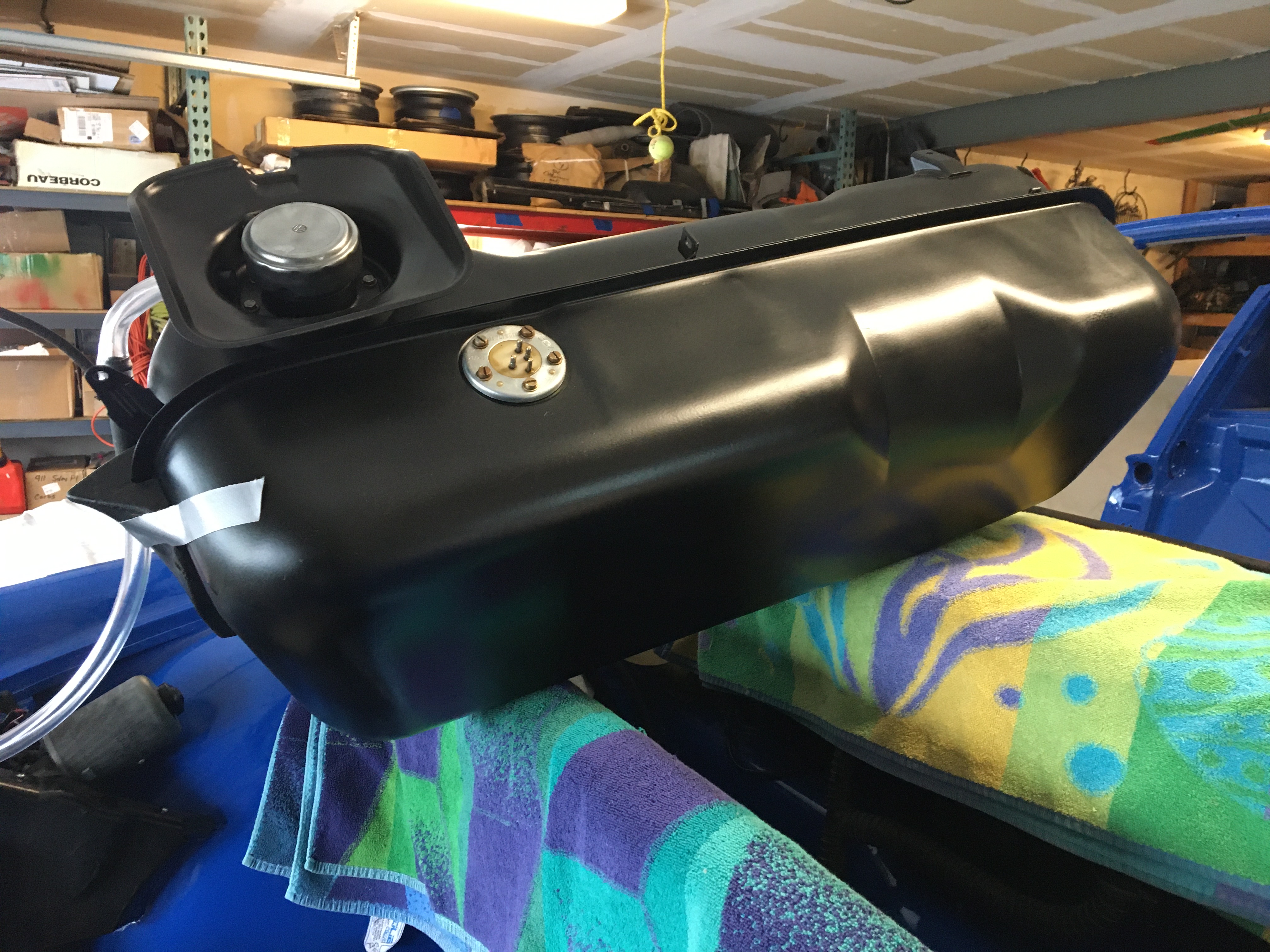

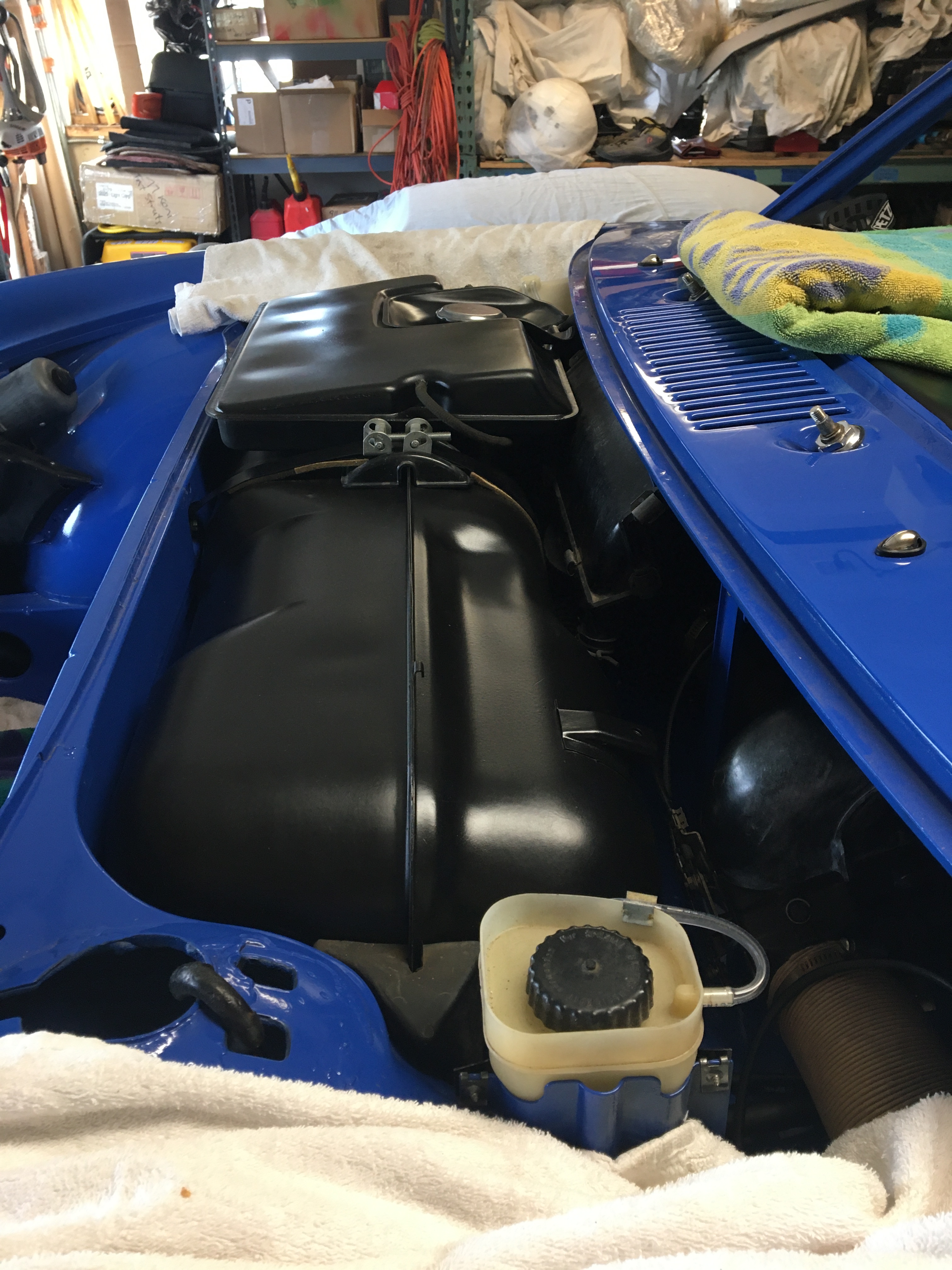

Progress on the fuel tank this weekend when I wasn't looking for the lost tail lights.
New fuel lines and clamps and filter and hose (high pressure) getting ready to re-install tank.
Speedo

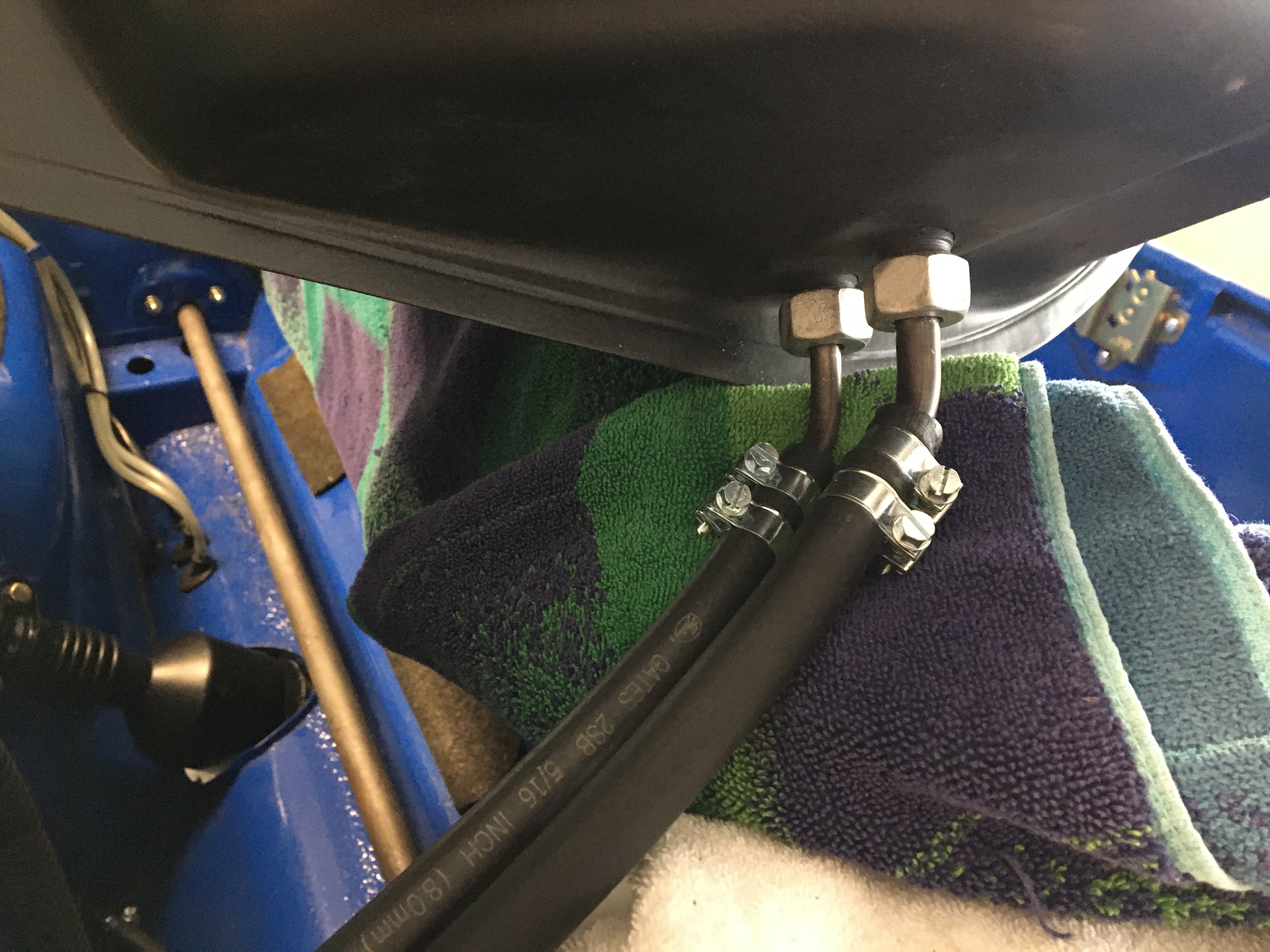

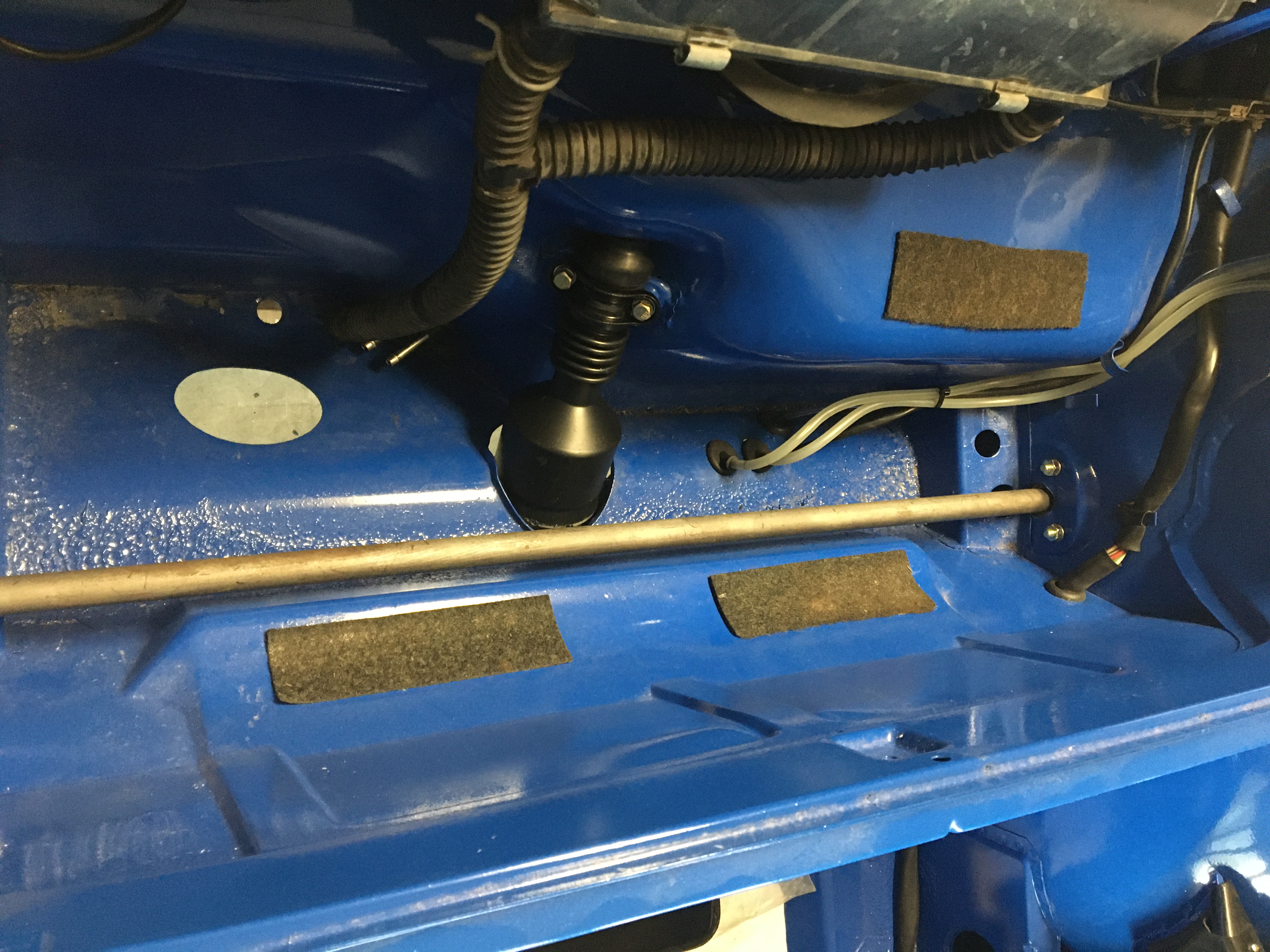

Fuel lines installed. Need another hand to install tank.

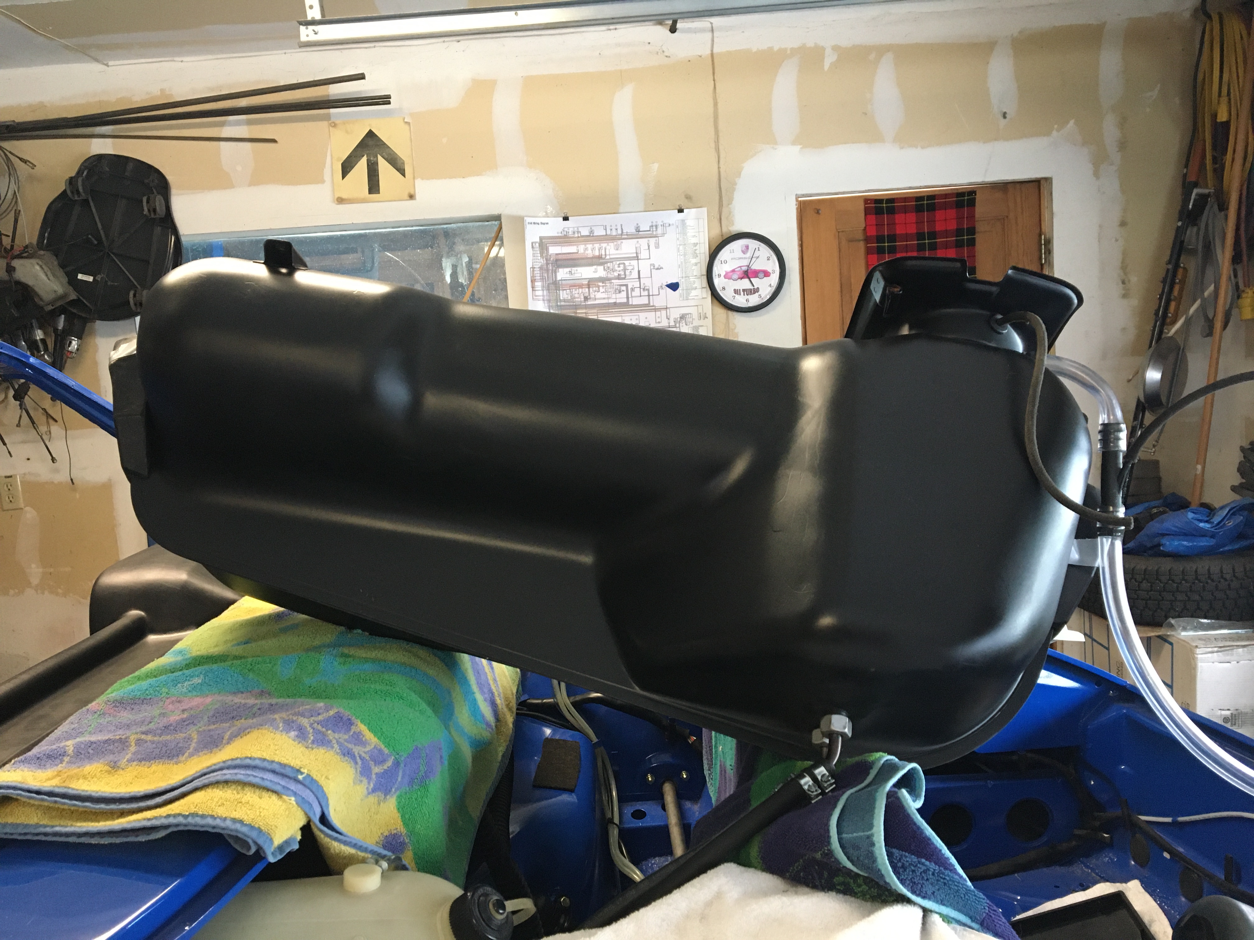

All the other stuff that needed to be done to install the gas tank...is finally done. Actually that is a lie. When I installed the tank, I had to remove it two times...once for the overflow drain, and second for the tank straps. Now all good.
