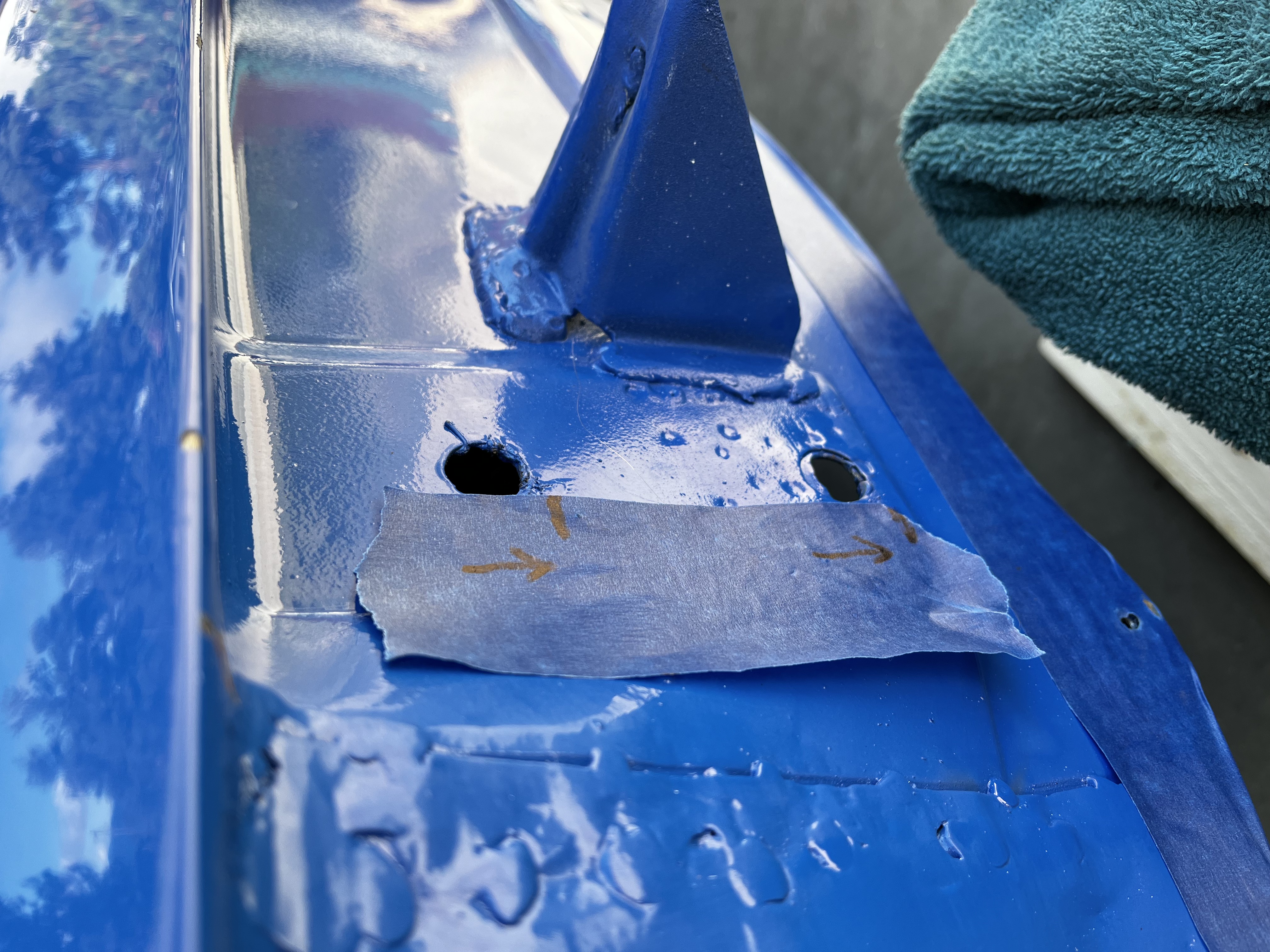

The rubber top of the bumper is aftermkt. The dogbones are original. The bumper itself is original. The center to center distance of the dogbones, the thredded captured nuts in the bumper, and the holes in the rear of the car are all the same measurement. The problem is that the current orientation (placement) of the holes in the chassis, means the lip on the top of the bumper interferes with the ledge under the lights. If those four chassis holes were lowered by 3/8ths of an inch, all would line up. Or if I removed the lip on the top of the bumper...all would line up. I think the path of least resistance (as the bumper has been nicely re-chromed)...would be to "oval" the chassis holes to move them effectively lower so the bumper lip clears the ledge.
Speedo
post Sep 22 2024, 03:17 PM
Post #648
Posts: 666
Joined: 7-November 06
From: Boulder
Member No.: 7,170
Here is the ledge, the existing holes and the need to lower (oval) the holes so that the bumper fits under the ledge.

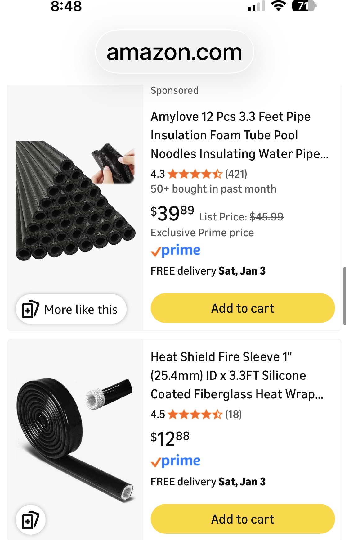

I'm hoping I don't need to buy a new MFI harness. Also 914 Rubber does not have the hose for the heat exchanger bung to the MFI warm up ...hose looks to be 1 inch ID and insulated. Where to buy?
post Dec 31 2025, 07:50 PM
Post #655
914-6 GT in waiting
Posts: 20,919
Joined: 19-September 09
Member No.: 10,825
Amazon? Heat shield?

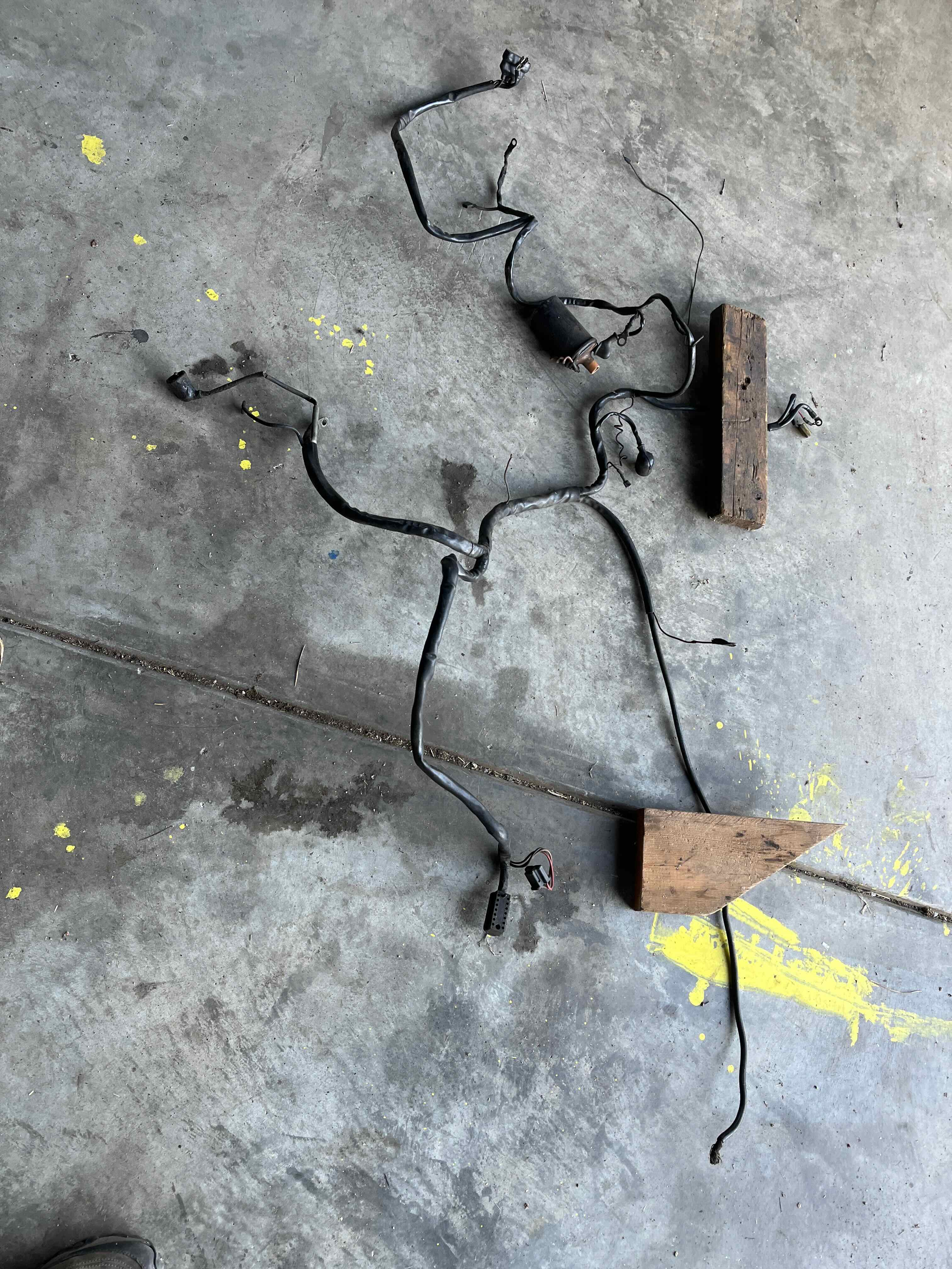

So this is my 2.0 engine harness from the six. It looks to me like it is missing the alternator harness...which wouldn't be too difficult to re-create. I just need to determine if my alternator has the voltage regulator built in or separate. And I need to figure out the wiring for the decel switch. I reached out to Clay P but didn't hear back....holidays I guess. If anyone has modified their harness to accommodate MFI, feel free to school me.
930cabman
post Jan 3 2026, 03:02 PM
Post #658
Posts: 4,833
Joined: 12-November 20
From: Buffalo
Member No.: 24,877
I would try to run with the VR built in, makes things soo much easier

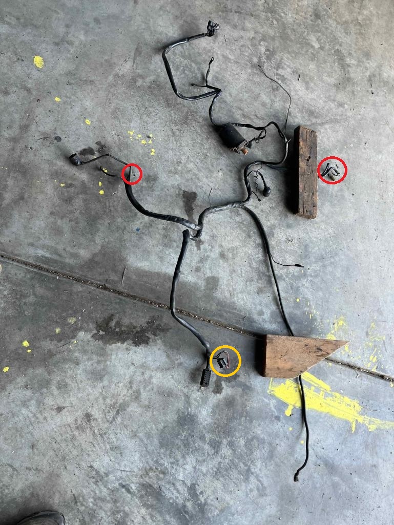

QUOTE(Speedo @ Jan 3 2026, 02:35 PM) *
Luke M
post Jan 4 2026, 01:17 PM
Post #660
Posts: 1,602
Joined: 8-February 05
From: WNY
Member No.: 3,574
Matt is correct.
The end under the 2x4 goes to alt w/int reg. The other end goes on the starter ( + ) stud along with a separate hot ( + ) wire from the battery. The yellow circle is the alt wires that mount to the relay board.
