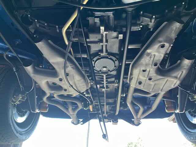

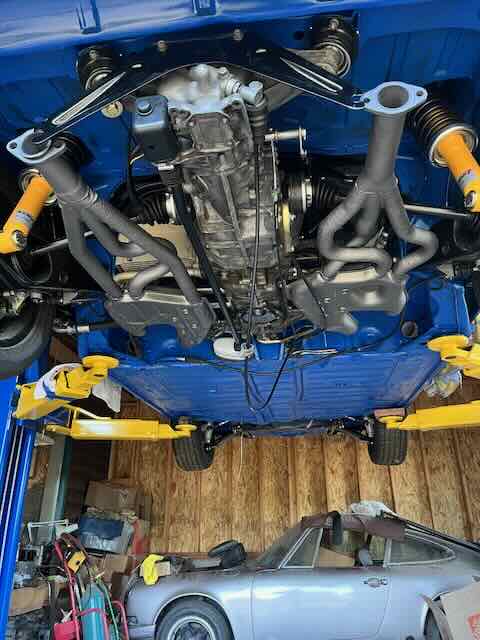

So getting ready to hang the HEs and one of Ben's pea-shooter (GT3?) mufflers. Is the only support for the muffler the hanger at the end of the trannie, or should it be supported additionally?
Luke M
post Apr 12 2026, 04:09 PM
Post #683
Posts: 1,602
Joined: 8-February 05
From: WNY
Member No.: 3,574
QUOTE(Speedo @ Apr 12 2026, 12:49 PM) *
Hi Lars,
Hanger at the rear of the trans and hooks to the inside bolt of the header/muffler .
That's all you get. Make sure you install the oil lines before you hang the exhaust.

So this should be enough?

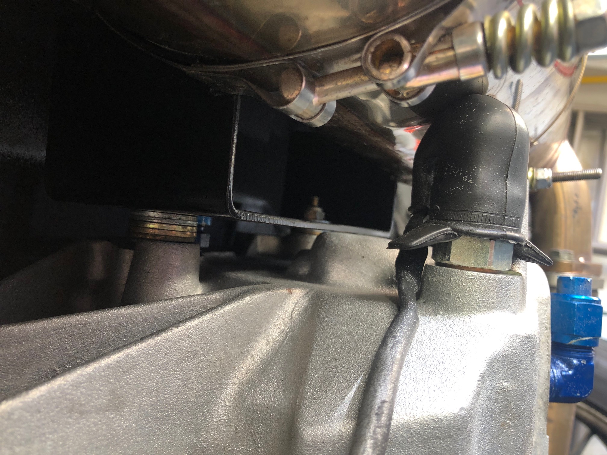

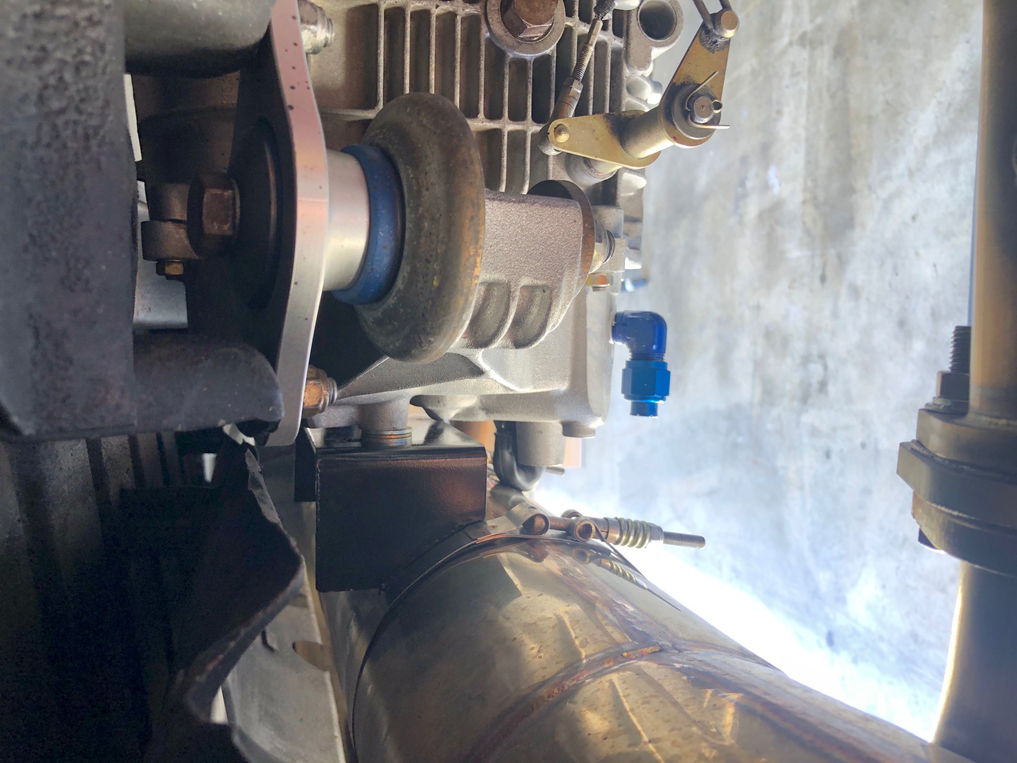

I've been communicating with Ben about the GT Mount for the GT3 (pea shooter) muffler. Does anyone have pictures of the mount in use?
post Apr 12 2026, 04:49 PM
Post #686
914-6 GT in waiting
Posts: 20,919
Joined: 19-September 09
Member No.: 10,825
QUOTE(Speedo @ Apr 12 2026, 06:39 PM) *
I don't have a pic of it mounted because I removed mine to measure it so Ben could make some more. But it lets you mount the muffler like a 911 with metal straps around the body and the weight of the muffler is supported at the middle of the muffler, not at the mounting flanges. To me it made sense and worked well.

I have one here. I'll take a few pics of it on Monday.
I found these pics of Ben's GT mount. I can't recall which members car this was.

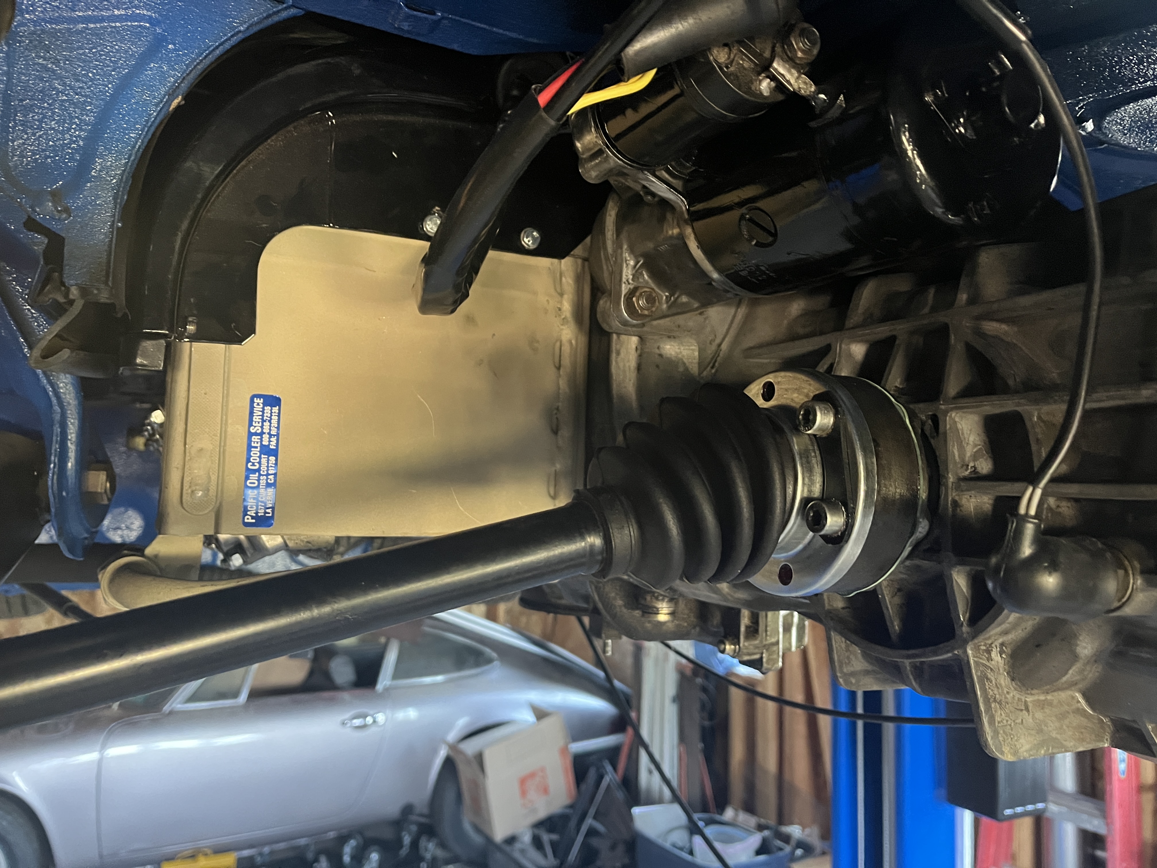

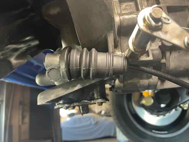

Thanks Luke. I mount the HEs and GT3 muffler tomorrow. I may try something a bit more simple. God I dislike mounting CVs...what a freaking mess. But they are done. And I found an acceptable boot for the speedo.

Here's the speedo boot.

So got the HEs hung today...solo is a challenge. Feels like the end flanges of the HEs are off from the hanger. And the hanger does not seem centered on the tailpiece. Suggestion was to loosen up the 6 nuts on each HE to better center them to the hanger. The hanger has oblong holes that will allow up and down movement but not left to right.
Luke M
post Apr 20 2026, 07:07 PM
Post #693
Posts: 1,602
From: WNY
Member No.: 3,574
Hi Lars,
Just leave everything loose for now. Hang the muffler on the heat exchangers then once you have everything lined up tighten up the hardware. It’s kinda of a pain but that's how I do it. Makesure all your gaskets are in too. I had 1 fall off when I did my brother's exhaust.

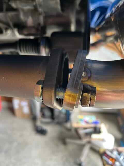

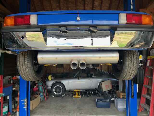

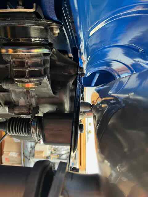

Mounted Bens beautiful GT3 muffler and I have clearance problems with the tailcone and the muffler. Has anyone experienced this? Hate to clearance the back of the muffler, but it doesn't look like there is any other way...suggestions? Good news is that the hanger now lines up correctly and the pea shooters are perfectly centered.
post Apr 22 2026, 03:25 PM
Post #698
914-6 GT in waiting
Posts: 20,919
Member No.: 10,825
Are you using a real six trans. I bet everyone up until now has been using a side shifter with their six. Ben would know for sure but I sold some mufflers for him and I never remember them going in an original six.
Speedo
post Apr 22 2026, 03:35 PM
Post #699
Posts: 666
Joined: 7-November 06
From: Boulder
Member No.: 7,170
QUOTE(mepstein @ Apr 22 2026, 01:25 PM) *
My original trannie. I can't be the first? (IMG:style_emoticons/default/sunglasses.gif)
I guess another option would be to install a 5/8" spacer and longer bolts...but that doesn't seem like a good idea. (IMG:style_emoticons/default/huh.gif)
post Apr 22 2026, 06:36 PM
Post #700
914-6 GT in waiting
Posts: 20,919
Member No.: 10,825
QUOTE(Speedo @ Apr 22 2026, 05:35 PM) *
Ben didn't make a ton of those mufflers before he shut it down. He might have some suggestions for you. @MB911
