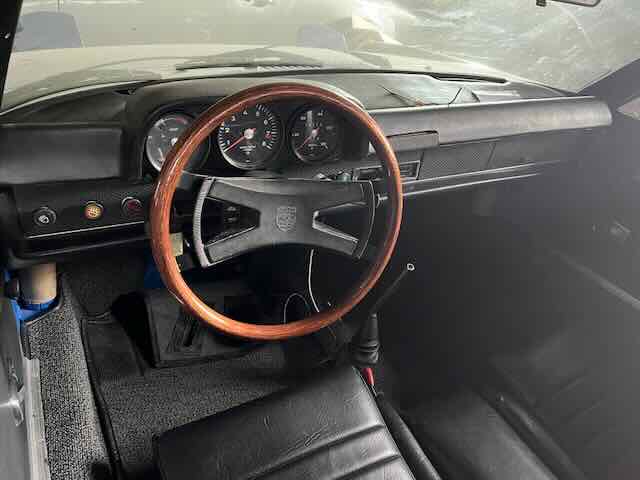

Checked my engine linkages, and found the linkage from the crossbar to the pump wasn't connected. The MFI system complicates accessing things on top of the engine...at least its not a flat fan. Topped off the trannie (not a lot of working room there either), and added 9.5 quarts to the oil tank. No leaks so far. Gave the gas tank 2 gallons...should be enough to start, and not too much to clean up if it leaks. Added ground to the battery and the headlights popped up and the left turn also...I'm sure I will be chasing down exterior lights, turns etc. Glad to know both headlight motors are in synchronicity. I have a wiring harness question for Perry, before I try to start the engine. I don't want to fry the new harness. The custom dished mahogany 360mm VDM is badass if I may say so. Some pics and maybe a video tomorrow. My low rear corners on my doors are a little proud...think I need to hog (oval) my lower hinges to get them to pull in just a little more...details.

Sputtered today on starting fluid, but not getting fuel to the injectors. Feels close. Promised pics of the mahogany VDM...here you go. (IMG:style_emoticons/default/biggrin.gif)
