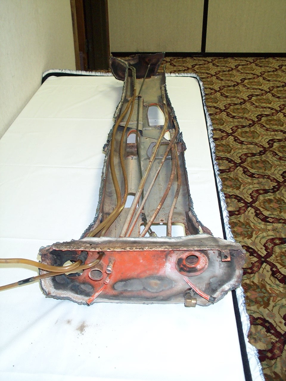

pilothyer
post Jun 18 2012, 12:36 PM
Posts: 838
Joined: 21-May 08
From: N. Alabama
Member No.: 9,080
This is a picture of an original tunnel with all the tubes and fuel line in place. Keep in mind, though, the picture is upside down....hope it will help.
