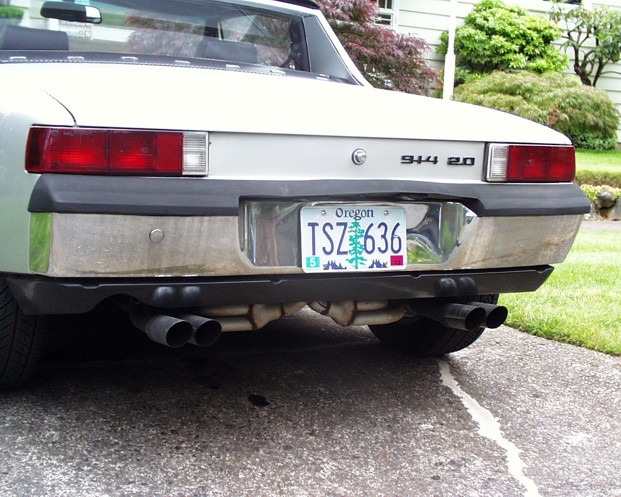

steuspeed
post Jun 29 2012, 08:13 PM
Posts: 1,011
Joined: 12-July 11
From: Portland, Oregon
Member No.: 13,308
Mine is a 2.0 73. It came with a quad tip from Pelican Parts. Not sure if it's Ansa or? The stock valence is on there with the left side cut out. Not what I would have done, but it works for now. I would say it's louder than stock, since I'm louder than most cars on the road. Sounds a bit like a VW BUS with a little Growl Prrrr. My driving is mostly short trips. Occasional Hwy, so it's tolerable.
