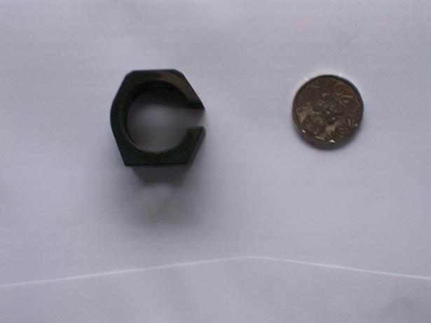

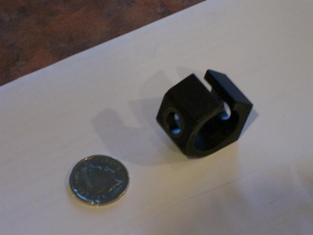

Attached ImageAttached ImageAttached ImageCan anyone tell me where this bit comes from please? Sorry about the poor photo but it is winter, wet and cold down here.

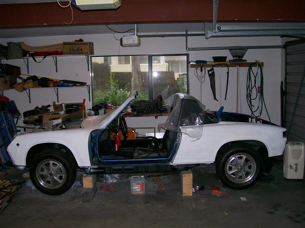

Also added a pic of my 914 nearly all bare metalled and primed. Bit of a mess but we're getting there. Thanks, Richard

rocker shaft retainer ????? that's what i think anyway

Mmmmm. Could be. When I pulled the engine out with a blown head I took the whole thing apart and then down to my mechanic but I could well have left that behind. I think you are right. Thanks

That is correct. the slot is where the push rods guide wire is held in place. the through holes are for the bolt that scew into the heads.
