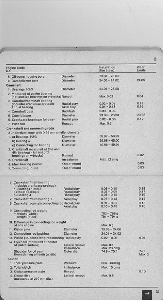

The crank journal should be between 2.3610 and 2.3618. I've got some red and blue plastiguage here that measure 2 to 6 and 4 to 9 thousandths, respectively. Green is 1 to 3 thousandths. Is there a smaller color? - because the whole range of tolerance is +-4 ten thousandths, or 'four tens' as they say.

The only way to check the clearance on those bearings is before they are assembled on the crank, and you need either an inside mic or snap gauges. When the case halves are torqued they compress the bearing shell slightly, meaning the clearance you are seeing is not what it will be when assembled. At this point you can either say "close enough for gov't work" and assemble it or disassemble the crank to check it properly. It all depends on how confident you feel.
