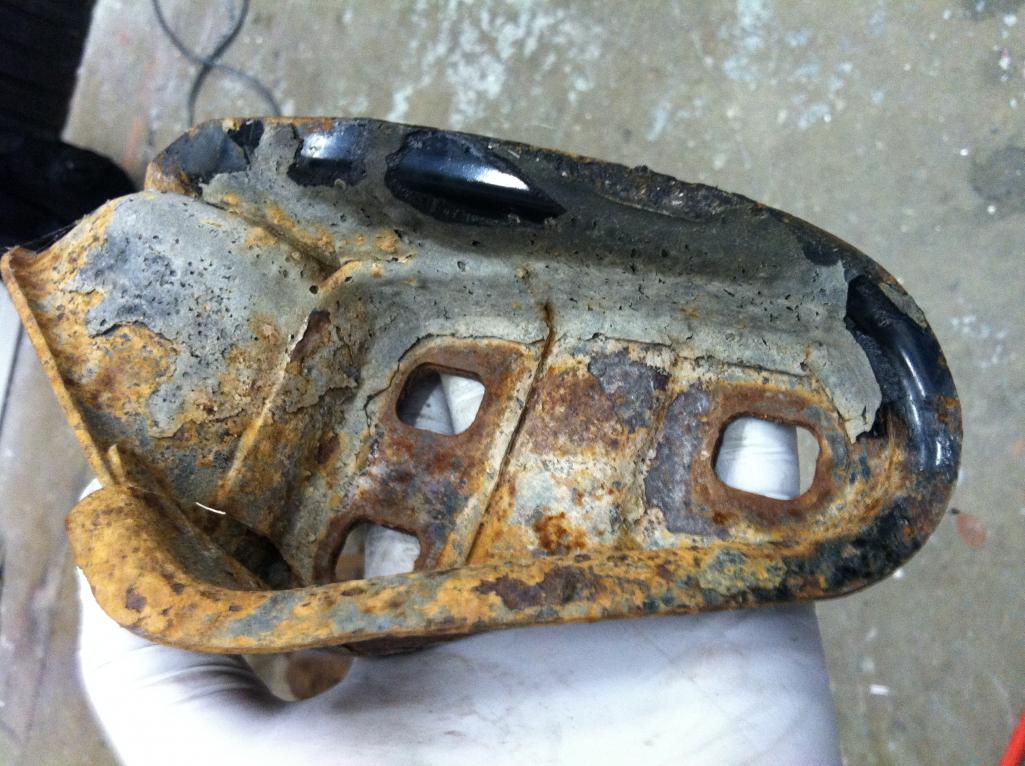

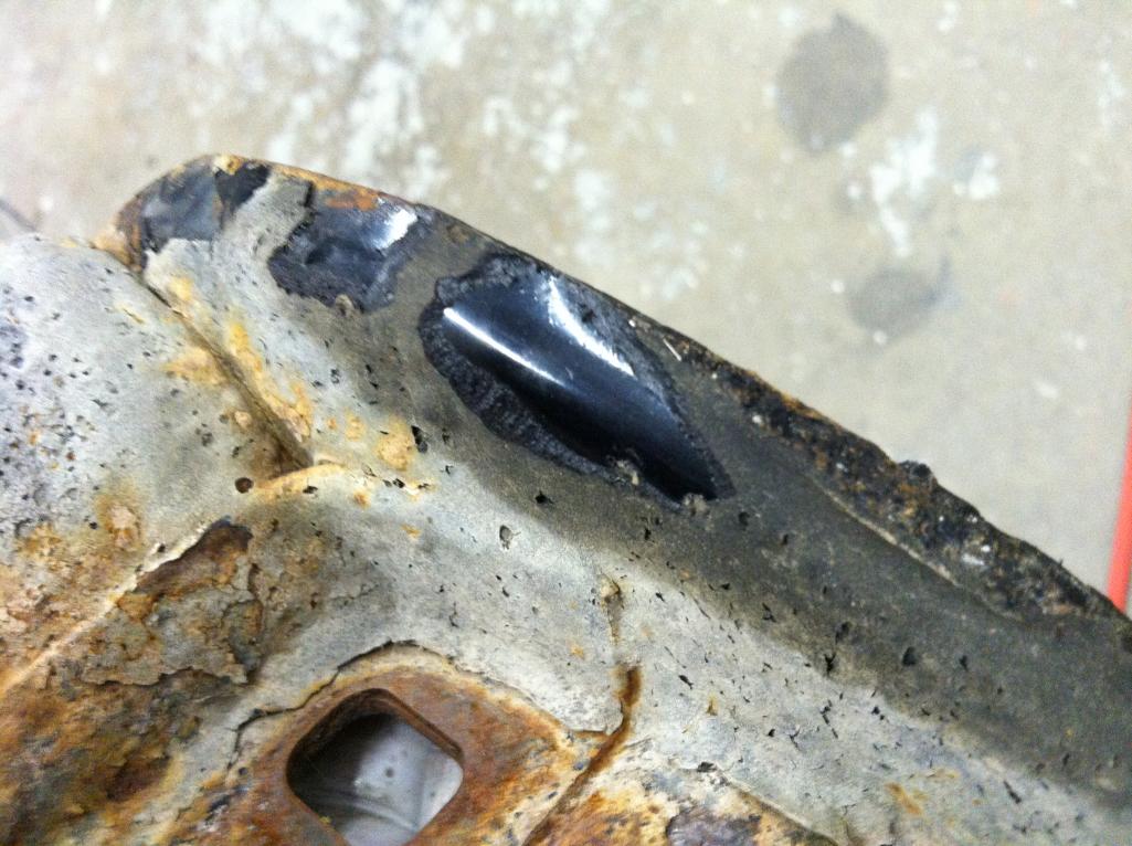

Eric_Shea   Here's a shot that may help. Old suspension c...   May 9 2013, 04:41 PM
tod914   So 60% gloss then?   May 9 2013, 09:00 PM

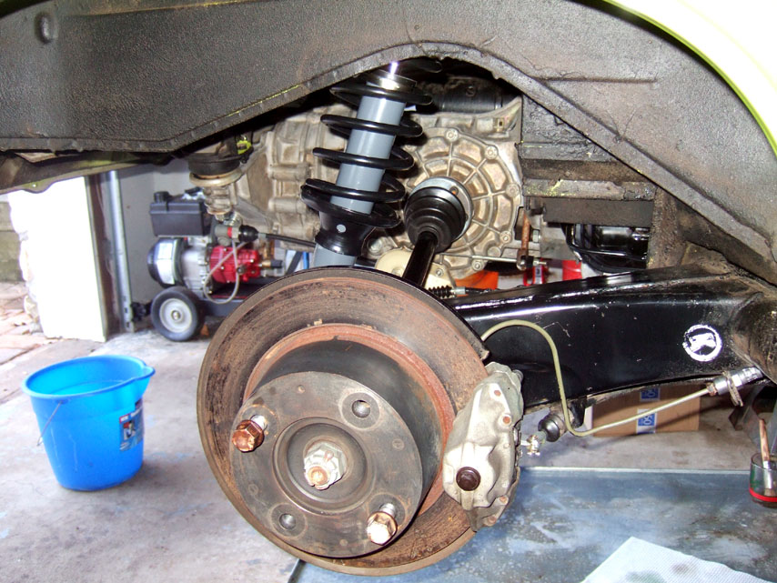

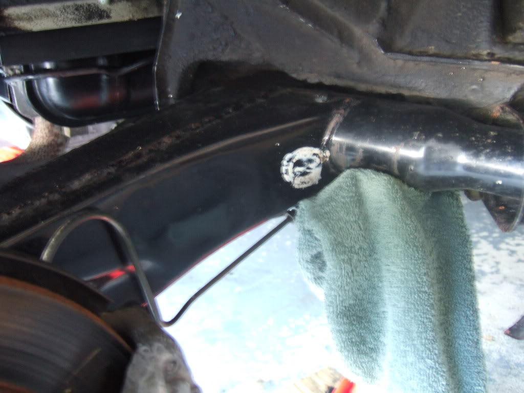

DennisV   If anyone is curious, here is a side-by-side compa...   Jul 18 2023, 05:50 PM
