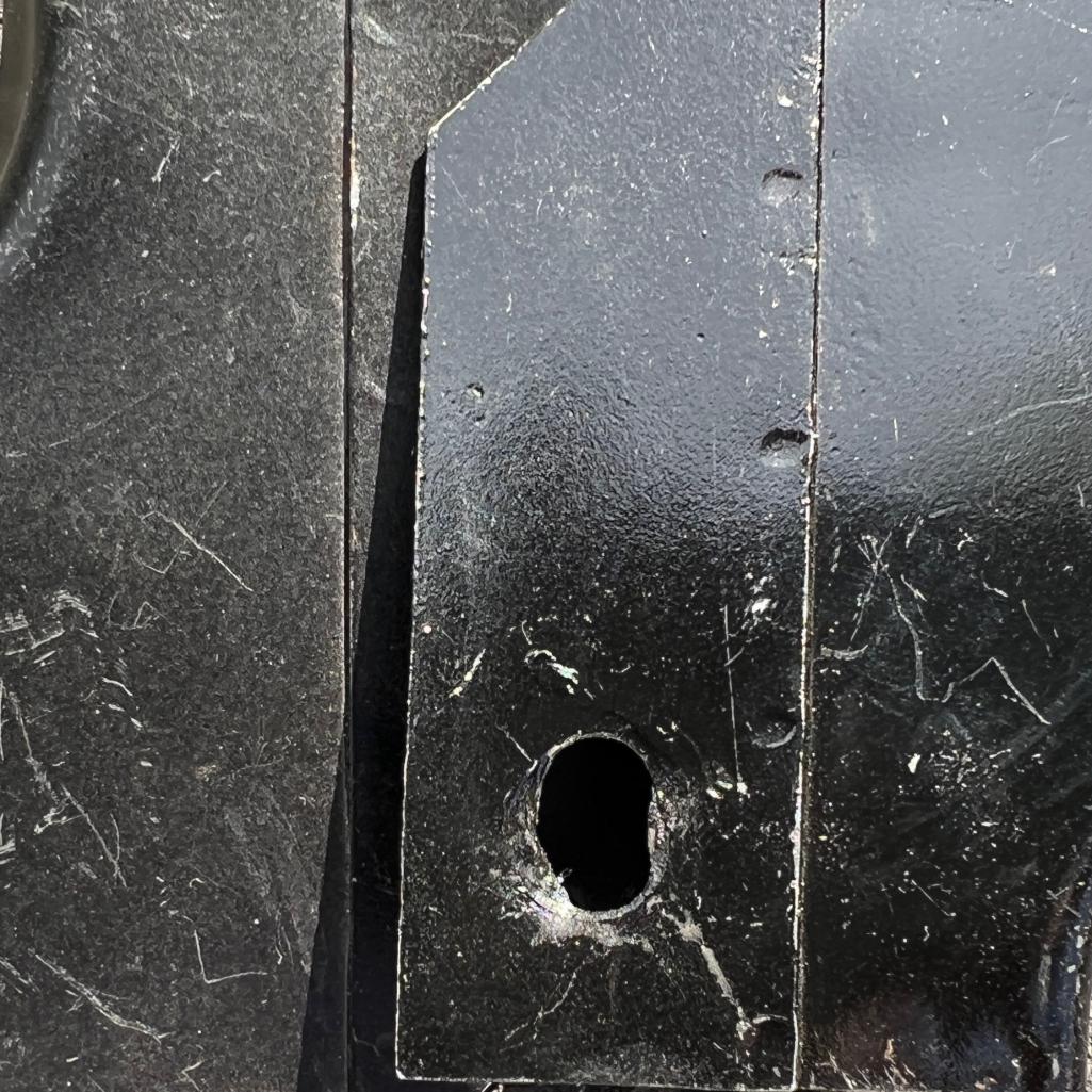

Eric_Shea   Here's a shot that may help. Old suspension c...   May 9 2013, 04:41 PM
tod914   So 60% gloss then?   May 9 2013, 09:00 PM

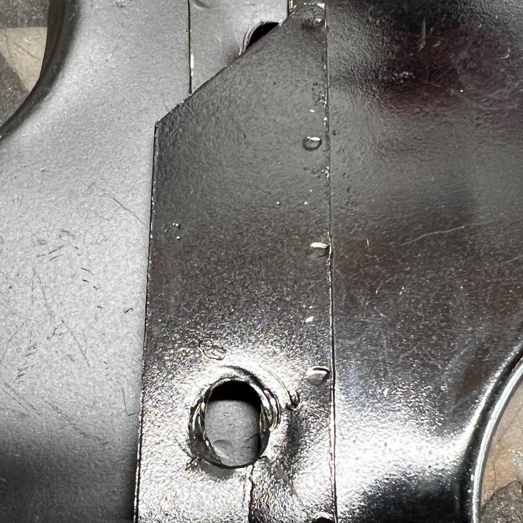

DennisV   So 60% gloss then? Has anyone sprayed out the Ea...   Jul 10 2023, 11:22 AM
DennisV   If anyone is curious, here is a side-by-side compa...   Jul 18 2023, 05:50 PM

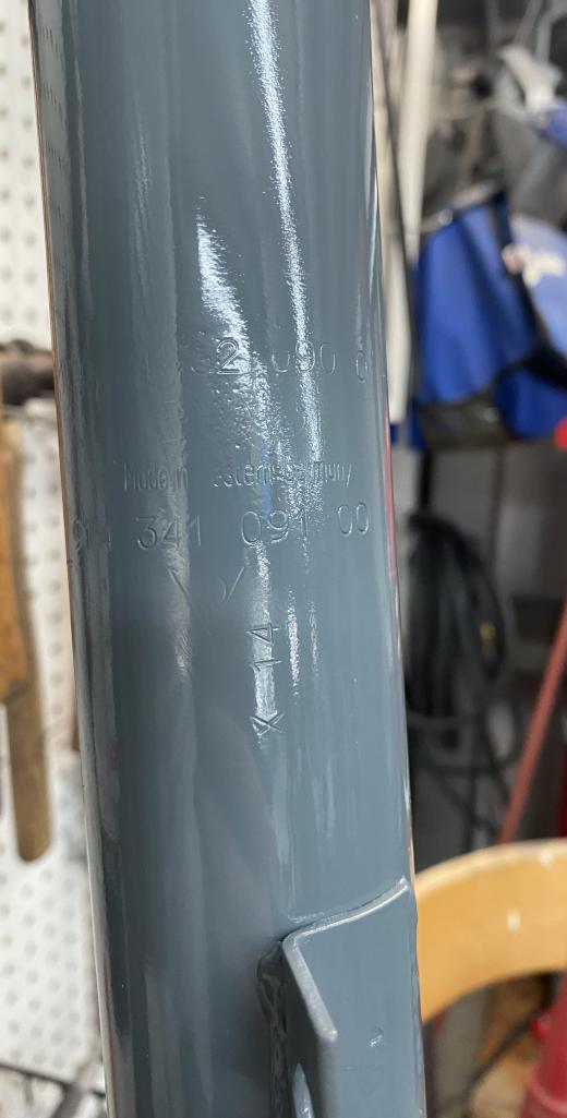

toolguy   However, 914-6's had light gray front struts, ...   Jun 13 2013, 05:47 PM
aturboman   Original 914-6 front strut, part numbers are for 6...   Aug 20 2023, 09:40 AM
