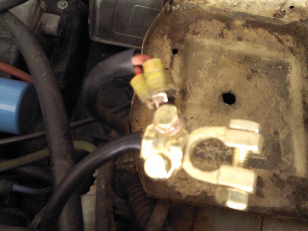

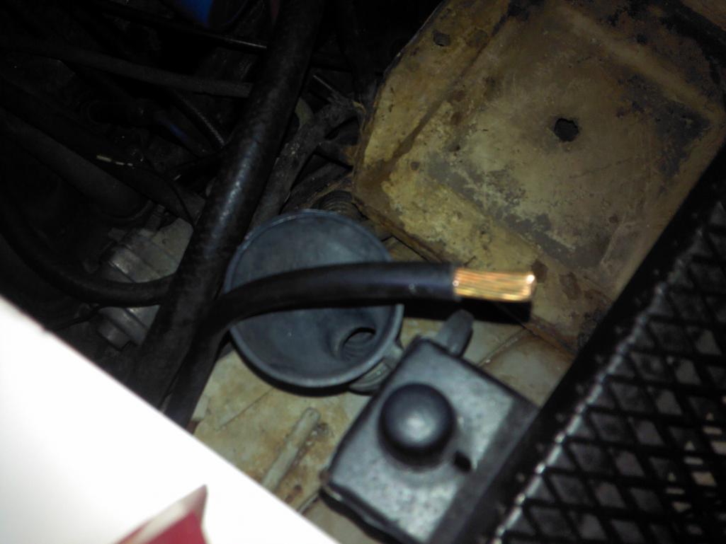

Well, a fellow 914World member (thanks again toadster!) contacted me, and was nice enough to stop over with his new battery to see if perhaps my battery didn't have the needed oomph to turn over the starter.
But no luck, same annoying click, we also cleaned up the bundle of ground connections in the engine compartment behind the drivers seat. He was able to call a mechanic friend who suggested holding the key in the start position for 15 seconds and feel the important connections for heat.
We found that the starter and solenoid motor were quite hot, and the cable from the positive post of the battery to the starter was slightly warm. That cable connector (that also has the 3 red wires attached) seems a little 'crusty' and I will buy a new connector and clean up that connection.

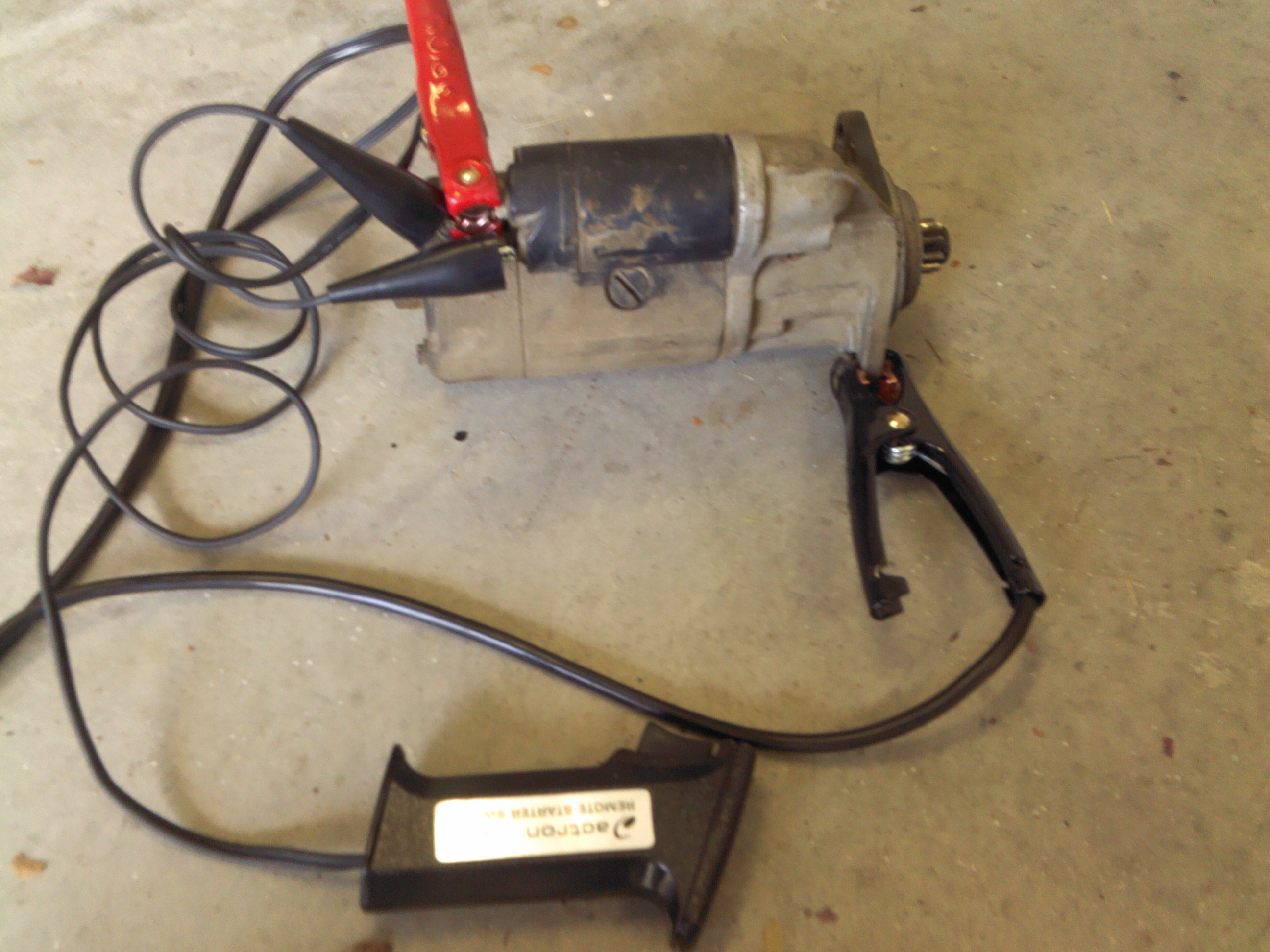

I will also replace the connector on the end of the yellow wire that connects to the solenoid. The fact that the solenoid and starter are so hot, makes me think that there is a problem there. I will also remove the starter and bench test it (my new refurbished Bosch SR17x), just to make sure that it is functioning correctly.

SUCCESS!!! (IMG:style_emoticons/default/cheer.gif)
I replaced the positive battery terminal connection (you were right toadman!).
and cleaned up the connections on that terminal, and she fired right up!
So I have a good back up starter, and I learned a thing or two.
Thanks everyone for helping, I really appreciate it.
Turk
