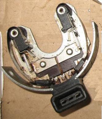

Can you show me on this picture where you would clean, and with what.
Also where to lubricate and with what.
Thanks

I would probably just wipe them out good. Spray some electrical contact cleaner. Make sure the contact points are clean and not pitted. Lube the pivot shafts with distributor grease.

Clean the metal contact bits. Clean the plastic rubbing blocks. Clean the pivots and so on. Clean the electrical contacts inside the plug with TV tuner cleaner (or equivalent). Re-lube the pivots and put a dot of the super-sticky distributor grease on each of the plastic rubbing blocks.

Im not sure if its alignment or what. I am still getting an occasional loss of power (bucking) under heavy accleration. No bucking under constant speed at any RPM, no bucking if im driving around town, even quick. Only noticable when I am on the Highway at speed and then I floor it. TPS is good, and accleration is smooth other than this highway bucking.
Do I need more lube on the triggerpoints?
This is my second used set. Are there any available new?
I adjusted them to look center. is there a way to adjust with tools?
I am gonna bet my problem is trigger related

In all the years we had a 2L with trigger points (10?), we never found cleaning/lubing/etc to them did anything. The only thing that worked was putting in new ones and generally that was done after everything else was adjusted, poked, replaced, etc and the problem never went away but new points "magically" fixed it! This may be against what many will say but the replacement ALWAYS fixed the problem.
Since you said the O2 dropped low, I would suggest installing a fuel pressure gauge and run it up through the engine lid so someone can watch it. The engine is a bit larger and it sounds like to me there is not enough fuel being caused by pressure surges. We used a gauge that was left in all the time and now and then I would run the pressure up and down just to "clean out" the pressure regulator. Seemed to help.

I do have a fuel gauge in the cabin it holds steady @30psi under any and all conditions, needle dosnt even wiggle. Im thinking trigger points

If you have access to an oscilloscope, you can scope the trigger point signals to see if they're noisy or bouncing.
