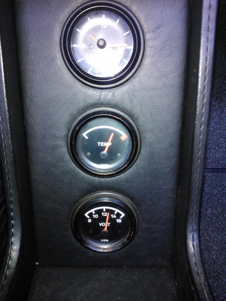

Ok, finally I had some time yesterday to check the car again, I unplugged TS1 and I rechecked timing and vacuum lines. Car is still running very hot and after 15 minutes my oil temp gauge was showing high oil temp again. Any other ideas???

Thats a normal oil temp reading for the stock guage Juergen, I wouldnt worry about that. To really test it you'll need to get an accurate temp guage or pyrometer to know the exact temp values.

Yeah I wouldn't sweat your temps there. I would buy one of those diptick temp gages to get an accurate read. I think you are fine there. Mine will go past the P on the temp gage in really hot weather on the highway. If that is as high as it goes don't worry about it. If you take it out & it is past the P approaching the red. Then you need to change something (IMG:style_emoticons/default/smile.gif) .

My oil temp reads the same sometimes in above 90 degree temps. but it takes more than 15 minutes to get there; at least an hour of highway driving.

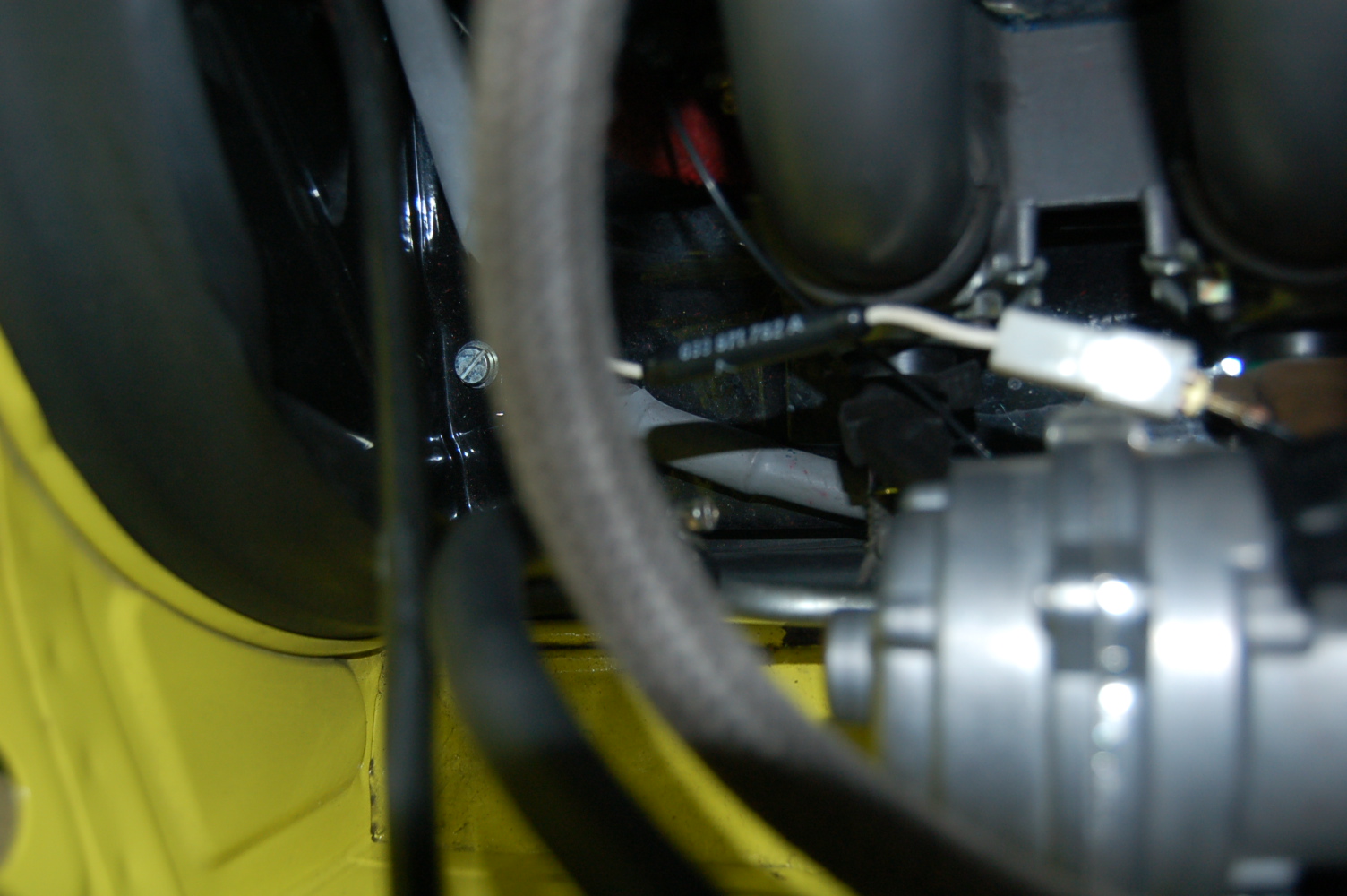

George Hussey @ AA just fixed my slightly lean engine issue with a part I bought from him 10-years ago. I found it in my junk drawer and installed it a few days ago and corrected all lean issues. Check out my post with George on 914-Club site and read what happened. I suspected a lean engine idle at low RPM's & lived with it but after installing a "wehrle" part #039.971.762a that adds 270 ohms to the head temp sensor it increased the duration of injecting with a alightly richer mixture for more power & better idle when fully hot.
Guys, I felt the engine smooth out and run better than ever on my 2.0 liter F.I. Raby # 9550 camshaft with Raby LE-180 heads. Amazing tech advise from George. I understand AA sells them, don't know how much $$ but it worked for me.
