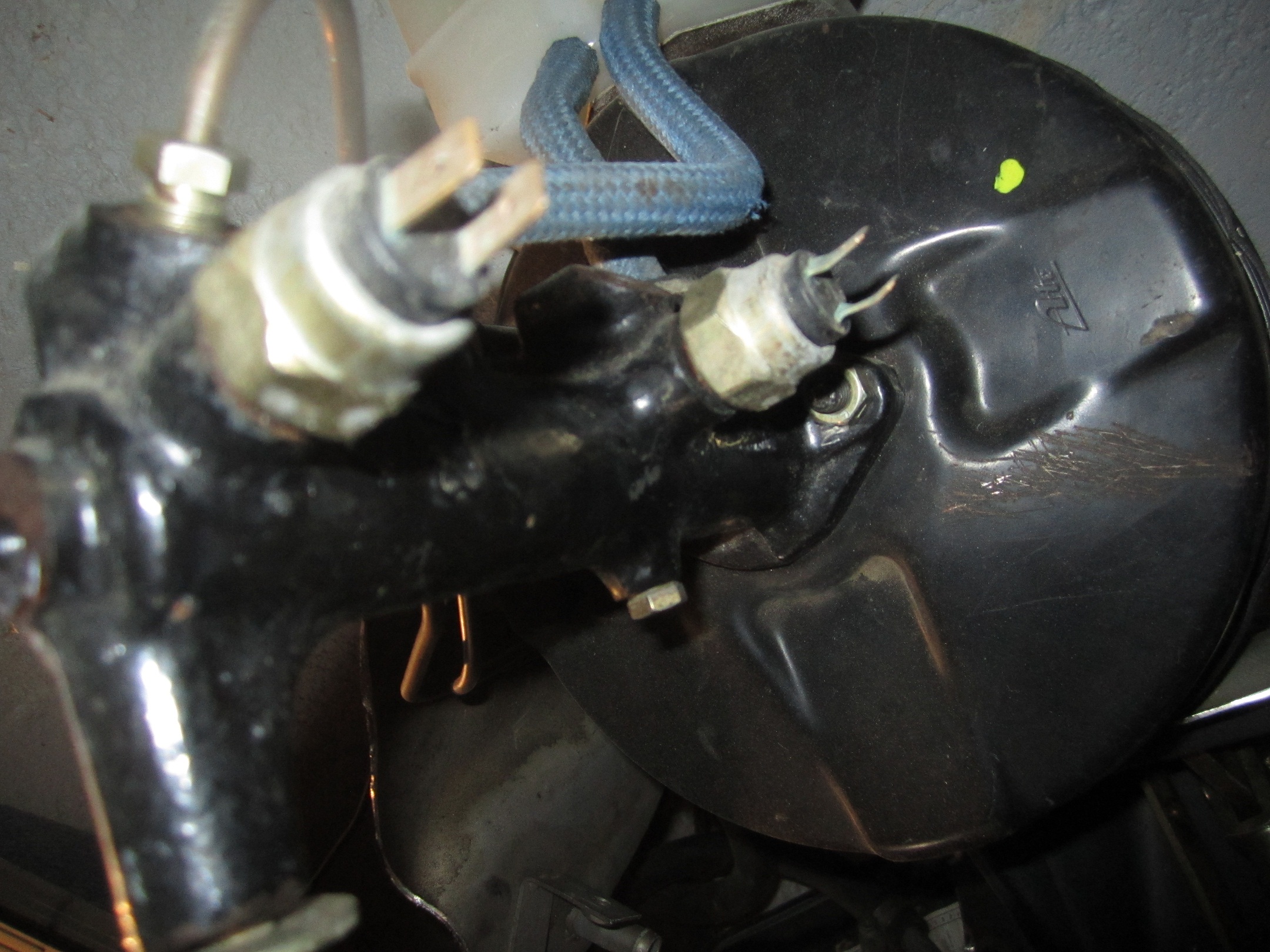

> Does this look like a 19mm MC?

I have the opportunity to get this MC for my 911 front end (M calipers) conversion but I'm wondering if this is a 19mm MC (IMG:style_emoticons/default/confused24.gif)
Can anyone confirm what MC this is?

Without saying that it is not a 19mm.
I have a 19mm and it does not look like that.
Hope this helps. (IMG:style_emoticons/default/dry.gif)

I say... figure out how to use it with the booster. 914 power brakes... (IMG:style_emoticons/default/idea.gif)

OK, Then I guess I will pass on that opportunity and still look for a 19mm.

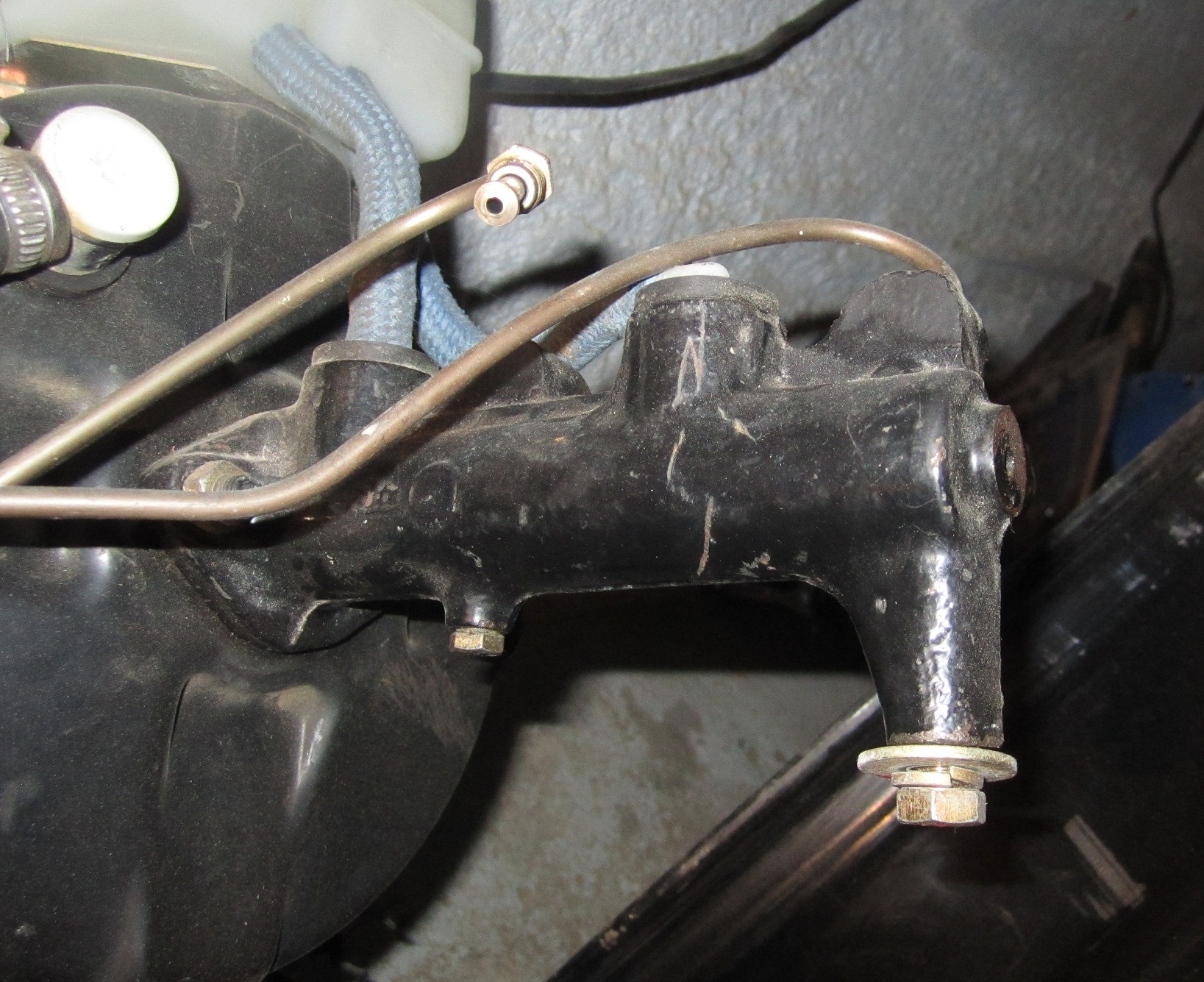

I got more info from the MC owner. It is installed on an SC and it says 19 on the side apparently. Does this seem possible? Could it be used on a 914 or do I need an earlier 911 version?

So, do you guys think the 19mm dual circuit master cylinder installed on pre-1977 911s is the ONLY 19 mm master cylinder out there? While this one should be all the clue you need, there are literally hundreds of varieties of 19mm master cylinders fitted to all manner of cars and light trucks, and one easy way to identify an Ate 19mm unit is to look for the number embossed on the body.

Thank you for this additional piece of information. I haven't seen the unit. I just got those pictures from the P-car owner who claims there is a 19 on the side and there seems to be the Ate logo in the first picture (IMG:style_emoticons/default/confused24.gif) .
Based on that, I thought this could be a good candidate for my conversion but wanted to make sure.
I'm sorry not to be as knowledgeable in the 911s variations as many of the members here are, and that is why I'm sharing and asking about these pictures.
Now I know I need a pre '77 MC for my conversion and it should'nt look like the one I'm being offered (IMG:style_emoticons/default/beerchug.gif)

It is not a good candidate. This is a power master cylinder, and there isn't room for the booster on a 914. If you want an interesting project with lots of fabrication, you can probably find a way to use it.
But it certainly isn't a bolt-in solution in a 914.
