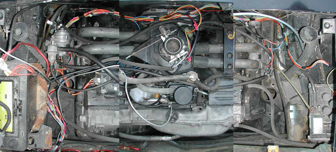

I'll let you know in about a week. Just got the wiring harness modified and installed. Got new spark plug wires. Still need to get a piece from Dave and get the brain talking to the Palm handheld.

QUOTE(markd@mac.com @ Oct 25 2004, 06:51 PM)
that pic makes my head huuuuurt. ever think to zoom out? (IMG:style_emoticons/default/wacko.gif) (IMG:style_emoticons/default/lol2.gif)
