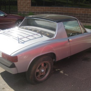

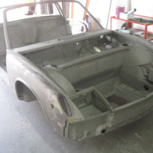

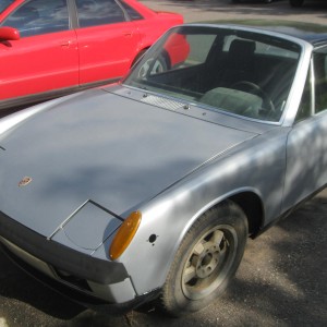

Hi, i'm currently converting this 914 to a GT for a customer and thought i'd post the metal work progress as i go along.
Thanks for looking !

You should keep the luggage rack. It will set your car apart from the other GT clones... (IMG:style_emoticons/default/biggrin.gif)

The rear LH side had been in an accident in the past taking damage to the front fender,door and rear quarter.Before we graft the flare in, the door was metal finished and the front section of the rear quarter panel replaced with freshly made metal along with the door handle depression fixed and grafted into the new quarter.
