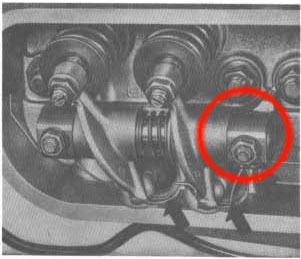

Pulling off my rocker arm I notice its a little hard to get off jiggling and pulling the arm doesn't move. Hey bright idea, let me try to pry it off. The arm comes of but leaves half of one of the mounting blocks still installed against the head. Does anyone one know were I can get one of these? Is this a part I can get from my FLAPS. I hate to have to pay 8 dollars shipping for a 4 or 5 dollar piece.

I believe that is a separate part, and should be readily available. I probably have dozens. I don't think there are any variations.

Send me your address and I will mail you one.
