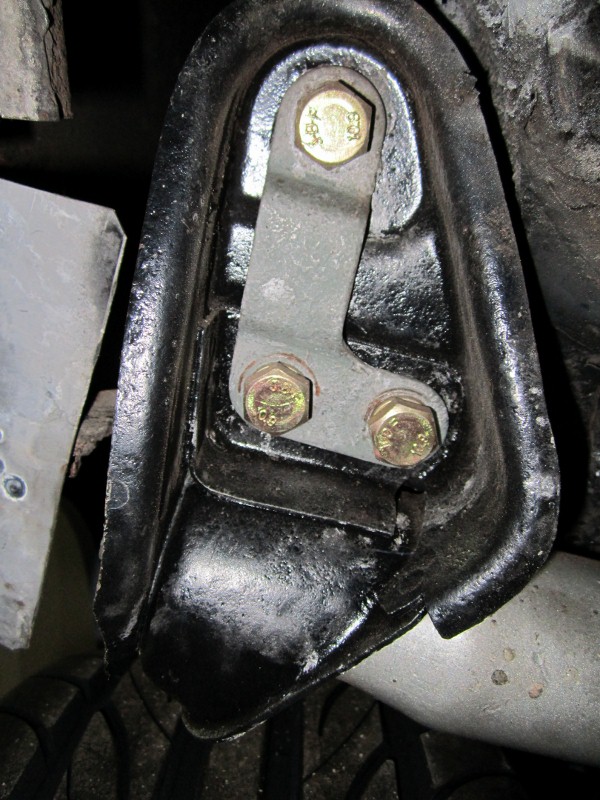

Bolts should be 10mm x 55mm x 1.5 thread. They bolt into the three threaded tubes welded into the front outer control bracket.
Is it possible the threads stripped and someone just put bolt(s) through the tubes with a nut on top?
Here is the plate Chris is talking about.

Chris was right ...Bolts were too long
