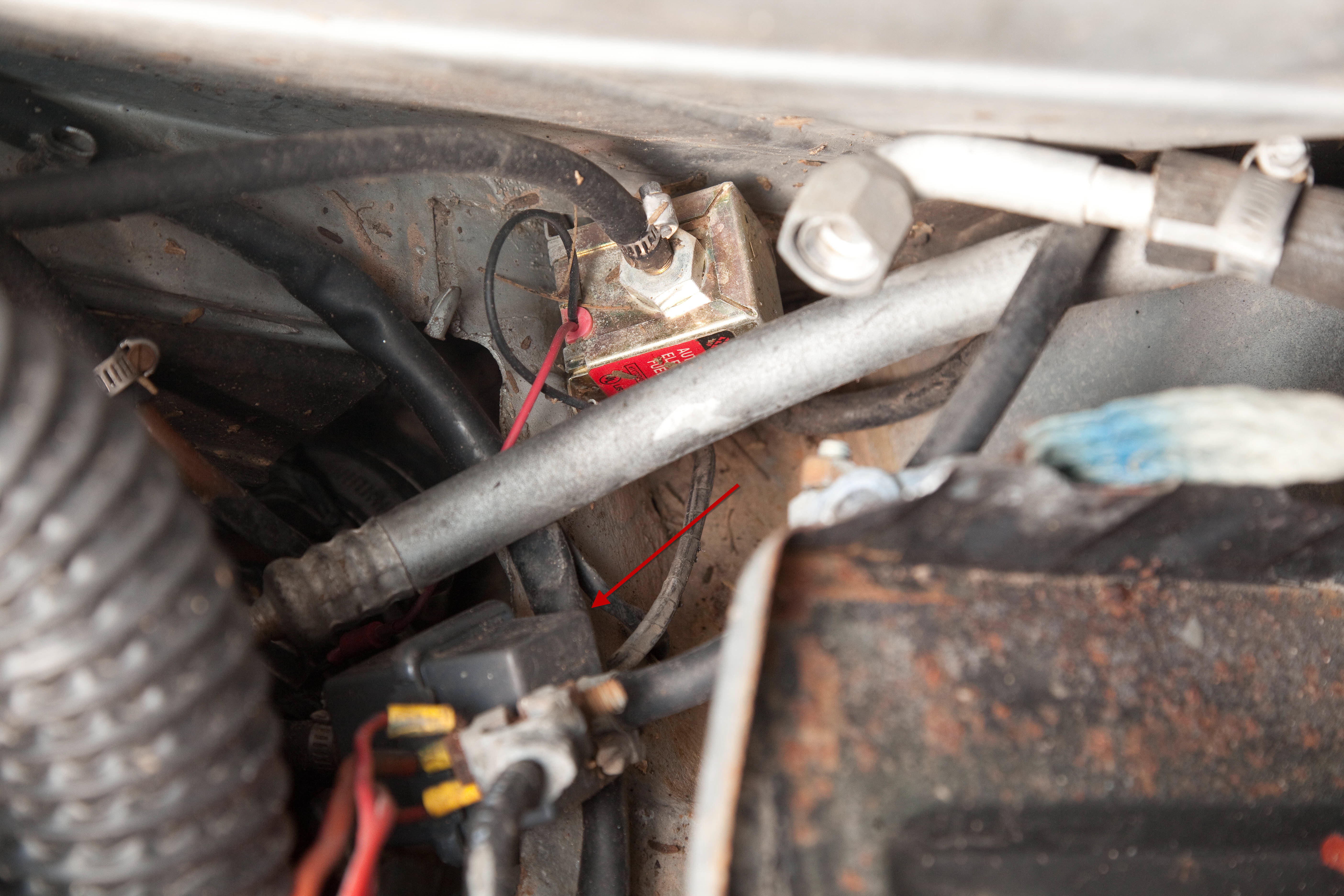

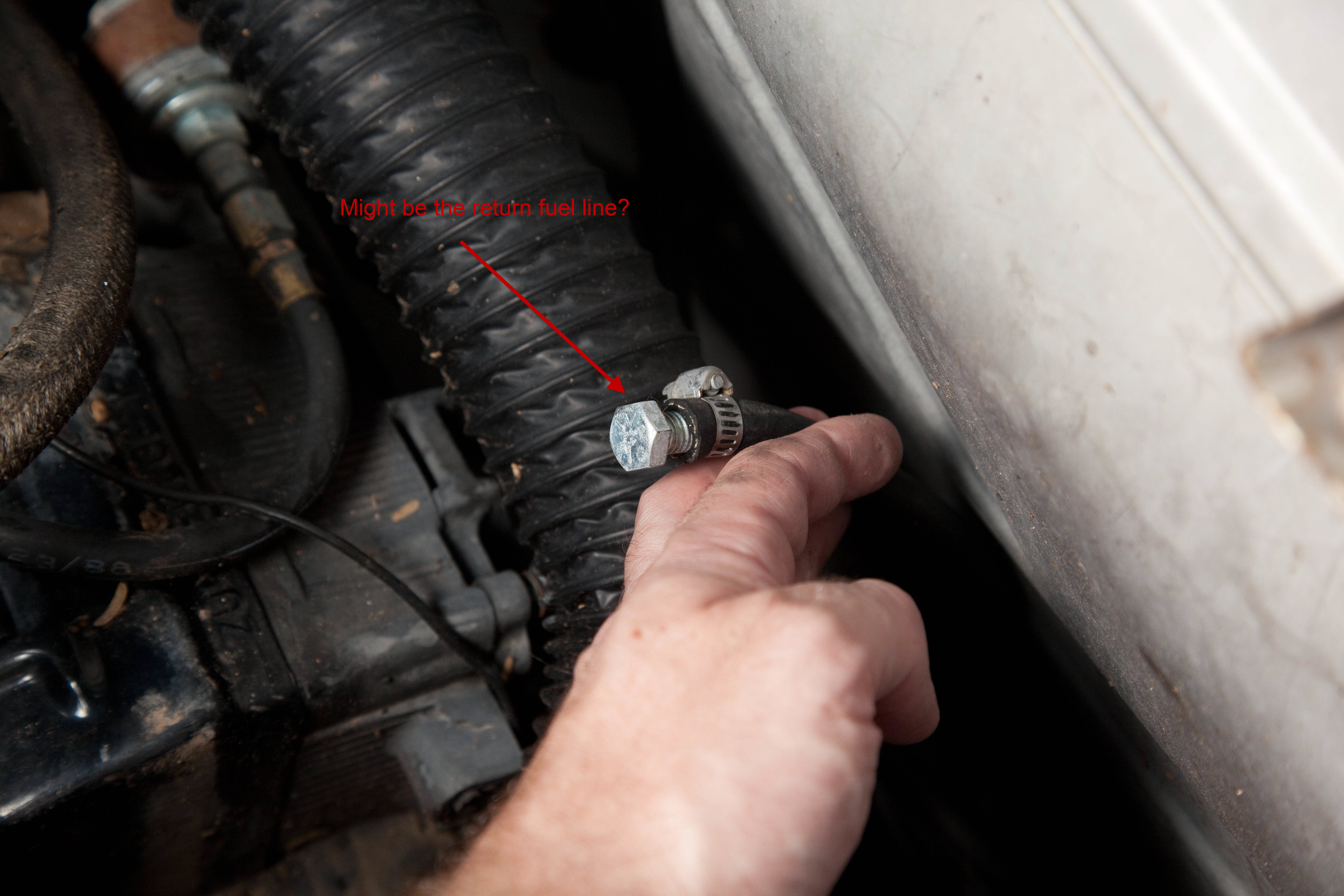

These pics are from my friends car (porkchopexpress). This is his return line situation, the next pic shows where his pump is located.

short piece of line on the tank fuel return tube, a tight fit shouldered bolt and a stock clamp.
tim, that fully threaded bolt return line plug is sketchy and if it should leak in the engine compartment...FIRE!! find another place to locate the pump too. hot confines. i try to keep the # of hose connections to a minimum in the engine compartment
edit: something else i noticed. it looks like the pump to carb line runs across the front of the engine to the dr side carb? then all the way back across to the pass side? does the fuel line contact the engine or tin anywhere? if so, try to configure it to keep the footage of the line in the engine compartment to a minimum and off all warm surfaces.
