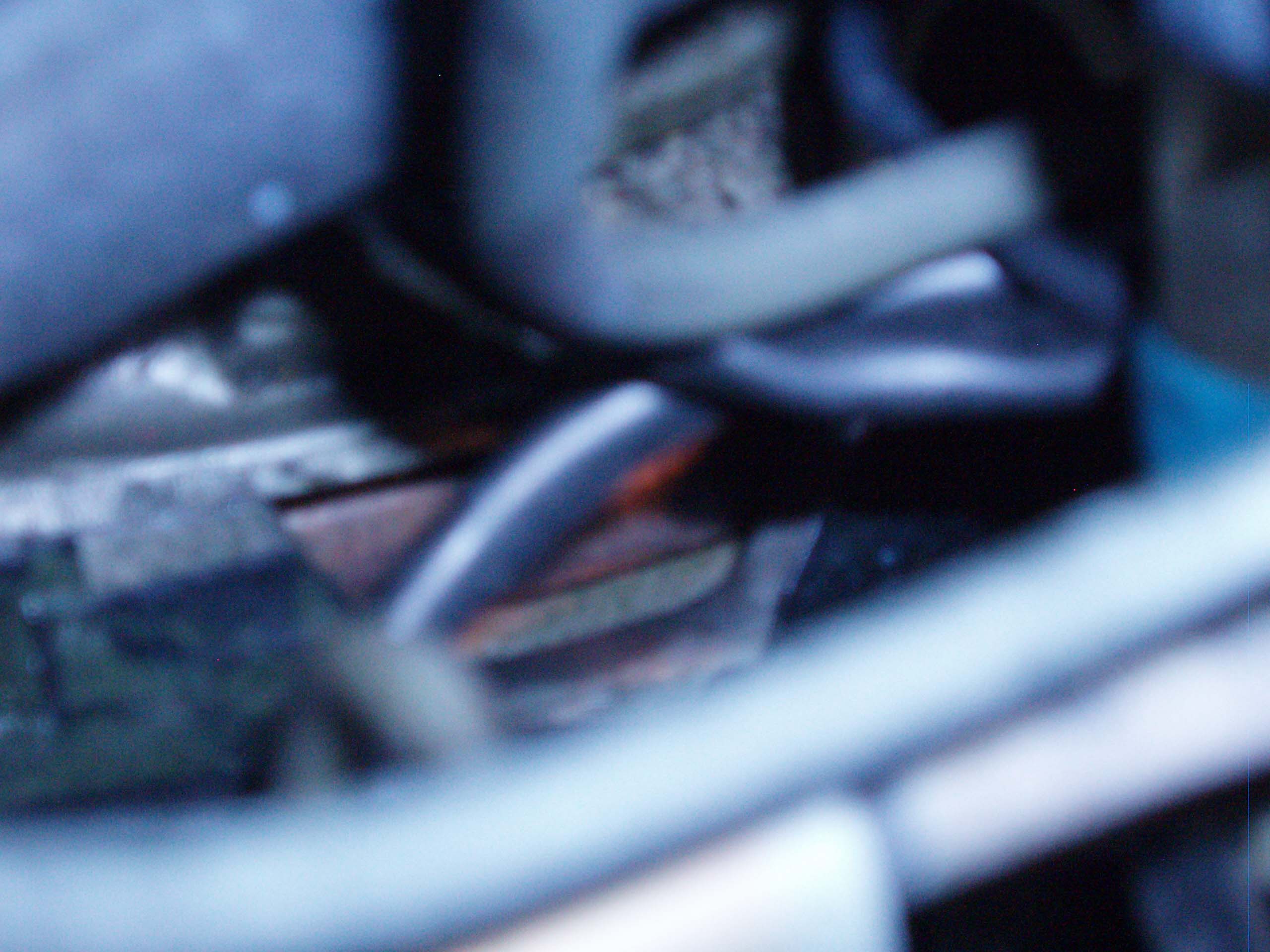

This may seem stupid.. But, I went to check the timing, and I can't get to it. The timing marks are right up against the firewall. So, is there some trick to it? And, I hope you don't have to crawl under a running car to get to it...

Is it a stock 6?? Take off the air cleaner if it is and you should be able to get to the mark on the flywheel!!
My FI 3.0L is a bit tough but once I get the light in it works fine!! I found that it is easier if you have a time
ing light with an adjustable advance so you can set it and find the line easier!

QUOTE(bfrymire @ Sep 26 2012, 08:54 PM) *
Ahh - no.
There are TDC marks on the crankshaft pulley, but they are intended to be used when setting valve lash.
The _timing_ marks, which include TDC and 35º BTDC, are on the _flywheel_ and are visible through a notch in the bellhousing.

It's a 2.7l. I can't tell from the photo, where you angle in from, andwhere to sight onthe timing mark.
thanks for the response!

If you have a 2.7 with a 2.0 -6 flywheel the timing marks will be off on the flywheel.

Mine is a 3.0L 911 and it has marks on the flywheel!
The photo is to the back at the flywheel!

Timing is probably more like 28 or 32 degrees total advance, and you want to set the timing at full advance.
Your best bet is going to be to rotate the engine so you can see the timing mark on the front pulley line up(with a mirror) and then make a paint mark on the flywheel, then use the mark on the flywheel to set the timing with the engine running.
This is also why some guys cut an access hole in the firewall right in front of the fan pulley.
Jeffs9146

When I did the conversion on my car, I initially used a cup-type flywheel with the 901 transmission, and the engraved marks on the flywheel were not lined up with the crank pulley. Obviously, there is a difference in the way the crankshafts key the flywheel position between the original 2.0 engine and the 2.7.
Use the crankshaft pulley marks and some whiteout (it seems to show up best IMHO) to make the corresponding marks on the flywheel for TDC and 35 BTDC.
