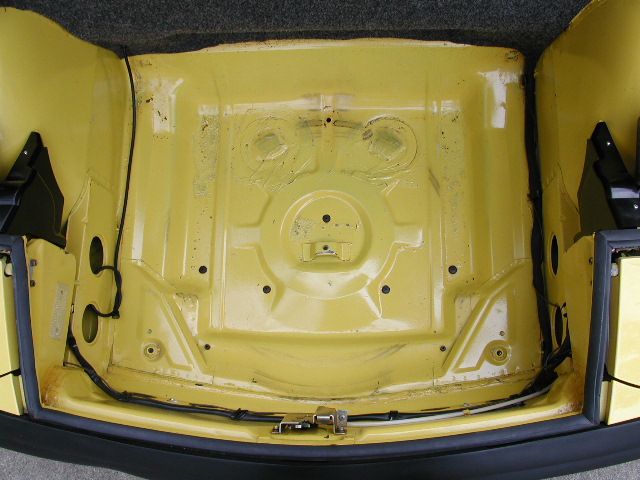

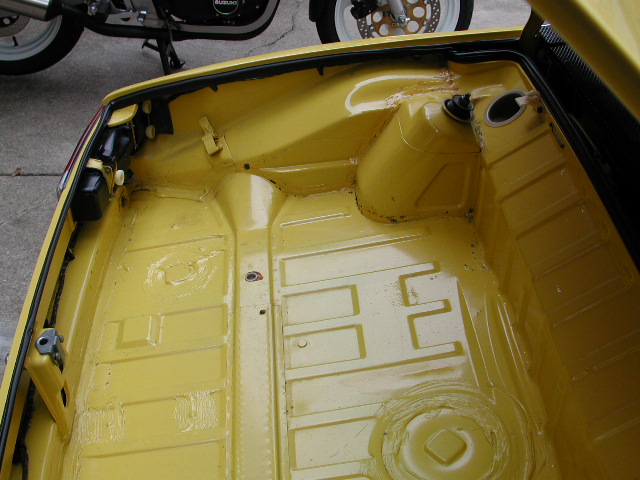

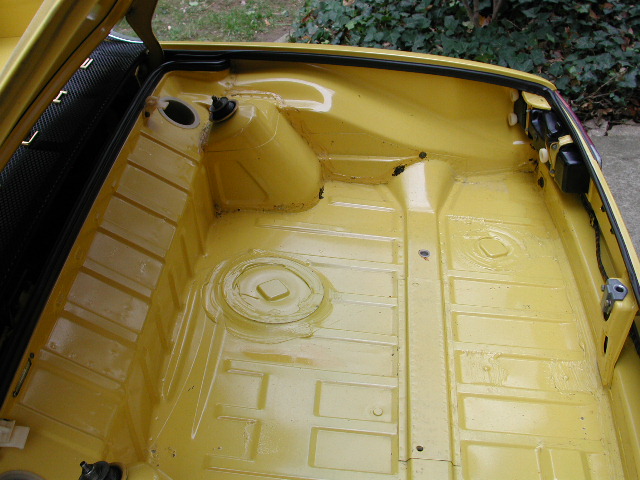

1970 Neun vierzehn
post Sep 28 2012, 12:37 PM
Posts: 3,199
Joined: 16-March 06
From: cincinnati, ohio
Member No.: 5,727
As previously posted....the trunk finish on early cars was body color.
These photos of an unrestored, Jan. 1970 build date, 914/4.........
