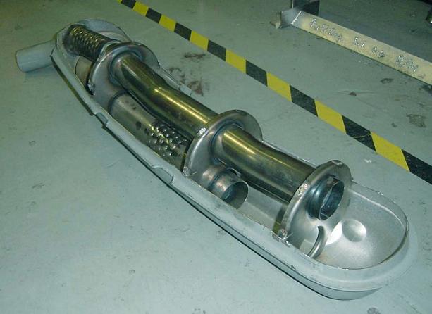

So,. . . My header/muffler system on my shop-car works flawlessly and actually sounds really good too. However, I REALLY love the sound of the Porsche banana can muffs. So I'm thinking of converting my shop-car to a banana can muffler. Switching could also eliminate the occasional dragging of the muffler coming out of steep parking lots. The big issue though is where would I end up mounting the O2 bung so it will read correctly?? I'm thinking that with a muffler like this one below, over on the right side (closest end) near the end would be a good spot. . . What say you??

On the outlet, as hidden as possible, but must be mounted between 9 and 3 o'clock. Best is at 12. This will get mix of all the exhaust to sample and keep water and condensation from damaging the sensor. BTW, use a wide band...

From the research I did before mounting mine, all experts said that O2 sensors should be inserted BEFORE the muffler between the above mentioned 9-3 o'clock.
If the inlet is a single pipe from all four cylinders, (can't tell from the pic and am not familiar with the Dansk models), it should be installed there. If the muffler is a dual inlet, I guess at the outlet of the muffler is your only option. I'm not sure what that will do to your readings. (IMG:style_emoticons/default/confused24.gif)

I have submitted a request to PLX regarding the sensor placement as I have the same muffler as you and would like to make sure that the readings are correct.. I would rather have correct readings for one exhaust pipe before the muffler if I have to, rather than risk improper readings from placing the bung on the exhaust. Stay tuned for their reply...your pic of the exhaust should be of great help to them in giving me an answer, I was unsure of the chamber layout until I saw your info.

Theoretically speaking, The O2 optimum location is 12" from the exhaust port. This is especially important if you are using a non heated sensor. If your exhaust merges into 1 inlet to the muffler, place it there. If you have dual inlets to the muffler, place it on the outlet as I described above. If you use either a wide band (best) or a heated sensor, the outlet is fine. If you run a non heated sensor, it may tank up to 20-30 minutes run time to get an accurate reading. The exhaust has to heat up the sensor.
I'm not an expert in that muffler but I have installed plenty of 02 sensors on custom EFI systems. You need to capture all of the cylinders with your sensor or your not going to get good readings. You could have one cylinder go lean and never know it.

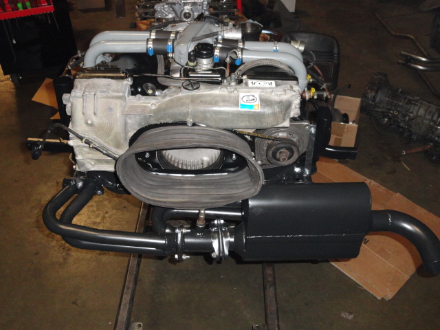

I've already got a wide-band sensor (LC-1) that is mounted @ 12 o'clock immediately after the collector and it works great. I don't see it possible to get one mounted on the outlet though since it's got to be around 12"-15" from ambient air or it begins to have bad readings too. This is the current set-up:
(IMG:http://www.914world.com/bbs2/uploads_offsite/images.thesamba.com-9730-1350180264.1.jpg)

QUOTE(aircooledtechguy @ Oct 13 2012, 10:04 PM) *
that's a nice setup, the collector looks like a perfect place for the sensor. Too bad with my Dansk I can't do the same. I suppose if I were to get real serious the PLX sensor module can accept up to 32 sensors, so one on each of my four exhaust pipes would be the ultimate. Since I'm running a stock L jet system rather than carbs, I'll pick a single tube about 12 inches from the exhaust port and see what I get. Here's the specs on the PLX sensor module:
