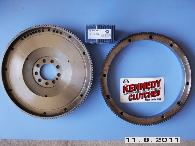

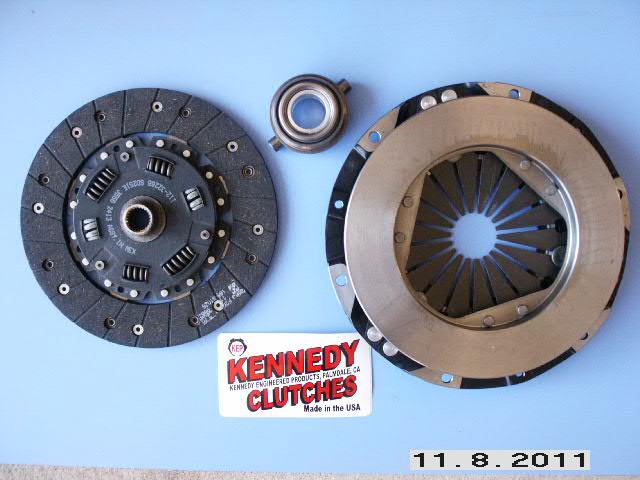

anybody seen this before? Solutions ??
I have a new-in-box KEP-1 pressure plate that I purchased thru GPR of San Luis Obispo (German Parts & Restoration) as part of a complete FW-Clutch conversion package to fit a 901 transaxle to a 3.2 engine
. Attached Image
today I finally tried to install the clutch
the PP bolt holes are not matching - the edges are about 1.5-2.0 mm inset from the matching bolt holes of the flywheel -
impossible to bolt up unless I hog out the existing holes in the KEP-1 PP
further measuring shows that the OD of the KEP-1 PP is maybe 1.5-2mm mm larger than the ID of the Porsche ring gear
looks like - it would require a big hammer or some grinding on the OD to make this fit correctly
the label on the box only has the KEP logo and "Stage 1 228mm VW/Porsche Presure Plate" printed on it
The Kennedy box says 228 - but the PP inside is a 225 - (a shipping room error somewhere...)
the 225 PP does not match up to the 228mm 930 FW/ring gear - just as said below
problem solved- see post below

I think I have that same kit on my 3.0 to 901. I know its 228mm. I do remember the mounting holes in the pressure plate came "clearanced" so it would bolt up. Either the pressure plate or the KEP ring had a pin to correctly locate the PP onto the flywheel. I do not remember the PP being larger than the ID of the ring gear. I can't see it, but I don't think that would be a problem. If the starter can engage the teeth without hitting you might be fine. Remember this is not OEM. KEP makes tons of different adapters for many car and engine combos.

When I installed my kit on the 3.0L it looked like it wouldn't fit but after getting everything turned the right way it did come together.
I had to tap the edge of the PP before it popped in and I was able to tork the bolts the rest of the way!
I would not enlarge the holes, I would wait until you hear from KEP to decide if it is possible they sent you something else!

If you are using the stock 3.2 flywheel, you will also need an adapter ring from KEP. The pressure plate bolts to this ring. Otherwise they also sell a complete flywheel designed for there 228mm pressure plate and disk.

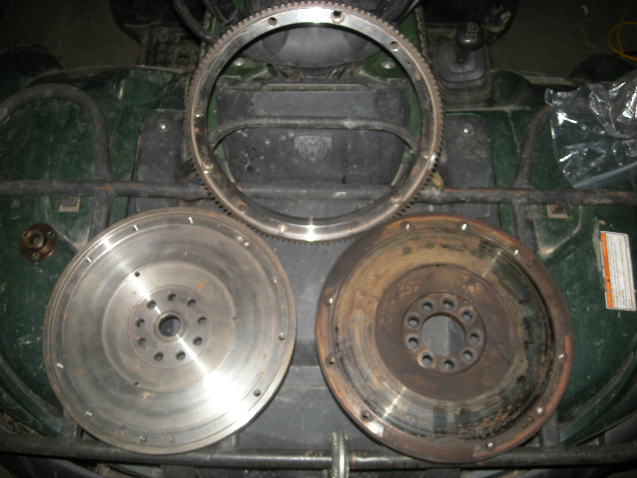

My bet is you are you trying to put a kit designed for a 225mm flywheel on a a 245mm flywheel.

This is the adapter I'm making for my 3.0 conversion, it fits the 225mm flywheel on the left, the flywheel on the right doesn't work with the 228mm pressure plate that KEP and others use for this.
I ran into this when a friend basically gave me the late 930 flywheel (245mm) on the right. Great price but it's no damn good to me. (IMG:style_emoticons/default/sad.gif)
I bet Andy's 3.6 conversion uses a whole different (245mm +/-) pressure plate.
Note the 225 flywheel on the left is borrowed, hence my ad in the classifieds. It's a 78-79 3.0 SC flywheel, in 1980 they went to the big hole 225mm flywheel.

so far, the big news here is that there was a 225 kit vs a 228 kit - that is fascinating!!!
WHY ???? (update - KEP says 225 is for VW bus, 228 is for Porsche)
whatever i have is what GPR sold as a complete conversion for 3.2 to 901, KEP box marked 228
- yes I have the correct adaptor ring gear, no it's not a 245mm FW, no pin in the adaptor ring - PP holes do not match up to ring - about 1-2mm off as stated above

That ring bolts to the flywheel through the recessed holes and then you install the disk and bolt the pressure plate to the ring. If the pressure plate doesn't match the ring then they sold you the wrong pressure plate.
The clutch and pressure plate are reinforced 228mm bus parts from KEP. Hence the stage 1 and 2 options hold up to various amounts of torque. I ran the stage 2 kit with my 3.2 and was very happy with it. It's just as reliable as stock, except the pedal was a little harder to push.

The 225 kit does use the 228mm pressure plate, the holes do need slight enlarging (elongating), but it's the adaptor ring that holds it centred in place. You shouldn't have to this as it should be done so let the seller look at it before whipping the drill out.

I just found the GPR invoice - it says part number "916-116-911-00 clutch set - 901 - 225 kit"

I DO NOT have a 245mm g50 FW
- I have a new 930- 228mm FW
it appears you are absolutely correct about the 225mm vs 228mm PP mismatch
the 225 PP does not match up to the 228mm 930 FW/ring gear - just as said above
Kennedy says there are TWO differences:
1. the bolt holes issue (they elongate them to solve) and
2. the diaphragm fingers on the correct one have flats at the T/O brg
Kennedy will exchange for the correct one, for only the shipping costs - hurrah !!!!
- solves my problem -
TIA.
