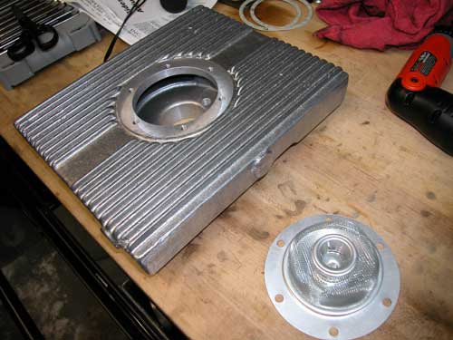

took out my screen, which was very clean btw,
has this one had the center drilled out or is this the way they come? Attached image(s) ![]() |

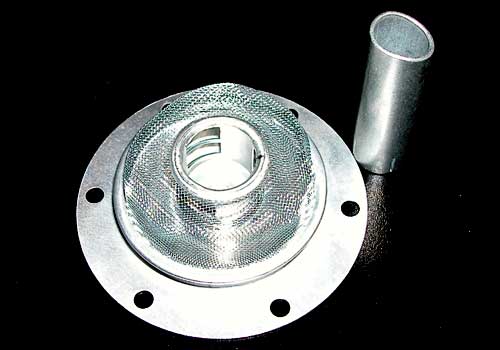

and this is how the screen that came with the scat deep sump looks.
should I drill out the center like the other one? Attached image(s) ![]() |

how does the deep some attach? how do you keep from bottoming out?

QUOTE(acox914 @ Nov 5 2004, 06:28 PM) how does the deep some attach? how do you keep from bottoming out? there are 2 large bolts and a plate that goes inside the case. Not an elegant solution but it seems to work. Jake has one on his track 914. This is really the only choice short of going to a dry sump. I hope it works. It really only hangs about .5" lower than the iron cross bar. I'll take a picture when I install it tommorrow. |

Dave,
If you look at the way the stock screen attaches the center bolt protrudes THROUGH the stock TIV sump screen and thats why the hole is there.. The sump screen that the scat sump uses is from a TYPE I... It needs some modifications that will help it to flow better. Please call me on my cell phone and I will walk you through it. I only have limited access to the net from where I'm at and will have no more till Tueday when I return. You have my number, utilize it as I would rather receiove a phone call as to see you get the wrong information. FYI- he is running the Scat Sump per my recommendations. Ivhave been doing alot with these sumps in wet sump 914s and they have alot of potential, especially when i start cutting and welding them into weird shapes to increase oil control in hard turns.The sumps don't sit very much lower than the engine mount bar and in Mark's F prod car, My car, or many other 914s we have never had an issue with them dragging the ground.. The Sump attaches with a steel bar that slides into the case and has two through bolts. This design was refined by Scat a few months ago due to my modifications that worked so well for mounting them. Dave, call me! I'm outta here again now....... Back to having fun!!! also, the |

Well I removed the first conical area around the screen opening. The pickup drops right in now but I still don't like the "resevoir like" area around the pickup tube. It only has 3 small openings to allow the oil in.
Maybe I'll cut that out as well. Attached image(s) ![]() |
