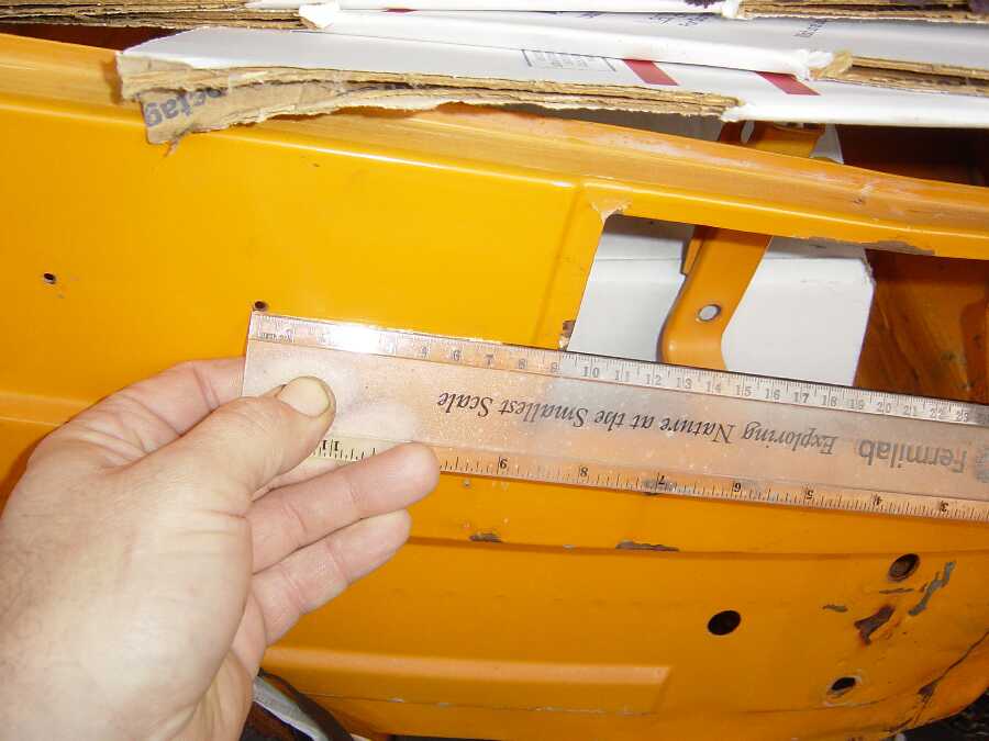

the first hole on the rear panel is 92 mm to the left of the tail light housing cutout.
(not the 914-6 VW Porsche badge)

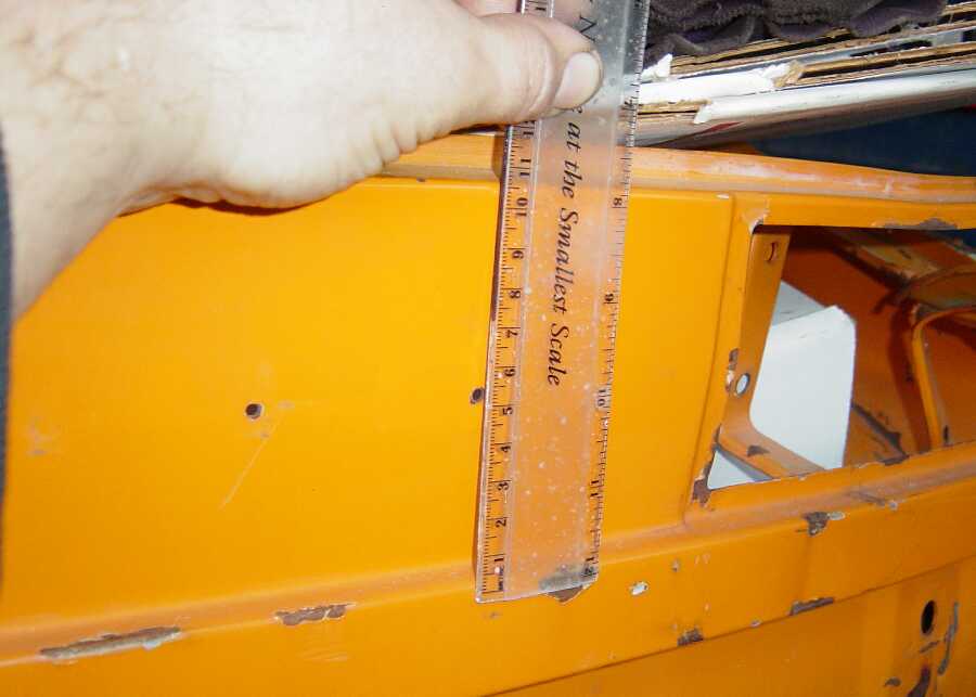

52 mm above panel rib
