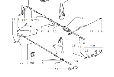

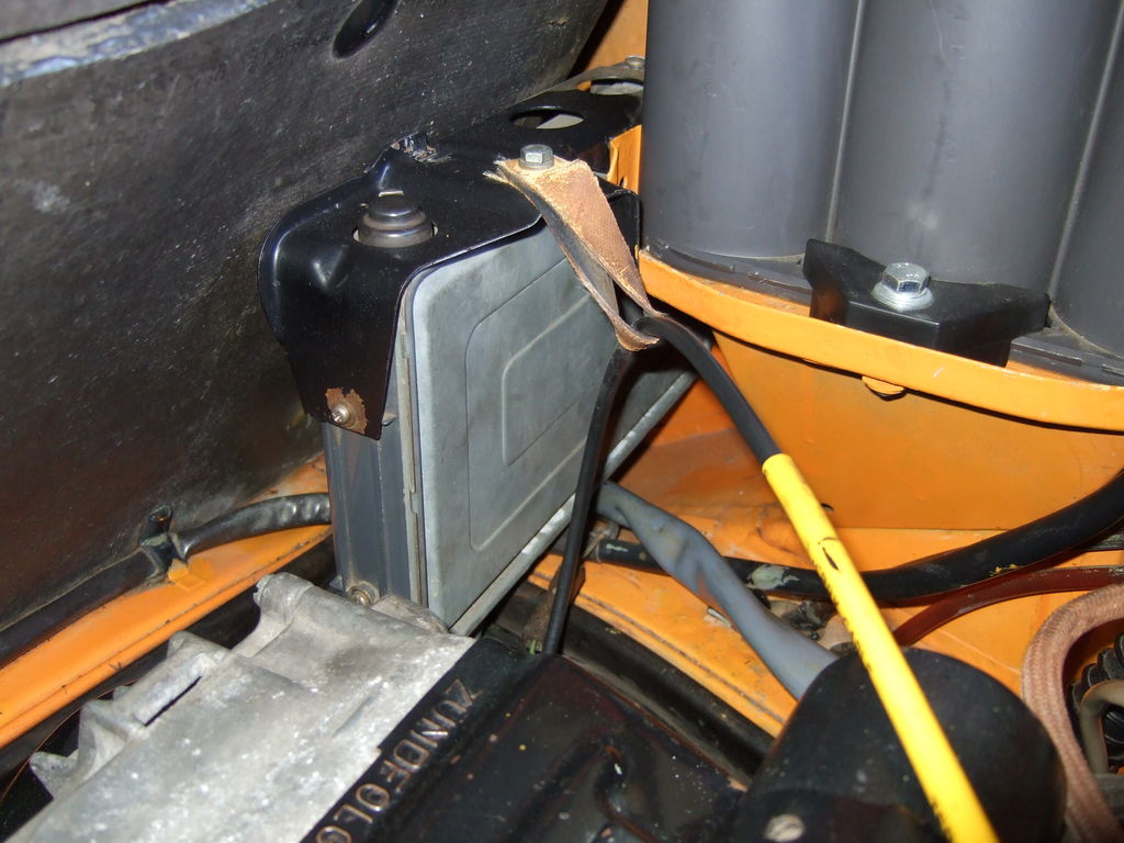

PN 999.706.005.80 (suspension strap). It's listed only as for 914 2.0 though. Possibly because of where the 2.0 cable attachment is and perhaps to relieve strain on the mounting nut.
#71 in the diagram below
