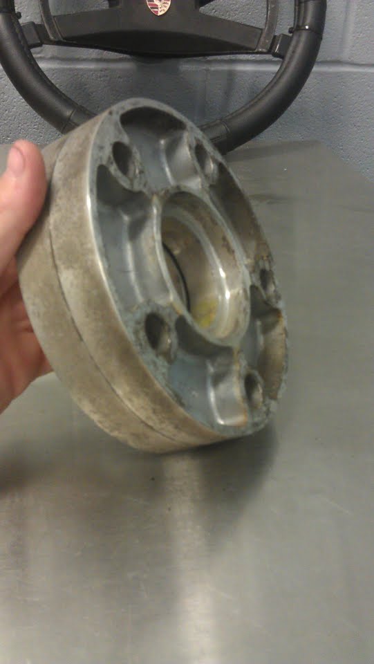

FWIW... I like 944 spacers. I've stacked a few and custom machined them for the desired thickness:
(IMG:http://www.914world.com/bbs2/uploads_offsite/sphotos-a.xx.fbcdn.net-1110-1355346176.1.jpg)

QUOTE(Eric_Shea @ Dec 12 2012, 01:02 PM) *
WOW! that is ARTWORK! You are talking hub-centric, yah? I've got stock 914 4 lug hubs drilled for 5-lug, not sure that approach will work? <---- clearly I'm lost and way out of my depth, trying to learn here....
