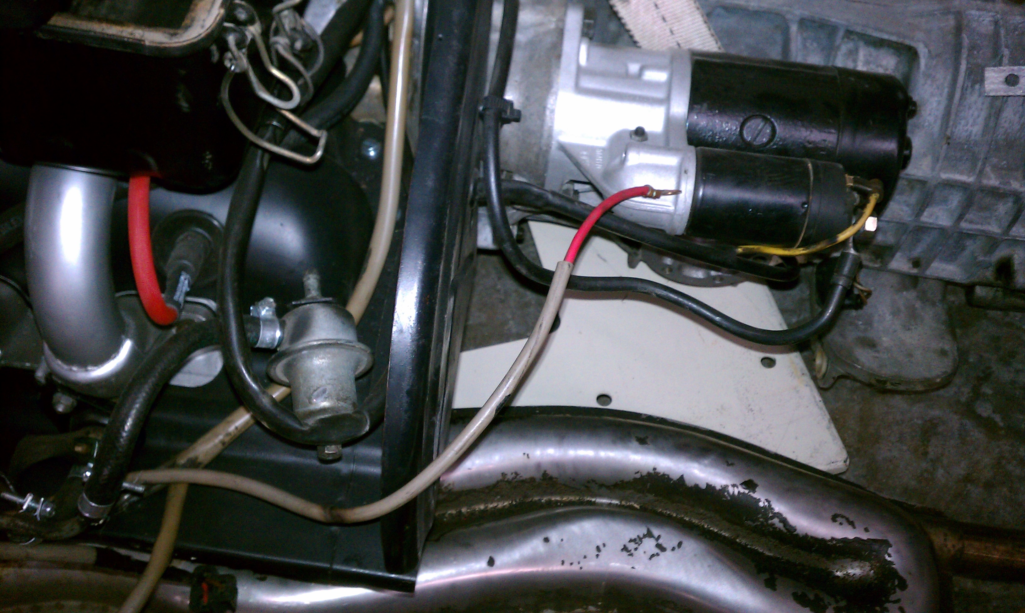

Getting ready to install the engine and cant remember where this wire goes to. It looks like it goes into the hole next to the drivers side heat port.

It looks like the one that goes from the alt to the back of the starter main + from the battery!

Yep, same place as the bla k wire .

yep. the derk area on that sheathing will line up with the grommet where it turns under.

I did notice that your fuel line to the fuel pressure regulator looks a little short, may be the camera angle. Yours line looks to be about about 6 inches, mine is closer to 12 inches. Easier to check now than after engine install.

Thanks for noticing my clean engine. I just had it rebuilt to a 2056 cc and took the time to clean & paint all the tin, intake manifolds & mic parts. I also had the alternator & starter rebuilt.
I may have to pull on the cable in question cause it seems to be +/- 2" short of the starter bolt. More pictures to come of the engine.

The cable should reach of routes properly . There should be ahole on the back metal thin to route the cable
